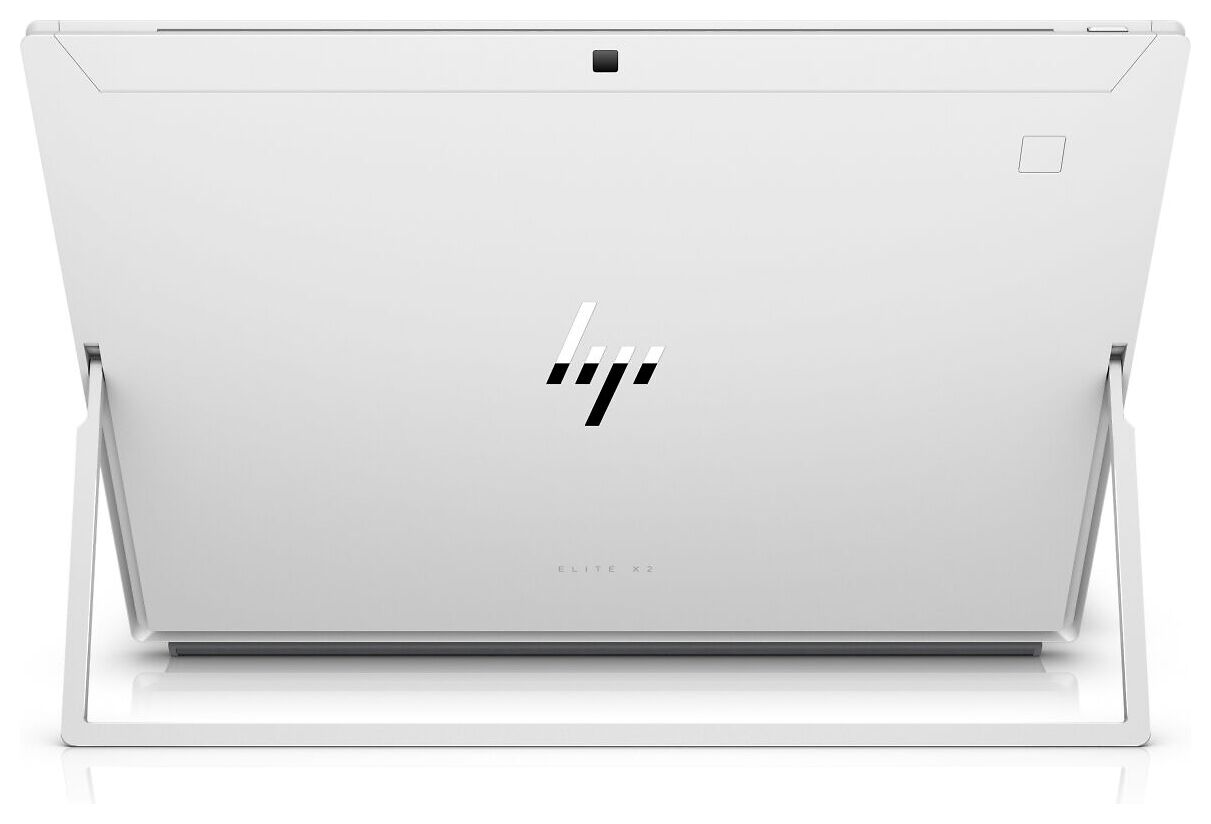

HP Elite x2 1013 G3 + LaserJet Pro M15w Hybrid (2-in-1) 1013 Specification for Upgrade or Repair
    HP Elite x2 1013 G3 + LaserJet Pro M15w Hybrid (2-in-1) 1013 Specification for Upgrade or Repair
    This specification for the HP Elite x2 1013 G3 + LaserJet Pro M15w Hybrid (2-in-1) can be useful for upgrading or repairing a laptop that is not working. As a community we are working through our specifications to add valuable data like the 1013 G3 + LaserJet Pro M15w boardview and 1013 G3 + LaserJet Pro M15w schematic. Our users have donated over 1 million documents which are being added to the site. This page will be updated soon with additional information. Alternatively you can request additional help from our users directly on the relevant badcaps forum. Please note that we offer no warranties that any specification, datasheet, or download for HP Elite x2 1013 G3 + LaserJet Pro M15w Hybrid (2-in-1) is accurate, safe, error free, or the fix you require.
    Design > Family: Elite x2
    Design > Model Name: 1013 G3 + LaserJet Pro M15w
    Design > Part Number: 4WD01PA-M15W
    Design > Release Date: 13/02/2019
    Design > Series: 1013
    Display > Aspect Ratio: 0.126388889
    Display > Display Brightness: 450 cd/m^2
    Display > Display Diagonal: 13 inch
    Display > Display Resolution: 3000x2000 pixels
    Specification > Battery: 10.5 hrs
    Specification > Display Diagonal: 13 inch
    Specification > Processor: i7-8650U 1.9GHz
    Specification > Weight: 1.17kg
    Product Code: 4WD01PA-M15W
    Battery > Battery Life (max): 10.5 h
    Camera > Rear Camera: Yes
    Networking > 3G Standards: HSPA+
    Networking > 4G Standard: LTE
    Performance > Gyroscope: Yes
    Performance > Proximity Sensor: Yes
    Ports & Interfaces > USB 3.2 Gen 1 (3.1 Gen 1) Type-C Ports Qty: 3
    Weight And Dimensions > Depth: 231.5mm
    Weight And Dimensions > Depth (tablet Mode): 23.1 cm
    Weight And Dimensions > Height: 13.3mm
    Weight And Dimensions > Height (tablet Mode): 7.9mm
    Weight And Dimensions > Weight: 1.17kg
    Weight And Dimensions > Weight (tablet Mode): 820g
    Weight And Dimensions > Width: 300mm
    Weight And Dimensions > Width (tablet Mode): 30 cm
    HP Elite x2 1013 G3 + LaserJet Pro M15w Hybrid (2-in-1) 1013 Specification for Upgrade or Repair
    HP Elite x2 1013 G3 + LaserJet Pro M15w Hybrid (2-in-1) 1013 Specification for Upgrade or Repair
    This specification for the HP Elite x2 1013 G3 + LaserJet Pro M15w Hybrid (2-in-1) can be useful for upgrading or repairing a laptop that is not working. As a community we are working through our specifications to add valuable data like the 1013 G3 + LaserJet Pro M15w boardview and 1013 G3 + LaserJet Pro M15w schematic. Our users have donated over 1 million documents which are being added to the site. This page will be updated soon with additional information. Alternatively you can request additional help from our users directly on the relevant badcaps forum. Please note that we offer no warranties...
    09-06-2024, 08:10 AM
    HP Elite x2 1013 G3 + LaserJet Pro M15w Hybrid (2-in-1) 1013 Specification for Upgrade or Repair
    This specification for the HP Elite x2 1013 G3 + LaserJet Pro M15w Hybrid (2-in-1) can be useful for upgrading or repairing a laptop that is not working. As a community we are working through our specifications to add valuable data like the 1013 G3 + LaserJet Pro M15w boardview and 1013 G3 + LaserJet Pro M15w schematic. Our users have donated over 1 million documents which are being added to the site. This page will be updated soon with additional information. Alternatively you can request additional help from our users directly on the relevant badcaps forum. Please note that we offer no warranties...
    09-06-2024, 08:10 AM
    HP Elite x2 1013 G3 + LaserJet Pro M15w Hybrid (2-in-1) 1013 Specification for Upgrade or Repair
    This specification for the HP Elite x2 1013 G3 + LaserJet Pro M15w Hybrid (2-in-1) can be useful for upgrading or repairing a laptop that is not working. As a community we are working through our specifications to add valuable data like the 1013 G3 + LaserJet Pro M15w boardview and 1013 G3 + LaserJet Pro M15w schematic. Our users have donated over 1 million documents which are being added to the site. This page will be updated soon with additional information. Alternatively you can request additional help from our users directly on the relevant badcaps forum. Please note that we offer no warranties...
    09-06-2024, 08:10 AM
    HP Elite x2 1013 G3 + LaserJet Pro M15w Hybrid (2-in-1) 1013 Specification for Upgrade or Repair
    This specification for the HP Elite x2 1013 G3 + LaserJet Pro M15w Hybrid (2-in-1) can be useful for upgrading or repairing a laptop that is not working. As a community we are working through our specifications to add valuable data like the 1013 G3 + LaserJet Pro M15w boardview and 1013 G3 + LaserJet Pro M15w schematic. Our users have donated over 1 million documents which are being added to the site. This page will be updated soon with additional information. Alternatively you can request additional help from our users directly on the relevant badcaps forum. Please note that we offer no warranties...
    09-06-2024, 08:10 AM
    HP Elite x2 1013 G3 + LaserJet Pro M15w Hybrid (2-in-1) 1013 Specification for Upgrade or Repair
    This specification for the HP Elite x2 1013 G3 + LaserJet Pro M15w Hybrid (2-in-1) can be useful for upgrading or repairing a laptop that is not working. As a community we are working through our specifications to add valuable data like the 1013 G3 + LaserJet Pro M15w boardview and 1013 G3 + LaserJet Pro M15w schematic. Our users have donated over 1 million documents which are being added to the site. This page will be updated soon with additional information. Alternatively you can request additional help from our users directly on the relevant badcaps forum. Please note that we offer no warranties...
    09-06-2024, 08:10 AM
