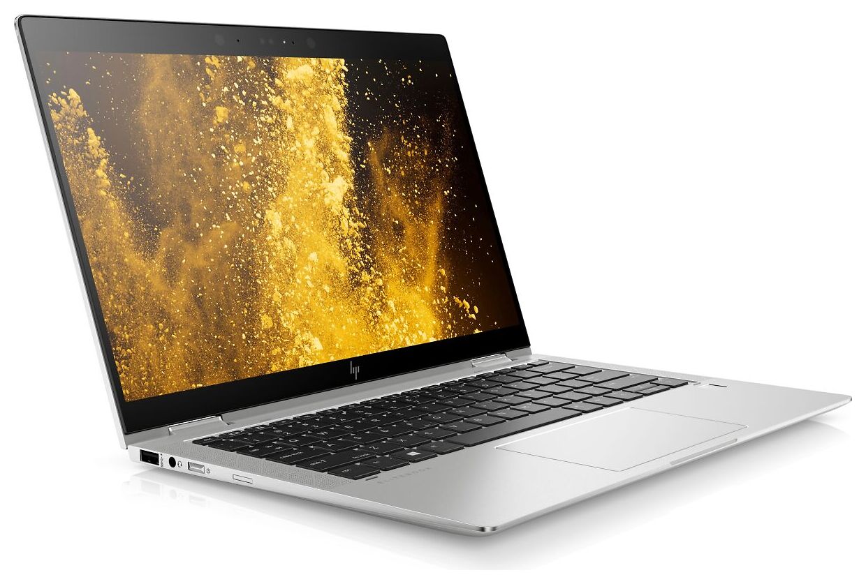

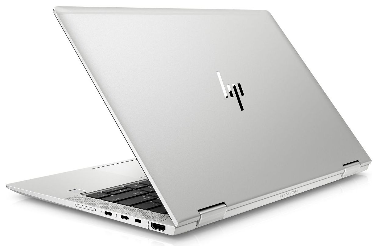

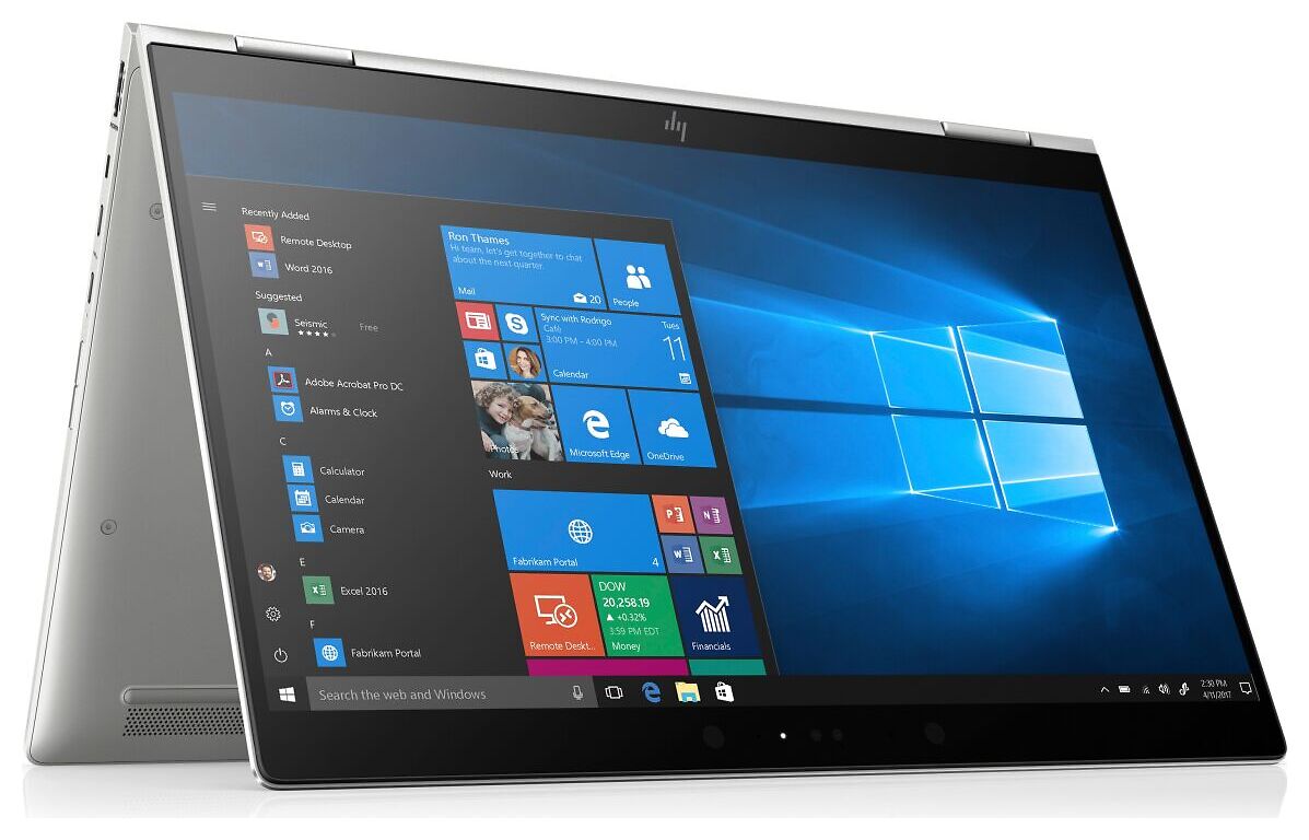

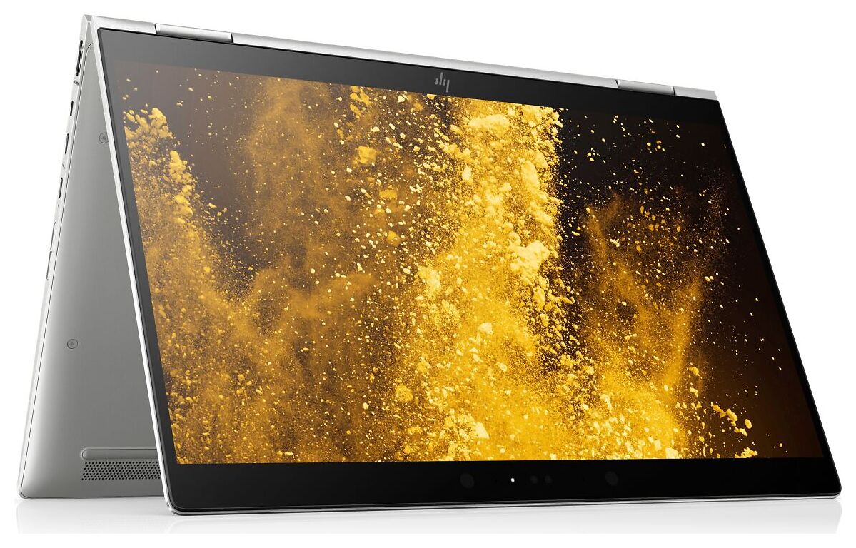

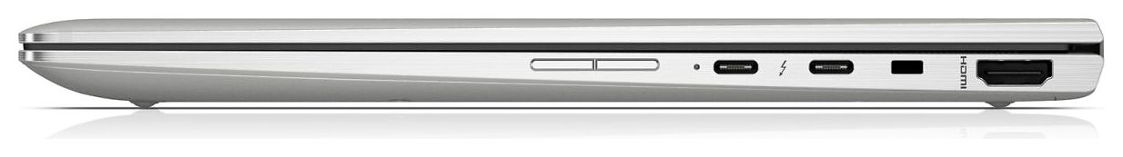

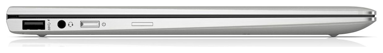

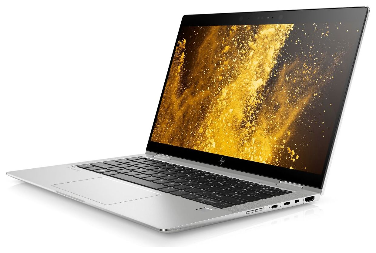

HP EliteBook x360 1030 G3 Hybrid (2-in-1) Specification for Upgrade or Repair
    HP EliteBook x360 1030 G3 Hybrid (2-in-1) Specification for Upgrade or Repair
    This specification for the HP EliteBook x360 1030 G3 Hybrid (2-in-1) can be useful for upgrading or repairing a laptop that is not working. As a community we are working through our specifications to add valuable data like the 1030 G3 boardview and 1030 G3 schematic. Our users have donated over 1 million documents which are being added to the site. This page will be updated soon with additional information. Alternatively you can request additional help from our users directly on the relevant badcaps forum. Please note that we offer no warranties that any specification, datasheet, or download for HP EliteBook x360 1030 G3 Hybrid (2-in-1) is accurate, safe, error free, or the fix you require.
    Design > Model Name: 1030 G3
    Design > Part Number: 5VT84US
    Design > Release Date: 02/02/2019
    Specification > Processor: i7-8650U 1.9GHz
    Product Code: 5VT84US
    Performance > Gyroscope: Yes
    Weight And Dimensions > Depth: 205mm
    Weight And Dimensions > Height: 15.8mm
    Weight And Dimensions > Width: 305.8mm
    HP EliteBook x360 1030 G3 Hybrid (2-in-1) Specification for Upgrade or Repair
    HP EliteBook x360 EliteBook x360 1030 G2 Hybrid (2-in-1) Specification for Upgrade or Repair
    This specification for the HP EliteBook x360 EliteBook x360 1030 G2 Hybrid (2-in-1) can be useful for upgrading or repairing a laptop that is not working. As a community we are working through our specifications to add valuable data like the EliteBook x360 1030 G2 boardview and EliteBook x360 1030 G2 schematic. Our users have donated over 1 million documents which are being added to the site. This page will be updated soon with additional information. Alternatively you can request additional help from our users directly on the relevant badcaps forum. Please note that we offer no warranties that...
    09-06-2024, 08:27 AM
    HP EliteBook x360 EliteBook x360 1030 G2 (ENERGY STAR) Hybrid (2-in-1) Specification for Upgrade or Repair
    This specification for the HP EliteBook x360 EliteBook x360 1030 G2 (ENERGY STAR) Hybrid (2-in-1) can be useful for upgrading or repairing a laptop that is not working. As a community we are working through our specifications to add valuable data like the EliteBook x360 1030 G2 (ENERGY STAR) boardview and EliteBook x360 1030 G2 (ENERGY STAR) schematic. Our users have donated over 1 million documents which are being added to the site. This page will be updated soon with additional information. Alternatively you can request additional help from our users directly on the relevant badcaps forum. Please...
    09-06-2024, 05:33 AM
    HP EliteBook x360 EliteBook x360 1030 G2 (ENERGY STAR) Hybrid (2-in-1) Specification for Upgrade or Repair
    This specification for the HP EliteBook x360 EliteBook x360 1030 G2 (ENERGY STAR) Hybrid (2-in-1) can be useful for upgrading or repairing a laptop that is not working. As a community we are working through our specifications to add valuable data like the EliteBook x360 1030 G2 (ENERGY STAR) boardview and EliteBook x360 1030 G2 (ENERGY STAR) schematic. Our users have donated over 1 million documents which are being added to the site. This page will be updated soon with additional information. Alternatively you can request additional help from our users directly on the relevant badcaps forum. Please...
    09-06-2024, 06:40 AM
    HP EliteBook x360 EliteBook x360 1030 G2 (ENERGY STAR) Hybrid (2-in-1) Specification for Upgrade or Repair
    This specification for the HP EliteBook x360 EliteBook x360 1030 G2 (ENERGY STAR) Hybrid (2-in-1) can be useful for upgrading or repairing a laptop that is not working. As a community we are working through our specifications to add valuable data like the EliteBook x360 1030 G2 (ENERGY STAR) boardview and EliteBook x360 1030 G2 (ENERGY STAR) schematic. Our users have donated over 1 million documents which are being added to the site. This page will be updated soon with additional information. Alternatively you can request additional help from our users directly on the relevant badcaps forum. Please...
    09-06-2024, 05:33 AM
    HP EliteBook x360 1030 G2 + Casio G-SHOCK Hybrid (2-in-1) Specification for Upgrade or Repair
    This specification for the HP EliteBook x360 1030 G2 + Casio G-SHOCK Hybrid (2-in-1) can be useful for upgrading or repairing a laptop that is not working. As a community we are working through our specifications to add valuable data like the 1030 G2 + Casio G-SHOCK boardview and 1030 G2 + Casio G-SHOCK schematic. Our users have donated over 1 million documents which are being added to the site. This page will be updated soon with additional information. Alternatively you can request additional help from our users directly on the relevant badcaps forum. Please note that we offer no warranties...
    09-06-2024, 08:20 AM
