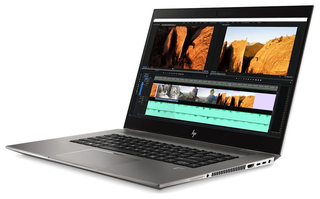

HP ZBook Studio G5 Mobile workstation Studio Specification for Upgrade or Repair
    HP ZBook Studio G5 Mobile workstation Studio Specification for Upgrade or Repair
    This specification for the HP ZBook Studio G5 Mobile workstation can be useful for upgrading or repairing a laptop that is not working. As a community we are working through our specifications to add valuable data like the Studio G5 boardview and Studio G5 schematic. Our users have donated over 1 million documents which are being added to the site. This page will be updated soon with additional information. Alternatively you can request additional help from our users directly on the relevant badcaps forum. Please note that we offer no warranties that any specification, datasheet, or download for HP ZBook Studio G5 Mobile workstation is accurate, safe, error free, or the fix you require.
    Design > EAN/UPC Code: 0193808332272, 0193808332333, 0193808332357, 0193808332289, 0193808801419, 0193808332371, 0193808332302, 0193808332388, 0193808332050
    Design > Family: ZBook
    Design > Model Name: Studio G5
    Design > Part Number: 5UC27ET
    Design > Release Date: 01/02/2019
    Design > Series: Studio
    Graphics > Discrete Graphics Adapter Model: NVIDIA Quadro P1000
    Specification > Battery: 95.6 Wh
    Specification > Processor: i7-8750H 2.20GHz
    Specification > Weight: 2kg
    Processor > Processor Boost Frequency: 4.10GHz
    Processor > Processor Frequency: 2.20GHz
    Product Code: 5UC27ET
    Battery > Battery Capacity (Watt Hours): 95.6Wh
    Brand-specific Features > HP Security Tools: HP Device Access Manager, HP FingerPrint Sensor, HP Password Manager, HP Power On Authentication, HP Security Manager, HP Sure Click, HP BIOS Config Utility (BCU), HP Client Catalog, HP Driver Packs, HP System Software Manager (SSM), HP Manageability Integration Kit Gen2, HP BIOSphere with Sure Start Gen4, HP Secure Disk Erase, HP Host Based Mac Address
    Weight And Dimensions > Height (front): 8.8mm
    Weight And Dimensions > Height (rear): 1.74 cm
    HP ZBook Studio G5 Mobile workstation Studio Specification for Upgrade or Repair
    HP ZBook ZBook Studio G5 Mobile Workstation Mobile workstation Studio Specification for Upgrade or Repair
    This specification for the HP ZBook ZBook Studio G5 Mobile Workstation Mobile workstation can be useful for upgrading or repairing a laptop that is not working. As a community we are working through our specifications to add valuable data like the ZBook Studio G5 Mobile Workstation boardview and ZBook Studio G5 Mobile Workstation schematic. Our users have donated over 1 million documents which are being added to the site. This page will be updated soon with additional information. Alternatively you can request additional help from our users directly on the relevant badcaps forum. Please note that...
    09-06-2024, 07:05 AM
    HP ZBook ZBook Studio G3 Mobile Workstation Mobile workstation Studio Specification for Upgrade or Repair
    This specification for the HP ZBook ZBook Studio G3 Mobile Workstation Mobile workstation can be useful for upgrading or repairing a laptop that is not working. As a community we are working through our specifications to add valuable data like the ZBook Studio G3 Mobile Workstation boardview and ZBook Studio G3 Mobile Workstation schematic. Our users have donated over 1 million documents which are being added to the site. This page will be updated soon with additional information. Alternatively you can request additional help from our users directly on the relevant badcaps forum. Please note that...
    09-06-2024, 06:02 AM
    HP ZBook ZBook Studio G3 Mobile Workstation Ultrabook Studio Specification for Upgrade or Repair
    This specification for the HP ZBook ZBook Studio G3 Mobile Workstation Ultrabook can be useful for upgrading or repairing a laptop that is not working. As a community we are working through our specifications to add valuable data like the ZBook Studio G3 Mobile Workstation boardview and ZBook Studio G3 Mobile Workstation schematic. Our users have donated over 1 million documents which are being added to the site. This page will be updated soon with additional information. Alternatively you can request additional help from our users directly on the relevant badcaps forum. Please note that we offer...
    09-06-2024, 05:30 AM
    HP ZBook Studio G4 + DreamColor Z27x Studio Display Mobile workstation Studio Specification for Upgrade or Repair
    This specification for the HP ZBook Studio G4 + DreamColor Z27x Studio Display Mobile workstation can be useful for upgrading or repairing a laptop that is not working. As a community we are working through our specifications to add valuable data like the Studio G4 + DreamColor Z27x Studio Display boardview and Studio G4 + DreamColor Z27x Studio Display schematic. Our users have donated over 1 million documents which are being added to the site. This page will be updated soon with additional information. Alternatively you can request additional help from our users directly on the relevant badcaps...
    09-06-2024, 06:00 AM
    HP ZBook ZBook Studio G3 Mobile Workstation Ultrabook Specification for Upgrade or Repair
    This specification for the HP ZBook ZBook Studio G3 Mobile Workstation Ultrabook can be useful for upgrading or repairing a laptop that is not working. As a community we are working through our specifications to add valuable data like the ZBook Studio G3 Mobile Workstation boardview and ZBook Studio G3 Mobile Workstation schematic. Our users have donated over 1 million documents which are being added to the site. This page will be updated soon with additional information. Alternatively you can request additional help from our users directly on the relevant badcaps forum. Please note that we offer...
    09-06-2024, 05:30 AM
