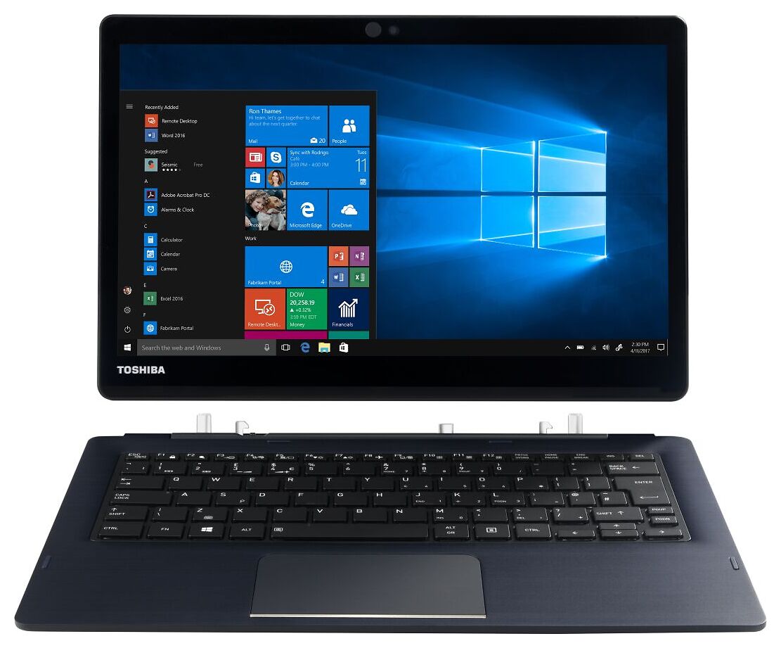

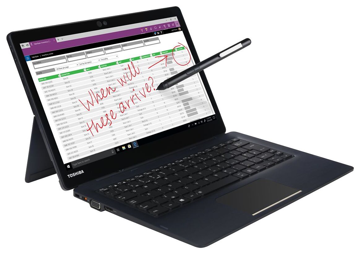

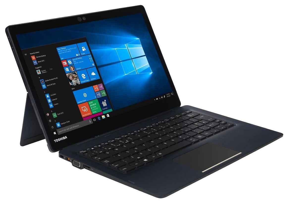

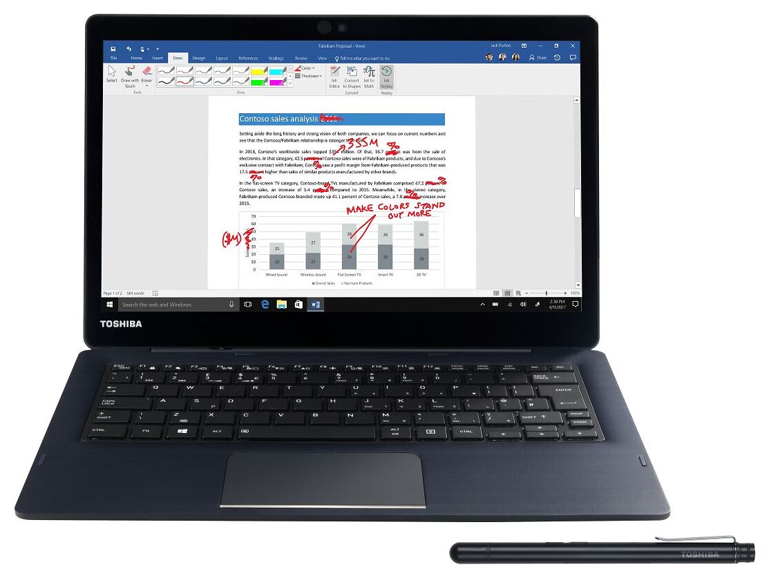

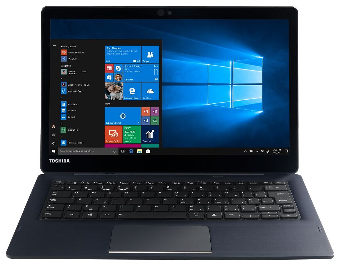

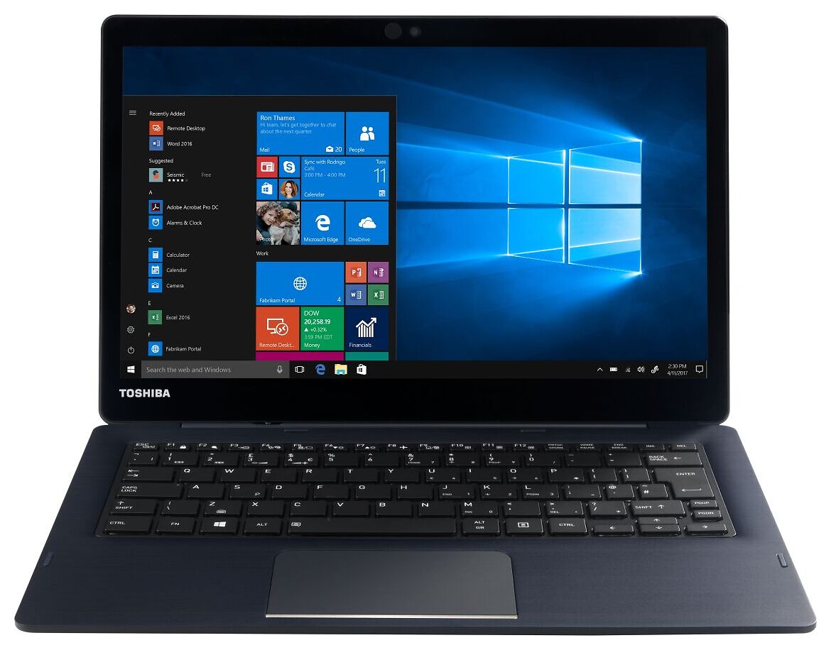

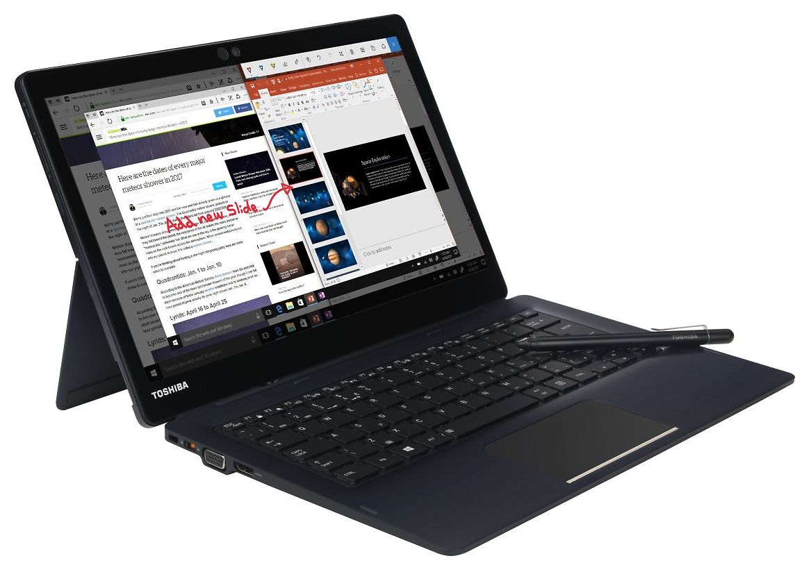

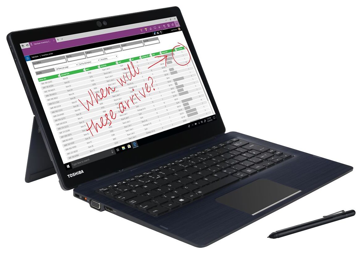

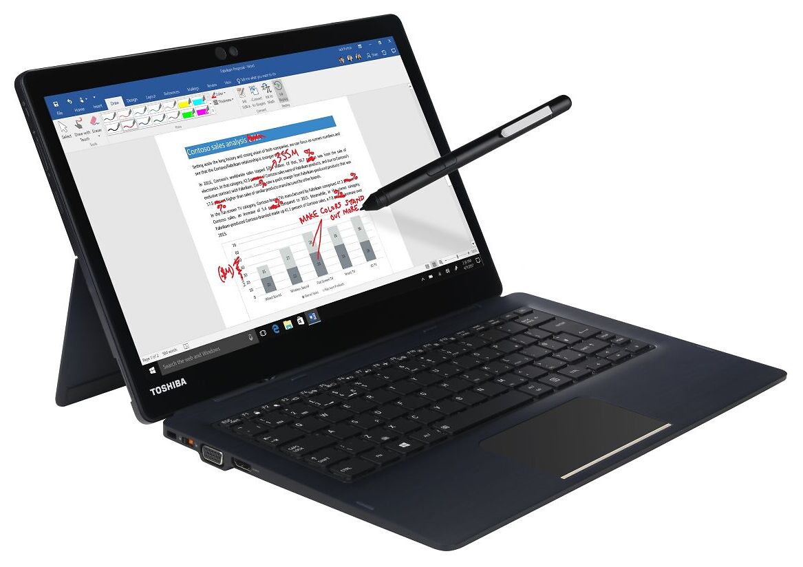

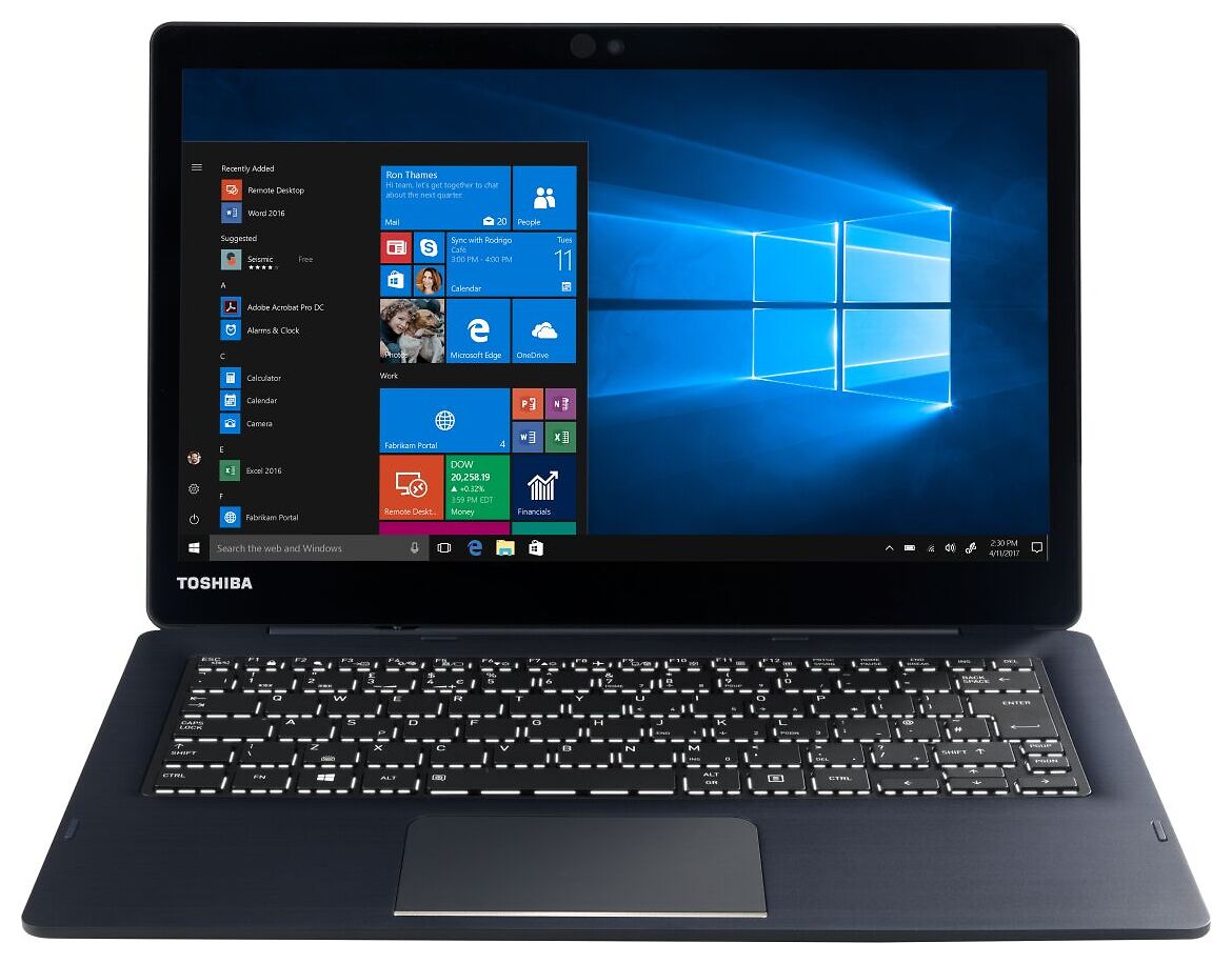

Toshiba Portege X30T-E-13H Hybrid (2-in-1) Specification for Upgrade or Repair
    Toshiba Portege X30T-E-13H Hybrid (2-in-1) Specification for Upgrade or Repair
    This specification for the Toshiba Portege X30T-E-13H Hybrid (2-in-1) can be useful for upgrading or repairing a laptop that is not working. As a community we are working through our specifications to add valuable data like the X30T-E-13H boardview and X30T-E-13H schematic. Our users have donated over 1 million documents which are being added to the site. This page will be updated soon with additional information. Alternatively you can request additional help from our users directly on the relevant badcaps forum. Please note that we offer no warranties that any specification, datasheet, or download for Toshiba Portege X30T-E-13H Hybrid (2-in-1) is accurate, safe, error free, or the fix you require.
    Design > Brand: Toshiba
    Design > Family: Portege
    Design > Model Name: X30T-E-13H
    Design > Part Number: PT17CE-01U00LBT
    Design > Product Colour: Blue
    Design > Release Date: 22/01/2019
    Specification > Battery: 14.25 hrs
    Specification > Weight: 1.4kg
    Product Code: PT17CE-01U00LBT
    Battery > Battery Life (max): 14.25 h
    Camera > Rear Camera: Yes
    Camera > Rear Camera Resolution (numeric): 5MP
    Camera > Windows Hello: Yes
    Keyboard > Keyboard Number Of Keys: 87
    Power > AC Adapter Output Current: 2.25A
    Weight And Dimensions > Depth: 217mm
    Weight And Dimensions > Depth (tablet Mode): 20.7 cm
    Weight And Dimensions > Height: 22.1mm
    Weight And Dimensions > Height (tablet Mode): 9.1mm
    Weight And Dimensions > Weight (tablet Mode): 799g
    Weight And Dimensions > Width: 316mm
    Weight And Dimensions > Width (tablet Mode): 31.6 cm
    Toshiba Portege X30T-E-13H Hybrid (2-in-1) Specification for Upgrade or Repair
    Toshiba Portege Portege Z30-C-1CV Notebook Specification for Upgrade or Repair
    This specification for the Toshiba Portege Portege Z30-C-1CV Notebook can be useful for upgrading or repairing a laptop that is not working. As a community we are working through our specifications to add valuable data like the Portege Z30-C-1CV boardview and Portege Z30-C-1CV schematic. Our users have donated over 1 million documents which are being added to the site. This page will be updated soon with additional information. Alternatively you can request additional help from our users directly on the relevant badcaps forum. Please note that we offer no warranties that any specification, datasheet,...
    09-06-2024, 05:33 AM
    Toshiba Portege Portege X20W-D-10Q Hybrid (2-in-1) Specification for Upgrade or Repair
    This specification for the Toshiba Portege Portege X20W-D-10Q Hybrid (2-in-1) can be useful for upgrading or repairing a laptop that is not working. As a community we are working through our specifications to add valuable data like the Portege X20W-D-10Q boardview and Portege X20W-D-10Q schematic. Our users have donated over 1 million documents which are being added to the site. This page will be updated soon with additional information. Alternatively you can request additional help from our users directly on the relevant badcaps forum. Please note that we offer no warranties that any specification,...
    09-06-2024, 05:33 AM
    Toshiba Portege Portege X20W-D-10V Hybrid (2-in-1) Specification for Upgrade or Repair
    This specification for the Toshiba Portege Portege X20W-D-10V Hybrid (2-in-1) can be useful for upgrading or repairing a laptop that is not working. As a community we are working through our specifications to add valuable data like the Portege X20W-D-10V boardview and Portege X20W-D-10V schematic. Our users have donated over 1 million documents which are being added to the site. This page will be updated soon with additional information. Alternatively you can request additional help from our users directly on the relevant badcaps forum. Please note that we offer no warranties that any specification,...
    09-06-2024, 05:33 AM
    Toshiba Portege Portege Z30-C-1CW Notebook Specification for Upgrade or Repair
    This specification for the Toshiba Portege Portege Z30-C-1CW Notebook can be useful for upgrading or repairing a laptop that is not working. As a community we are working through our specifications to add valuable data like the Portege Z30-C-1CW boardview and Portege Z30-C-1CW schematic. Our users have donated over 1 million documents which are being added to the site. This page will be updated soon with additional information. Alternatively you can request additional help from our users directly on the relevant badcaps forum. Please note that we offer no warranties that any specification, datasheet,...
    09-06-2024, 05:33 AM
    09-06-2024, 05:33 AM
