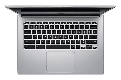

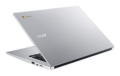

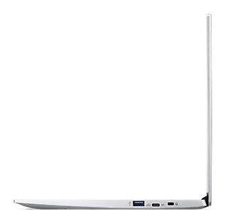

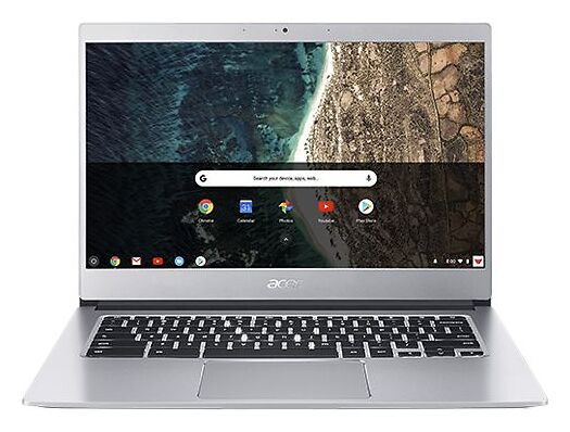

Acer Chromebook CB514-1H-C0F0 Chromebook Specification for Upgrade or Repair
    Acer Chromebook CB514-1H-C0F0 Chromebook Specification for Upgrade or Repair
    This specification for the Acer Chromebook CB514-1H-C0F0 Chromebook can be useful for upgrading or repairing a laptop that is not working. As a community we are working through our specifications to add valuable data like the CB514-1H-C0F0 boardview and CB514-1H-C0F0 schematic. Our users have donated over 1 million documents which are being added to the site. This page will be updated soon with additional information. Alternatively you can request additional help from our users directly on the relevant badcaps forum. Please note that we offer no warranties that any specification, datasheet, or download for Acer Chromebook CB514-1H-C0F0 Chromebook is accurate, safe, error free, or the fix you require.
    Design > Brand: Acer
    Design > Family: Chromebook
    Design > Model Name: CB514-1H-C0F0
    Design > Part Number: NX.H4BEH.001
    Design > Release Date: 17/12/2018
    Display > Aspect Ratio: 1.78:1
    Display > HD Type: HD
    Graphics > On-board Graphics Adapter Model: Intel HD Graphics 500
    Graphics > On-board Graphics Card ID: 0x5A85
    Specification > Battery: 3920mAh
    Specification > Graphics: Intel HD Graphics 500
    Specification > Processor: N3350 1.1GHz
    Specification > Storage: 32GB Flash
    Specification > Weight: 1.5kg
    Memory > Internal Memory: 4GB
    Processor > Processor Boost Frequency: 2.4GHz
    Processor > Processor Model: N3350
    Product Code: NX.H4BEH.001
    Battery > Battery Capacity: 3920mAh
    Ports & Interfaces > USB 3.0 (3.1 Gen 1) Type-C Ports Qty: 2
    Software > Operating System Installed: ChromeOS
    Weight And Dimensions > Depth: 232mm
    Weight And Dimensions > Height: 17mm
    Weight And Dimensions > Width: 323mm
    Acer Chromebook CB514-1H-C0F0 Chromebook Specification for Upgrade or Repair
    Acer Chromebook C771T-56G3 Chromebook 11 Specification for Upgrade or Repair
    This specification for the Acer Chromebook C771T-56G3 Chromebook can be useful for upgrading or repairing a laptop that is not working. As a community we are working through our specifications to add valuable data like the C771T-56G3 boardview and C771T-56G3 schematic. Our users have donated over 1 million documents which are being added to the site. This page will be updated soon with additional information. Alternatively you can request additional help from our users directly on the relevant badcaps forum. Please note that we offer no warranties that any specification, datasheet, or download...
    09-06-2024, 06:06 AM
    Acer Chromebook CP713-1WN-866Q Chromebook Spin 13 Specification for Upgrade or Repair
    This specification for the Acer Chromebook CP713-1WN-866Q Chromebook can be useful for upgrading or repairing a laptop that is not working. As a community we are working through our specifications to add valuable data like the CP713-1WN-866Q boardview and CP713-1WN-866Q schematic. Our users have donated over 1 million documents which are being added to the site. This page will be updated soon with additional information. Alternatively you can request additional help from our users directly on the relevant badcaps forum. Please note that we offer no warranties that any specification, datasheet,...
    09-06-2024, 07:14 AM
    Acer Chromebook CB713-1W-5549 Chromebook 13 Specification for Upgrade or Repair
    This specification for the Acer Chromebook CB713-1W-5549 Chromebook can be useful for upgrading or repairing a laptop that is not working. As a community we are working through our specifications to add valuable data like the CB713-1W-5549 boardview and CB713-1W-5549 schematic. Our users have donated over 1 million documents which are being added to the site. This page will be updated soon with additional information. Alternatively you can request additional help from our users directly on the relevant badcaps forum. Please note that we offer no warranties that any specification, datasheet, or...
    09-06-2024, 11:05 AM
    Acer Chromebook CB715-1WT-5591 Chromebook 715 Specification for Upgrade or Repair
    This specification for the Acer Chromebook CB715-1WT-5591 Chromebook can be useful for upgrading or repairing a laptop that is not working. As a community we are working through our specifications to add valuable data like the CB715-1WT-5591 boardview and CB715-1WT-5591 schematic. Our users have donated over 1 million documents which are being added to the site. This page will be updated soon with additional information. Alternatively you can request additional help from our users directly on the relevant badcaps forum. Please note that we offer no warranties that any specification, datasheet,...
    09-06-2024, 09:45 AM
    Acer Chromebook CP713-1WN-813G Chromebook Spin 13 Specification for Upgrade or Repair
    This specification for the Acer Chromebook CP713-1WN-813G Chromebook can be useful for upgrading or repairing a laptop that is not working. As a community we are working through our specifications to add valuable data like the CP713-1WN-813G boardview and CP713-1WN-813G schematic. Our users have donated over 1 million documents which are being added to the site. This page will be updated soon with additional information. Alternatively you can request additional help from our users directly on the relevant badcaps forum. Please note that we offer no warranties that any specification, datasheet,...
    09-06-2024, 09:32 AM
