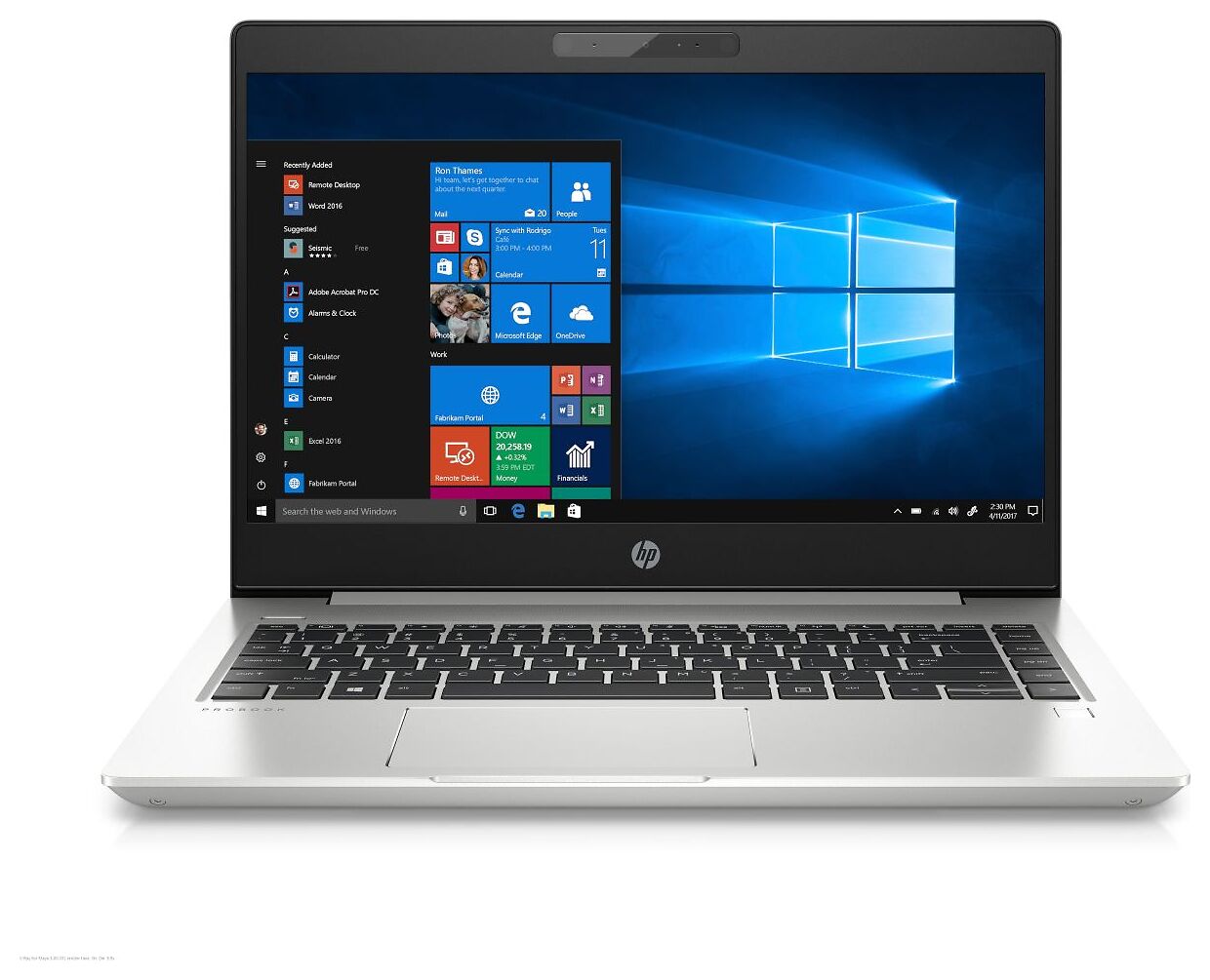

HP ProBook 440 G6 Notebook 400 Specification for Upgrade or Repair
    HP ProBook 440 G6 Notebook 400 Specification for Upgrade or Repair
    This specification for the HP ProBook 440 G6 Notebook can be useful for upgrading or repairing a laptop that is not working. As a community we are working through our specifications to add valuable data like the 440 G6 boardview and 440 G6 schematic. Our users have donated over 1 million documents which are being added to the site. This page will be updated soon with additional information. Alternatively you can request additional help from our users directly on the relevant badcaps forum. Please note that we offer no warranties that any specification, datasheet, or download for HP ProBook 440 G6 Notebook is accurate, safe, error free, or the fix you require.
    Design > Family: ProBook
    Design > Model Name: 440 G6
    Design > Part Number: 6FU34LT
    Design > Release Date: 14/12/2018
    Design > Series: 400
    Display > HD Type: HD
    Display > Panel Type: SVA
    Specification > Battery: 45 Wh
    Specification > Weight: 1.6kg
    Product Code: 6FU34LT
    Battery > Battery Capacity (Watt Hours): 45Wh
    Networking > Miracast: Yes
    Weight And Dimensions > Depth: 237.7mm
    Weight And Dimensions > Width: 324.2mm
    HP ProBook 440 G6 Notebook 400 Specification for Upgrade or Repair
    HP ProBook ProBook 440 G3 Notebook PC (ENERGY STAR) Notebook 400 Specification for Upgrade or Repair
    This specification for the HP ProBook ProBook 440 G3 Notebook PC (ENERGY STAR) Notebook can be useful for upgrading or repairing a laptop that is not working. As a community we are working through our specifications to add valuable data like the ProBook 440 G3 Notebook PC (ENERGY STAR) boardview and ProBook 440 G3 Notebook PC (ENERGY STAR) schematic. Our users have donated over 1 million documents which are being added to the site. This page will be updated soon with additional information. Alternatively you can request additional help from our users directly on the relevant badcaps forum. Please...
    09-06-2024, 05:30 AM
    HP ProBook 450 G5 Notebook 400 Specification for Upgrade or Repair
    This specification for the HP ProBook 450 G5 Notebook can be useful for upgrading or repairing a laptop that is not working. As a community we are working through our specifications to add valuable data like the 450 G5 boardview and 450 G5 schematic. Our users have donated over 1 million documents which are being added to the site. This page will be updated soon with additional information. Alternatively you can request additional help from our users directly on the relevant badcaps forum. Please note that we offer no warranties that any specification, datasheet, or download for HP ProBook 450...
    09-06-2024, 06:51 AM
    HP ProBook 640 G5 Notebook 600 Specification for Upgrade or Repair
    This specification for the HP ProBook 640 G5 Notebook can be useful for upgrading or repairing a laptop that is not working. As a community we are working through our specifications to add valuable data like the 640 G5 boardview and 640 G5 schematic. Our users have donated over 1 million documents which are being added to the site. This page will be updated soon with additional information. Alternatively you can request additional help from our users directly on the relevant badcaps forum. Please note that we offer no warranties that any specification, datasheet, or download for HP ProBook 640...
    09-06-2024, 11:14 AM
    HP ProBook 640 G5 Notebook 600 Specification for Upgrade or Repair
    This specification for the HP ProBook 640 G5 Notebook can be useful for upgrading or repairing a laptop that is not working. As a community we are working through our specifications to add valuable data like the 640 G5 boardview and 640 G5 schematic. Our users have donated over 1 million documents which are being added to the site. This page will be updated soon with additional information. Alternatively you can request additional help from our users directly on the relevant badcaps forum. Please note that we offer no warranties that any specification, datasheet, or download for HP ProBook 640...
    09-06-2024, 11:14 AM
    HP ProBook 650 G5 Notebook 600 Specification for Upgrade or Repair
    This specification for the HP ProBook 650 G5 Notebook can be useful for upgrading or repairing a laptop that is not working. As a community we are working through our specifications to add valuable data like the 650 G5 boardview and 650 G5 schematic. Our users have donated over 1 million documents which are being added to the site. This page will be updated soon with additional information. Alternatively you can request additional help from our users directly on the relevant badcaps forum. Please note that we offer no warranties that any specification, datasheet, or download for HP ProBook 650...
    09-06-2024, 11:14 AM
