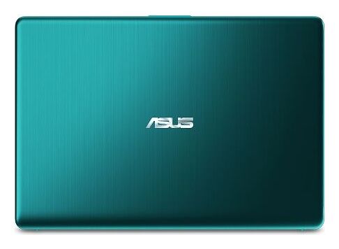

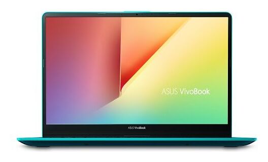

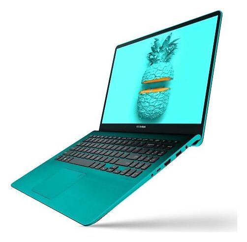

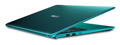

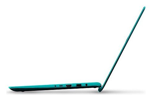

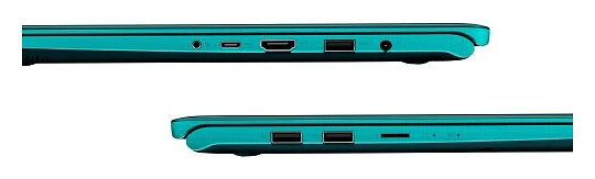

ASUS VivoBook S530UA-DB51 Notebook S15 Specification for Upgrade or Repair
    ASUS VivoBook S530UA-DB51 Notebook S15 Specification for Upgrade or Repair
    This specification for the ASUS VivoBook S530UA-DB51 Notebook can be useful for upgrading or repairing a laptop that is not working. As a community we are working through our specifications to add valuable data like the S530UA-DB51 boardview and S530UA-DB51 schematic. Our users have donated over 1 million documents which are being added to the site. This page will be updated soon with additional information. Alternatively you can request additional help from our users directly on the relevant badcaps forum. Please note that we offer no warranties that any specification, datasheet, or download for ASUS VivoBook S530UA-DB51 Notebook is accurate, safe, error free, or the fix you require.
    Design > Brand: ASUS
    Design > Family: VivoBook
    Design > Model Name: S530UA-DB51
    Design > Part Number: 90NB0I91-M00140
    Design > Product Colour: Green
    Design > Release Date: 13/12/2018
    Design > Series: S15
    Specification > Weight: 1.8kg
    Product Code: 90NB0I91-M00140
    Power > AC Adapter Output Current: 2.47A
    Weight And Dimensions > Depth: 243.5mm
    Weight And Dimensions > Width: 361.4mm
    ASUS VivoBook S530UA-DB51 Notebook S15 Specification for Upgrade or Repair
    ASUS VivoBook N580GD-E4189T Notebook Pro Specification for Upgrade or Repair
    This specification for the ASUS VivoBook N580GD-E4189T Notebook can be useful for upgrading or repairing a laptop that is not working. As a community we are working through our specifications to add valuable data like the N580GD-E4189T boardview and N580GD-E4189T schematic. Our users have donated over 1 million documents which are being added to the site. This page will be updated soon with additional information. Alternatively you can request additional help from our users directly on the relevant badcaps forum. Please note that we offer no warranties that any specification, datasheet, or download...
    09-06-2024, 07:36 AM
    ASUS VivoBook N580GD-E4189R Notebook Pro Specification for Upgrade or Repair
    This specification for the ASUS VivoBook N580GD-E4189R Notebook can be useful for upgrading or repairing a laptop that is not working. As a community we are working through our specifications to add valuable data like the N580GD-E4189R boardview and N580GD-E4189R schematic. Our users have donated over 1 million documents which are being added to the site. This page will be updated soon with additional information. Alternatively you can request additional help from our users directly on the relevant badcaps forum. Please note that we offer no warranties that any specification, datasheet, or download...
    09-06-2024, 07:36 AM
    ASUS VivoBook N580GD-E4104T Notebook Pro Specification for Upgrade or Repair
    This specification for the ASUS VivoBook N580GD-E4104T Notebook can be useful for upgrading or repairing a laptop that is not working. As a community we are working through our specifications to add valuable data like the N580GD-E4104T boardview and N580GD-E4104T schematic. Our users have donated over 1 million documents which are being added to the site. This page will be updated soon with additional information. Alternatively you can request additional help from our users directly on the relevant badcaps forum. Please note that we offer no warranties that any specification, datasheet, or download...
    09-06-2024, 08:32 AM
    ASUS VivoBook N580GD-DM230T Notebook Pro Specification for Upgrade or Repair
    This specification for the ASUS VivoBook N580GD-DM230T Notebook can be useful for upgrading or repairing a laptop that is not working. As a community we are working through our specifications to add valuable data like the N580GD-DM230T boardview and N580GD-DM230T schematic. Our users have donated over 1 million documents which are being added to the site. This page will be updated soon with additional information. Alternatively you can request additional help from our users directly on the relevant badcaps forum. Please note that we offer no warranties that any specification, datasheet, or download...
    09-06-2024, 07:02 AM
    ASUS VivoBook N580VD-DM264T Notebook Pro Specification for Upgrade or Repair
    This specification for the ASUS VivoBook N580VD-DM264T Notebook can be useful for upgrading or repairing a laptop that is not working. As a community we are working through our specifications to add valuable data like the N580VD-DM264T boardview and N580VD-DM264T schematic. Our users have donated over 1 million documents which are being added to the site. This page will be updated soon with additional information. Alternatively you can request additional help from our users directly on the relevant badcaps forum. Please note that we offer no warranties that any specification, datasheet, or download...
    09-06-2024, 06:31 AM
