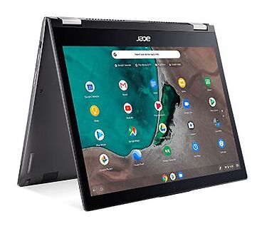

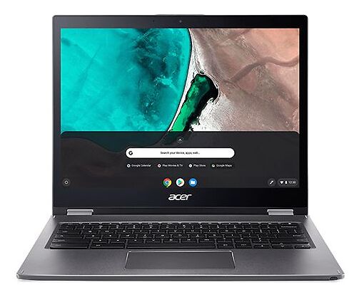

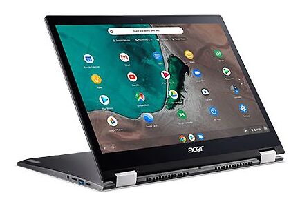

Acer Spin CP713-1WN-52TK Chromebook Specification for Upgrade or Repair
    Acer Spin CP713-1WN-52TK Chromebook Specification for Upgrade or Repair
    This specification for the Acer Spin CP713-1WN-52TK Chromebook can be useful for upgrading or repairing a laptop that is not working. As a community we are working through our specifications to add valuable data like the CP713-1WN-52TK boardview and CP713-1WN-52TK schematic. Our users have donated over 1 million documents which are being added to the site. This page will be updated soon with additional information. Alternatively you can request additional help from our users directly on the relevant badcaps forum. Please note that we offer no warranties that any specification, datasheet, or download for Acer Spin CP713-1WN-52TK Chromebook is accurate, safe, error free, or the fix you require.
    Design > Brand: Acer
    Design > Family: Spin
    Design > Model Name: CP713-1WN-52TK
    Design > Part Number: NX.EFJEZ.001
    Design > Release Date: 24/09/2018
    Display > Aspect Ratio: 0.126388889
    Display > HD Type: Quad HD
    Specification > Battery: 4670mAh
    Specification > Storage: 64GB Flash
    Specification > Weight: 1.5kg
    Product Code: NX.EFJEZ.001
    Battery > Battery Capacity: 4670mAh
    Ports & Interfaces > USB 3.0 (3.1 Gen 1) Type-C Ports Qty: 2
    Software > Operating System Installed: ChromeOS
    Weight And Dimensions > Depth: 245.8mm
    Weight And Dimensions > Height: 17mm
    Weight And Dimensions > Width: 309.5mm
    Acer Spin CP713-1WN-52TK Chromebook Specification for Upgrade or Repair
    Acer Chromebook Spin 13 CP713-1NW Chromebook Spin 13 Specification for Upgrade or Repair
    This specification for the Acer Chromebook Spin 13 CP713-1NW Chromebook can be useful for upgrading or repairing a laptop that is not working. As a community we are working through our specifications to add valuable data like the Spin 13 CP713-1NW boardview and Spin 13 CP713-1NW schematic. Our users have donated over 1 million documents which are being added to the site. This page will be updated soon with additional information. Alternatively you can request additional help from our users directly on the relevant badcaps forum. Please note that we offer no warranties that any specification, datasheet,...
    09-06-2024, 07:25 AM
    Acer Chromebook Spin 13 CP713-1NW Chromebook Spin 13 Specification for Upgrade or Repair
    This specification for the Acer Chromebook Spin 13 CP713-1NW Chromebook can be useful for upgrading or repairing a laptop that is not working. As a community we are working through our specifications to add valuable data like the Spin 13 CP713-1NW boardview and Spin 13 CP713-1NW schematic. Our users have donated over 1 million documents which are being added to the site. This page will be updated soon with additional information. Alternatively you can request additional help from our users directly on the relevant badcaps forum. Please note that we offer no warranties that any specification, datasheet,...
    09-06-2024, 07:25 AM
    Acer Chromebook Spin 13 CP713-1NW Chromebook Spin 13 Specification for Upgrade or Repair
    This specification for the Acer Chromebook Spin 13 CP713-1NW Chromebook can be useful for upgrading or repairing a laptop that is not working. As a community we are working through our specifications to add valuable data like the Spin 13 CP713-1NW boardview and Spin 13 CP713-1NW schematic. Our users have donated over 1 million documents which are being added to the site. This page will be updated soon with additional information. Alternatively you can request additional help from our users directly on the relevant badcaps forum. Please note that we offer no warranties that any specification, datasheet,...
    09-06-2024, 07:25 AM
    Acer Chromebook Spin CP713-1WN Chromebook 13 Specification for Upgrade or Repair
    This specification for the Acer Chromebook Spin CP713-1WN Chromebook can be useful for upgrading or repairing a laptop that is not working. As a community we are working through our specifications to add valuable data like the Spin CP713-1WN boardview and Spin CP713-1WN schematic. Our users have donated over 1 million documents which are being added to the site. This page will be updated soon with additional information. Alternatively you can request additional help from our users directly on the relevant badcaps forum. Please note that we offer no warranties that any specification, datasheet,...
    09-06-2024, 07:25 AM
    Acer Chromebook Spin 512 R851TN-P5FV Chromebook Spin 512 Specification for Upgrade or Repair
    This specification for the Acer Chromebook Spin 512 R851TN-P5FV Chromebook can be useful for upgrading or repairing a laptop that is not working. As a community we are working through our specifications to add valuable data like the Spin 512 R851TN-P5FV boardview and Spin 512 R851TN-P5FV schematic. Our users have donated over 1 million documents which are being added to the site. This page will be updated soon with additional information. Alternatively you can request additional help from our users directly on the relevant badcaps forum. Please note that we offer no warranties that any specification,...
    09-06-2024, 08:47 AM
