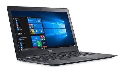

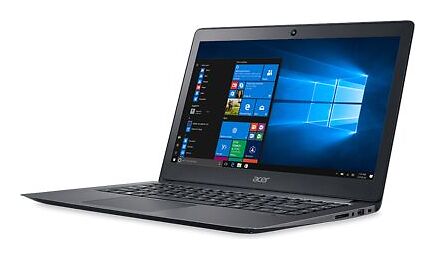

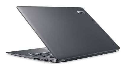

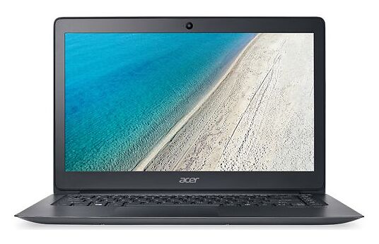

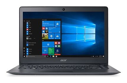

Acer TravelMate TMX3410-M-50AR Notebook X3 Specification for Upgrade or Repair
    Acer TravelMate TMX3410-M-50AR Notebook X3 Specification for Upgrade or Repair
    This specification for the Acer TravelMate TMX3410-M-50AR Notebook can be useful for upgrading or repairing a laptop that is not working. As a community we are working through our specifications to add valuable data like the TMX3410-M-50AR boardview and TMX3410-M-50AR schematic. Our users have donated over 1 million documents which are being added to the site. This page will be updated soon with additional information. Alternatively you can request additional help from our users directly on the relevant badcaps forum. Please note that we offer no warranties that any specification, datasheet, or download for Acer TravelMate TMX3410-M-50AR Notebook is accurate, safe, error free, or the fix you require.
    Design > Brand: Acer
    Design > Family: TravelMate
    Design > Model Name: TMX3410-M-50AR
    Design > Part Number: NX.VHJEG.004
    Design > Release Date: 15/07/2018
    Design > Series: X3
    Specification > Battery: 5170mAh
    Specification > Weight: 1.6kg
    Product Code: NX.VHJEG.004
    Battery > Battery Capacity: 5170mAh
    Weight And Dimensions > Depth: 238mm
    Acer TravelMate TMX3410-M-50AR Notebook X3 Specification for Upgrade or Repair
    Acer TravelMate P2410-M-562N Notebook P2 Specification for Upgrade or Repair
    This specification for the Acer TravelMate P2410-M-562N Notebook can be useful for upgrading or repairing a laptop that is not working. As a community we are working through our specifications to add valuable data like the P2410-M-562N boardview and P2410-M-562N schematic. Our users have donated over 1 million documents which are being added to the site. This page will be updated soon with additional information. Alternatively you can request additional help from our users directly on the relevant badcaps forum. Please note that we offer no warranties that any specification, datasheet, or download...
    09-06-2024, 06:10 AM
    Acer TravelMate P276-MG-54G7 Notebook P2 Specification for Upgrade or Repair
    This specification for the Acer TravelMate P276-MG-54G7 Notebook can be useful for upgrading or repairing a laptop that is not working. As a community we are working through our specifications to add valuable data like the P276-MG-54G7 boardview and P276-MG-54G7 schematic. Our users have donated over 1 million documents which are being added to the site. This page will be updated soon with additional information. Alternatively you can request additional help from our users directly on the relevant badcaps forum. Please note that we offer no warranties that any specification, datasheet, or download...
    09-06-2024, 05:27 AM
    Acer TravelMate P276-MG-745A Notebook P2 Specification for Upgrade or Repair
    This specification for the Acer TravelMate P276-MG-745A Notebook can be useful for upgrading or repairing a laptop that is not working. As a community we are working through our specifications to add valuable data like the P276-MG-745A boardview and P276-MG-745A schematic. Our users have donated over 1 million documents which are being added to the site. This page will be updated soon with additional information. Alternatively you can request additional help from our users directly on the relevant badcaps forum. Please note that we offer no warranties that any specification, datasheet, or download...
    09-06-2024, 05:27 AM
    Acer TravelMate P2510-G2-MG-50VW Notebook P2 Specification for Upgrade or Repair
    This specification for the Acer TravelMate P2510-G2-MG-50VW Notebook can be useful for upgrading or repairing a laptop that is not working. As a community we are working through our specifications to add valuable data like the P2510-G2-MG-50VW boardview and P2510-G2-MG-50VW schematic. Our users have donated over 1 million documents which are being added to the site. This page will be updated soon with additional information. Alternatively you can request additional help from our users directly on the relevant badcaps forum. Please note that we offer no warranties that any specification, datasheet,...
    09-06-2024, 07:50 AM
    Acer TravelMate P259-G2-MG-57K1 Notebook P2 Specification for Upgrade or Repair
    This specification for the Acer TravelMate P259-G2-MG-57K1 Notebook can be useful for upgrading or repairing a laptop that is not working. As a community we are working through our specifications to add valuable data like the P259-G2-MG-57K1 boardview and P259-G2-MG-57K1 schematic. Our users have donated over 1 million documents which are being added to the site. This page will be updated soon with additional information. Alternatively you can request additional help from our users directly on the relevant badcaps forum. Please note that we offer no warranties that any specification, datasheet,...
    09-06-2024, 05:54 AM
