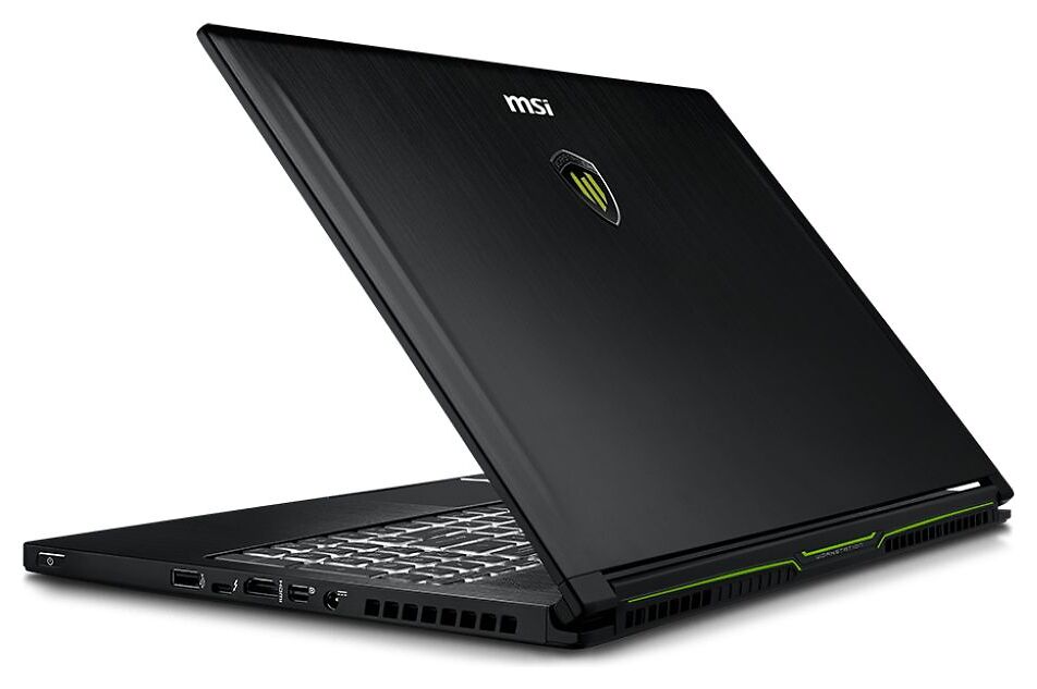

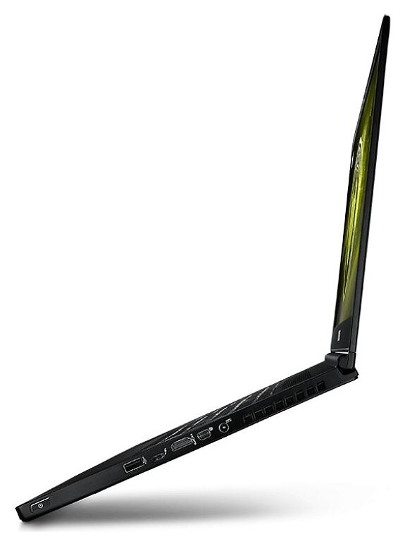

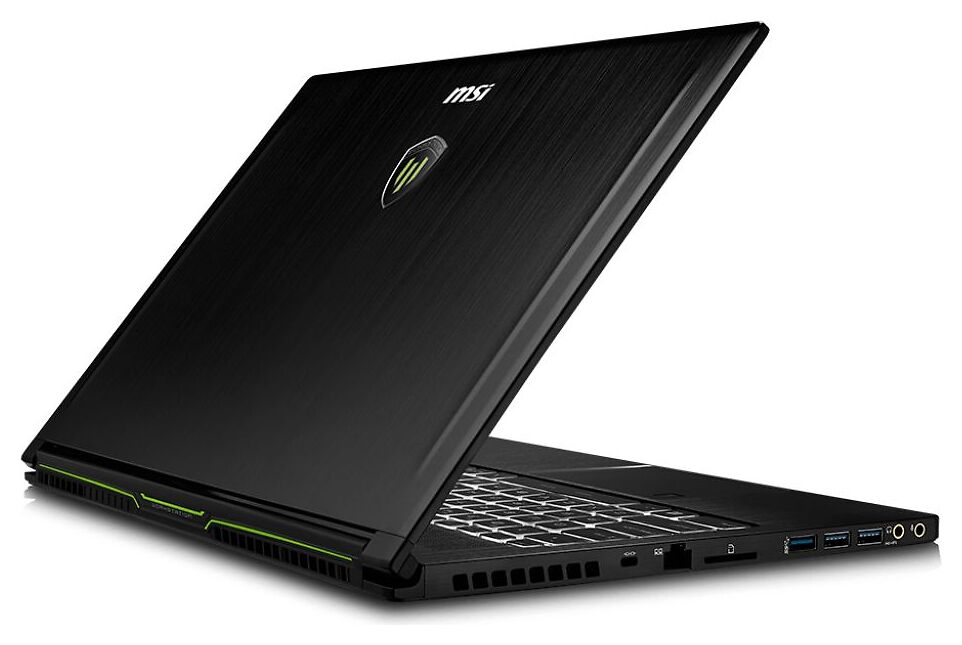

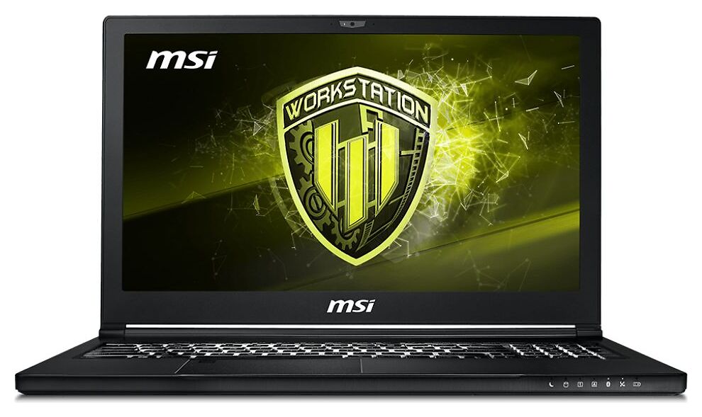

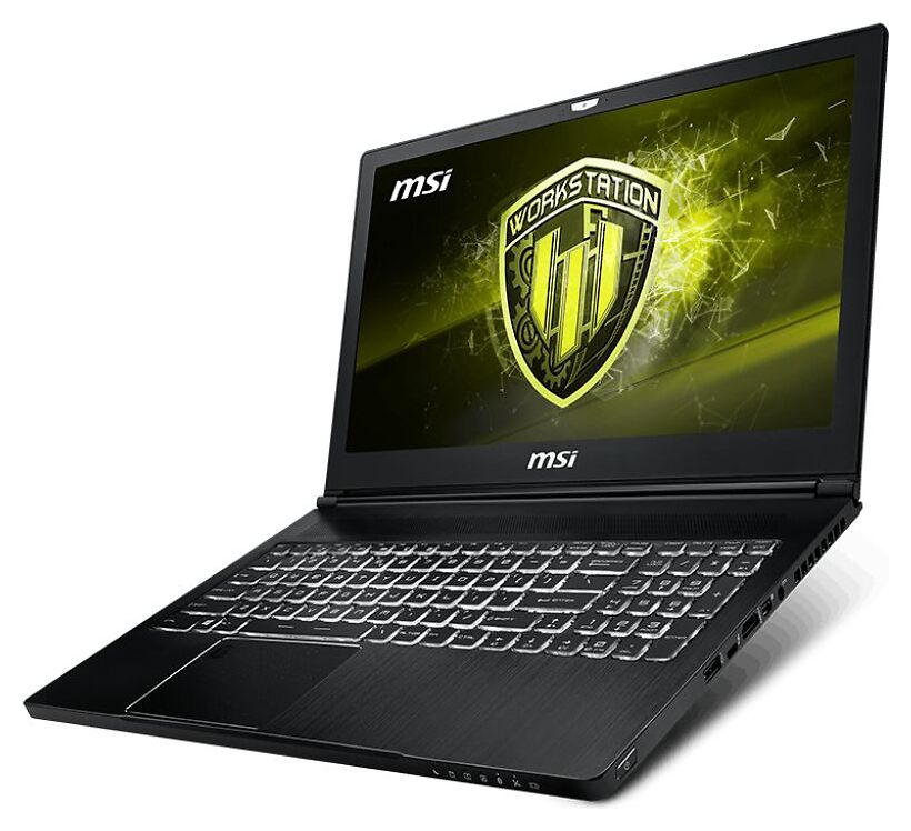

MSI Workstation WS63 8SL-013ES Mobile workstation WS63 Specification for Upgrade or Repair
    • 115471
    MSI Workstation WS63 8SL-013ES Mobile workstation WS63 Specification for Upgrade or Repair
    This specification for the MSI Workstation WS63 8SL-013ES Mobile workstation can be useful for upgrading or repairing a laptop that is not working. As a community we are working through our specifications to add valuable data like the WS63 8SL-013ES boardview and WS63 8SL-013ES schematic. Our users have donated over 1 million documents which are being added to the site. This page will be updated soon with additional information. Alternatively you can request additional help from our users directly on the relevant badcaps forum. Please note that we offer no warranties that any specification, datasheet, or download for MSI Workstation WS63 8SL-013ES Mobile workstation is accurate, safe, error free, or the fix you require.
    Design > Brand: MSI
    Design > Family: Workstation
    Design > Market Positioning: High performance
    Design > Model Name: WS63 8SL-013ES
    Design > Part Number: 9S7-16K722-013
    Design > Release Date: 24/05/2018
    Design > Series: WS63
    Display > 3D: No
    Graphics > CUDA: Yes
    Graphics > Discrete Graphics Adapter Model: NVIDIA Quadro P4200
    Graphics > Discrete Graphics Card Model: NVIDIA Quadro P4200
    Specification > Battery: 51 Wh
    Specification > Processor: i7-8850H 2.6GHz
    Specification > Weight: 1.89kg
    Processor > Processor Boost Frequency: 4.3GHz
    Processor > Processor Model: i7-8850H
    Product Code: 9S7-16K722-013
    Battery > Battery Capacity: 51 Wh
    Battery > Battery Capacity (Watt Hours): 51Wh
    Weight And Dimensions > Depth: 249mm
    Weight And Dimensions > Height: 17.7mm
    Weight And Dimensions > Weight: 1.89kg
    MSI Workstation WS63 8SL-013ES Mobile workstation WS63 Specification for Upgrade or Repair
    MSI Workstation WS63 8SJ-061XES Mobile workstation WS63 Specification for Upgrade or Repair
    This specification for the MSI Workstation WS63 8SJ-061XES Mobile workstation can be useful for upgrading or repairing a laptop that is not working. As a community we are working through our specifications to add valuable data like the WS63 8SJ-061XES boardview and WS63 8SJ-061XES schematic. Our users have donated over 1 million documents which are being added to the site. This page will be updated soon with additional information. Alternatively you can request additional help from our users directly on the relevant badcaps forum. Please note that we offer no warranties that any specification,...
    09-06-2024, 07:46 AM
    MSI Workstation WS63 8SK-054FR Mobile workstation WS63 Specification for Upgrade or Repair
    This specification for the MSI Workstation WS63 8SK-054FR Mobile workstation can be useful for upgrading or repairing a laptop that is not working. As a community we are working through our specifications to add valuable data like the WS63 8SK-054FR boardview and WS63 8SK-054FR schematic. Our users have donated over 1 million documents which are being added to the site. This page will be updated soon with additional information. Alternatively you can request additional help from our users directly on the relevant badcaps forum. Please note that we offer no warranties that any specification, datasheet,...
    09-06-2024, 07:29 AM
    MSI Workstation WS63 8SJ-013XES Mobile workstation WS63 Specification for Upgrade or Repair
    This specification for the MSI Workstation WS63 8SJ-013XES Mobile workstation can be useful for upgrading or repairing a laptop that is not working. As a community we are working through our specifications to add valuable data like the WS63 8SJ-013XES boardview and WS63 8SJ-013XES schematic. Our users have donated over 1 million documents which are being added to the site. This page will be updated soon with additional information. Alternatively you can request additional help from our users directly on the relevant badcaps forum. Please note that we offer no warranties that any specification,...
    09-06-2024, 06:51 AM
    MSI Workstation WS63 8SK-083FR Mobile workstation WS63 Specification for Upgrade or Repair
    This specification for the MSI Workstation WS63 8SK-083FR Mobile workstation can be useful for upgrading or repairing a laptop that is not working. As a community we are working through our specifications to add valuable data like the WS63 8SK-083FR boardview and WS63 8SK-083FR schematic. Our users have donated over 1 million documents which are being added to the site. This page will be updated soon with additional information. Alternatively you can request additional help from our users directly on the relevant badcaps forum. Please note that we offer no warranties that any specification, datasheet,...
    09-06-2024, 09:32 AM
    MSI Workstation WS63 8SJ-042FR Mobile workstation WS63 Specification for Upgrade or Repair
    This specification for the MSI Workstation WS63 8SJ-042FR Mobile workstation can be useful for upgrading or repairing a laptop that is not working. As a community we are working through our specifications to add valuable data like the WS63 8SJ-042FR boardview and WS63 8SJ-042FR schematic. Our users have donated over 1 million documents which are being added to the site. This page will be updated soon with additional information. Alternatively you can request additional help from our users directly on the relevant badcaps forum. Please note that we offer no warranties that any specification, datasheet,...
    09-06-2024, 07:29 AM
