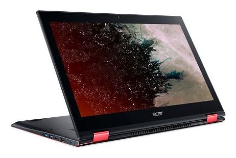

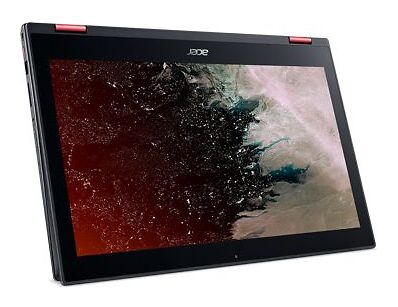

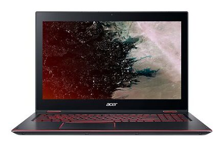

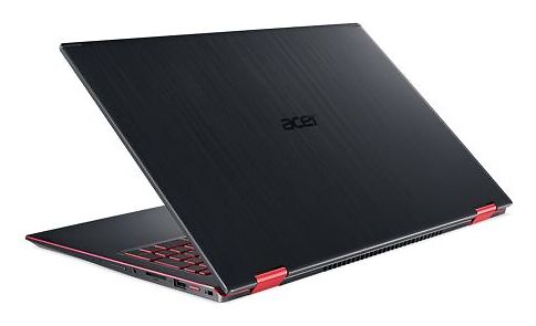

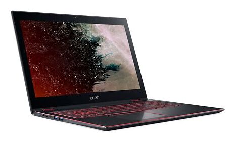

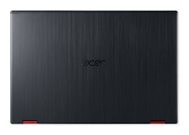

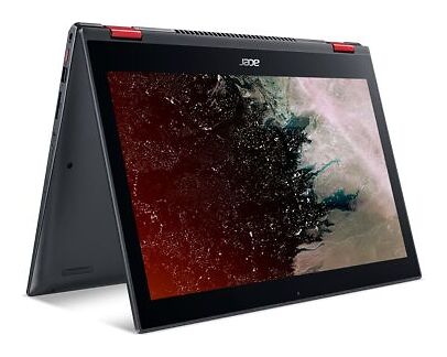

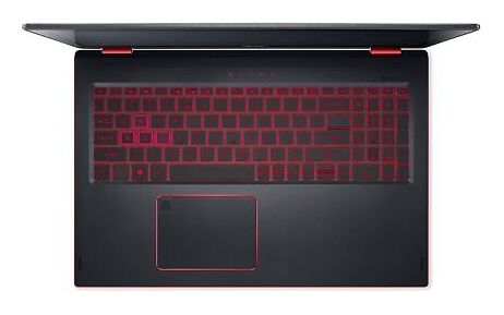

Acer Nitro NP515-51-84FZ Hybrid (2-in-1) 5 Spin Specification for Upgrade or Repair
    Acer Nitro NP515-51-84FZ Hybrid (2-in-1) 5 Spin Specification for Upgrade or Repair
    This specification for the Acer Nitro NP515-51-84FZ Hybrid (2-in-1) can be useful for upgrading or repairing a laptop that is not working. As a community we are working through our specifications to add valuable data like the NP515-51-84FZ boardview and NP515-51-84FZ schematic. Our users have donated over 1 million documents which are being added to the site. This page will be updated soon with additional information. Alternatively you can request additional help from our users directly on the relevant badcaps forum. Please note that we offer no warranties that any specification, datasheet, or download for Acer Nitro NP515-51-84FZ Hybrid (2-in-1) is accurate, safe, error free, or the fix you require.
    Design > Brand: Acer
    Design > Family: Nitro
    Design > Model Name: NP515-51-84FZ
    Design > Part Number: NH.Q2YEC.002
    Design > Release Date: 30/04/2018
    Design > Series: 5 Spin
    Specification > Battery: 3320mAh
    Specification > Storage: 2512GB HDD+SSD
    Specification > Weight: 2.2kg
    Product Code: NH.Q2YEC.002
    Battery > Battery Capacity: 3320mAh
    Power > AC Adapter Power: 90W
    Storage > Compatible Memory Cards: SD, SDXC
    Storage > HDD Interface: SATA
    Storage > Total HDDs Capacity: 2000GB
    Storage > Total Storage Capacity: 2512GB
    Weight And Dimensions > Depth: 258.1mm
    Weight And Dimensions > Height (front): 1.79 cm
    Weight And Dimensions > Height (rear): 1.79 cm
    Weight And Dimensions > Width: 381.5mm
    Acer Nitro NP515-51-84FZ Hybrid (2-in-1) 5 Spin Specification for Upgrade or Repair
    Acer Nitro NP515-51-88MT Hybrid (2-in-1) 5 Spin Specification for Upgrade or Repair
    This specification for the Acer Nitro NP515-51-88MT Hybrid (2-in-1) can be useful for upgrading or repairing a laptop that is not working. As a community we are working through our specifications to add valuable data like the NP515-51-88MT boardview and NP515-51-88MT schematic. Our users have donated over 1 million documents which are being added to the site. This page will be updated soon with additional information. Alternatively you can request additional help from our users directly on the relevant badcaps forum. Please note that we offer no warranties that any specification, datasheet, or...
    09-06-2024, 07:29 AM
    Acer Nitro NP515-51-80XS Hybrid (2-in-1) 5 Spin Specification for Upgrade or Repair
    This specification for the Acer Nitro NP515-51-80XS Hybrid (2-in-1) can be useful for upgrading or repairing a laptop that is not working. As a community we are working through our specifications to add valuable data like the NP515-51-80XS boardview and NP515-51-80XS schematic. Our users have donated over 1 million documents which are being added to the site. This page will be updated soon with additional information. Alternatively you can request additional help from our users directly on the relevant badcaps forum. Please note that we offer no warranties that any specification, datasheet, or...
    09-06-2024, 06:06 AM
    Acer Nitro NP515-51-8885 Hybrid (2-in-1) 5 Spin Specification for Upgrade or Repair
    This specification for the Acer Nitro NP515-51-8885 Hybrid (2-in-1) can be useful for upgrading or repairing a laptop that is not working. As a community we are working through our specifications to add valuable data like the NP515-51-8885 boardview and NP515-51-8885 schematic. Our users have donated over 1 million documents which are being added to the site. This page will be updated soon with additional information. Alternatively you can request additional help from our users directly on the relevant badcaps forum. Please note that we offer no warranties that any specification, datasheet, or...
    09-06-2024, 07:30 AM
    Acer Nitro NP515-51-87UB Hybrid (2-in-1) 5 Spin Specification for Upgrade or Repair
    This specification for the Acer Nitro NP515-51-87UB Hybrid (2-in-1) can be useful for upgrading or repairing a laptop that is not working. As a community we are working through our specifications to add valuable data like the NP515-51-87UB boardview and NP515-51-87UB schematic. Our users have donated over 1 million documents which are being added to the site. This page will be updated soon with additional information. Alternatively you can request additional help from our users directly on the relevant badcaps forum. Please note that we offer no warranties that any specification, datasheet, or...
    09-06-2024, 07:29 AM
    Acer Nitro NP515-51-53H2 Hybrid (2-in-1) 5 Spin Specification for Upgrade or Repair
    This specification for the Acer Nitro NP515-51-53H2 Hybrid (2-in-1) can be useful for upgrading or repairing a laptop that is not working. As a community we are working through our specifications to add valuable data like the NP515-51-53H2 boardview and NP515-51-53H2 schematic. Our users have donated over 1 million documents which are being added to the site. This page will be updated soon with additional information. Alternatively you can request additional help from our users directly on the relevant badcaps forum. Please note that we offer no warranties that any specification, datasheet, or...
    09-06-2024, 06:51 AM
