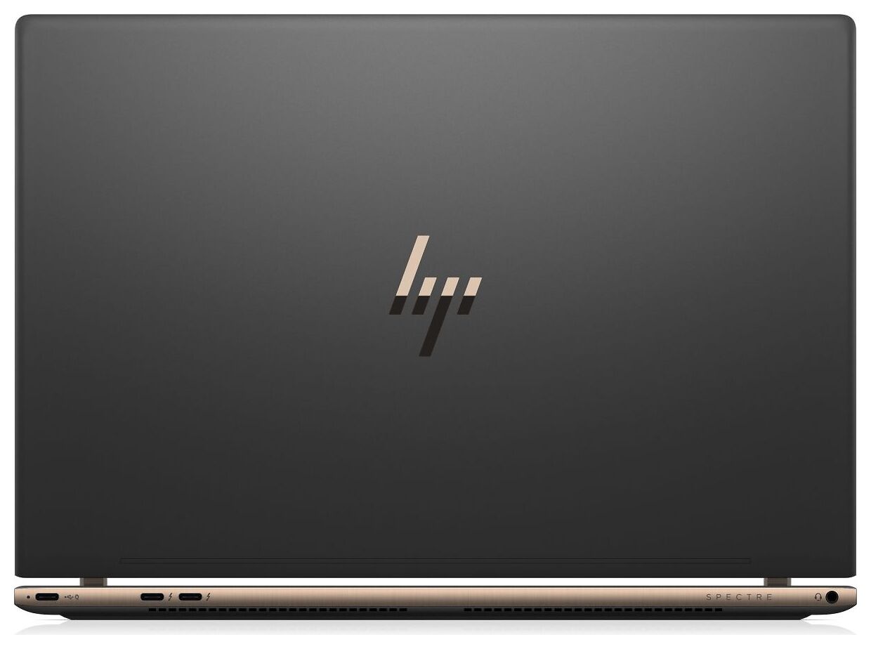

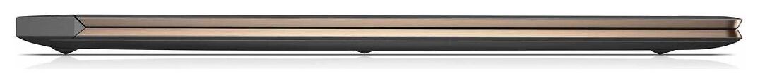

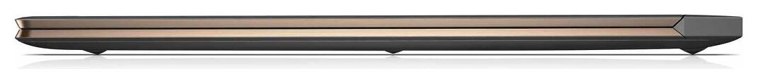

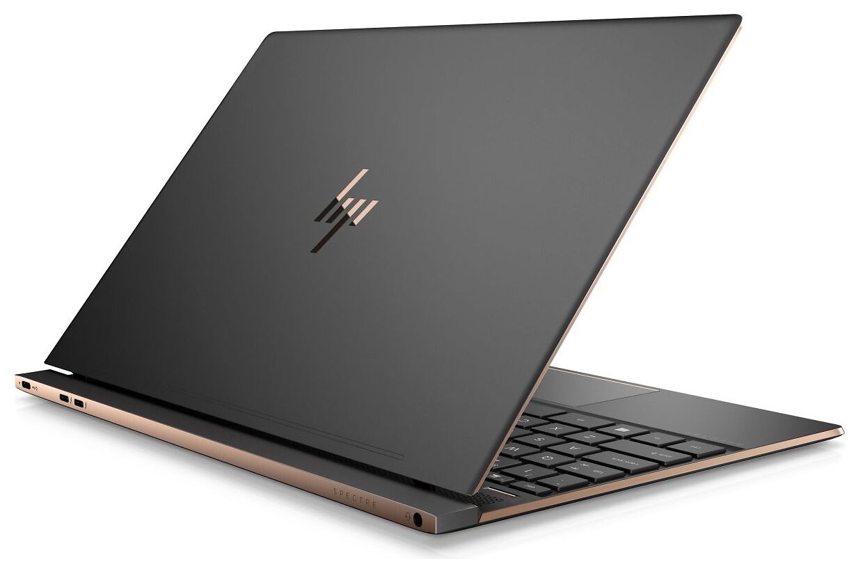

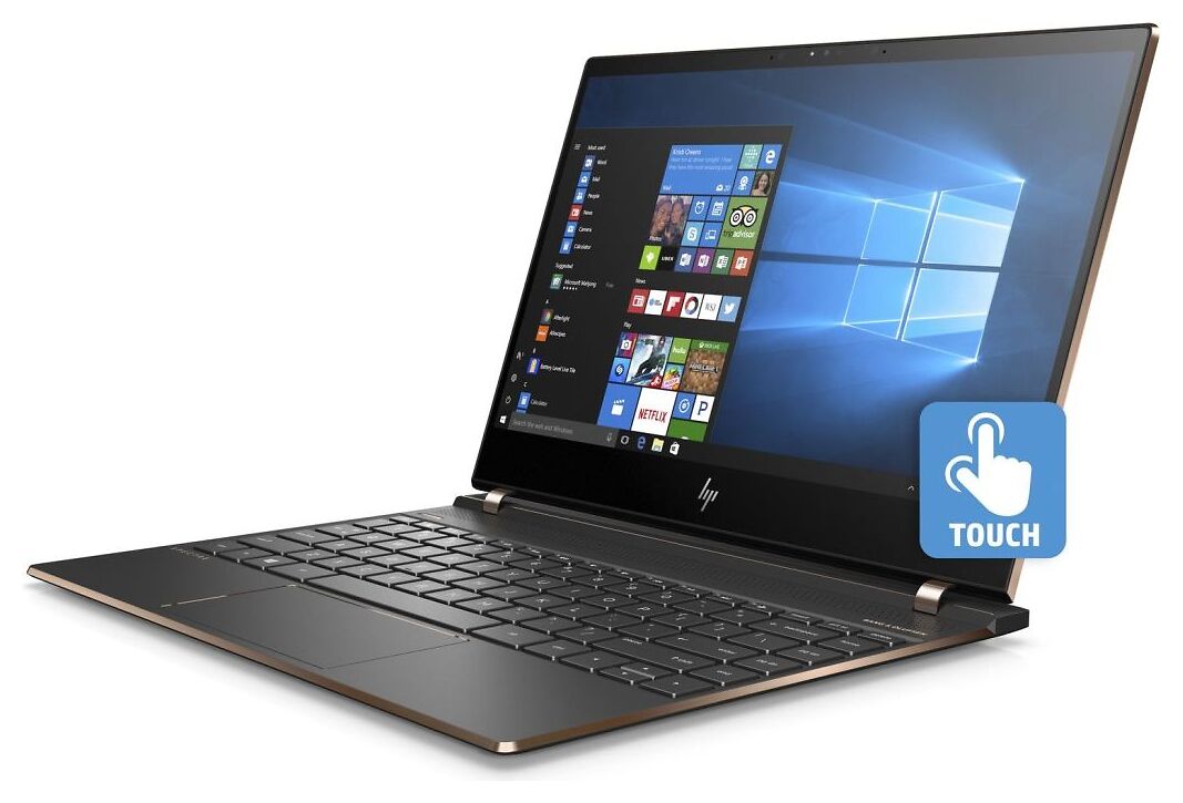

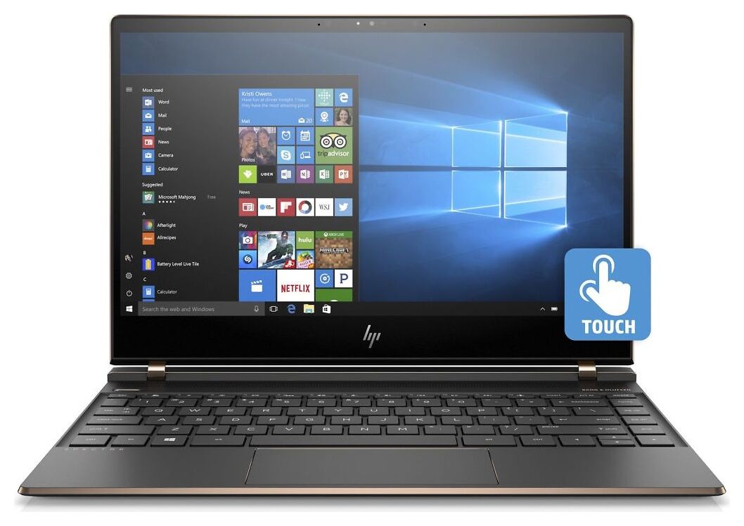

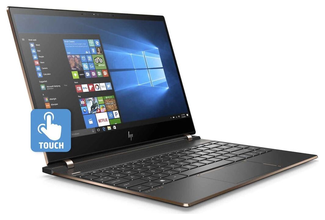

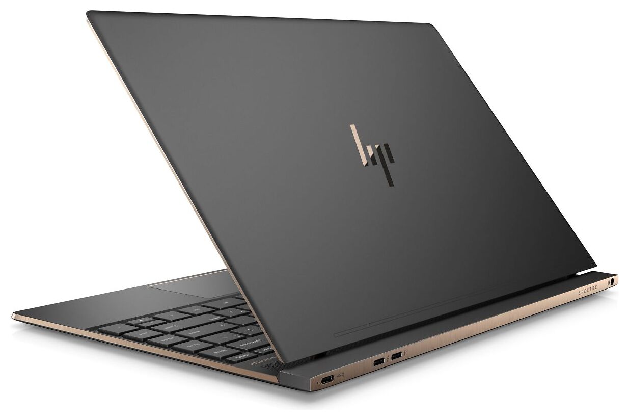

HP Spectre 13-af005nd Notebook 13 Specification for Upgrade or Repair
    HP Spectre 13-af005nd Notebook 13 Specification for Upgrade or Repair
    This specification for the HP Spectre 13-af005nd Notebook can be useful for upgrading or repairing a laptop that is not working. As a community we are working through our specifications to add valuable data like the 13-af005nd boardview and 13-af005nd schematic. Our users have donated over 1 million documents which are being added to the site. This page will be updated soon with additional information. Alternatively you can request additional help from our users directly on the relevant badcaps forum. Please note that we offer no warranties that any specification, datasheet, or download for HP Spectre 13-af005nd Notebook is accurate, safe, error free, or the fix you require.
    Design > Family: Spectre
    Design > Model Name: 13-af005nd
    Design > Part Number: 3RQ58EA#ABH
    Design > Release Date: 16/03/2018
    Design > Series: 13
    Specification > Battery: 43.7 Wh
    Specification > Weight: 1.11kg
    Product Code: 3RQ58EA#ABH
    Battery > Battery Capacity: 43.7 Wh
    Battery > Battery Capacity (Watt Hours): 43.7Wh
    Networking > Wi-Fi Standards: Wi-Fi 5 (802.11ac), 802.11b, 802.11g, Wi-Fi 4 (802.11n)
    Weight And Dimensions > Depth: 224.2mm
    Weight And Dimensions > Height: 10.4mm
    Weight And Dimensions > Weight: 1.11kg
    Weight And Dimensions > Width: 308.2mm
    HP Spectre 13-af005nd Notebook 13 Specification for Upgrade or Repair
    HP Spectre x360 Spectre x360 - 15-ch050na Hybrid (2-in-1) 15 Specification for Upgrade or Repair
    This specification for the HP Spectre x360 Spectre x360 - 15-ch050na Hybrid (2-in-1) can be useful for upgrading or repairing a laptop that is not working. As a community we are working through our specifications to add valuable data like the Spectre x360 - 15-ch050na boardview and Spectre x360 - 15-ch050na schematic. Our users have donated over 1 million documents which are being added to the site. This page will be updated soon with additional information. Alternatively you can request additional help from our users directly on the relevant badcaps forum. Please note that we offer no warranties...
    09-06-2024, 06:21 AM
    HP ProBook 450 G6 + Spectre Tech Tote Notebook 400 Specification for Upgrade or Repair
    This specification for the HP ProBook 450 G6 + Spectre Tech Tote Notebook can be useful for upgrading or repairing a laptop that is not working. As a community we are working through our specifications to add valuable data like the 450 G6 + Spectre Tech Tote boardview and 450 G6 + Spectre Tech Tote schematic. Our users have donated over 1 million documents which are being added to the site. This page will be updated soon with additional information. Alternatively you can request additional help from our users directly on the relevant badcaps forum. Please note that we offer no warranties that...
    09-06-2024, 10:51 AM
    HP Spectre Spectre 13-af033ng Notebook 13 Specification for Upgrade or Repair
    This specification for the HP Spectre Spectre 13-af033ng Notebook can be useful for upgrading or repairing a laptop that is not working. As a community we are working through our specifications to add valuable data like the Spectre 13-af033ng boardview and Spectre 13-af033ng schematic. Our users have donated over 1 million documents which are being added to the site. This page will be updated soon with additional information. Alternatively you can request additional help from our users directly on the relevant badcaps forum. Please note that we offer no warranties that any specification, datasheet,...
    09-06-2024, 06:08 AM
    HP Spectre Spectre Pro 13 G1 Notebook PC Notebook 13 Specification for Upgrade or Repair
    This specification for the HP Spectre Spectre Pro 13 G1 Notebook PC Notebook can be useful for upgrading or repairing a laptop that is not working. As a community we are working through our specifications to add valuable data like the Spectre Pro 13 G1 Notebook PC boardview and Spectre Pro 13 G1 Notebook PC schematic. Our users have donated over 1 million documents which are being added to the site. This page will be updated soon with additional information. Alternatively you can request additional help from our users directly on the relevant badcaps forum. Please note that we offer no warranties...
    09-06-2024, 05:30 AM
    HP Spectre x360 13-ap0130tu Hybrid (2-in-1) 13 Specification for Upgrade or Repair
    This specification for the HP Spectre x360 13-ap0130tu Hybrid (2-in-1) can be useful for upgrading or repairing a laptop that is not working. As a community we are working through our specifications to add valuable data like the 13-ap0130tu boardview and 13-ap0130tu schematic. Our users have donated over 1 million documents which are being added to the site. This page will be updated soon with additional information. Alternatively you can request additional help from our users directly on the relevant badcaps forum. Please note that we offer no warranties that any specification, datasheet, or...
    09-06-2024, 08:32 AM
