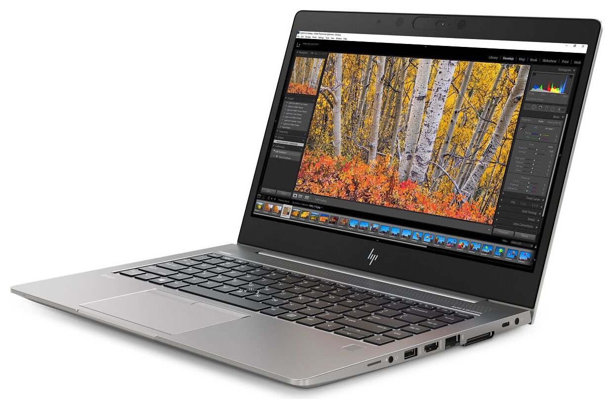

HP ZBook 14u G5 Notebook 14u Specification for Upgrade or Repair
    HP ZBook 14u G5 Notebook 14u Specification for Upgrade or Repair
    This specification for the HP ZBook 14u G5 Notebook can be useful for upgrading or repairing a laptop that is not working. As a community we are working through our specifications to add valuable data like the 14u G5 boardview and 14u G5 schematic. Our users have donated over 1 million documents which are being added to the site. This page will be updated soon with additional information. Alternatively you can request additional help from our users directly on the relevant badcaps forum. Please note that we offer no warranties that any specification, datasheet, or download for HP ZBook 14u G5 Notebook is accurate, safe, error free, or the fix you require.
    Design > Family: ZBook
    Design > Model Name: 14u G5
    Design > Part Number: 2ZB99ET#ABH
    Design > Price: 2014USD
    Design > Release Date: 03/02/2018
    Design > Series: 14u
    Specification > Battery: 10 hrs 50 Wh
    Product Code: 2ZB99ET#ABH
    Battery > Battery Capacity (Watt Hours): 50Wh
    Weight And Dimensions > Depth: 234.3mm
    HP ZBook 14u G5 Notebook 14u Specification for Upgrade or Repair
    HP ZBook Workstation ZBook 15 G3 Mobile workstation 15 Specification for Upgrade or Repair
    This specification for the HP ZBook Workstation ZBook 15 G3 Mobile workstation can be useful for upgrading or repairing a laptop that is not working. As a community we are working through our specifications to add valuable data like the Workstation ZBook 15 G3 boardview and Workstation ZBook 15 G3 schematic. Our users have donated over 1 million documents which are being added to the site. This page will be updated soon with additional information. Alternatively you can request additional help from our users directly on the relevant badcaps forum. Please note that we offer no warranties that any...
    09-06-2024, 08:20 AM
    HP ZBook ZBook 15u G3 Mobile Workstation Mobile workstation 15 Specification for Upgrade or Repair
    This specification for the HP ZBook ZBook 15u G3 Mobile Workstation Mobile workstation can be useful for upgrading or repairing a laptop that is not working. As a community we are working through our specifications to add valuable data like the ZBook 15u G3 Mobile Workstation boardview and ZBook 15u G3 Mobile Workstation schematic. Our users have donated over 1 million documents which are being added to the site. This page will be updated soon with additional information. Alternatively you can request additional help from our users directly on the relevant badcaps forum. Please note that we offer...
    09-06-2024, 05:30 AM
    HP ZBook Workstation ZBook 17 G3 Mobile workstation 17 Specification for Upgrade or Repair
    This specification for the HP ZBook Workstation ZBook 17 G3 Mobile workstation can be useful for upgrading or repairing a laptop that is not working. As a community we are working through our specifications to add valuable data like the Workstation ZBook 17 G3 boardview and Workstation ZBook 17 G3 schematic. Our users have donated over 1 million documents which are being added to the site. This page will be updated soon with additional information. Alternatively you can request additional help from our users directly on the relevant badcaps forum. Please note that we offer no warranties that any...
    09-06-2024, 08:20 AM
    HP ZBook Studio G5 Mobile workstation Studio Specification for Upgrade or Repair
    This specification for the HP ZBook Studio G5 Mobile workstation can be useful for upgrading or repairing a laptop that is not working. As a community we are working through our specifications to add valuable data like the Studio G5 boardview and Studio G5 schematic. Our users have donated over 1 million documents which are being added to the site. This page will be updated soon with additional information. Alternatively you can request additional help from our users directly on the relevant badcaps forum. Please note that we offer no warranties that any specification, datasheet, or download for...
    09-06-2024, 08:23 AM
    HP ZBook ZBook 14u G6 Mobile Workstation Mobile workstation 14u Specification for Upgrade or Repair
    This specification for the HP ZBook ZBook 14u G6 Mobile Workstation Mobile workstation can be useful for upgrading or repairing a laptop that is not working. As a community we are working through our specifications to add valuable data like the ZBook 14u G6 Mobile Workstation boardview and ZBook 14u G6 Mobile Workstation schematic. Our users have donated over 1 million documents which are being added to the site. This page will be updated soon with additional information. Alternatively you can request additional help from our users directly on the relevant badcaps forum. Please note that we offer...
    09-06-2024, 09:10 AM
