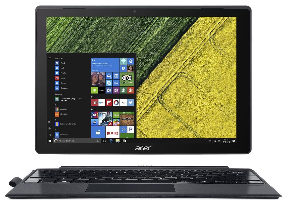

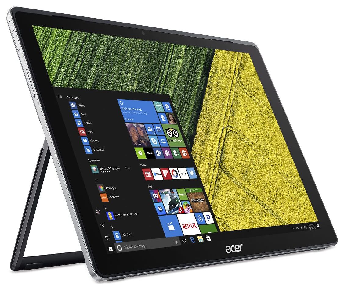

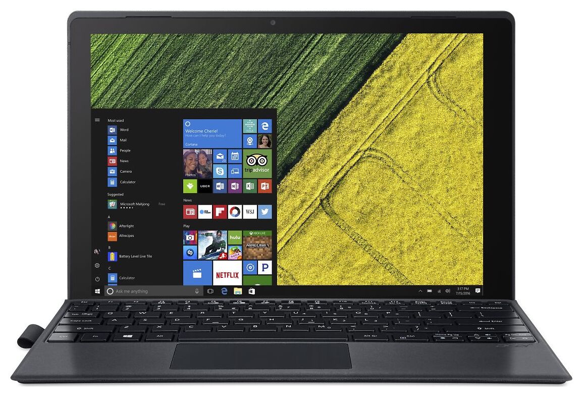

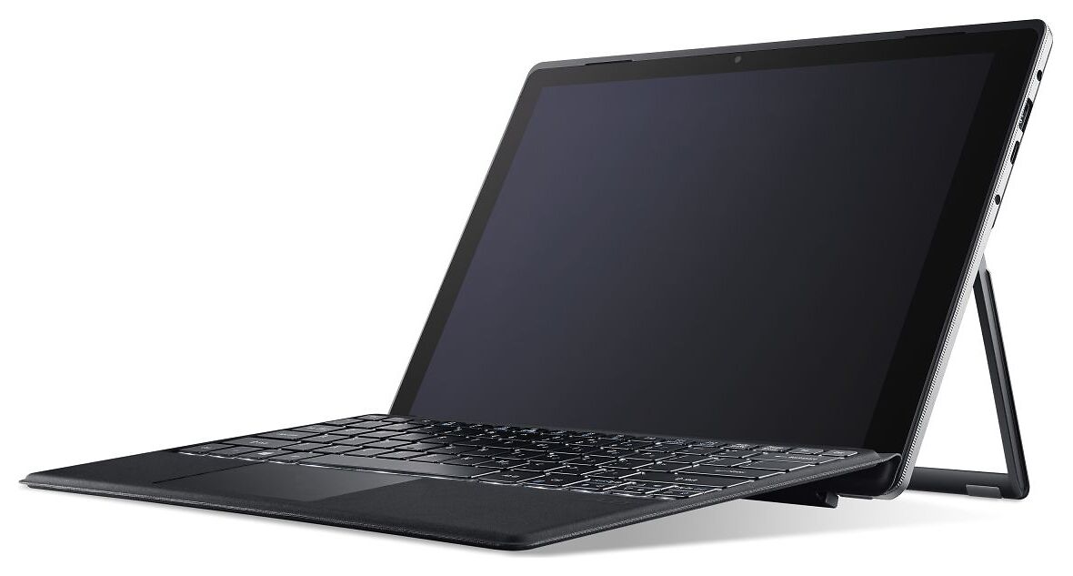

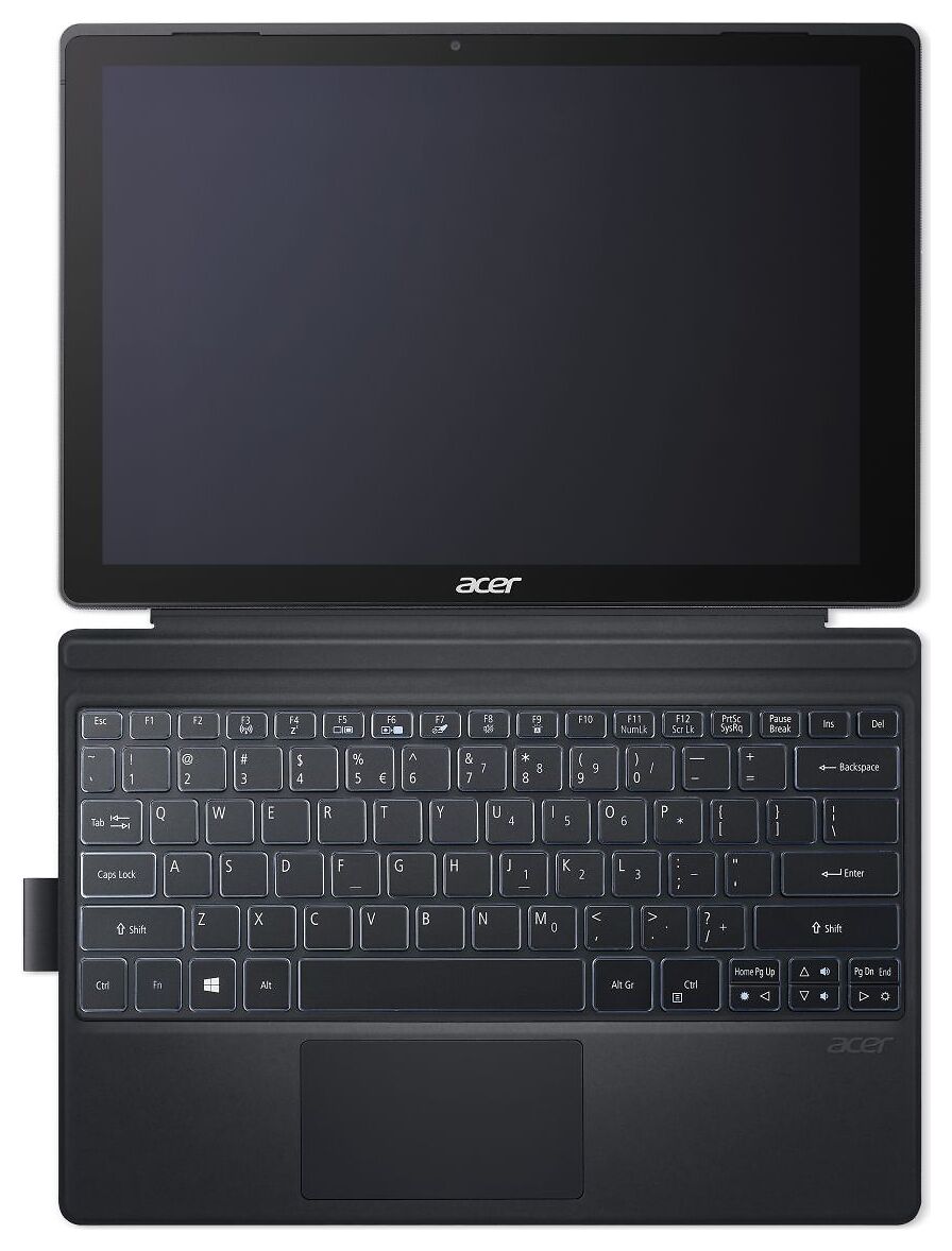

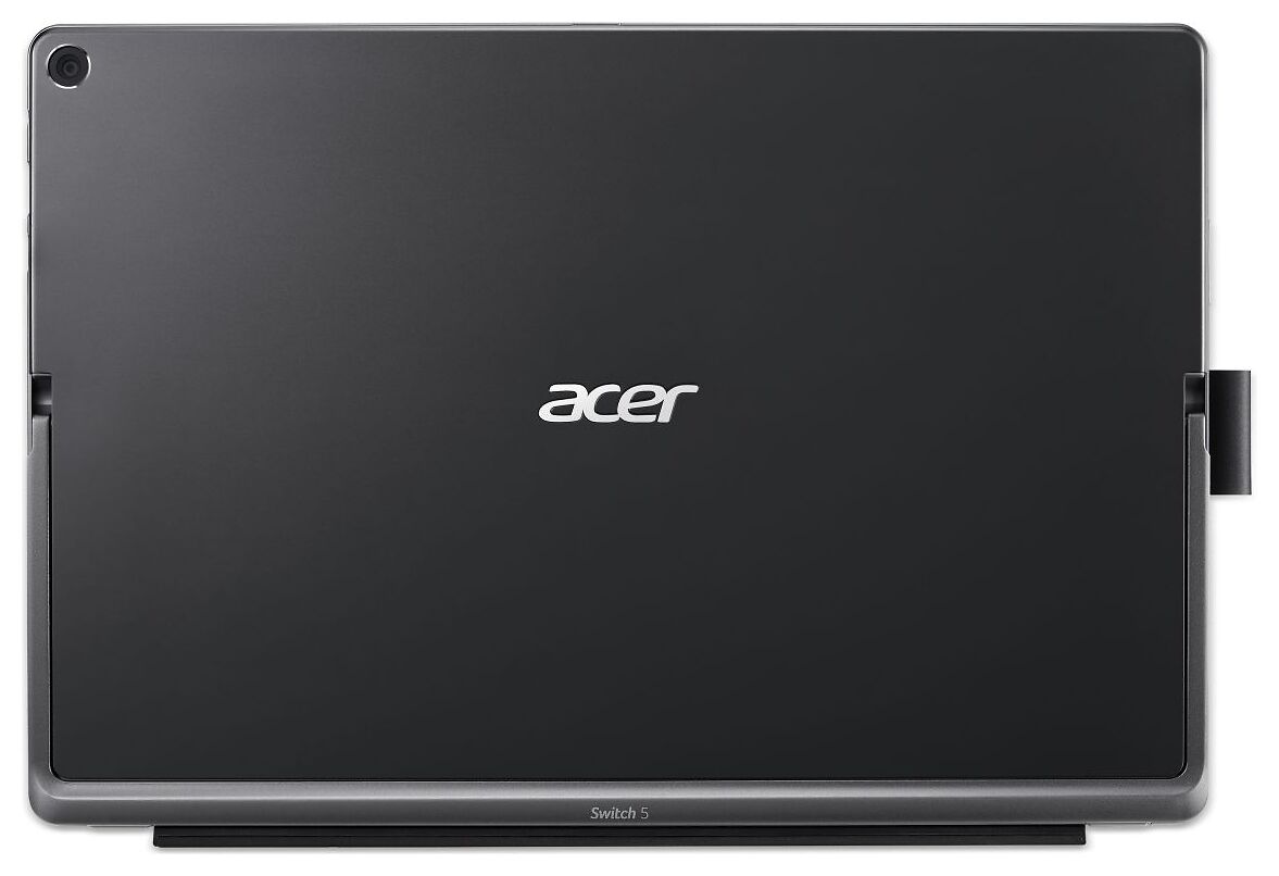

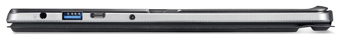

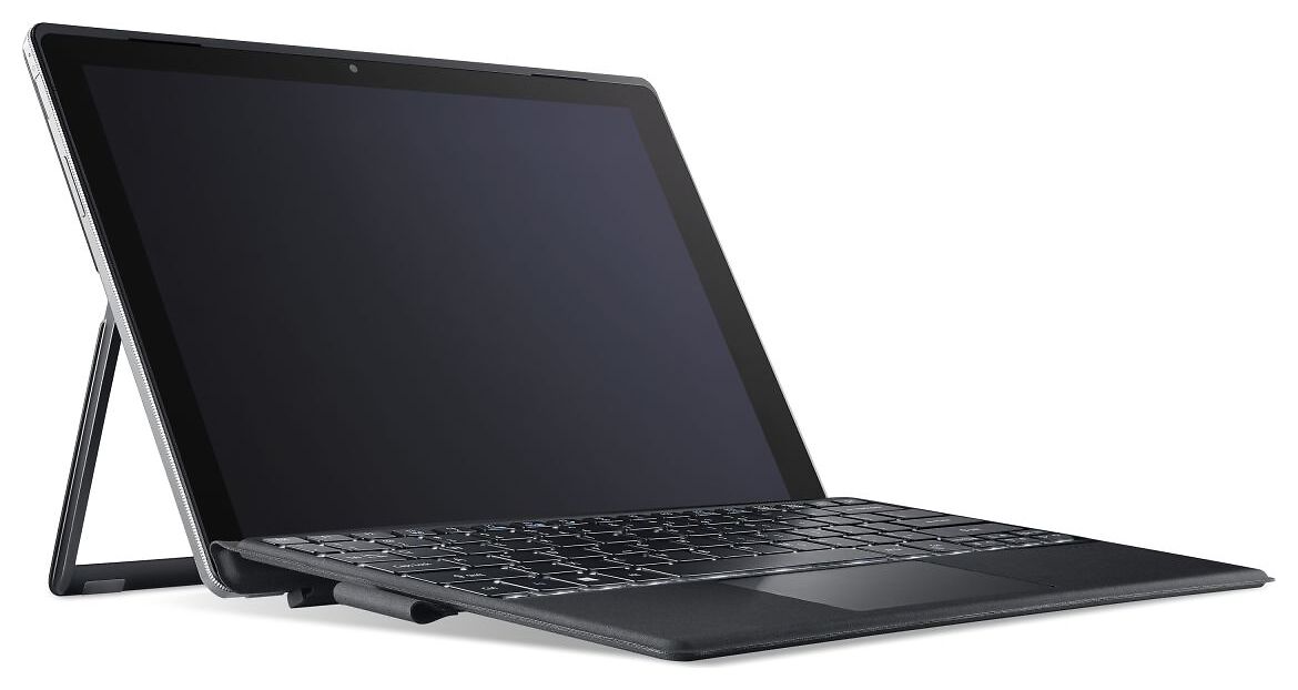

Acer Switch SW512-52P-54DJ Hybrid (2-in-1) 5 Specification for Upgrade or Repair
    Acer Switch SW512-52P-54DJ Hybrid (2-in-1) 5 Specification for Upgrade or Repair
    This specification for the Acer Switch SW512-52P-54DJ Hybrid (2-in-1) can be useful for upgrading or repairing a laptop that is not working. As a community we are working through our specifications to add valuable data like the SW512-52P-54DJ boardview and SW512-52P-54DJ schematic. Our users have donated over 1 million documents which are being added to the site. This page will be updated soon with additional information. Alternatively you can request additional help from our users directly on the relevant badcaps forum. Please note that we offer no warranties that any specification, datasheet, or download for Acer Switch SW512-52P-54DJ Hybrid (2-in-1) is accurate, safe, error free, or the fix you require.
    Design > Brand: Acer
    Design > Family: Switch
    Design > Model Name: SW512-52P-54DJ
    Design > Part Number: NT.LDTEC.001
    Design > Release Date: 02/02/2018
    Design > Series: 5
    Display > Aspect Ratio: 0.126388889
    Display > Display Diagonal: 12 inch
    Display > Display Resolution: 2160x1440 pixels
    Display > HD Type: Quad HD
    Specification > Battery: 10.5 hrs 4870mAh
    Specification > Display Diagonal: 12 inch
    Specification > Processor: i5-7200U 2.50GHz
    Specification > Weight: 1.27kg
    Processor > Processor Boost Frequency: 3.10GHz
    Processor > Processor Frequency: 2.50GHz
    Product Code: NT.LDTEC.001
    Battery > Battery Capacity: 4870mAh
    Battery > Battery Life (max): 10.5 h
    Camera > Auto Focus: Yes
    Camera > Front Camera Resolution: 1600x1200 pixels
    Camera > Rear Camera: Yes
    Camera > Rear Camera Resolution (numeric): 5MP
    Performance > Electronic Compass: Yes
    Performance > Gyroscope: Yes
    Storage > Compatible Memory Cards: MicroSD (TransFlash), MicroSDXC
    Weight And Dimensions > Depth: 201.8mm
    Weight And Dimensions > Height: 9.6mm
    Weight And Dimensions > Weight: 1.27kg
    Weight And Dimensions > Width: 292.9mm
    Acer Switch SW512-52P-54DJ Hybrid (2-in-1) 5 Specification for Upgrade or Repair
    Acer Switch SW713-51GNP-80Y3 Hybrid (2-in-1) 7 Black Edition Specification for Upgrade or Repair
    This specification for the Acer Switch SW713-51GNP-80Y3 Hybrid (2-in-1) can be useful for upgrading or repairing a laptop that is not working. As a community we are working through our specifications to add valuable data like the SW713-51GNP-80Y3 boardview and SW713-51GNP-80Y3 schematic. Our users have donated over 1 million documents which are being added to the site. This page will be updated soon with additional information. Alternatively you can request additional help from our users directly on the relevant badcaps forum. Please note that we offer no warranties that any specification, datasheet,...
    09-06-2024, 07:58 AM
    Acer Switch SW713-51GNP-86GA Hybrid (2-in-1) Specification for Upgrade or Repair
    This specification for the Acer Switch SW713-51GNP-86GA Hybrid (2-in-1) can be useful for upgrading or repairing a laptop that is not working. As a community we are working through our specifications to add valuable data like the SW713-51GNP-86GA boardview and SW713-51GNP-86GA schematic. Our users have donated over 1 million documents which are being added to the site. This page will be updated soon with additional information. Alternatively you can request additional help from our users directly on the relevant badcaps forum. Please note that we offer no warranties that any specification, datasheet,...
    09-06-2024, 06:21 AM
    Acer Switch SW713-51GNP-879G Hybrid (2-in-1) 7 Black Edition Specification for Upgrade or Repair
    This specification for the Acer Switch SW713-51GNP-879G Hybrid (2-in-1) can be useful for upgrading or repairing a laptop that is not working. As a community we are working through our specifications to add valuable data like the SW713-51GNP-879G boardview and SW713-51GNP-879G schematic. Our users have donated over 1 million documents which are being added to the site. This page will be updated soon with additional information. Alternatively you can request additional help from our users directly on the relevant badcaps forum. Please note that we offer no warranties that any specification, datasheet,...
    09-06-2024, 07:14 AM
    Acer Switch SW512-52P Hybrid (2-in-1) 5 Specification for Upgrade or Repair
    This specification for the Acer Switch SW512-52P Hybrid (2-in-1) can be useful for upgrading or repairing a laptop that is not working. As a community we are working through our specifications to add valuable data like the SW512-52P boardview and SW512-52P schematic. Our users have donated over 1 million documents which are being added to the site. This page will be updated soon with additional information. Alternatively you can request additional help from our users directly on the relevant badcaps forum. Please note that we offer no warranties that any specification, datasheet, or download for...
    09-06-2024, 07:58 AM
    Acer Switch SW512-52P-56F9 Hybrid (2-in-1) 5 Specification for Upgrade or Repair
    This specification for the Acer Switch SW512-52P-56F9 Hybrid (2-in-1) can be useful for upgrading or repairing a laptop that is not working. As a community we are working through our specifications to add valuable data like the SW512-52P-56F9 boardview and SW512-52P-56F9 schematic. Our users have donated over 1 million documents which are being added to the site. This page will be updated soon with additional information. Alternatively you can request additional help from our users directly on the relevant badcaps forum. Please note that we offer no warranties that any specification, datasheet,...
    09-06-2024, 07:00 AM
