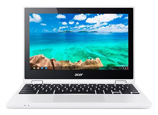

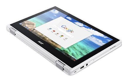

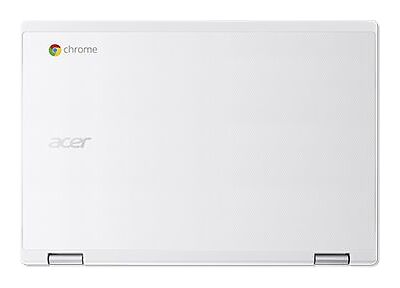

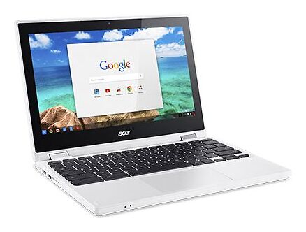

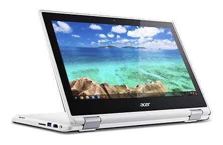

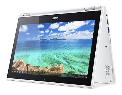

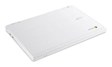

Acer Chromebook CB5-132T-C9F1 Chromebook R 11 Specification for Upgrade or Repair
    Acer Chromebook CB5-132T-C9F1 Chromebook R 11 Specification for Upgrade or Repair
    This specification for the Acer Chromebook CB5-132T-C9F1 Chromebook can be useful for upgrading or repairing a laptop that is not working. As a community we are working through our specifications to add valuable data like the CB5-132T-C9F1 boardview and CB5-132T-C9F1 schematic. Our users have donated over 1 million documents which are being added to the site. This page will be updated soon with additional information. Alternatively you can request additional help from our users directly on the relevant badcaps forum. Please note that we offer no warranties that any specification, datasheet, or download for Acer Chromebook CB5-132T-C9F1 Chromebook is accurate, safe, error free, or the fix you require.
    Design > Brand: Acer
    Design > Colour Of Product: White
    Design > Family: Chromebook
    Design > Model Name: CB5-132T-C9F1
    Design > Part Number: NX.G54AL.002
    Design > Release Date: 21/10/2017
    Design > Series: R 11
    Display > 3D: No
    Display > HD Type: HD
    Graphics > On-board Graphics Adapter Base Frequency: 320MHz
    Graphics > On-board Graphics Adapter Model: Intel HD Graphics
    Specification > Battery: 3490mAh
    Specification > Graphics: Intel HD Graphics
    Specification > Internal Memory: 4GB DDR3L-SDRAM
    Specification > Processor: N3150 1.6GHz
    Specification > Storage: 32GB Flash
    Memory > Internal Memory: 4GB
    Processor > Processor Boost Frequency: 2.08GHz
    Processor > Processor Codename: Braswell
    Processor > Processor Model: N3150
    Processor > Processor Socket: BGA1170
    Product Code: NX.G54AL.002
    Battery > Battery Capacity: 3490mAh
    Software > Operating System Installed: ChromeOS
    Weight And Dimensions > Depth: 204mm
    Weight And Dimensions > Height: 19.2mm
    Weight And Dimensions > Height (front): 1.92 cm
    Weight And Dimensions > Height (rear): 1.92 cm
    Weight And Dimensions > Width: 294mm
    Acer Chromebook CB5-132T-C9F1 Chromebook R 11 Specification for Upgrade or Repair
    Acer Chromebook C771T-56G3 Chromebook 11 Specification for Upgrade or Repair
    This specification for the Acer Chromebook C771T-56G3 Chromebook can be useful for upgrading or repairing a laptop that is not working. As a community we are working through our specifications to add valuable data like the C771T-56G3 boardview and C771T-56G3 schematic. Our users have donated over 1 million documents which are being added to the site. This page will be updated soon with additional information. Alternatively you can request additional help from our users directly on the relevant badcaps forum. Please note that we offer no warranties that any specification, datasheet, or download...
    09-06-2024, 06:06 AM
    Acer Chromebook CP713-1WN-866Q Chromebook Spin 13 Specification for Upgrade or Repair
    This specification for the Acer Chromebook CP713-1WN-866Q Chromebook can be useful for upgrading or repairing a laptop that is not working. As a community we are working through our specifications to add valuable data like the CP713-1WN-866Q boardview and CP713-1WN-866Q schematic. Our users have donated over 1 million documents which are being added to the site. This page will be updated soon with additional information. Alternatively you can request additional help from our users directly on the relevant badcaps forum. Please note that we offer no warranties that any specification, datasheet,...
    09-06-2024, 07:14 AM
    Acer Chromebook CB713-1W-5549 Chromebook 13 Specification for Upgrade or Repair
    This specification for the Acer Chromebook CB713-1W-5549 Chromebook can be useful for upgrading or repairing a laptop that is not working. As a community we are working through our specifications to add valuable data like the CB713-1W-5549 boardview and CB713-1W-5549 schematic. Our users have donated over 1 million documents which are being added to the site. This page will be updated soon with additional information. Alternatively you can request additional help from our users directly on the relevant badcaps forum. Please note that we offer no warranties that any specification, datasheet, or...
    09-06-2024, 11:05 AM
    Acer Chromebook CB715-1WT-5591 Chromebook 715 Specification for Upgrade or Repair
    This specification for the Acer Chromebook CB715-1WT-5591 Chromebook can be useful for upgrading or repairing a laptop that is not working. As a community we are working through our specifications to add valuable data like the CB715-1WT-5591 boardview and CB715-1WT-5591 schematic. Our users have donated over 1 million documents which are being added to the site. This page will be updated soon with additional information. Alternatively you can request additional help from our users directly on the relevant badcaps forum. Please note that we offer no warranties that any specification, datasheet,...
    09-06-2024, 09:45 AM
    Acer Chromebook CP713-1WN-56T1 Chromebook Spin 13 Specification for Upgrade or Repair
    This specification for the Acer Chromebook CP713-1WN-56T1 Chromebook can be useful for upgrading or repairing a laptop that is not working. As a community we are working through our specifications to add valuable data like the CP713-1WN-56T1 boardview and CP713-1WN-56T1 schematic. Our users have donated over 1 million documents which are being added to the site. This page will be updated soon with additional information. Alternatively you can request additional help from our users directly on the relevant badcaps forum. Please note that we offer no warranties that any specification, datasheet,...
    09-06-2024, 09:32 AM
