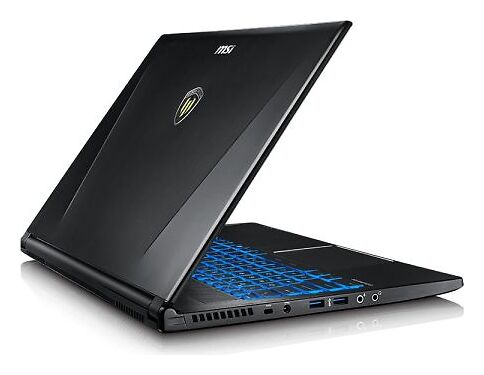

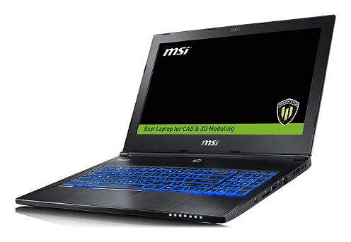

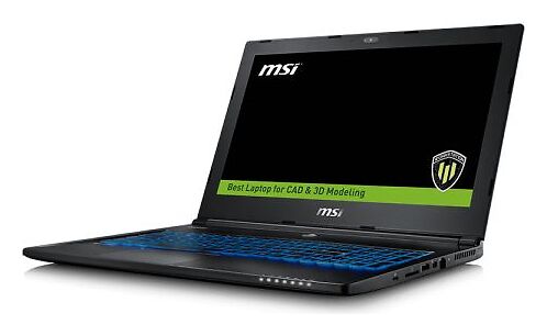

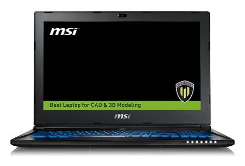

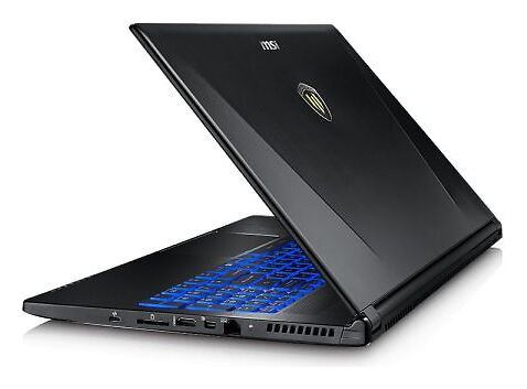

MSI Workstation WS60 6QJ-407NE Mobile workstation WS60 Specification for Upgrade or Repair
    MSI Workstation WS60 6QJ-407NE Mobile workstation WS60 Specification for Upgrade or Repair
    This specification for the MSI Workstation WS60 6QJ-407NE Mobile workstation can be useful for upgrading or repairing a laptop that is not working. As a community we are working through our specifications to add valuable data like the WS60 6QJ-407NE boardview and WS60 6QJ-407NE schematic. Our users have donated over 1 million documents which are being added to the site. This page will be updated soon with additional information. Alternatively you can request additional help from our users directly on the relevant badcaps forum. Please note that we offer no warranties that any specification, datasheet, or download for MSI Workstation WS60 6QJ-407NE Mobile workstation is accurate, safe, error free, or the fix you require.
    Design > Brand: MSI
    Design > Family: Workstation
    Design > Model Name: WS60 6QJ-407NE
    Design > Part Number: WS60 6QJ-407NE
    Design > Product Colour: Aluminium, Black
    Design > Release Date: 02/10/2016
    Design > Series: WS60
    Graphics > Discrete Graphics Adapter Model: NVIDIA Quadro M2000M
    Graphics > Maximum On-board Graphics Adapter Memory: 1.7GB
    Graphics > On-board Graphics Adapter Model: Intel HD Graphics 530
    Specification > Graphics: Intel HD Graphics 530
    Specification > Processor: I7-6700HQ 2.6GHz
    Specification > Weight: 1.9kg
    Processor > Motherboard Chipset: Intel CM236
    Processor > Processor Family: 6th gen Intel Core i7
    Processor > Processor Model: I7-6700HQ
    Processor > Processor Series: Intel Core i7-6700 Mobile series
    Product Code: WS60 6QJ-407NE
    Audio > Speakers Manufacturer: Dynaudio
    S/PDIF Out Port: No
    Storage > HDD Size: 2.5"
    Storage > HDD Speed: 7200RPM
    Storage > Number Of SSDs Installed: 2
    Storage > SSD Capacity: 128GB
    Weight And Dimensions > Depth: 266mm
    Weight And Dimensions > Width: 390mm
    MSI Workstation WS60 6QJ-407NE Mobile workstation WS60 Specification for Upgrade or Repair
    MSI Workstation WS60 6QH-414NE Mobile workstation WS60 Specification for Upgrade or Repair
    This specification for the MSI Workstation WS60 6QH-414NE Mobile workstation can be useful for upgrading or repairing a laptop that is not working. As a community we are working through our specifications to add valuable data like the WS60 6QH-414NE boardview and WS60 6QH-414NE schematic. Our users have donated over 1 million documents which are being added to the site. This page will be updated soon with additional information. Alternatively you can request additional help from our users directly on the relevant badcaps forum. Please note that we offer no warranties that any specification, datasheet,...
    09-06-2024, 05:30 AM
    MSI Workstation WS60 7RJ-685CA Mobile workstation WS60 Specification for Upgrade or Repair
    This specification for the MSI Workstation WS60 7RJ-685CA Mobile workstation can be useful for upgrading or repairing a laptop that is not working. As a community we are working through our specifications to add valuable data like the WS60 7RJ-685CA boardview and WS60 7RJ-685CA schematic. Our users have donated over 1 million documents which are being added to the site. This page will be updated soon with additional information. Alternatively you can request additional help from our users directly on the relevant badcaps forum. Please note that we offer no warranties that any specification, datasheet,...
    09-06-2024, 06:34 AM
    HP ZBook ZBook 15u G3 Mobile Workstation Mobile workstation 15 Specification for Upgrade or Repair
    This specification for the HP ZBook ZBook 15u G3 Mobile Workstation Mobile workstation can be useful for upgrading or repairing a laptop that is not working. As a community we are working through our specifications to add valuable data like the ZBook 15u G3 Mobile Workstation boardview and ZBook 15u G3 Mobile Workstation schematic. Our users have donated over 1 million documents which are being added to the site. This page will be updated soon with additional information. Alternatively you can request additional help from our users directly on the relevant badcaps forum. Please note that we offer...
    09-06-2024, 05:30 AM
    HP ZBook ZBook 14u G6 Mobile Workstation Mobile workstation 14u Specification for Upgrade or Repair
    This specification for the HP ZBook ZBook 14u G6 Mobile Workstation Mobile workstation can be useful for upgrading or repairing a laptop that is not working. As a community we are working through our specifications to add valuable data like the ZBook 14u G6 Mobile Workstation boardview and ZBook 14u G6 Mobile Workstation schematic. Our users have donated over 1 million documents which are being added to the site. This page will be updated soon with additional information. Alternatively you can request additional help from our users directly on the relevant badcaps forum. Please note that we offer...
    09-06-2024, 09:10 AM
    HP ZBook ZBook 17 G3 Mobile Workstation Mobile workstation 17 Specification for Upgrade or Repair
    This specification for the HP ZBook ZBook 17 G3 Mobile Workstation Mobile workstation can be useful for upgrading or repairing a laptop that is not working. As a community we are working through our specifications to add valuable data like the ZBook 17 G3 Mobile Workstation boardview and ZBook 17 G3 Mobile Workstation schematic. Our users have donated over 1 million documents which are being added to the site. This page will be updated soon with additional information. Alternatively you can request additional help from our users directly on the relevant badcaps forum. Please note that we offer...
    09-06-2024, 05:30 AM
