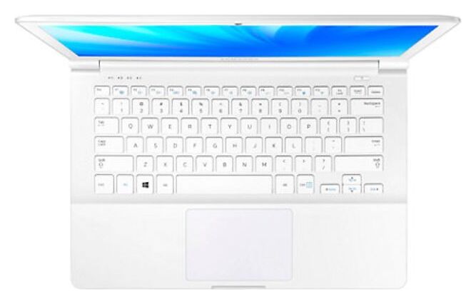

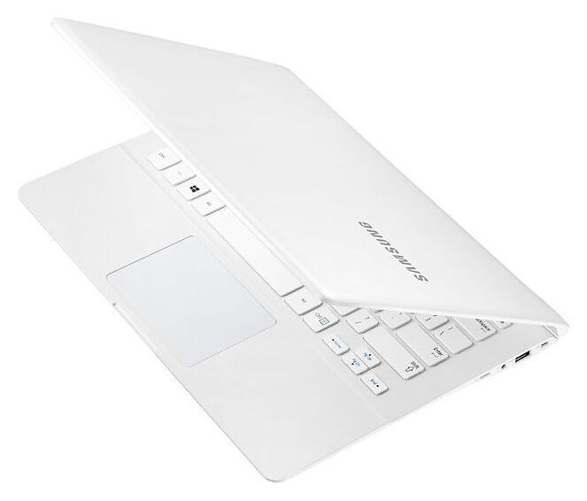

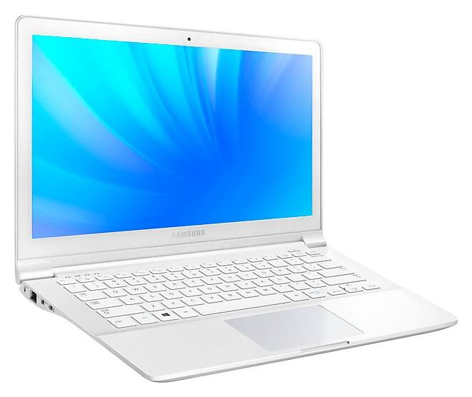

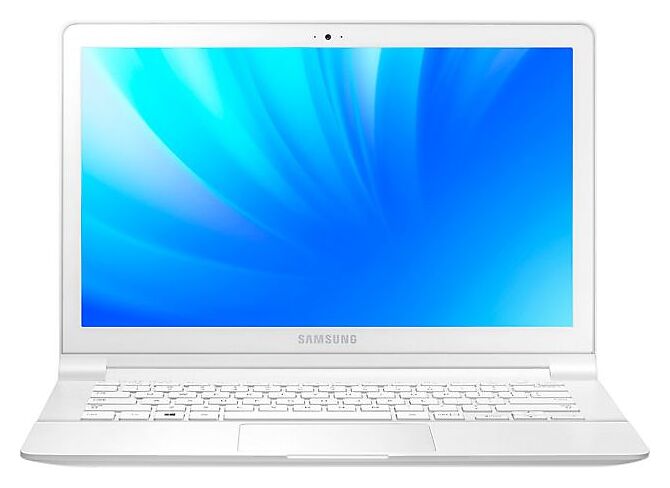

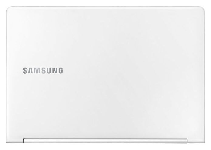

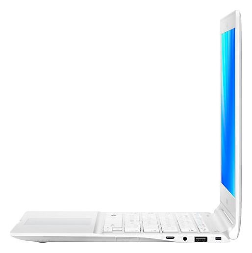

Samsung 9 NP905S3G Notebook Specification for Upgrade or Repair
    • 115471
    Samsung 9 NP905S3G Notebook Specification for Upgrade or Repair
    This specification for the Samsung 9 NP905S3G Notebook can be useful for upgrading or repairing a laptop that is not working. As a community we are working through our specifications to add valuable data like the NP905S3G boardview and NP905S3G schematic. Our users have donated over 1 million documents which are being added to the site. This page will be updated soon with additional information. Alternatively you can request additional help from our users directly on the relevant badcaps forum. Please note that we offer no warranties that any specification, datasheet, or download for Samsung 9 NP905S3G Notebook is accurate, safe, error free, or the fix you require.
    Design > Brand: Samsung
    Design > Family: 9
    Design > Model Name: NP905S3G
    Design > Part Number: NP905S3G-K05IT
    Design > Release Date: 10/01/2014
    Graphics > On-board Graphics Adapter Family: AMD Radeon HD 6000
    Graphics > On-board Graphics Adapter Model: AMD Radeon HD 6520G
    Specification > Battery: 30 Wh
    Specification > Graphics: AMD Radeon HD 6520G
    Specification > Internal Memory: 4GB DDR3-SDRAM
    Specification > Processor: A6-3400M 1.4GHz
    Specification > Weight: 1.44kg
    Memory > Internal Memory: 4GB
    Memory > Internal Memory Type: DDR3-SDRAM
    Memory > Memory Clock Speed: 1066MHz
    Processor > Processor Boost Frequency: 2.3GHz
    Processor > Processor Family: AMD A6
    Processor > Processor Frequency: 1.4GHz
    Processor > Processor Model: A6-3400M
    Product Code: NP905S3G-K05IT
    Audio > Audio System: SoundAlive
    Audio > Speaker Power: 1.5W
    Battery > Battery Capacity: 30 Wh
    Battery > Battery Capacity (Watt Hours): 30Wh
    Ports & Interfaces > Micro HDMI Ports Qty: 1
    Power > AC Adapter Power: 40W
    S/PDIF Out Port: No
    Software > Operating System Installed: Windows 8.1
    Storage > SSD Capacity: 128GB
    Weight And Dimensions > Depth: 224mm
    Weight And Dimensions > Weight: 1.44kg
    Weight And Dimensions > Width: 324mm
    Samsung 9 NP905S3G Notebook Specification for Upgrade or Repair
    Samsung ATIV NP905S3G Notebook Specification for Upgrade or Repair
    This specification for the Samsung ATIV NP905S3G Notebook can be useful for upgrading or repairing a laptop that is not working. As a community we are working through our specifications to add valuable data like the NP905S3G boardview and NP905S3G schematic. Our users have donated over 1 million documents which are being added to the site. This page will be updated soon with additional information. Alternatively you can request additional help from our users directly on the relevant badcaps forum. Please note that we offer no warranties that any specification, datasheet, or download for Samsung...
    09-06-2024, 05:27 AM
    Samsung ATIV NP905S3G Notebook Specification for Upgrade or Repair
    This specification for the Samsung ATIV NP905S3G Notebook can be useful for upgrading or repairing a laptop that is not working. As a community we are working through our specifications to add valuable data like the NP905S3G boardview and NP905S3G schematic. Our users have donated over 1 million documents which are being added to the site. This page will be updated soon with additional information. Alternatively you can request additional help from our users directly on the relevant badcaps forum. Please note that we offer no warranties that any specification, datasheet, or download for Samsung...
    09-06-2024, 05:27 AM
    Samsung ATIV NP905S3G Notebook Specification for Upgrade or Repair
    This specification for the Samsung ATIV NP905S3G Notebook can be useful for upgrading or repairing a laptop that is not working. As a community we are working through our specifications to add valuable data like the NP905S3G boardview and NP905S3G schematic. Our users have donated over 1 million documents which are being added to the site. This page will be updated soon with additional information. Alternatively you can request additional help from our users directly on the relevant badcaps forum. Please note that we offer no warranties that any specification, datasheet, or download for Samsung...
    09-06-2024, 05:27 AM
    Samsung ATIV NP905S3G Notebook Specification for Upgrade or Repair
    This specification for the Samsung ATIV NP905S3G Notebook can be useful for upgrading or repairing a laptop that is not working. As a community we are working through our specifications to add valuable data like the NP905S3G boardview and NP905S3G schematic. Our users have donated over 1 million documents which are being added to the site. This page will be updated soon with additional information. Alternatively you can request additional help from our users directly on the relevant badcaps forum. Please note that we offer no warranties that any specification, datasheet, or download for Samsung...
    09-06-2024, 05:27 AM
    Samsung ATIV NP905S3G Notebook Specification for Upgrade or Repair
    This specification for the Samsung ATIV NP905S3G Notebook can be useful for upgrading or repairing a laptop that is not working. As a community we are working through our specifications to add valuable data like the NP905S3G boardview and NP905S3G schematic. Our users have donated over 1 million documents which are being added to the site. This page will be updated soon with additional information. Alternatively you can request additional help from our users directly on the relevant badcaps forum. Please note that we offer no warranties that any specification, datasheet, or download for Samsung...
    09-06-2024, 05:27 AM
