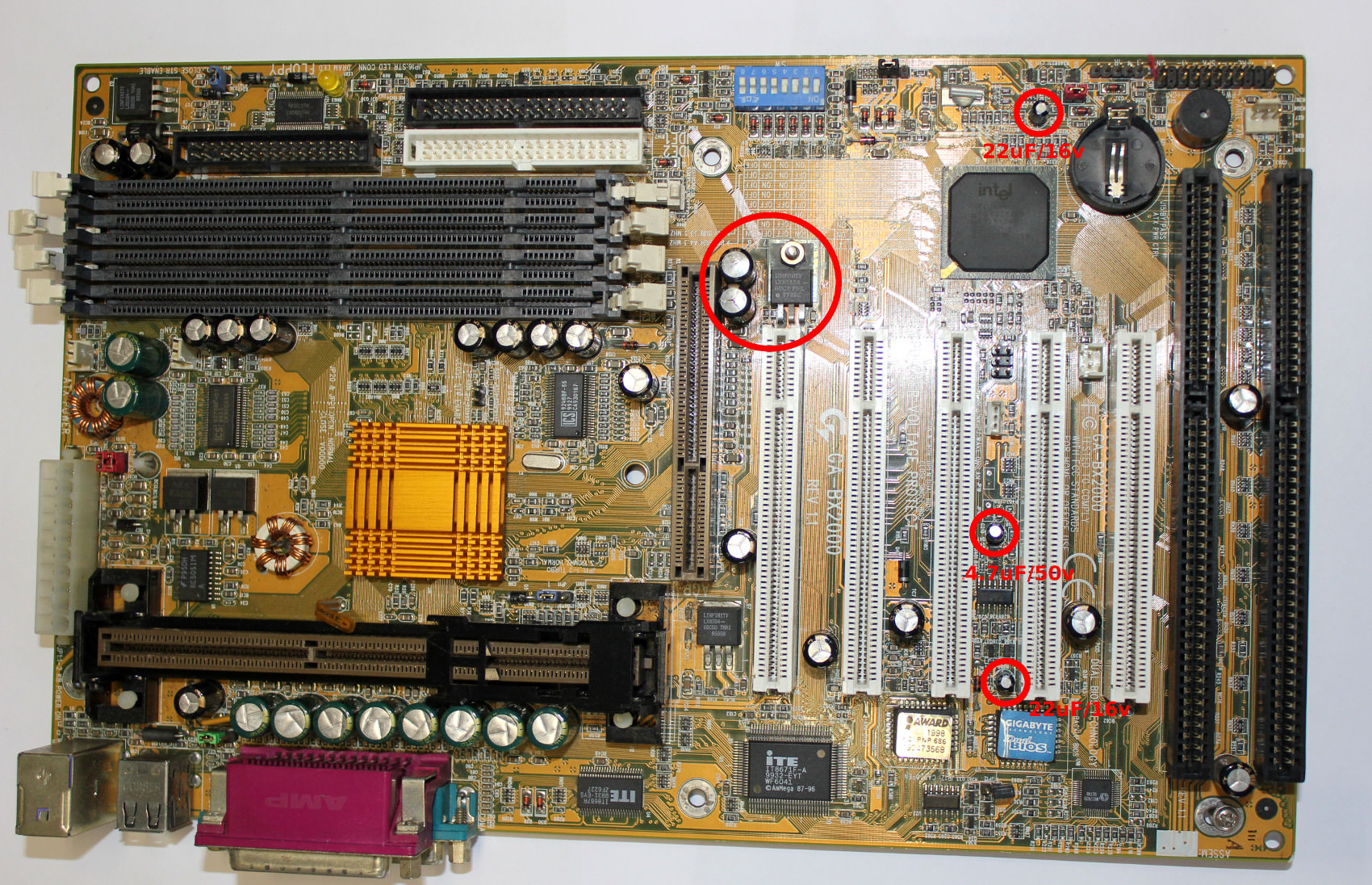

    When I got this motherboard it had some bulged capacitors but worked. One day, after some intensive CPU testing, it died peacefully.
    Since I enjoy learning about electronics and repairing things, I decided to recap it. Got a 60W soldering iron and a few other things and I took note of the position and values of the capacitors on the motherboard:
    10 1200uF 6.3v
    19 330uF 25v
    3 22uF 16v
    But after desoldering all caps, I noticed I made a mistake, as one of the 3 smaller capacitors is 4.7 uF/50v instead of 22uF. I guess I didn't see clearly before desoldering. Now I wonder where this 4.7uF/50v is supposed to go.
    My best guess based on some (not-so-clear) pictures I took before desoldering is that the 4.7uF 50v capacitor goes in the middle of the other two, i.e:
    Can somebody with this motherboard please confirm this?
    So if this is right, the correct count of the aluminum electrolytic capacitors is:
    10 1200uF 6.3v
    19 330uF 25v
    2 22uF 16v
    1 4.7uF 50v
    I have another issue, this one apparently is the definitive issue.
    I noticed the capacitors near the voltage regulator in the center (LINFINITY LX8383A - 00CP PHIL 9935C), (datasheet) were bulged, and the bottom of the PCB right under the voltage regulator looks discolored. So maybe this means the LX8383A is bad too? or this discoloration maybe was caused by the bad caps nearby?
    If the voltage regulator is bad, what replacement should I buy? What are the alternatives?
    I tried to understand the datasheet, I noticed this isn't a fixed voltage regulator and it needs a capacitor. But honestly I couldn't understand much.
    Thank you for sharing your knowledge
    Don't worry about it and just use the 22 uF capacitor in its place. Most of those 22 uF and 4.7 uF capacitors are just general filters for the PSU's 3.3V, 5V, and 12V rails. You could probably even use standard 16V/100 uF/5x11 mm caps everywhere in place of those.
    As for the 330 uF 25V capacitors... again, you don't have to use exactly 330 uF or 25V rated capacitors. The only reason this was done on old motherboards was because low ESR capacitors were expensive and not easily available back then, so manufacturers often used general purpose or entry-level low ESR caps with a higher voltage rating. The higher voltage rating makes the capacitor bigger, and the capacitor ESR and ripple current are directly proportional to the cap size (ESR decreases and ripple current capability increases with capacitor size). So you could also use 16V/ 470 uF capacitors in place of those 25V/330 uF caps.
    Before replacing anything though, you should first look at the specs of the original capacitors. The capacity (uF) and rated voltage (V) is not enough. The other two important specs of a capacitor - at least for computer gear - is the ESR (impedance) and ripple current. To find those, you need to also post what brand and series the capacitors are, as well as the dimensions (diameter and height in millimeters). This will enable us/you to look for datasheets for the caps and thus find the specs of the original capacitors, after which you can choose proper replacements.
    So for example, the green capacitors close to the CPU socket are Sanyo (now Suncon). Sanyo has several popular series that are used on motherboards: SE, WX, WG, and WF. This is an older motherboard, so those are probably either SE or WX (please confirm if that's the case). Now Sanyo is a good quality Japanese brand in general, so you don't need to replace any of the Sanyo caps. But the black capacitors with the "Y" vent on top appear to be a cheap Chinese/Taiwanese brand, so you should probably replace all of them. Again, however, we need to know what brand and series they are so that we can try to find proper replacements. (Though if I had to guess, these are probably entry-level low ESR, so anything like Panasonic FC, Nichicon PW/PS/PM/PJ/HE, Chemicon LXY/LXV/LXZ/KY, and Rubycon YXJ/YXG should work as replacements for those.)
    It could well be that the bad caps caused the linear regulator to run hotter than normal. But it's also not uncommon to see linear regulators like that to run very hot on motherboards and discolor the area around them. Most motherboards nowadays are black or dark brown, so you can't really see it. But it still happens and it doesn't mean the regulator is bad - just crappy design on the manufacturer's part. I have seen many motherboards over the years with discolored regulators like that, so I won't conclude that yours is bad just yet. Try the recap the motherboard first and see if it works. If not, then we will get to the regulator and test it and/or replace it, if necessary.
    By the way, that's a great classic slot motherboard you got there! I'm glad you decided to save it. Once recapped with good Japanese caps, these older motherboards are pretty much indestructible.

      Thanks for the swift reply momaka!
      I knew about the ESR, the temperature (all must be 105°), but I wasn't fully aware of the importance of the ripple current.
      This is all the written data from the previous capacitors and their measurements:
      1200uF 6.3V / SANYO / 105°C / S.E.97 / D X. | size 9x15mm
      330uF 25V / CHOYO / XR 105°C / 3 5 A | size 7x14mm
      4.7uF 50V / CHOYO / MR 105°C /2 0 A | size 4x7mmm
      22uF 16V / CHOYO /MR 105°C /1 3 A | size 4x7mm

        Looks like your diamter values are off by 1 mm. The standard sizes are 5 mm, 6.3 mm, 8 mm, 10 mm, and 12.5 mm.
        So your 9 x 15 mm caps are probably 10 x 15 mm.
        The 7 x 14 should be 8 x 14 mm.
        And 4 x 7 is probably 5 x 7 mm.

        Ugh, Jackon - cheap caps. I would use them only if I had bulging/leaking capacitors that are out of spce and nothing better to replace them with.
        Definitely keep the Sanyos.

        Choyo is know crap cap brand. But replacing them with Jackcon.... I don't know. Both have equally poor chance of being a proper permanent fix.
        See if you can find better capacitors in your country, like Panasonic, Rubycon, Nichicon, and United Chemicon. Sanyo is okay too, but you're very likely to get counterfeits (they are probably the most counterfeited brand).
        I'm not sure what is available in Argentina in terms of online stores, but in North America, we have Digikey.com and Mouser.com. Badcaps.net also has a store that can ship caps internationally, but it's $14 USD for international shipping, if I remember correctly. Other options include Farnell/Element14 and RS Components, but I think those are more popular for Europe. Finally, there is also the seller egekecu on eBay with supposedly genuine Japanese caps, but I've never shopped from him so I can't confirm that.

        Yes, those should be okay.
        Like I said, those small caps are usually general filters, so just about anything will do. In reality, you probably don't even need to replace the original ones, as they don't see to be that bad in terms of ESR. For small 5x11 mm general purpose (GP) caps, 1-5 Ohms ESR is usually within spec. But if you already have replacements, you might as well go with them.
        That said, I suggest keeping the original caps from this motherboard, just in case (or at least keep the non-failed ones anyways).

            You probably could use them in place of the two bulged Choyo 25V/330 uF cap next to that hot regulator, but don't expect them to last too long (a year or two if you are lucky). Also note that they are only rated for 6.3V, while the original Choyo are 25V. In general, you should not replace caps with ones that have a lower voltage rating. BUT, if the voltage that the new caps are going to see is less than what they are rated for, then you should be fine. If I had to guess, that hot regulator is probably either for the Northbridge, RAM, or AGP bus, so you are unlikely to find more than 3.3V on its output and more than 5V on it's input. Hence why 6.3V caps should work in that spot.
            But I'll be short of 5, and now another question for a change: Is it a wise idea to mix brands and values? How can one tell?
            Yeah its fine. If the caps meet the specs of the originals and/or the circuit, then you can use whatever you got on hand.

                Gentlemen, it doesn't boot.
                I get nothing, it's exactly like before. I use a POST PCI/ISA card and I get nothing. At least the CPU fan is spinning, but that's it.
                I was extremely careful in my work, I cleaned all the caps with solder wick, re-measured them, I cleaned all the holes, the legs of the used capacitors, re-measured them, soldered, cleaned the flux, I was very meticulous, delicate, I was a craftsman. Yet it failed silently. No explosions.
                I soldered the SANYO 1200uF 6.3V back, replaced the CHOYO 330uF/25V with the JACKCON 330uF/25V, and replaced the small capacitors (4.7uF 50V, 2x22uF 25V) with the HITANO 22uF 25V.
                What is the next step? What is worth doing to fix this motherboard or at least to finish the diagnose? By the way, the PSU is OK, the CPU is OK (they work well with other motherboards).
                Thank you for the resources and all the data about capacitors. I'll save it and consider it a bible. I'll see if I can get a good deal getting discarded motherboards. I found a guy that sells used working P4 or Socket 462 motherboards for a good price.

                  My assumption from this description is you tested the motherboard with all the caps installed, correct? Because if you test the motherboard without any capacitors installed, that can cause damage. Just making sure I point this out.
                  Anyways, with the capacitors replaced, now it's time to check all the regulators on the board, especially that overheated one (the LX8383A-00cp).
                  According to the LX8383A-00cp datasheet, pin 1 is Adjust/Ground, pin 2 (and also the tab) is V_out (the output voltage), and pin 3 is V_in (the input voltage coming to the regulator.) With the motherboard powered on and everything connected correctly, use a multimeter to measure the voltage between V_in and ground (any metal part in your computer case, but NOT pin 1 on the regulator). Then do the same for the V_out pin: measure the voltage between it and ground. Report back what results you get here.
                  There appears to be two more Linfinity regulators, so we need to check those as well. One of them can be found at the upper-right corner of the motherboard, next to the RAM slots. The other is below the CPU slot and right next to the AGP slot. Test both of them the same way you test the LX8383A-00cp mentioned above and post back what results you get. This should tell us if all of the voltages going to the various motherboard components are correct.
                    Yes, I never turned it on when it was "cap-less".
                    I'm using the motherboard on a table, there's no computer case. Furthermore, I think that there is no third pin in this electrical installation, that is to say, no ground (if there is something, I think it doesn't go all the way to the ground in a proper way). Anyway, I used the PSU case and it worked! but I'm really interested to know how can this be possible? And why am I to avoid using the pin 1 (GND/ADJ)?
                    This is what I measured:
                    8383A
                    V_out 3.316
                    V_in 4.99
                    Accidentally I also measured the voltage between pin 1 GND and the PSU case, it was 2.070v
                    8384 (near the RAM sockets)
                    V_out 3.541
                    V_in 4.746
                    8384 (near the CPU/AGP slot)
                    V_out 1.506
                    V_in 4.998
                    Full info about the other two voltage regulators:
                    LINFINITY LX8384-00CDD THAI 9935U, they are surface-mounted. This is the datasheet.
                    Depends on how much you value your time and the motherboard.
                    If you do have the time and you enjoy doing this, then you might as well attempt everything reasonable to troubleshoot it.
                    Yes! Let's go for it. I really enjoy this process as I'm learning a lot and it's quite fun! But it was disappointing not to see any changes after the whole recapping business.
                    Speaking of which, have you tried resetting the CMOS? I see this motherboard has dual BIOS. Have you tried booting from the second BIOS? What does the POST card say with the second BIOS? What about the jumper/switch settings for the CPU/frequency/host clock - tried setting those to "stock" / minimum?
                    I have set the CPU Bus to 100 MHz, which is the standard, and the multiplier is locked, but I also set it right. Changing the bus speed to 66 MHz didn't help.
                    I reset the CMOS many times, I tried it with and without the battery on.
                    The motherboard has two BIOS chips, from the manual: "2M bits FLASH RAM, Support Dual BIOS", and one can select to use both or a single one, but this function is optional, as I don't have pins where the jumpers JP18 and JP19 should be, so it is permanently in dual BIOS mode. Anyway I went on and closed the contacts where the pins should be with some solder, so it would use only a single BIOS. Nevertheless, it didn't yield a different result and I removed the solder.
                    The POST card isn't showing anything, it just powers on but the display is fixed at "----". As if there was no CPU. No error code.
                    I don't think the BIOS is compromised, but you never know, it could be! The question is that removing it is quite hard as it is surface mounted and has a lot of pins, I don't have the proper tools to desolder it, and I don't have a fancy external/USB BIOS flasher.
                    Mmm... what are your thoughts?
                    Thank you for the detailed answers as always and Merry Christmas!

                      There are two MOSFETs and this is what is written on them: "NEC / K3296 / 97M".
                      Maybe they are the culprit? How can we check them?
                      I think this is the datasheet, right? Is it strange that the name on these doesn't include "2S"?

                        The two MOSFETs are very unlikely to be the problem (typically, they would make your PSU shut down if there was something wrong there).
                        Regarding the linear regulators: all input and output voltages appear okay. Well, the one near the RAM slots appears to have an output that is a bit high at 3.5V and an input that is a bit low for a "5V" rail. So it does make me wonder a bit if there is something wrong with it (though I highly doubt it).
                        Unfortunately, I am doing a bit of traveling tomorrow for the next 2-3 days, so I can't give you more to test/check right now. But when I come back, I'll look into your motherboard again. So please be patient if you don't see a response from me for a few days.

                            I'm back. Happy New Year.
                            Because the Ground/Adjust pins are not always connected directly to ground (as you saw with the voltage measurements for your first regulator above).
                            So if you measure the input and output voltages with respect to the regulator's GND/ADJ pin, you may not get an accurate reading.
                            You are indeed right in noting that most *linear* voltage regulators don't necessarily have a direct connection to ground. But that's normal.
                            Yes it can be disappointing at times when you seem to have tried everything and nothing works. But not everything is fixable, unfortunately. Still, if it's worth it to you, then you should try everything you can, indeed.
                            That said, looking at the voltage readings of the regulators above once more, again I don't see any issues there. So unfortunately, the bad caps near the regulator in conjunction with you running load tests on the motherboard could have killed the motherboard's Northbridge. Otherwise, I just don't see why it won't work with the new caps you put.
                            But before declaring the motherboard dead, there's a few more things we can try.
                            Good.
                            I also suggest testing with only a single RAM module, and try inserting the RAM in and out once or twice more, just in case this is a contact issue. Same goes for the VGA card and CPU.
                            Interesting.
                            Did you try all PCI slots? (Assuming your POST card is PCI). If I remember correctly from reading some article a long time ago, some motherboards have PCI slots that may not show anything on a POST card. So try each one, just in case. I find it very strange that the car is sitting with a blank code. Most dead motherboards I have at least display "FF" or "00".
                            Yes, I doubt the BIOS is bad, especially considering you have dual BIOS.
                            But try the above few suggestions to see what we get. They may yield more information about what the problem is.
                            If nothing else, sometimes I go as far as testing the small transistors and resistors on the board. It's tricky and finicky work and rarely yields any results. But I did sort-of revive one motherboard that was refusing to boot at all otherwise (now it boots only when I plug in and power the PSU at the right moment and change some CMOS settings, then save CMOS).

                              Re: GA-BX2000 Recap: identify capacitors, voltage regulator
                              What are those 2 caps under the agp slot that are marked.
                              Specs ?
                                master hoarder
                                • May 2008
                                • 12175
                                • Bulgaria
                                Specs ?
                                Looks like 25V, 330 uF.
                                My guess is they are low voltage and under 5V, so probably can use 6.3V caps.
                                Could also up the capacitance to 470 uF, 680 uF, or even 820 uF without issues.
                                But 470 uF @ 10V or 16V would be a very conservative and safe bet.
