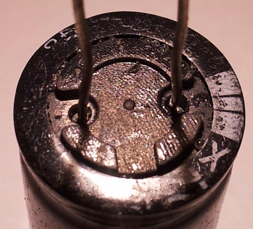

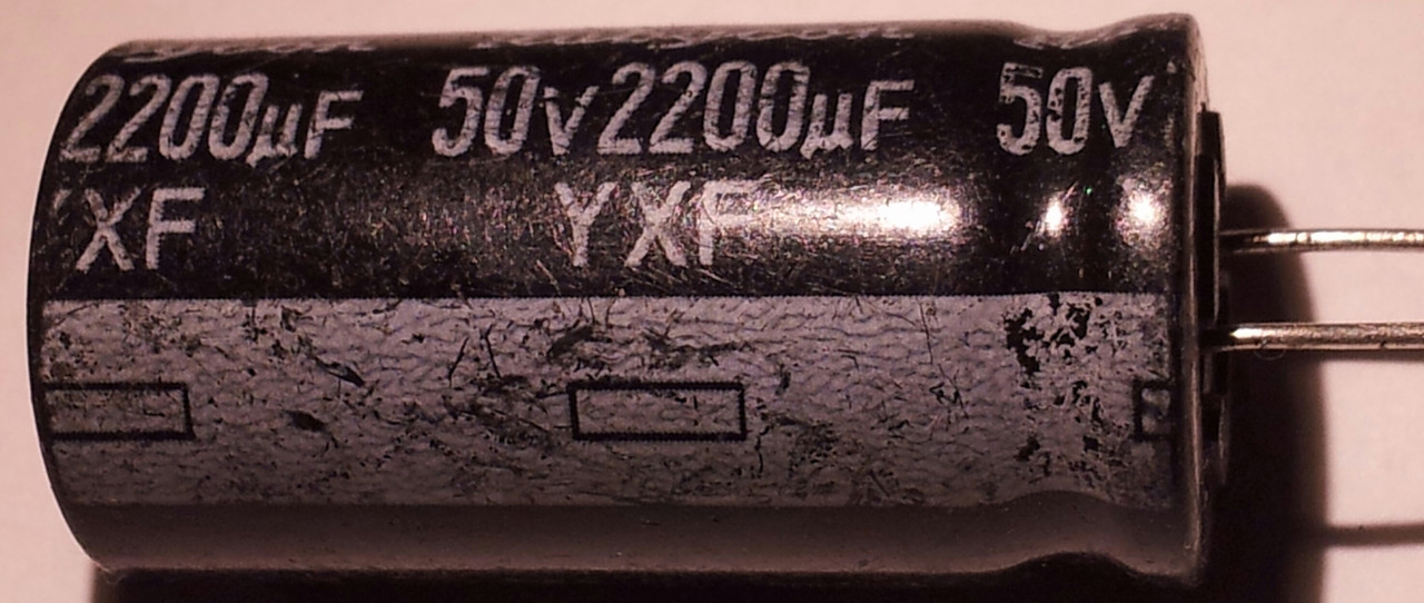

Hello, I just received some capacitors from ebay, and I'm almost 100% sure I've got some fake shit. Attach some pictures so you can judge.
PS: The seller informed that there was little "wear" on them.
To me it looks like a bad copy print, and one can see the glue residue (with a fingerprint).

They look sketchy to me, to say the least. Is the vent a proper Rubycon "K"? Bung looks pretty bad too. But let's get more voice in this thread (free bump - enjoy ).

That is not wear, thats a shitty print job. Look at the bottom of the label, how can you make wear marks on that? Also, the K vent? And the bung is suspicius, i have never seen a ruby with a bung like this. This is what i belive the bung should look like: http://www.retronix.com/uploads/imag...20CAPs%202.JPG

I just took a random Rubycon cap out of my drawer of caps and it has a bung like that.
Mine is a Rubycon WXA with a datecode of S0145, so it's a bit on the older side...

fake.
buy ebay crap, thats what you get.

I've seen too many fake Ruby's out of China. Your caps look like they were clear-coated or sprayed with something. The bung shouldn't have fingerprints like that.
