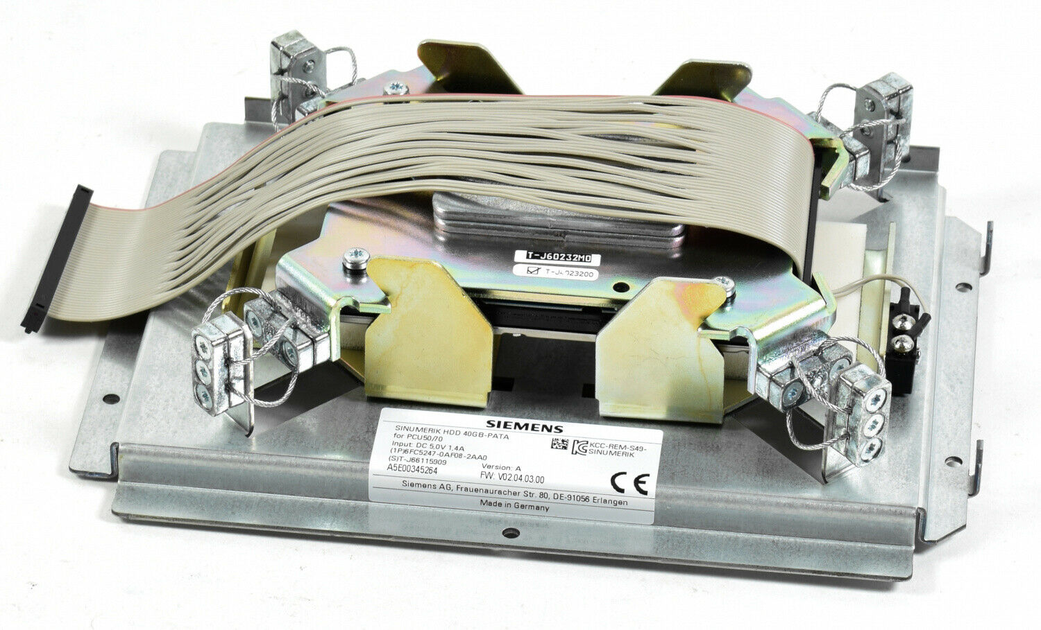

      Not a study per se, more of anecdotal evidence:
      But in industrial machines I service the Siemens PCU50 HMI PC is very popular.
      It does feature a 2.5" HDD in a nice "free hanging" HDD cage.
      I thought one of the primary things would be these HDD's failing in industrial setting.
      But they last forever, and it must 100% be due to the nice mounting mechanism.
      Here a picture stolen off eBay of one, notice the wires in the corners: they act like springs...

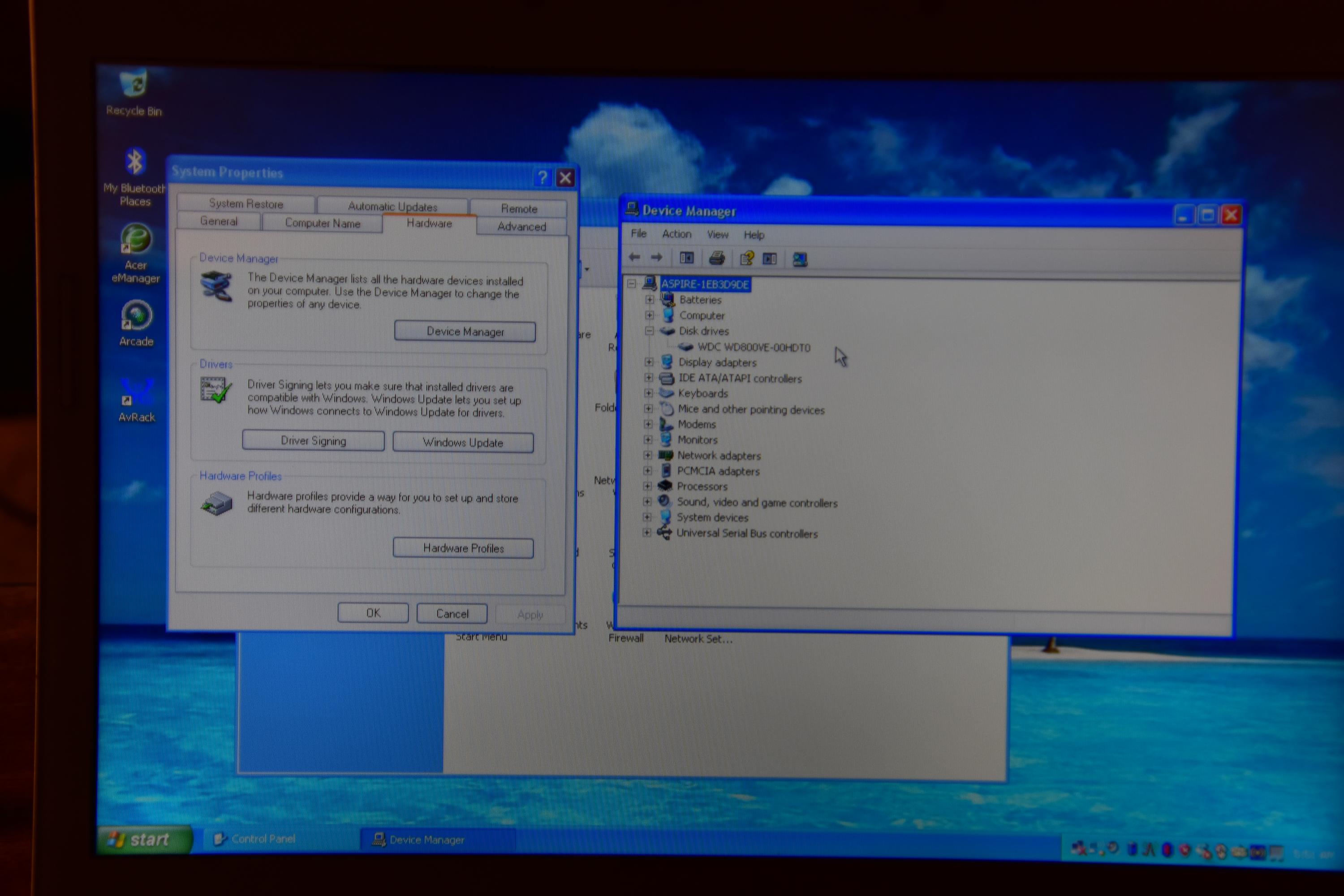

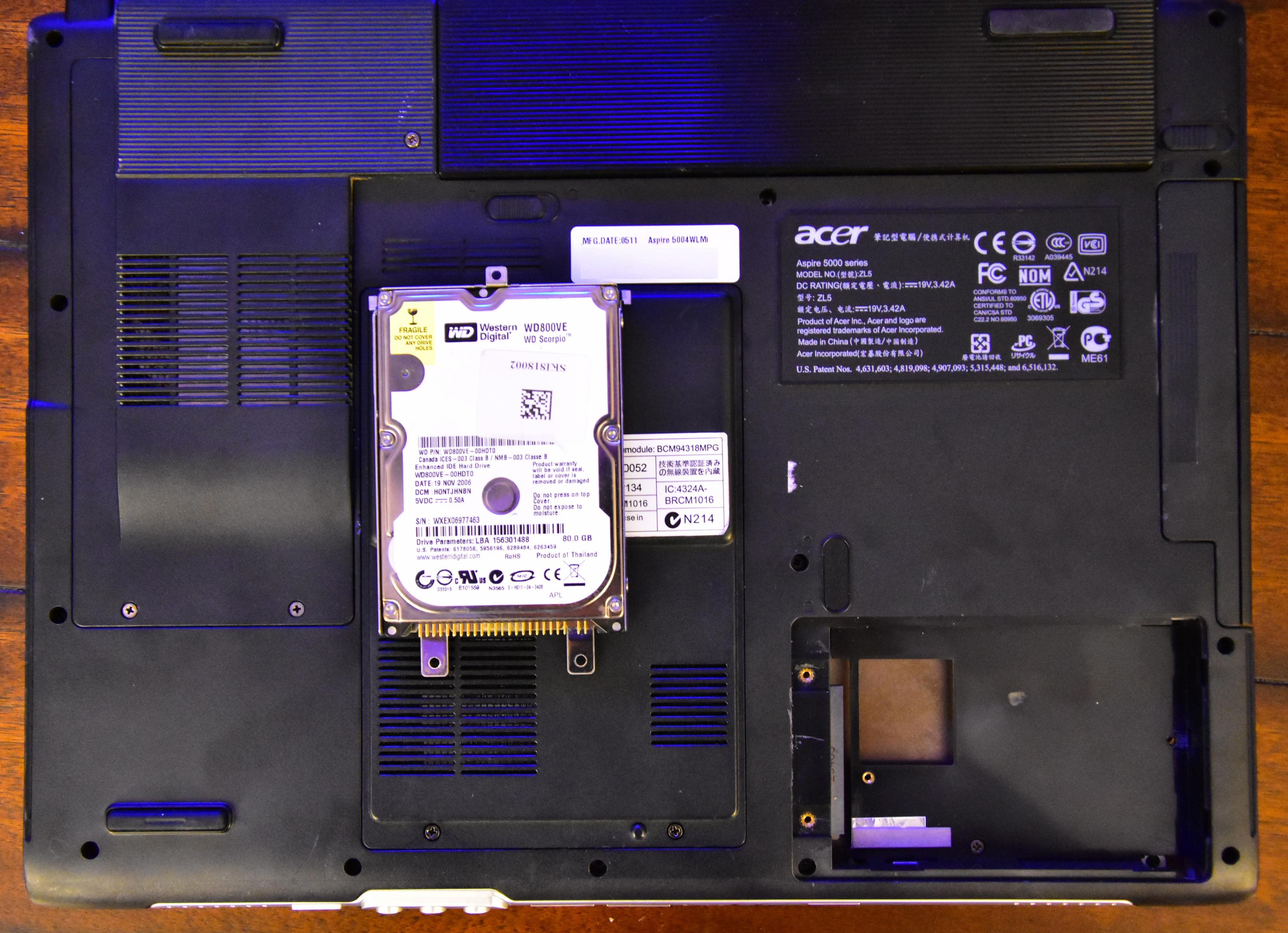

                              Not sure about the others (though I've got an 8 year old WD Blue in my PS3 and haven't had any issues with it), but with the Seagate Momentus (at least the circa 2010s SATA ones), the failure point is usually the controller, so usage is unlikely to matter much. I've had 2 Momentus drives from this era, and one failed completely at around 2 years (no noise or warning, the drive just stopped "showing" up and was inaccessible, likely the infamous controller failure), the other one still kind of works but smelled "burnt" and was very slow (even for a mechanical drive) when I pulled it out of the laptop it was in (and replaced it with an SSD), so those definitely top my personal list of drives to stay away from.
                              I've got several 10+ year old laptop HDDs (most WD Black or Hitachi) that still work (the oldest being a circa 2006 WD Scorpio WD800VE 5200rpm IDE drive from my first laptop, an Acer Aspire 5004 WLMI my grandfather bought for me for Christmas back in 2005, with the WD drive being an upgrade from the 4200rpm unit the Laptop originally came with, yes once upon a time 5200rpm was actually an "upgrade"), though my Laptops are usually used on a desk or table, not on my lap or being carried while powered on (admittedly I'm less diligent about this now with SSDs, but my laptops are still stationary 95%+ of the time while being used).

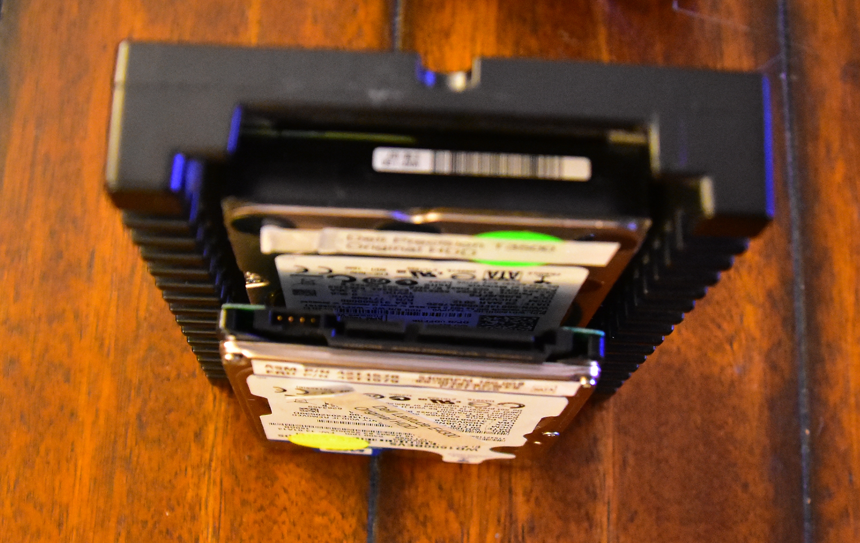

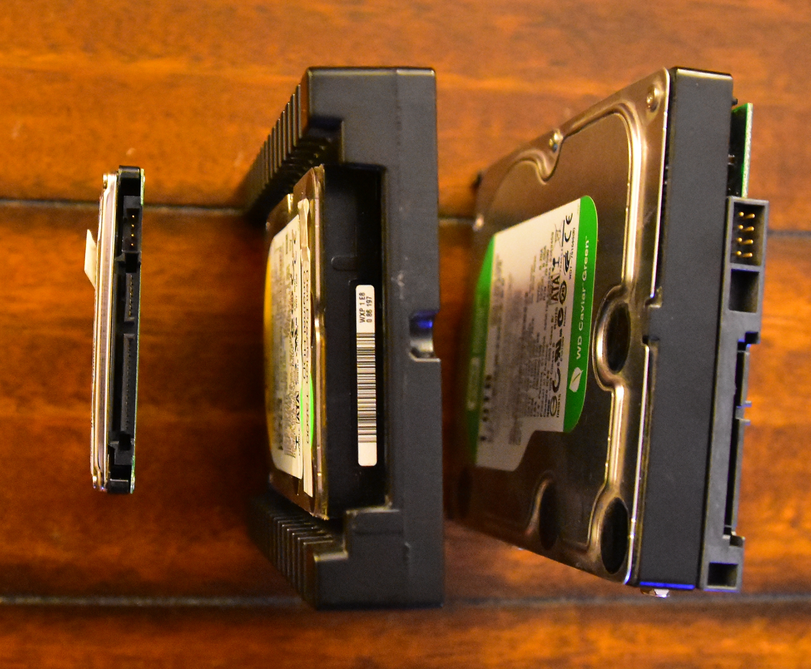

                              As for 2.5" laptop drives vs. 2.5" (or 3.5") desktop drives. Since desktop drives aren't concerned with being thin and light they are generally much more heavily built with larger motors and bearings than laptop drives so I suspect they would last much longer, but I don't have a source of empirical data on this.
                              Laptop 2.5" (bottom), vs. Desktop 2.5" (WD velociraptor, this is in a heatsink but I still think you can see how much thicker the drive is, middle), vs. Desktop 3.5" (top).
                              now just the Laptop 2.5" (bottom) and Desktop 2.5" (top), the velociraptor is about 4 times the thickness of the Laptop drive (and both are 160GB drives)
