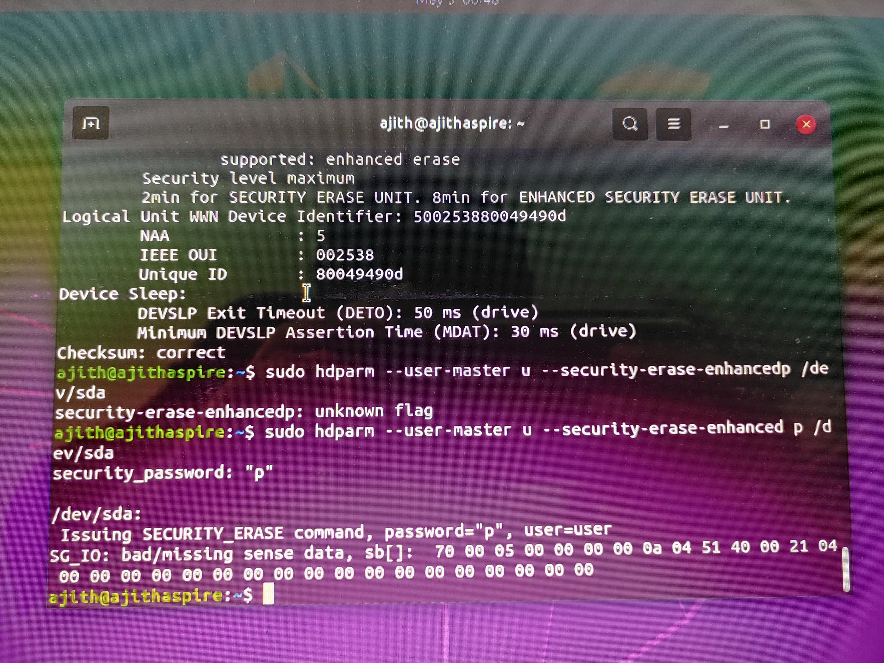

        SG_IO: bad/missing sense data
        I followed this guide - https://grok.lsu.edu/article.aspx?articleid=16716
        I am attaching pictures for reference. I tried this on a laptop as well as on a PC. Same error in both. Tried power cycling but it didn't work.

          "enhancedp"
          try without the p

            If you look at the next command, I corrected it. It still did not work.

              you still tried to pass the "p" as a password though

                I reproduced the steps in the following guides.
                https://ata.wiki.kernel.org/index.php/ATA_Secure_Erase
                https://www.ibm.com/docs/en/linux-on...ion-sata-drive
                I am still getting the same "SG_IO: bad or missing sense data" error
                However, I also tried your recommendation now. It says "Missing PASSWD"

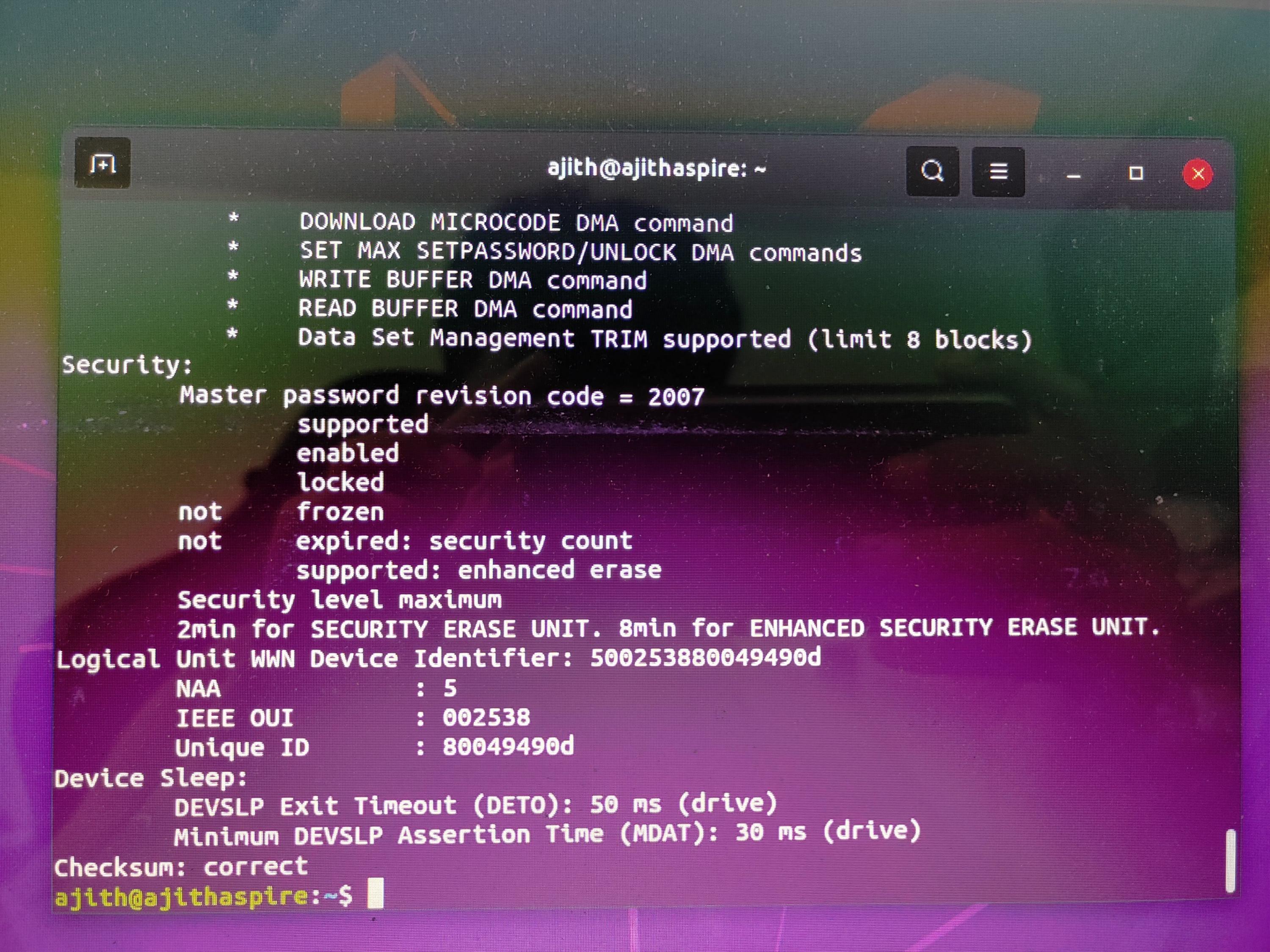

                The HDPARM erase command requires a password it seems. That's why in all these guides there is a step to set the user password and then run the secure delete command using the user password. I am also attaching another image. Let me know if it helps.

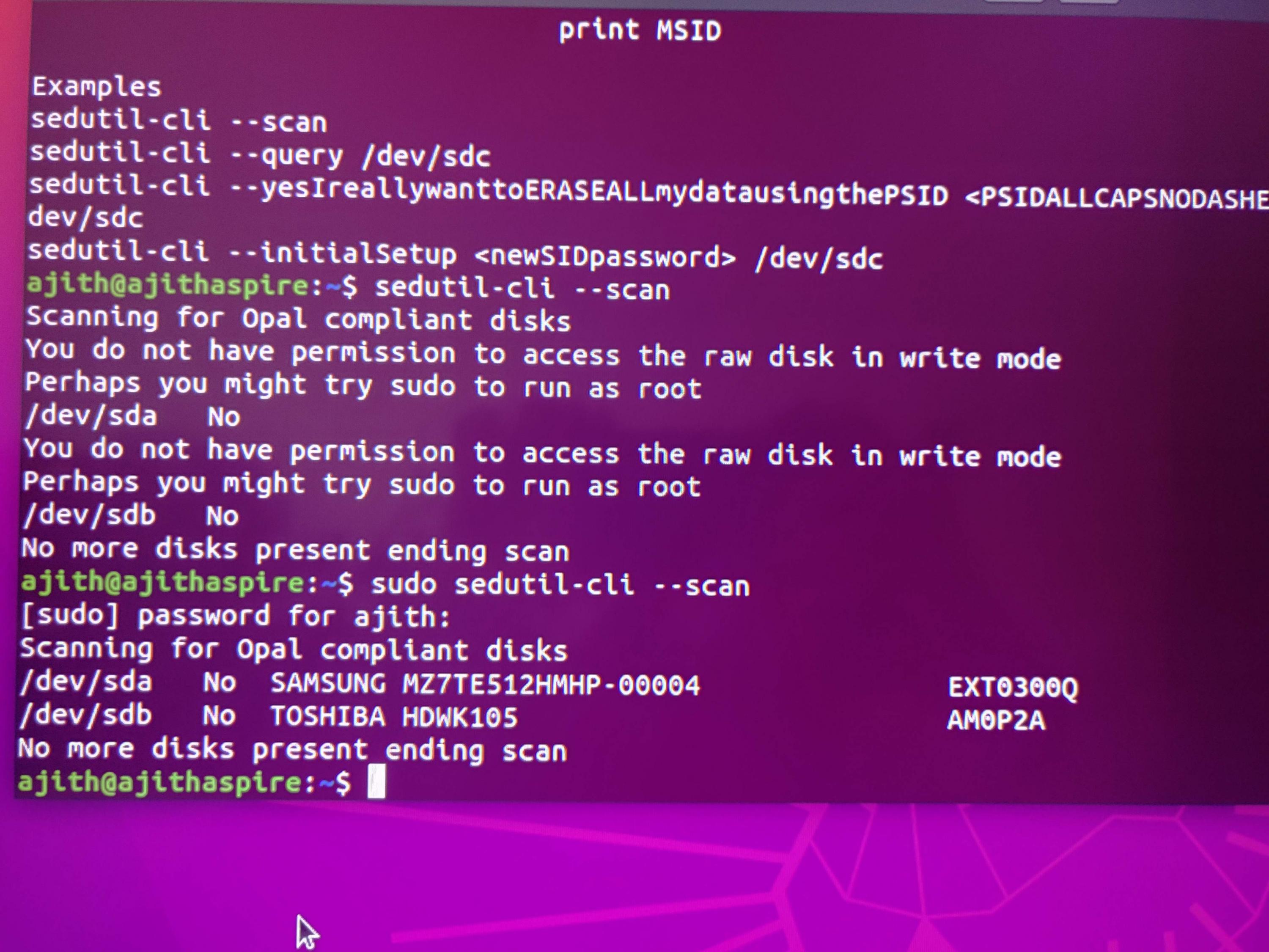

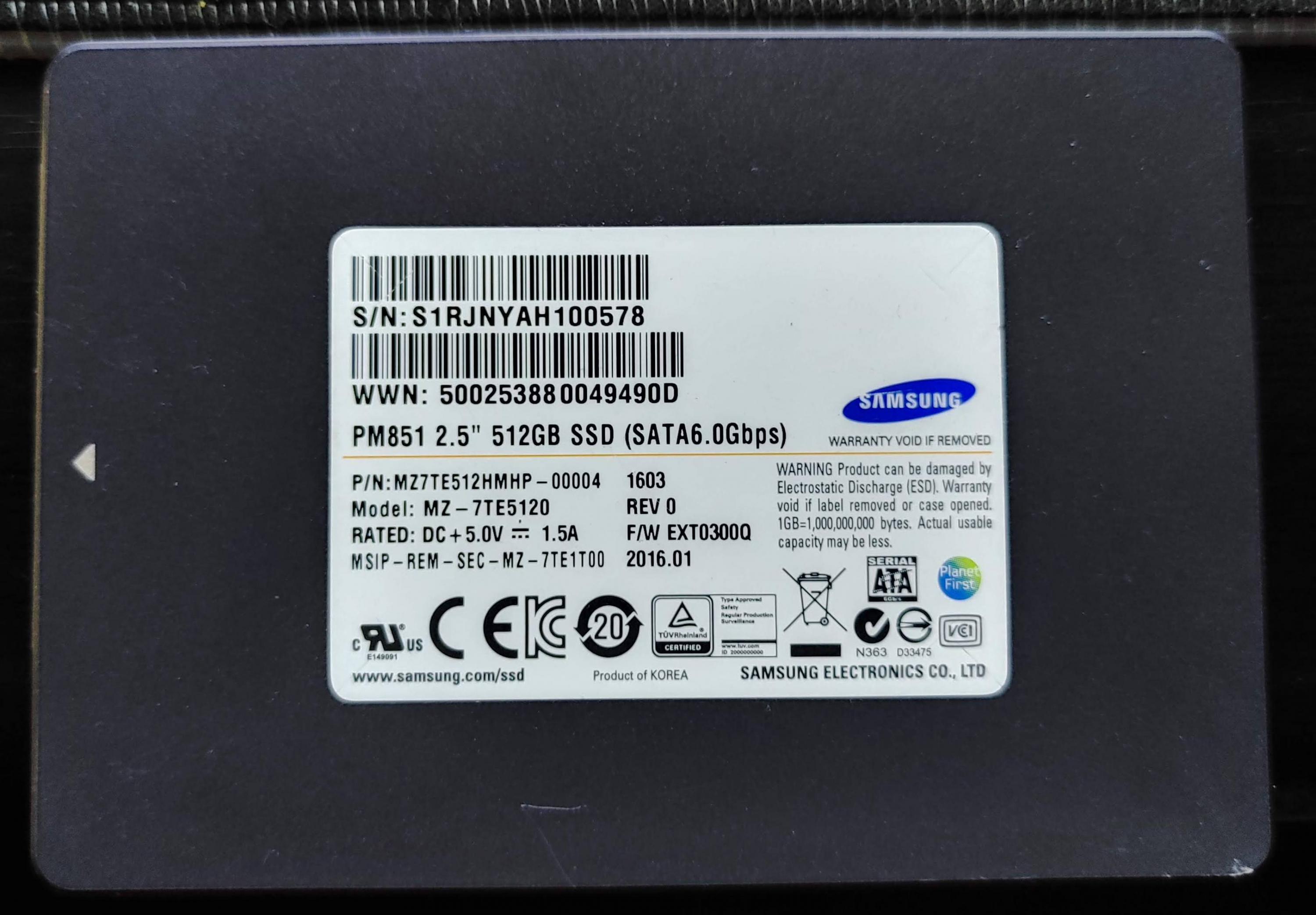

                  Seeing your PM851 has no PSID on its label (a 32 character code I believe), PSID Revert isn't an option for you
                  Although there may be faint hope if PM851 is Opal compliant:
                  https://github.com/Drive-Trust-Allia...ki/PSID-Revert
                  Failing that, based on my experience, you may need to get back the CF54, put the PM851 back in it, then go through a process similar to that required to unlock the CF54 BIOS

                      Unfortunately the drive is not OPAL compliant (refer attached picture). I did go through all your posts before posting this new thread. I have gotten in touch with my friend to see if he can hand over the toughbook for a few days so that I can try something with it. Will keep everyone posted once I get a hold on the laptop.
