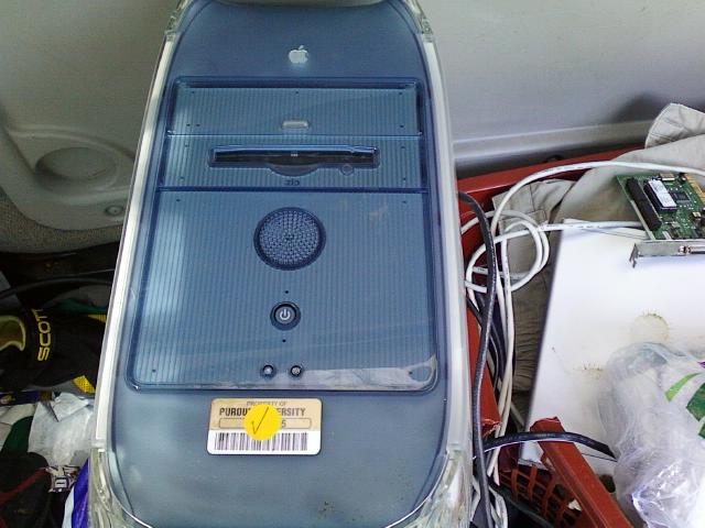

    went to purdue surplus, walked out with a 450mhz G4 tower. had a dvd drive, a zip drive, an ati rage128 agp card, and a scsi card. no hd/ram
    i added an 80GB hd and 1.5gb RAM (2x 512mb, 2x 256mb)
    i have yet to run it as my mom will not let me take it into the house as we are trying to move out. i will this weekend...
    i assume i can install mac os x leopard on it... once i get some dvd-r's, i will torrent it. will that run ok on my setup?
    i may someday install debian or fedora on it... i will look in to it.

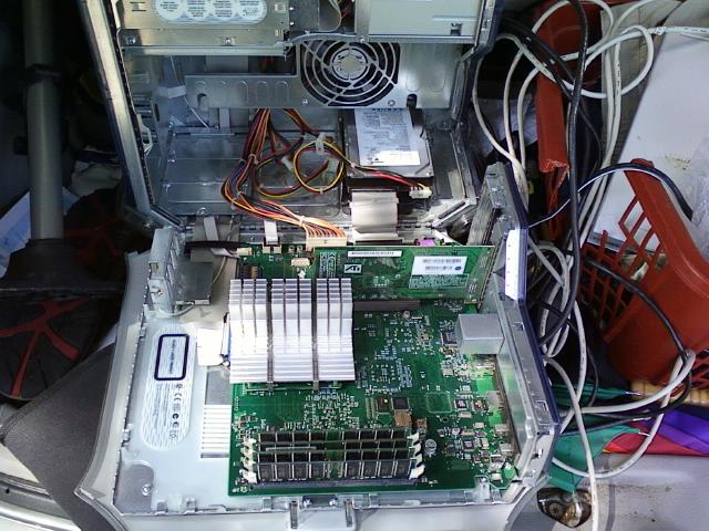

                Re: another $10 mac... G4 Tower
                pics!
                note- they are out of the back of my mom's van... what a mess...
                  yup.. that's a Powermac G4 "Sawtooth" .. direct predecessor of my own "Gigabit Ethernet" ..
                  doesn't have those powersupply problems. also only has a 20pin "ATX" plug instead of 22pin of the Gigabit Ethernet.
                  i wrote ATX in quotes because the pinout is still different from standard PC power supplies. only the plug is the same.
                  little tips before using it:
                  - take the left (looking from the front) side cover off and clean the dust off the 120mm fan's vents which are hidden underneath that cover. they're usually completely clogged with dust. you may need to remove the top "feet" to get it off
                  - clean out the powersupply (lotsa dust bunnies in there usually)

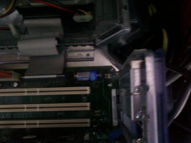

                  oh and i'm pretty sure the PRAM battery (something like the BIOS CR2032 cell) will be dead by now lol
                  i also did a hackjob on mine by mounting a CR2032 socket there. don't wanna spend 8 - 12 bucks on that special battery type if a CR2032 also works..

                    • 17136
                    looked clean... i will check on it when i have time.

                      • seanc
                        • Nov 2008
                        • 1319
                        PPC Macs will enter dead as a dornail syndrome if their PRAM (stupid expensive battery) is dead.

                          the pram battery is good-3.68v... but unlees i can get ma to letme bring it in and hook it up, it will likely not be for long.

                            • deckart
                              • Sep 2009
                              • 67
                              Or,if you have another Mac going,check to see if it has D/L by going to the Apple Icon on top left,click on About this Mac,click on more info,click on Disc Burning and it will give optical properties.If it can read/write D/l,find a Firewire cable connect the two macs,restart the Mac you want to install OSX on,whilst pressing T on the keyboard,chuck in 10.5 in the other Mac.then install by choosing the HDD on the other Mac,remember to format disk to APT.Or just hook up an external optical,reboot whilst pressing alt and selecting 10.5.

                                  well... i may have found the fix for the pram battery...
                                  as it turns out, a cr2 camera battery fits. the lithium ones go for $10 for a two pack:
                                  they are a bit longer...
                                  but still fit....
                                  note- they are 3v, not 3.6v... but if a 2032 cmos battery worked, then 3v is fine.
                                  i bet you could get the cr2 cheaper...
