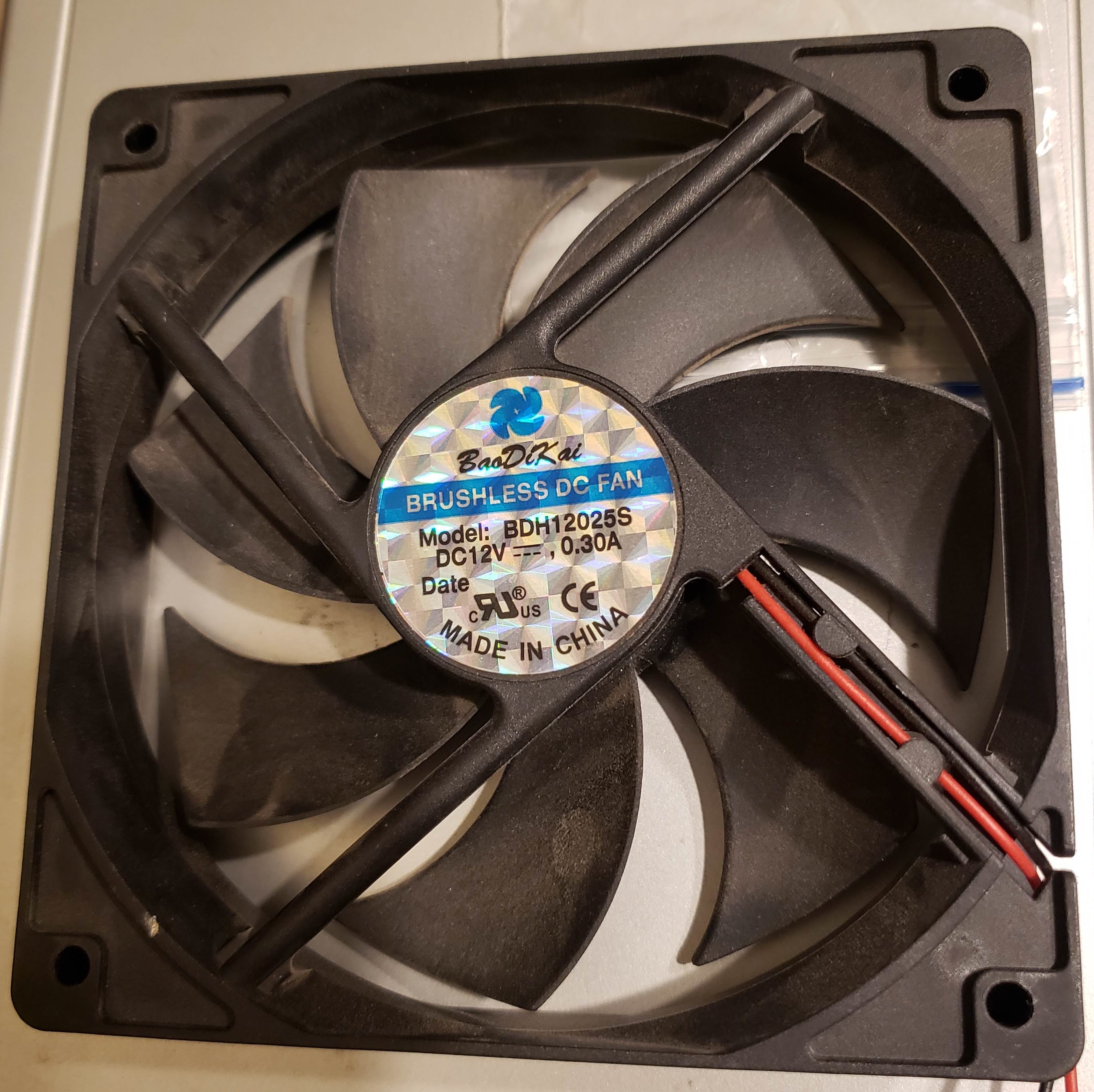

    So this was running in a computer for a while, working fine. I went to do my every-other-day check to make sure fans are spinning, no clicking hard drives, etc. of all my computers running. I noticed that there was no fan exhaust on this machine. I shined a flashlight to see that the fan was not spinning. I thought that maybe it seized but thought that was strange because I always oil fans after I recap power supplies.
    I thought that maybe it was the PSU but I pulled it and plugged it straight into the molex of another PSU. I tried 5V and 12V, nothing. No tick, it doesn't even try. Plugged into 12V and tried 'kick starting' it by manually spinning it but it has no life.
    I got close to the bearing to see if I could smell anything burnt but it doesn't smell at all and spinning it with your finger, it spins very well. The sleeve bearing seems perfectly healthy. It was made in November 2011 but does not have a lot of use on it.
    Has anyone had a cheap fan like this just die for no reason? It's a modded power supply but it seems odd that any refurbishing mods would cause a fan to die. It's just scary to think that a fan could die for no reason! Luckily the PSU was only powering an 80W load so even with no fan, it wasn't that warm.

    Re: Completely dead BaoDiKai 120MM fan
    anything can fail
    it may be a bad chip,
    or a broken coil.
    or more likely based on fixing transformers, it may have broken a winding at the binding post where it is stressed during manufacture.

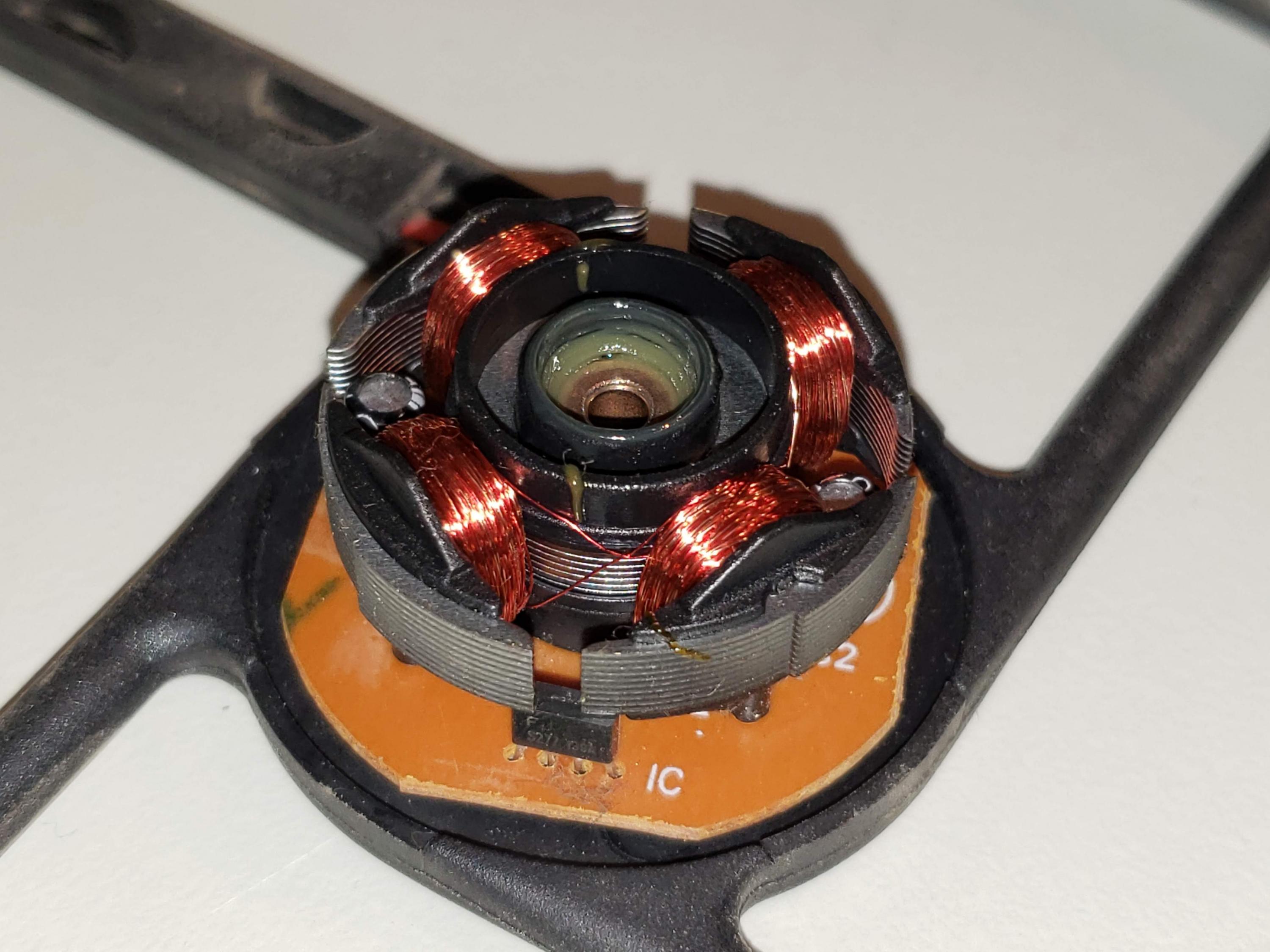

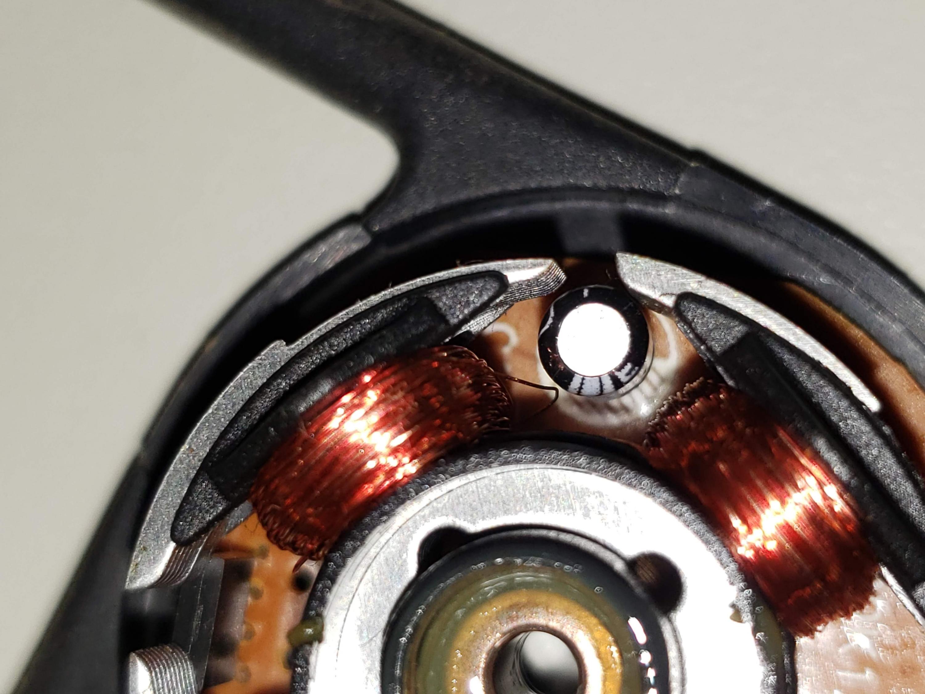

                      I found the issue I believe. I managed to get the shaft off without breaking the tiny clip. I analyzed it and saw a loose piece of wire but then I went to look at the transistor. I barely touched it with a small pin and it moved significantly. I think some/all of the joints are broken or the solder was weak and broke. The trouble is... I can't get the board off! It feels like it's mended into the plastic somehow lol. Does anyone have an idea of how to get the board off without breaking it?

                          • 31051
                          to remove the board you usually drive out the bearing,
                          it is forced in causing the plastic to expand and jam the motor in.

                                    Originally posted by Pentium4
                                    I'm not sure what you mean by 'drive out the bearing' ?
                                    the bronze bushing in the center of the motor is rammed in from one end - you need to use something to drive it out again
                                        I will see if I can take it apart without breaking it lol. If the winding is broken, will it be easy to spot?
                                        Probably not.
                                        But if you can get access to the PCB (should be able to - I'll elaborate), you can check resistance on the windings right at the PCB. Cheap fans like this usually only have two windings... though it will be extremely difficult to tell how their are wound (I still actually haven't figured that out on some of the fans.) However, the IC that most cheap fans use tends to be just a simple 4-pin type, having only Vcc, Ground, L1, and L2. L1 and L2 are the outputs of the IC that drive the two windings. Checking resistance between L1 and ground as well as L2 and ground should reveal if something is broken.
                                        Not in my experience! This is only the second time I've seen this. I've even seen cheap fans seize up and run for years, have their PCB turn dark and still works after cleaning and oiling it.
                                        Same here.
                                        Actually, I revived a fan with a burned PCB and windings 6 months ago, just as a challenge to see if it can be done. Despite the original driver/IC in the fan looking completely burned, it worked absolutely fine.
                                        Also, cheap sleeve bearing fans can run 10x longer with proper lubrication and cleaning. So there's no need to junk them if you see one seized... unless it has burned windings or something that major, of course.
                                        Yes.
                                        First, remove the fan wires from the grooves in the housing. You want them "floating around" and only attached to the PCB.
                                        Next, with a thin cloth (not required but recommended), grip the stator (the metal piece in the center on which the windings are attached to) and rotate back and forth with your hand around the direction of the fan axle/bearing. Depending on how well they (the factory) glued the stator to the center post (typically plastic on cheap fans), you should be able to make the stator turn a little more every time. If not, try heating the stator and housing with a heat gun (or hot air) to maybe 50-60C (so that you can still hold it right after without getting burned) and try again. If not, heat a little higher to maybe 70-80C and definitely use a cloth this time to hold the stator while trying to turn it.
                                        Eventually, the glue holding the stator down to the center plastic post (which also has the sleeve bearing inside) will give. Once you can get it to turn a few mm, start pulling upwards on the stator while still rotating it back and forth. The PCB is attached to the stator on 3 or 4 metal posts, so it should rotate and come out with it.
                                        To check for open windings:
                                        Once you have the stator + PCB assembly, locate the driver IC. Most cheap fans usually use a 4-pin IC, like FS276 or similar (i.e. 2-phase motor driver.) In the case of such, just check resistance to between ground and output 1 (winding #1) as well as ground and output 2 (winding #2.) The other two pins on the IC should be Vcc and ground. So overall, it should be fairly easy to trace out the PCB. If both windings show similar resistance to ground (probably 100 Ohms or less), they should be good.
                                        True. But you don't need to remove the brass bushing (sleeve bearing) to take the fan apart.
