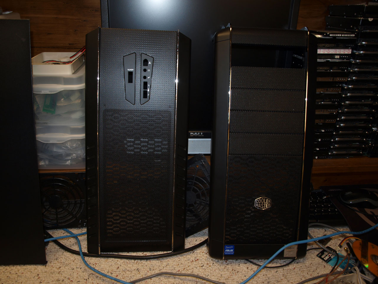

    ..and now for the case....it was a freebie I got from a local printing company a year or so ago, bad Asus P5N-D in it. I can hear Momaka's teeth gnashing over this build already because of the color of the case....but its actually a pretty decent and not over-done CoolerMaster....and here we go!!

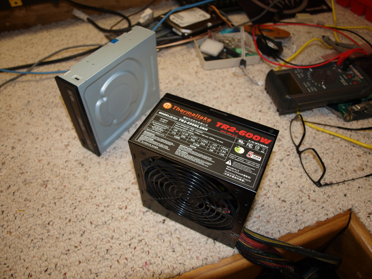

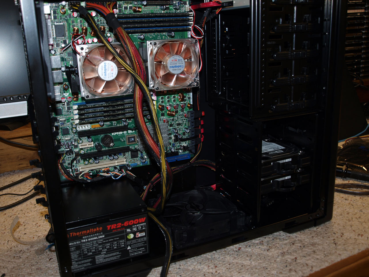

    Thermaltake TR2-600W.... I've seen a lot of mixed opinions of Thermaltake power supplies; this is the first one I've come across. Not sure who OEM's them..... The supply is good....but when the time comes, I'll crack it open and have a look at it for sure.

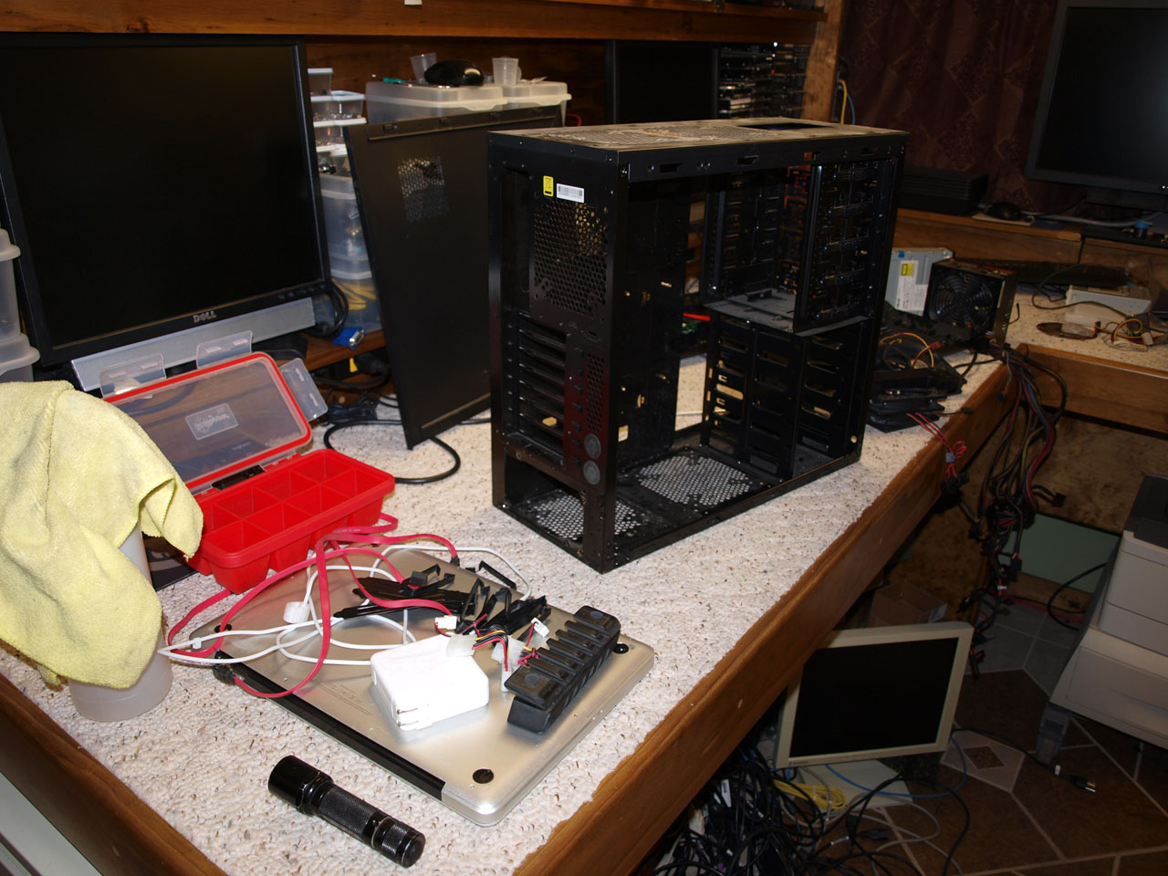

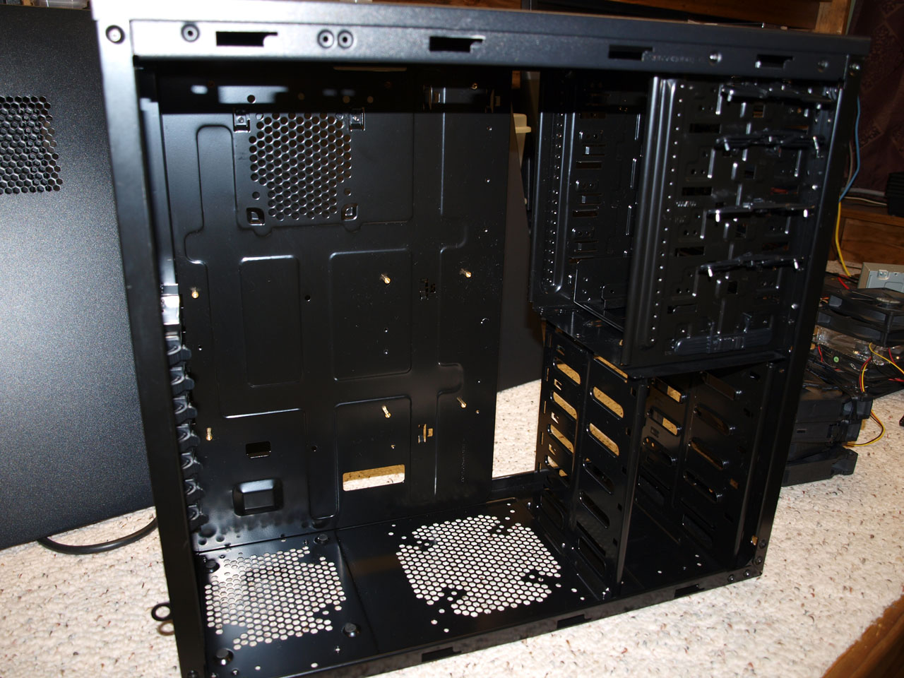

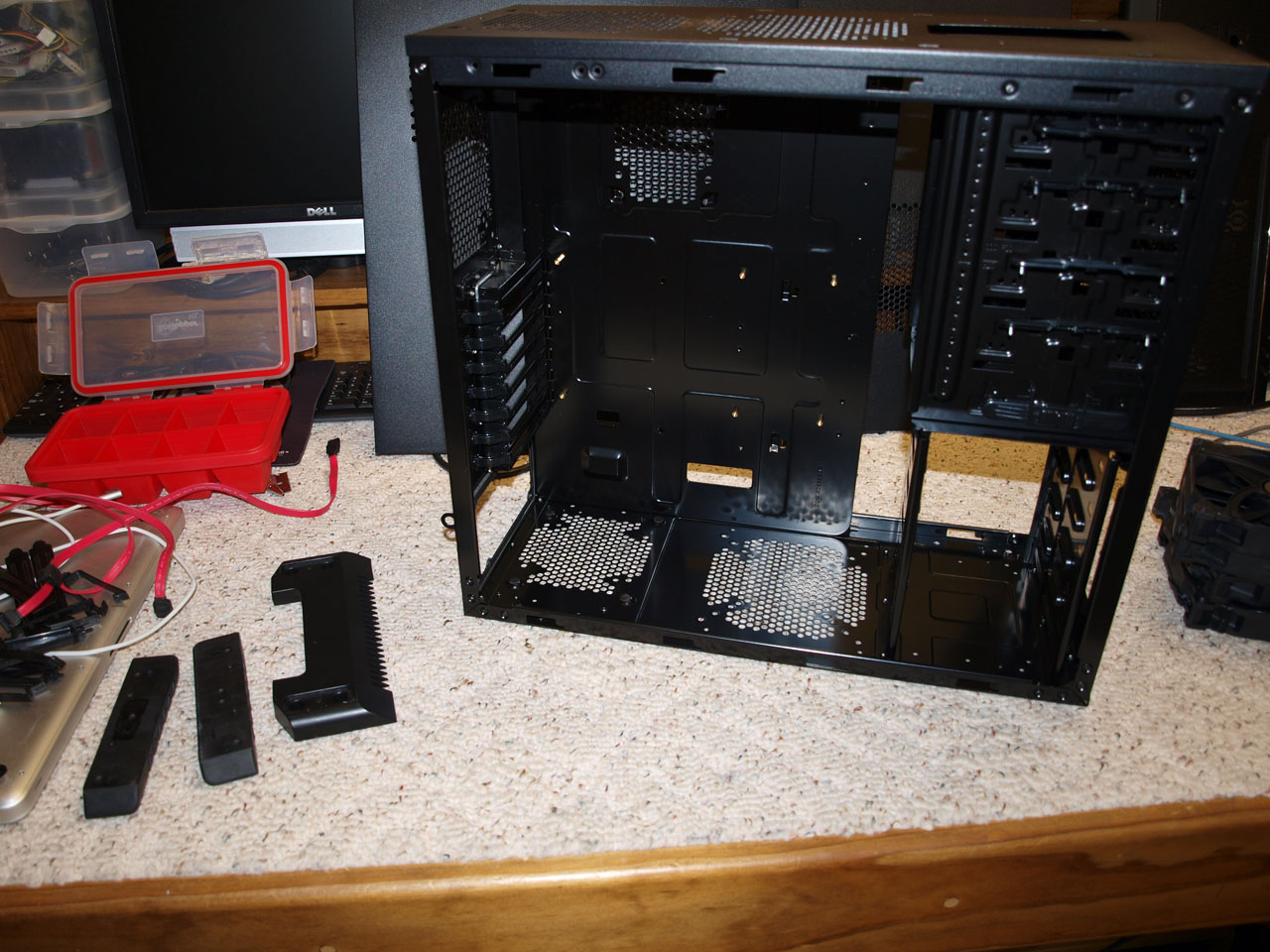

    Now time to start tearing down the case. It doesn't show too bad in the pics, but it's filthy.

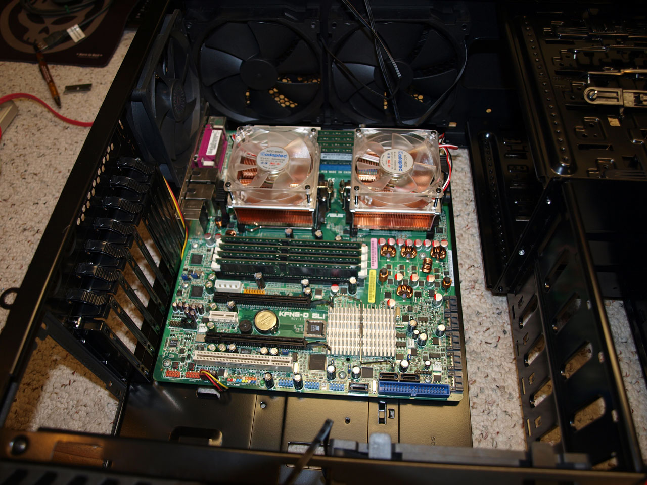

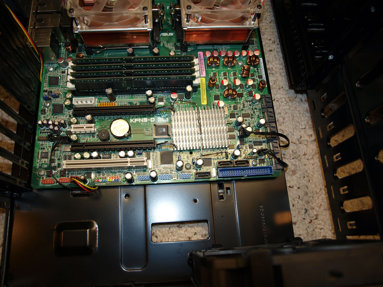

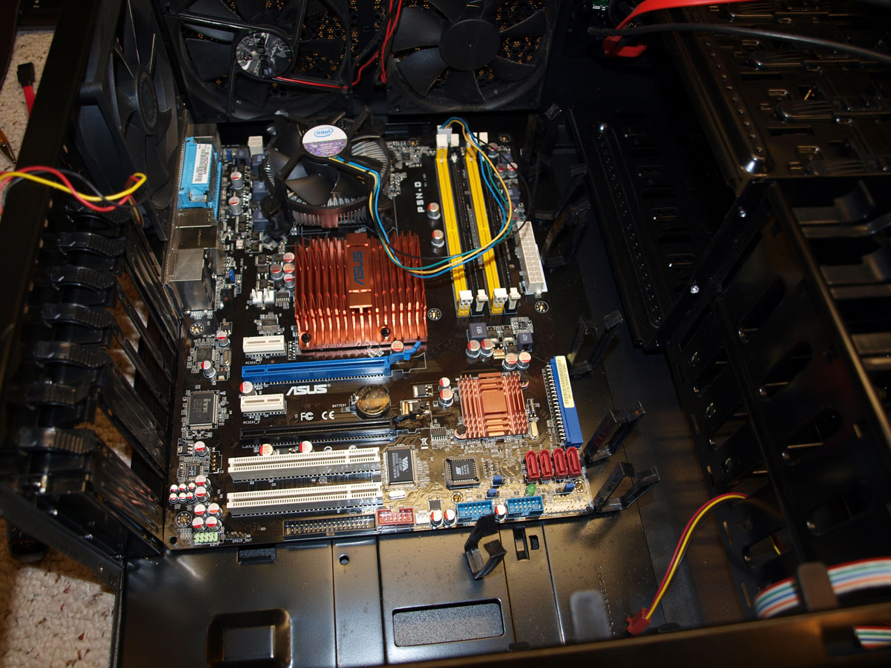

    The bad motherboard....
    I've never seen this before....a block for all the front panel connectors that plugs into the motherboard.... Interesting!
    Bad board out. CPU was a C2D @ 2.1, a bit of a turd for what this board could accept.

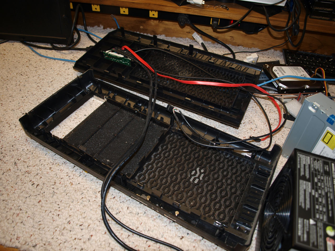

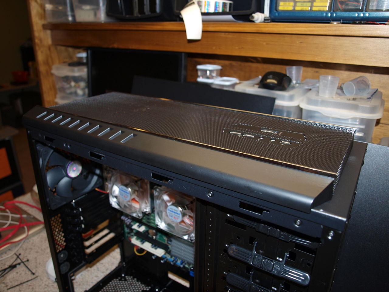

    Case roof & front bezel....again, the pics don't show the filth.
    Front & inside...
    All the fans pulled. This case has many fan ports that are drilled for both 120mm and 140mm fans. Ports that can take 140mm fans will get them....I have a big box full of them.

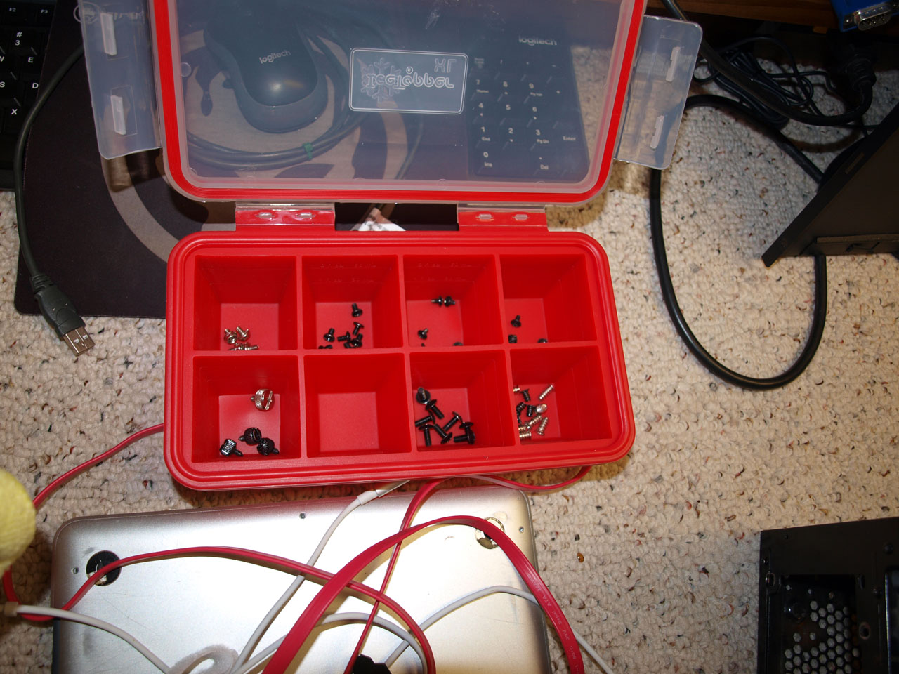

    My wife thought this would be a great screw holder....
    ...and case apart! Next step is cleaning...
          thermaltake psus are oem-ed from channel well technology or cwt. the issue is that thermaltake likes to cheap out on the caps when ordering from cwt and they often have junk caps like junfool, fuh-joo-yoo and what not. definitely crack it open and recap if u want the build to last or run it 24/7 as a server.
            Will do, and thanks for the info.

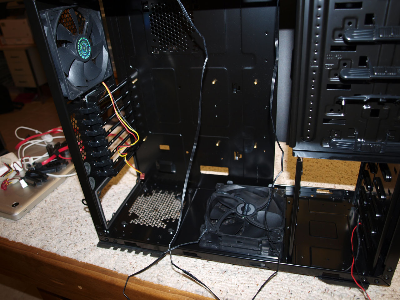

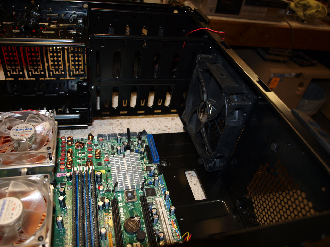

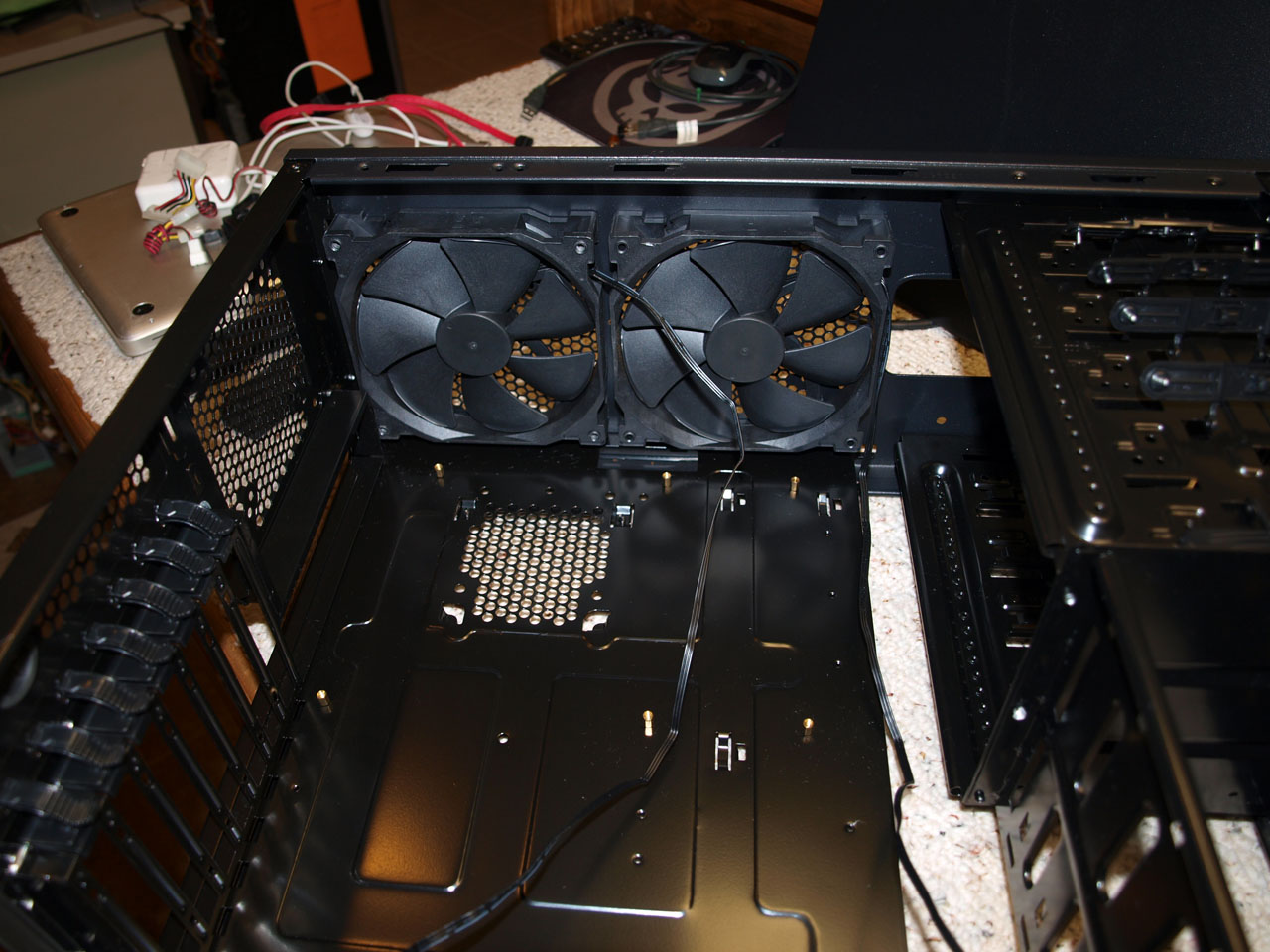

              Re: Asus KFN5-D SLI Kinda Retro-ish Rescue / Build

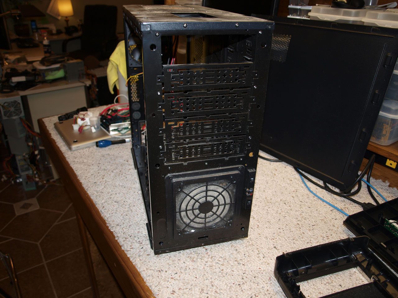

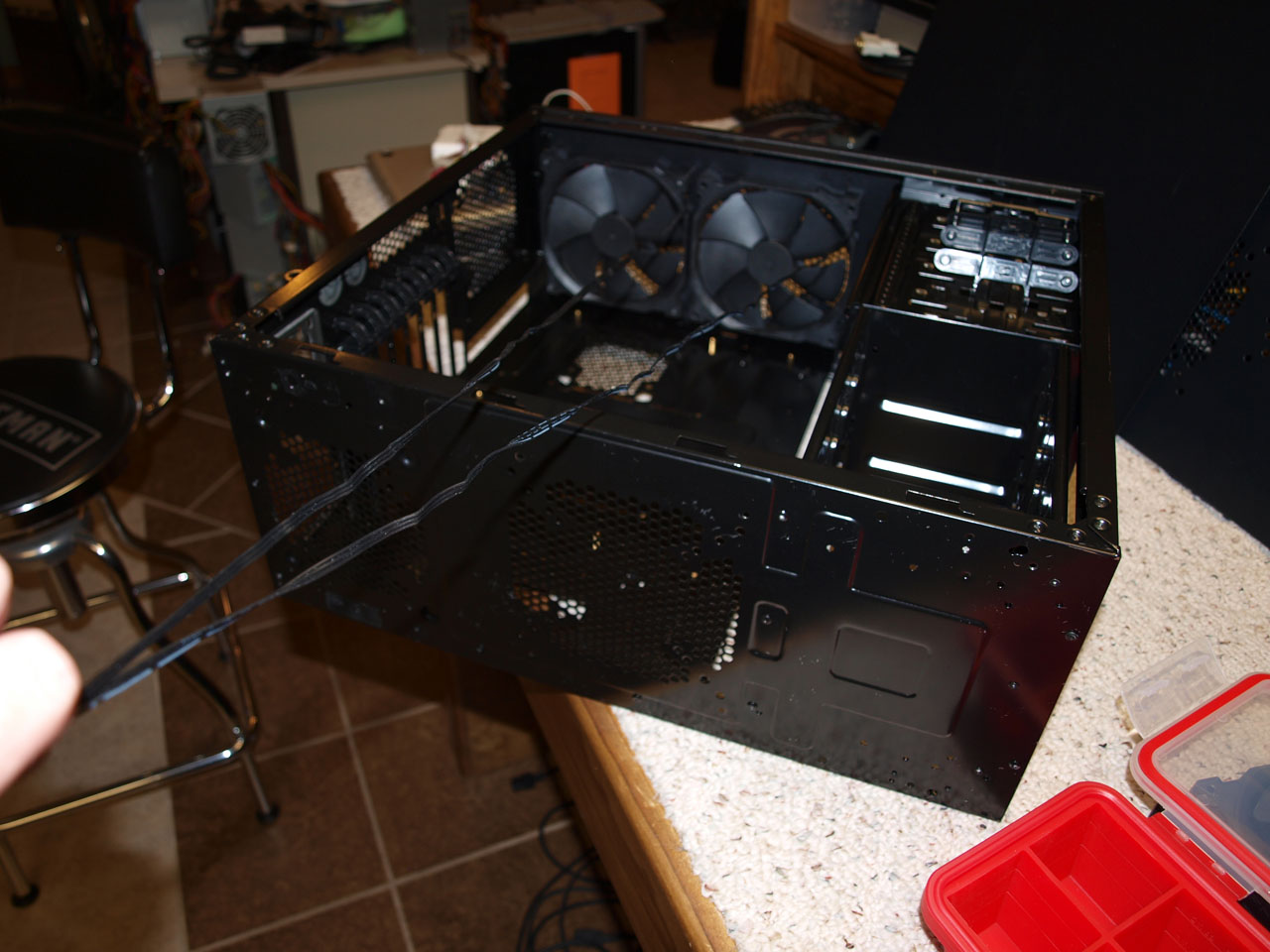

              Case washing time!! The frame was too big for the sink, it had to be done outside.....not a big deal until you realize it was 36*...
              ...but I got it done!!
              Front & top.

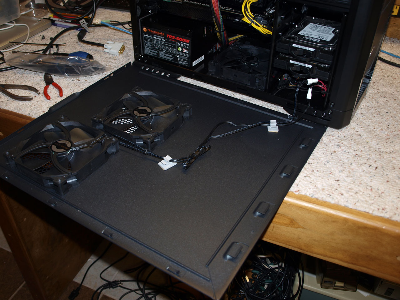

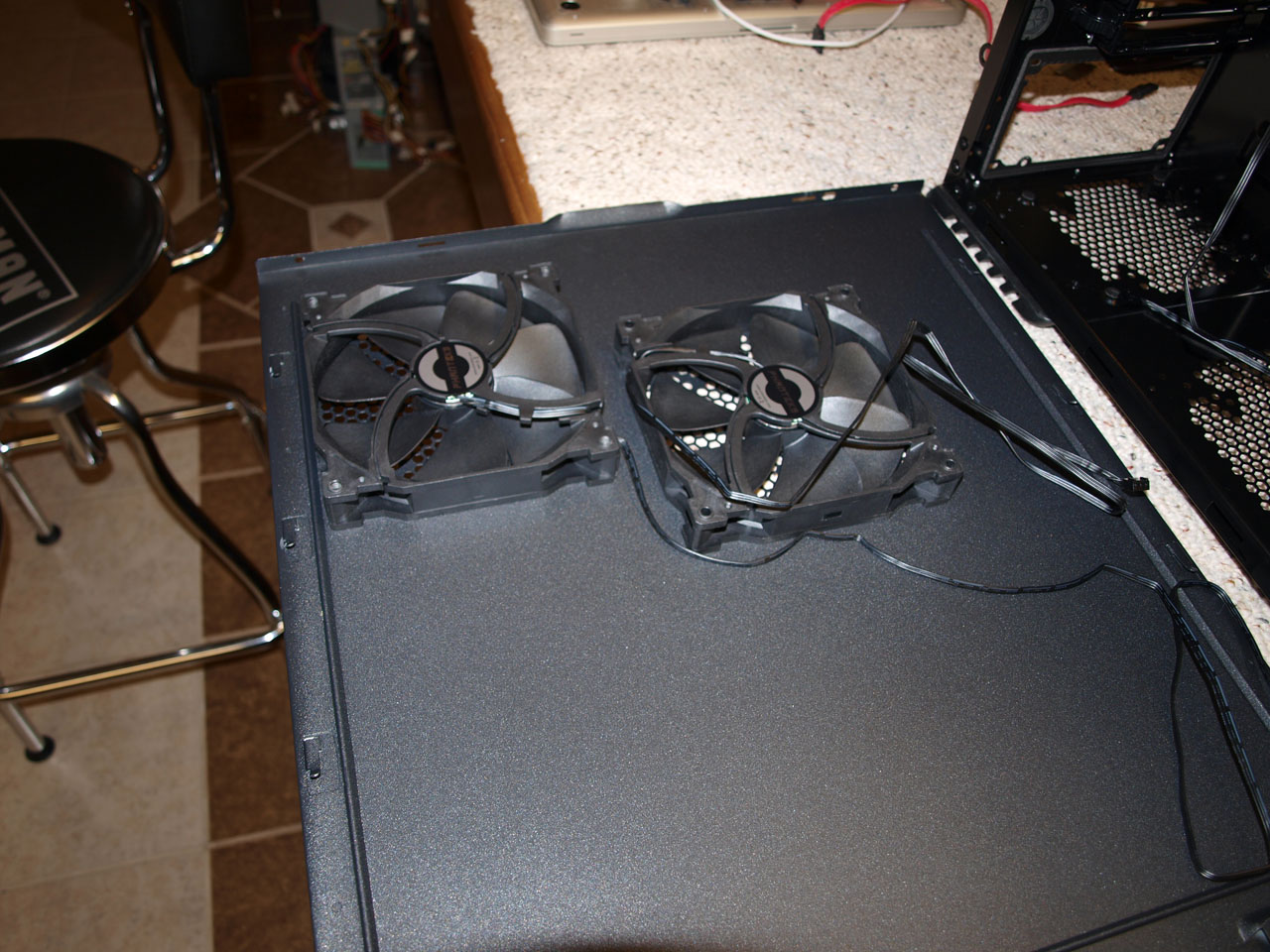

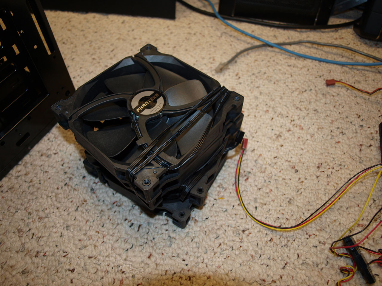

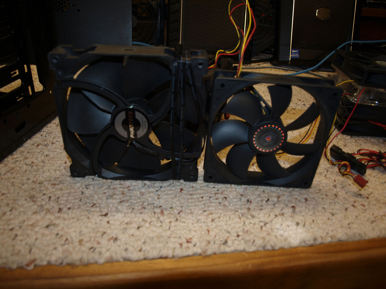

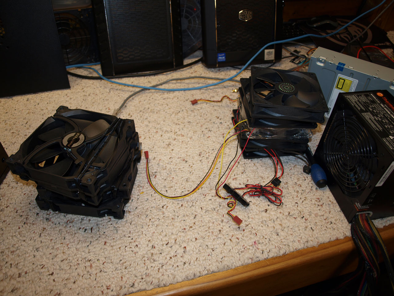

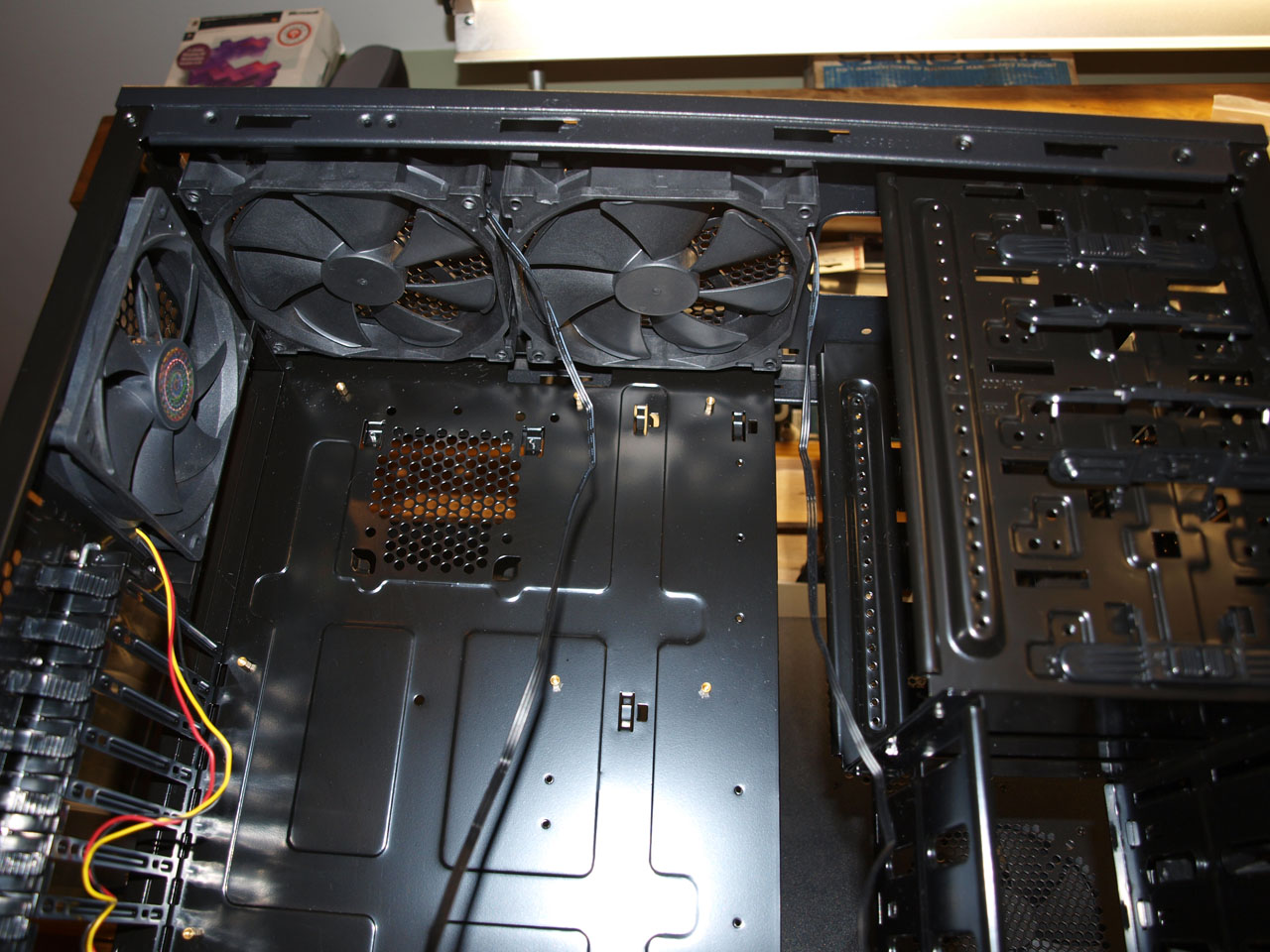

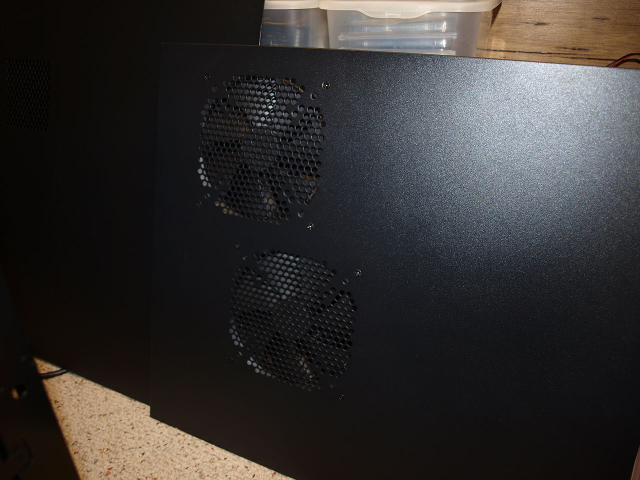

              Now for the fun of the 140mm fans. I got a big box full of these (probably 50 of them) from some R2 reseller for about $15 shipped. Cheap most likely because not many cases can use them....probably not a lot of demand.
              Mounted in the ceiling of the case.
              One upside, they have lots of wire length; a good 30"!! This made for wonderful cable management abilities!
              The left side panel can also take 2 of these.

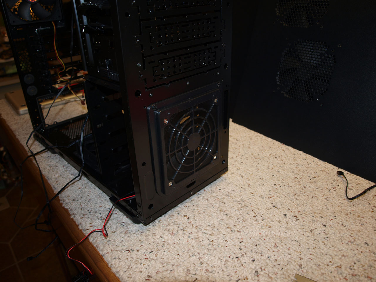

              ...and one more in the floor of the case...
              One of the existing 120mm fans in the front; cleaned of course.

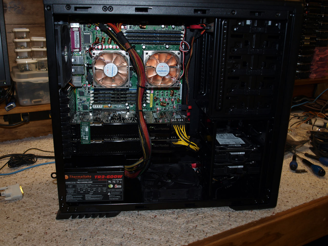

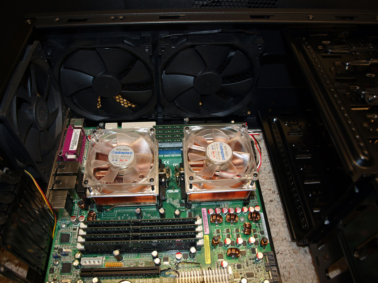

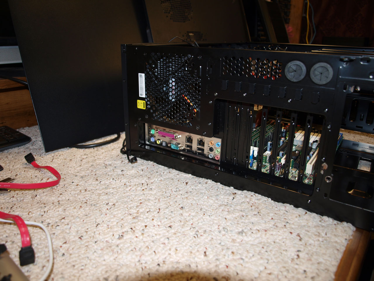

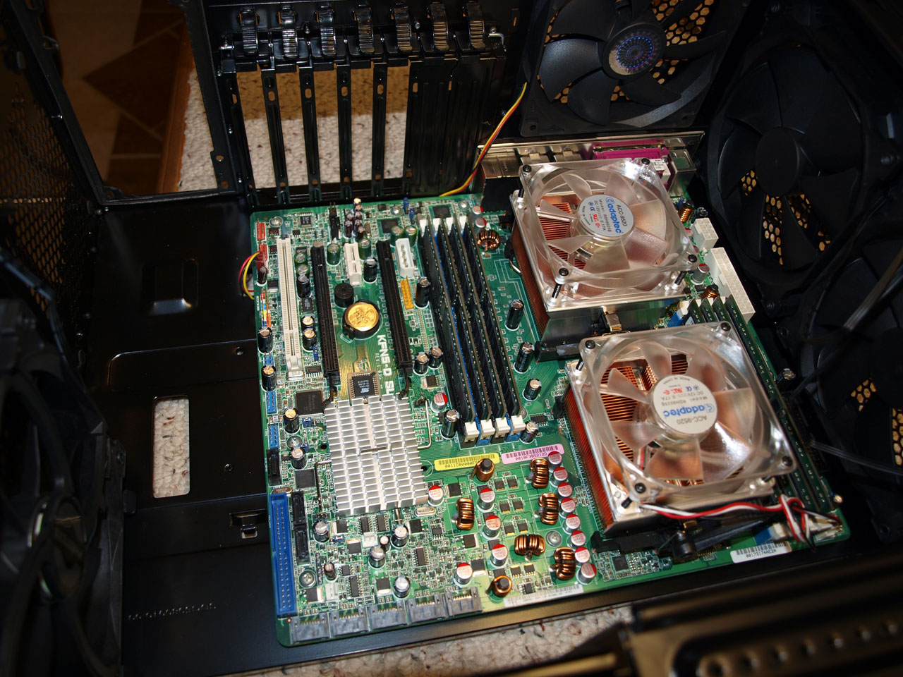

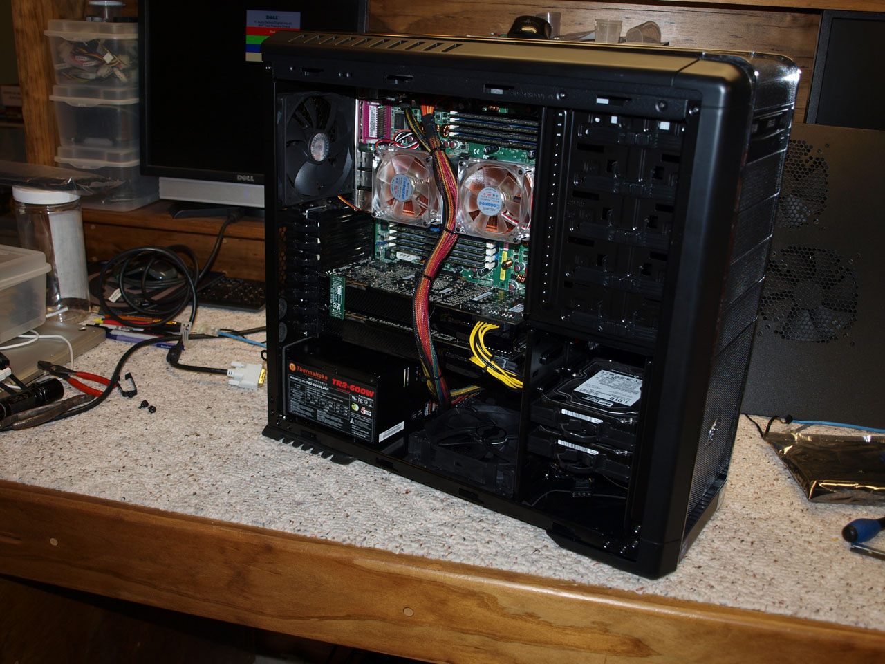

              Now we start to get somewhere! Motherboard mounted.

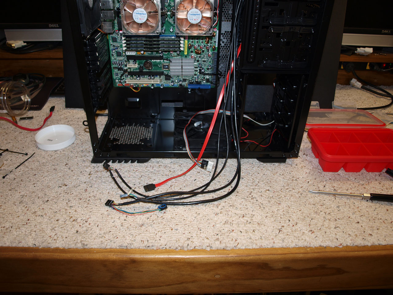

              ...and some of the cable management mentioned above...
              Top of the case reinstalled.
              ...and what's instore for tomorrow...
              This case was definitely designed for good clean cable management. There were big looms mounted AFT of the motherboard on the tray. This motherboard is longer, and would not allow them to be used; I had to remove them...however, there's a good 3/8" under the motherboard tray between the right side panel, along with tiedowns and galleys....so it will still look marvelous when I'm done. Tomorrow is the power supply rework and whatever else I feel like doing.

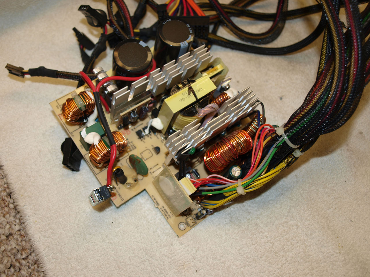

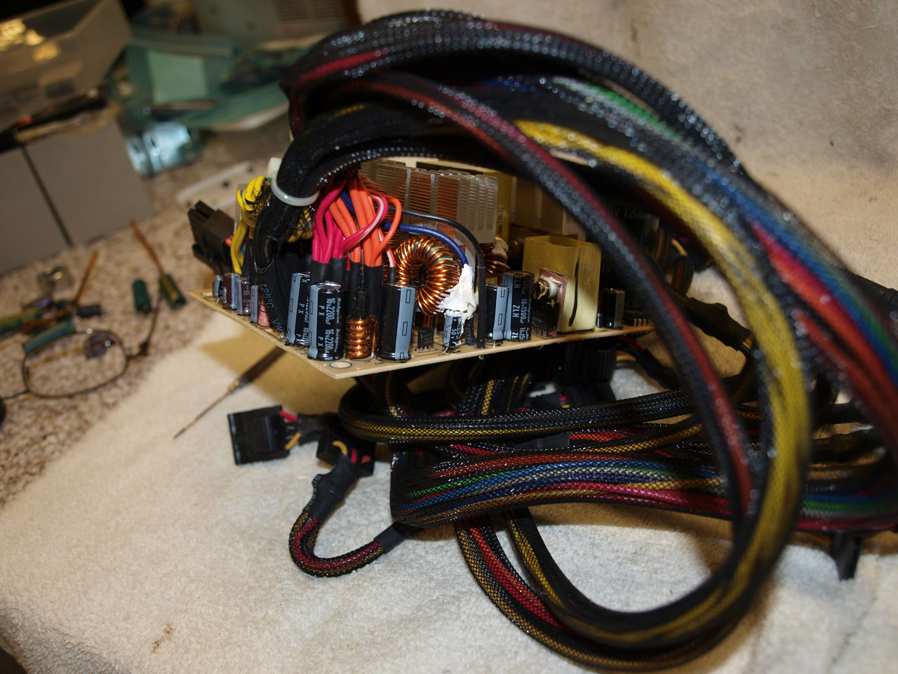

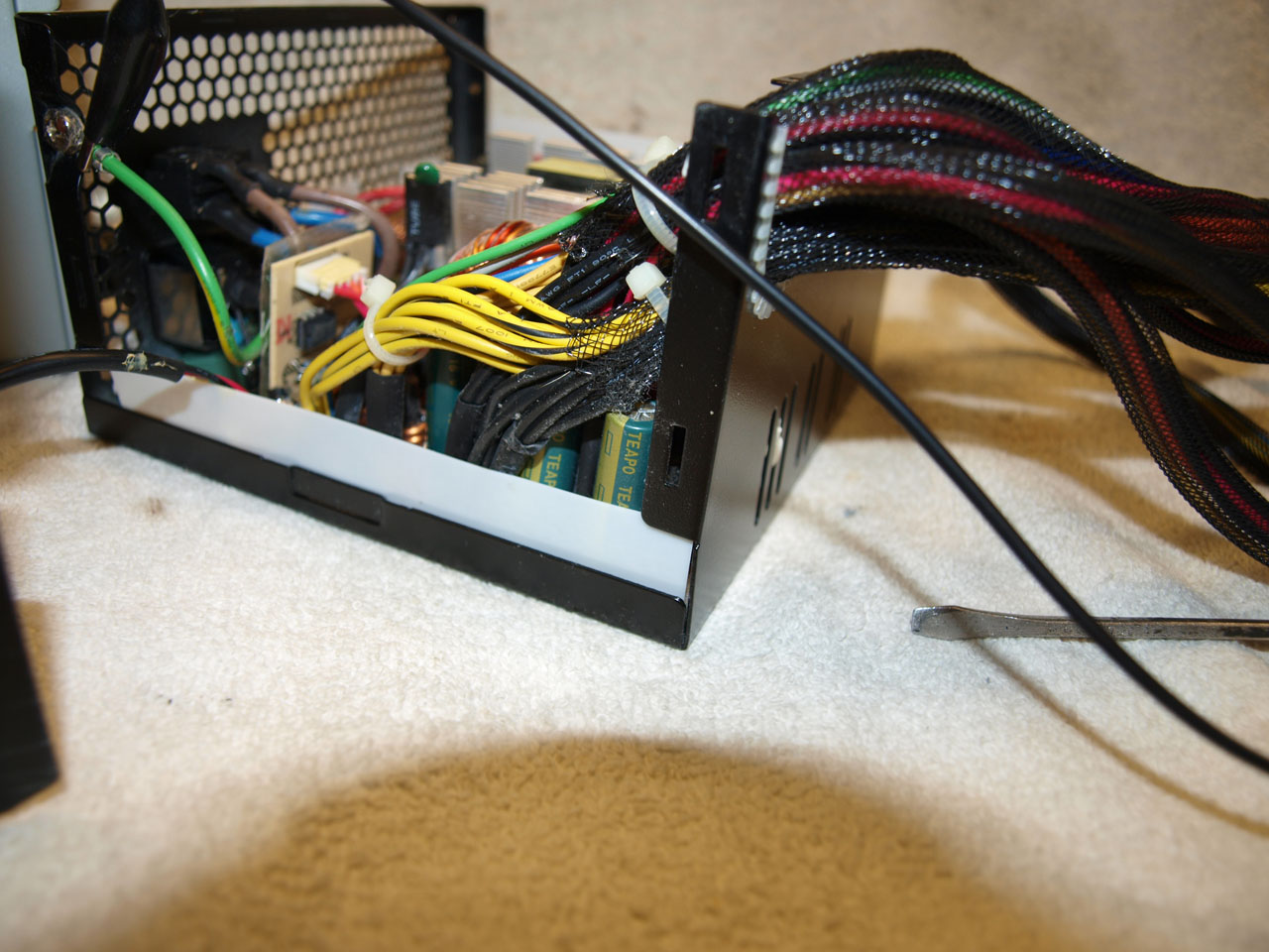

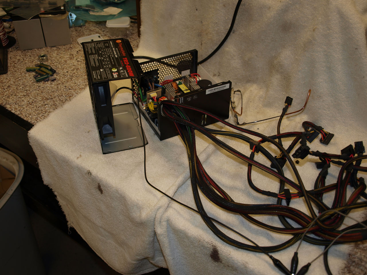

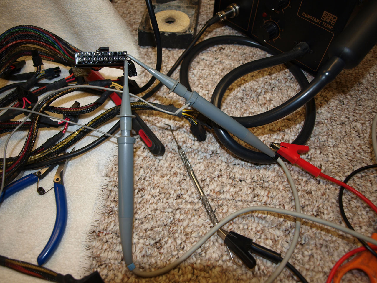

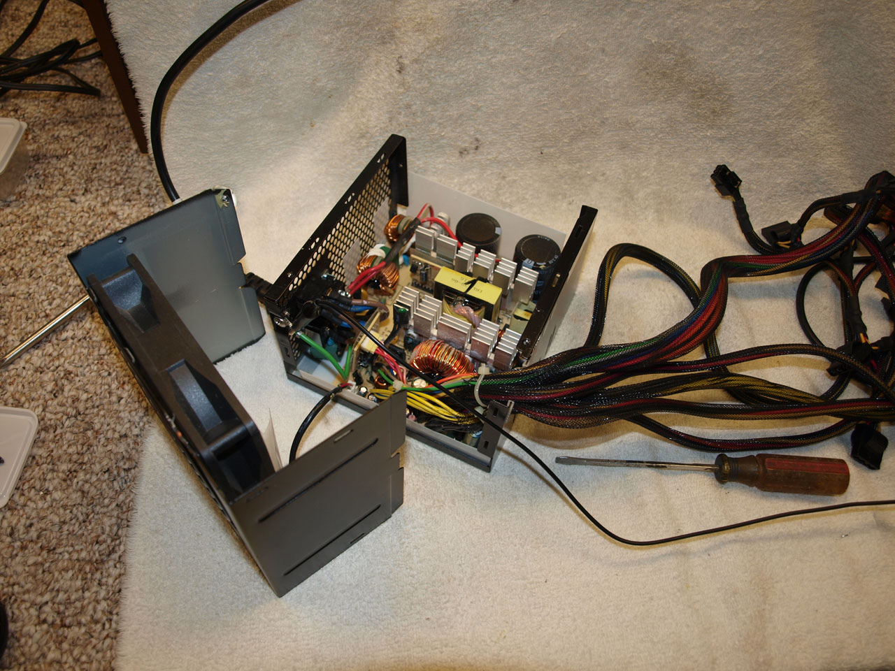

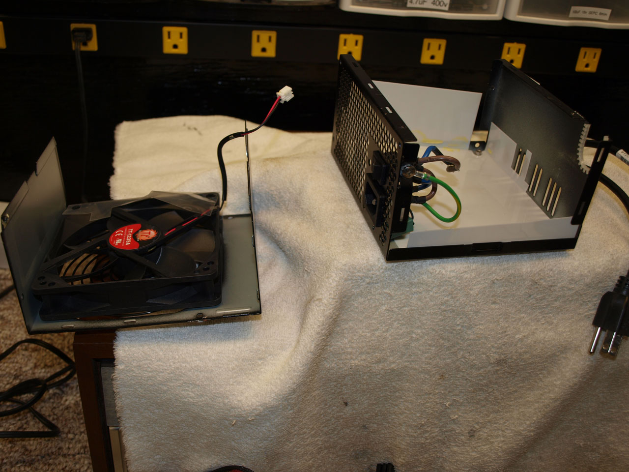

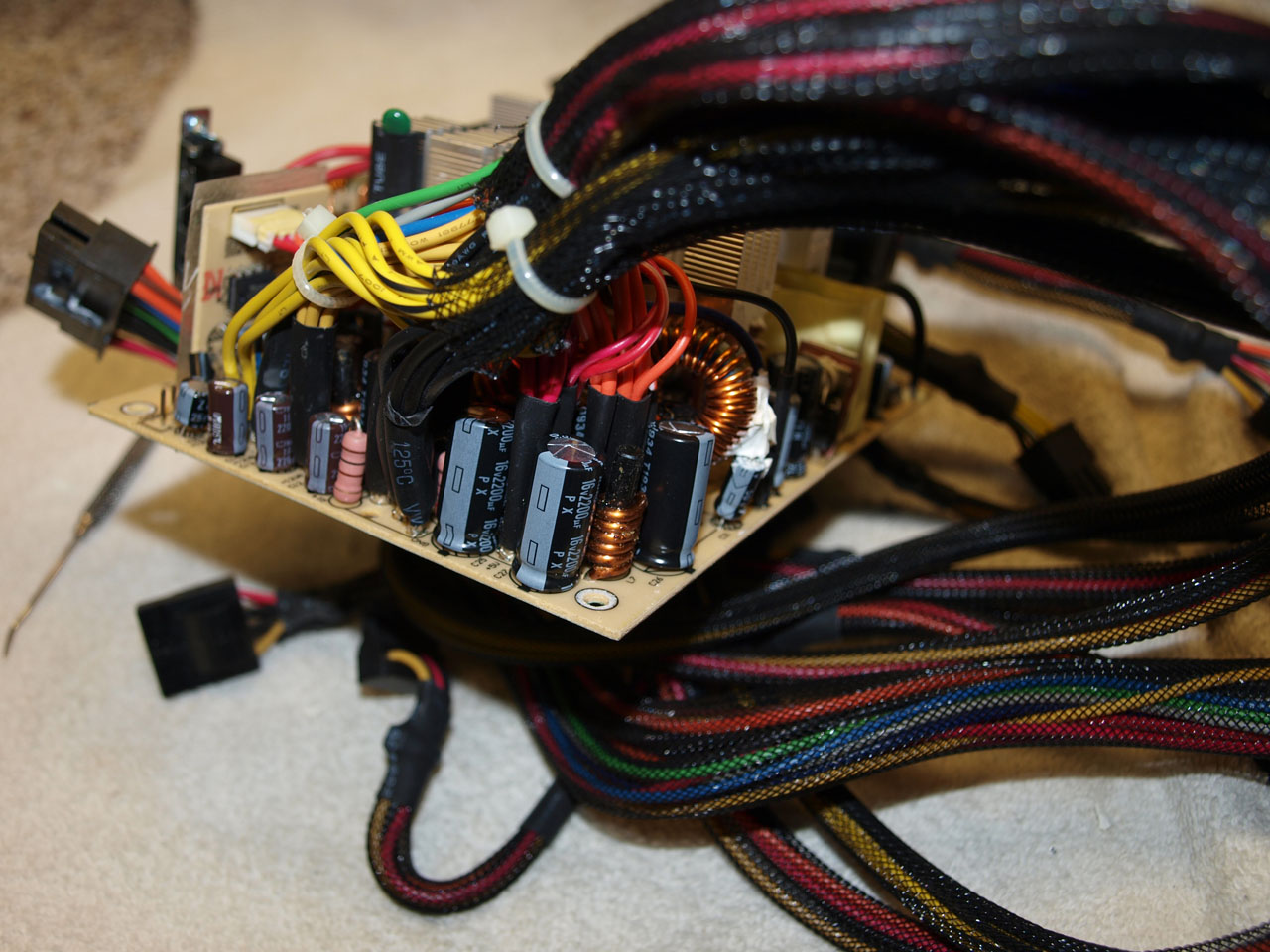

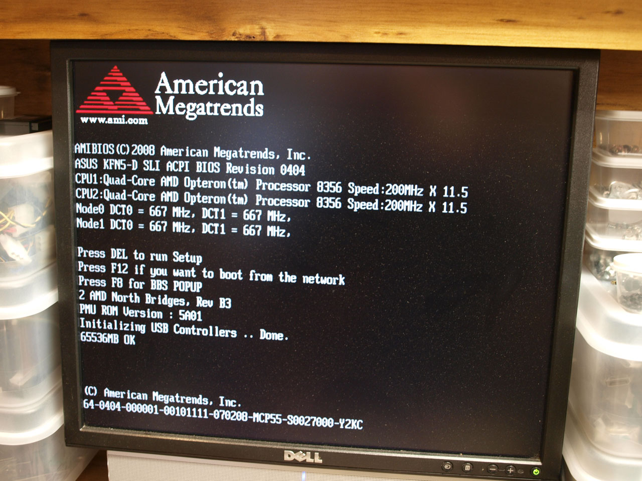

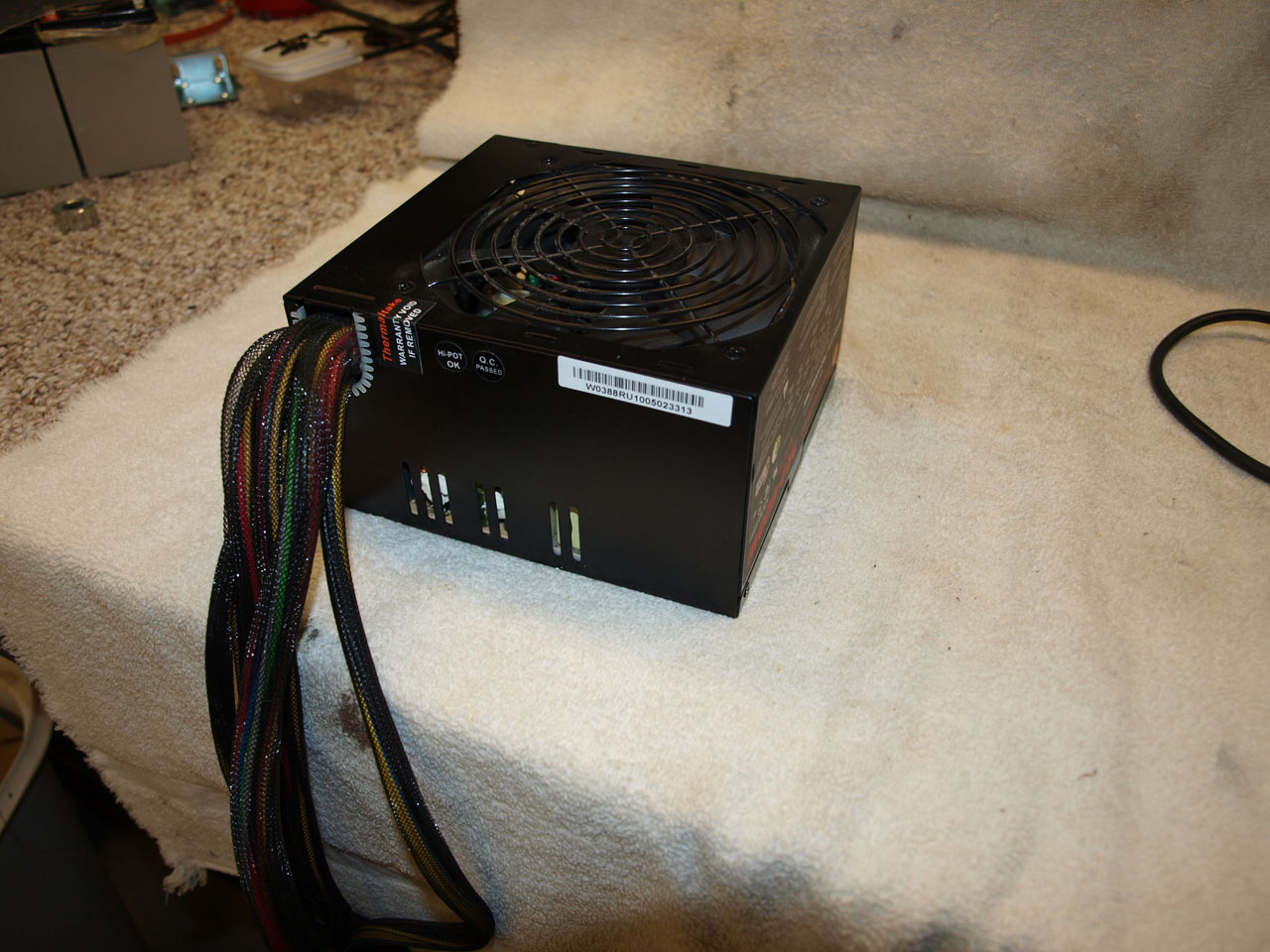

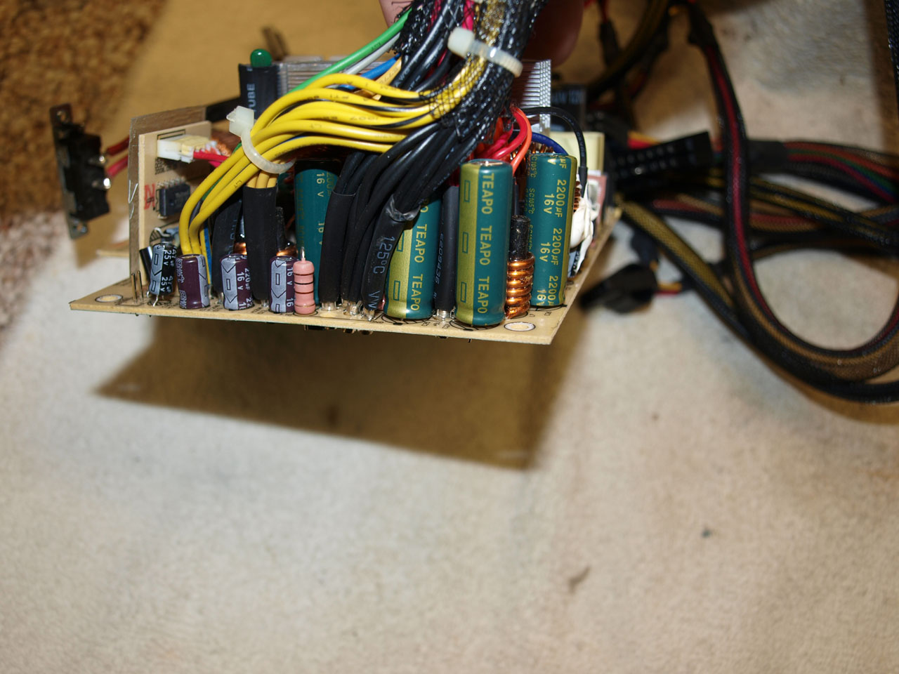

                          .....and here goes the PSU....
                          Cracked open.

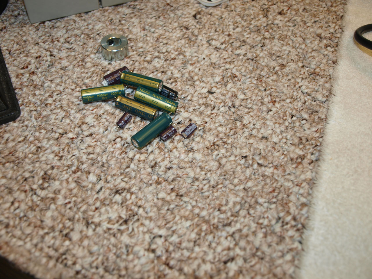

                          Secondary full of Teapo and Sa'con.

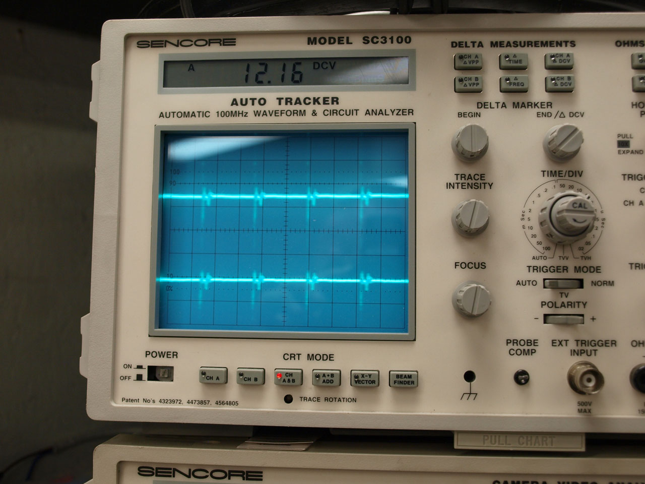

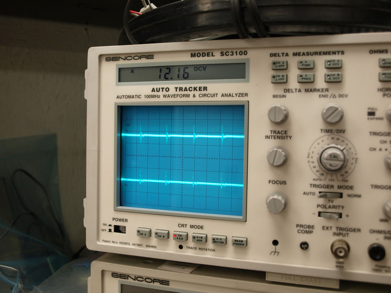

                          Quick peek at the outputs with the scope prior to recapping...
                          Ch.A (top) is the 12v rail, Ch.B (bottom) is the 5v. Uniform across both rails, not horrible....but not great.
                          ....and here we go!
                          I didn't have any 2200uF 16v KZE or KZH in a 10mm diameter, only 12.5....which would not fit...so I used Rubycon PX. Acceptable choice for this, but not my preferred.
                          Time to probe it again....
                          A little improvement.
                          The old caps.... The teapos capacitance was in spec, ESR was reading a little out (high), but not alarmingly so. THe only ones that were way out were 3 of 3 220uF 16v Sa'con. They were reading half their rated capacitance.

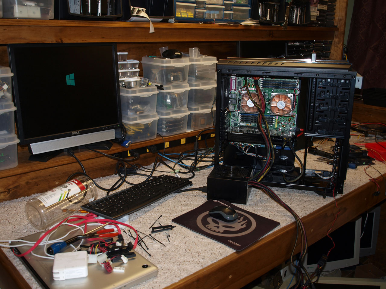

                          Now for the acid test!!
                          It POST'd!
                          So far so good booting Hiren's.
                          ...and here's she is, viewing her own thread on herself!

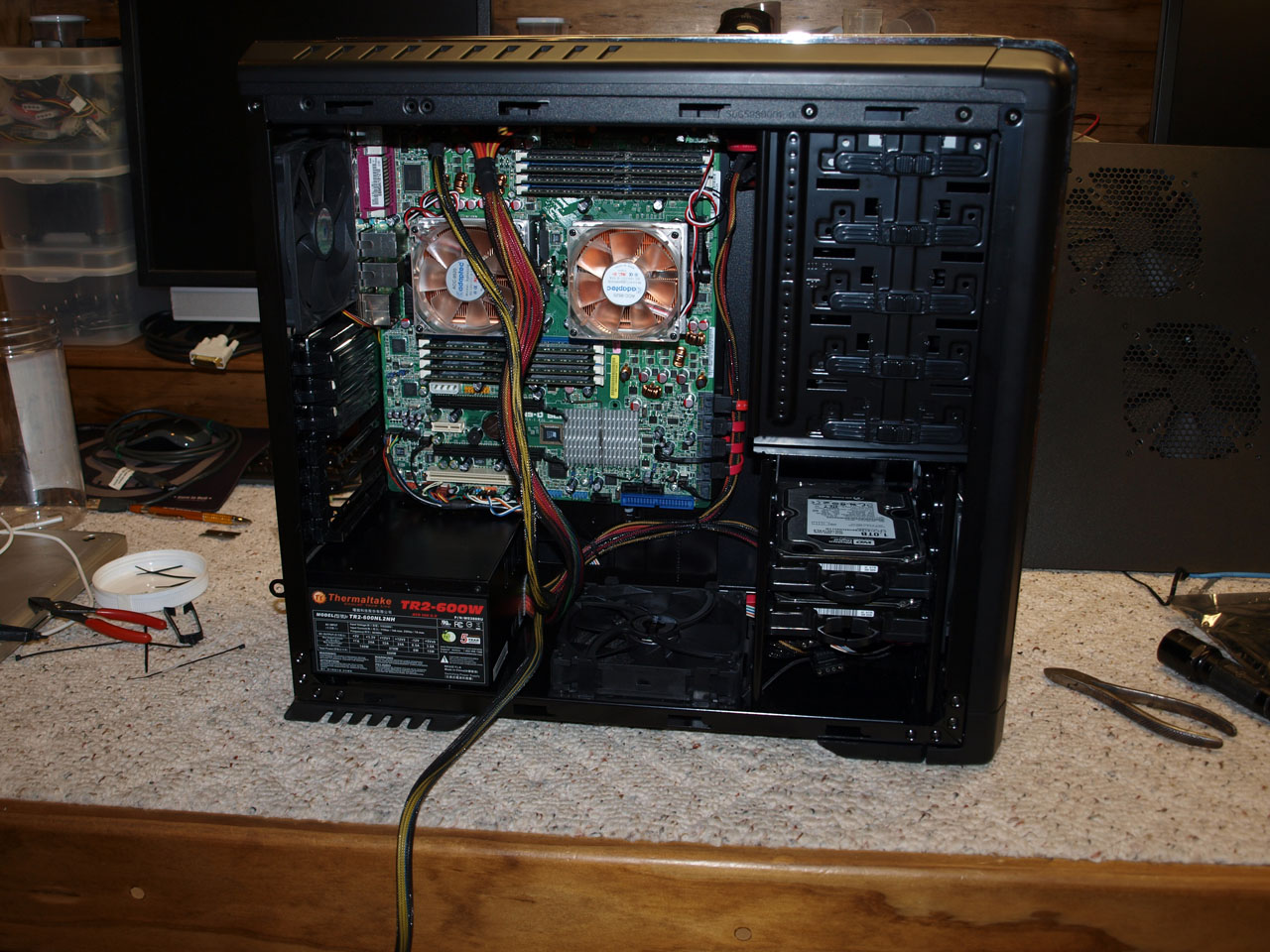

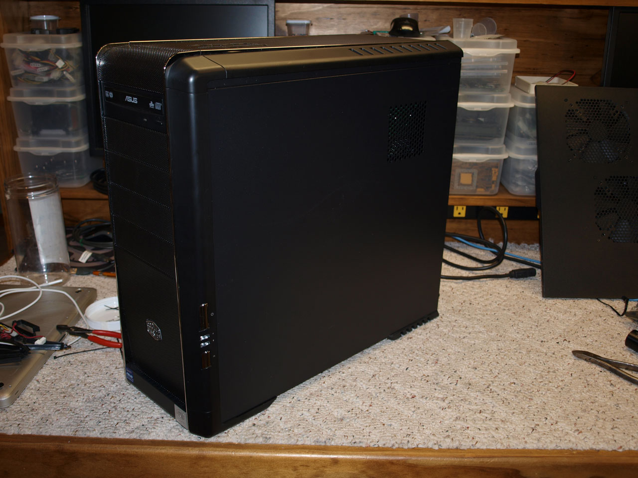

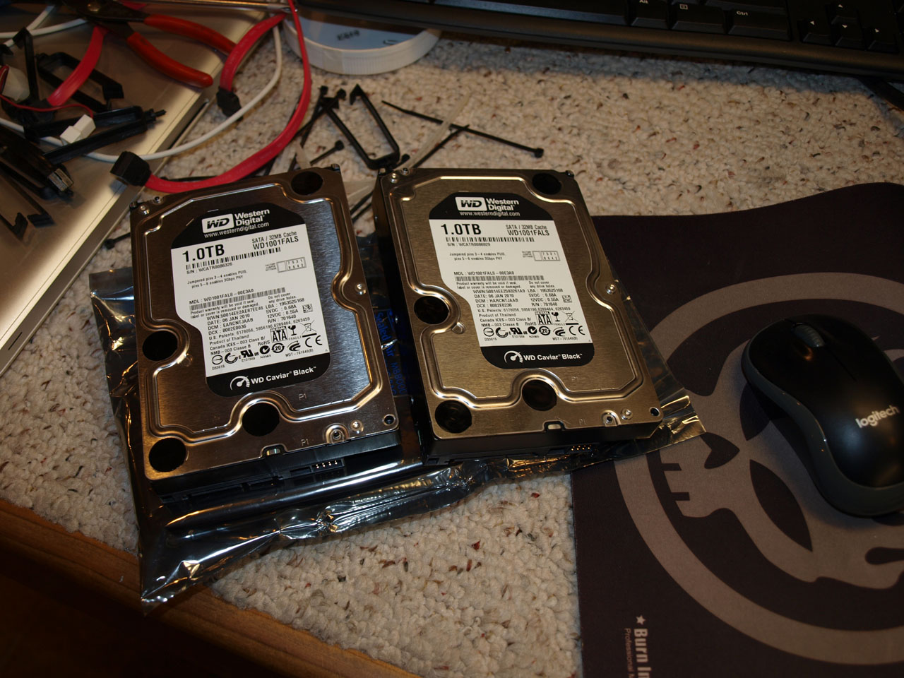

                          Now to finish assembly. Had to pick HDD's....and there's a pair of 1tb WD Blacks.

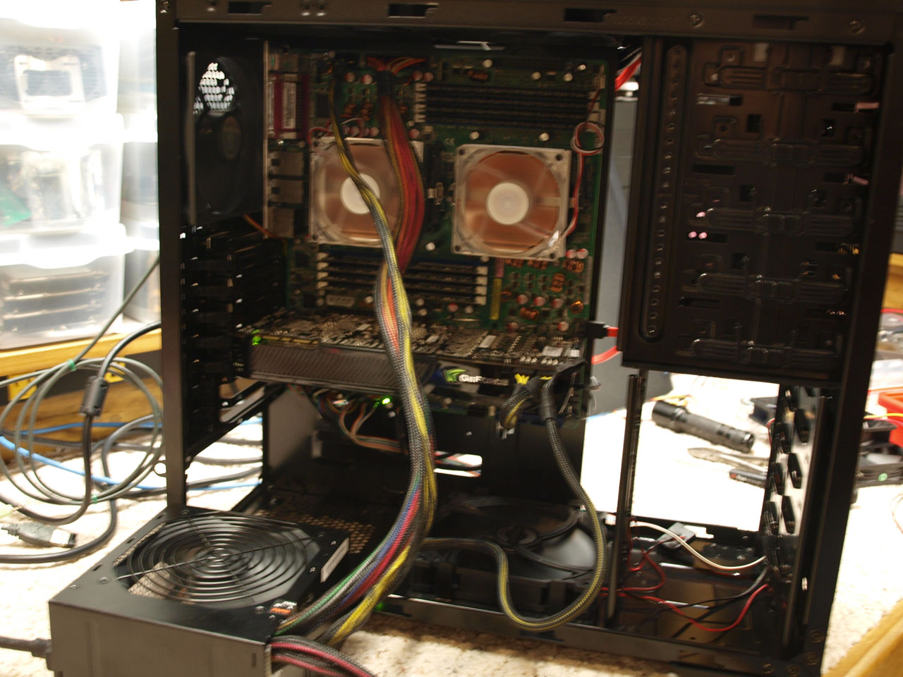

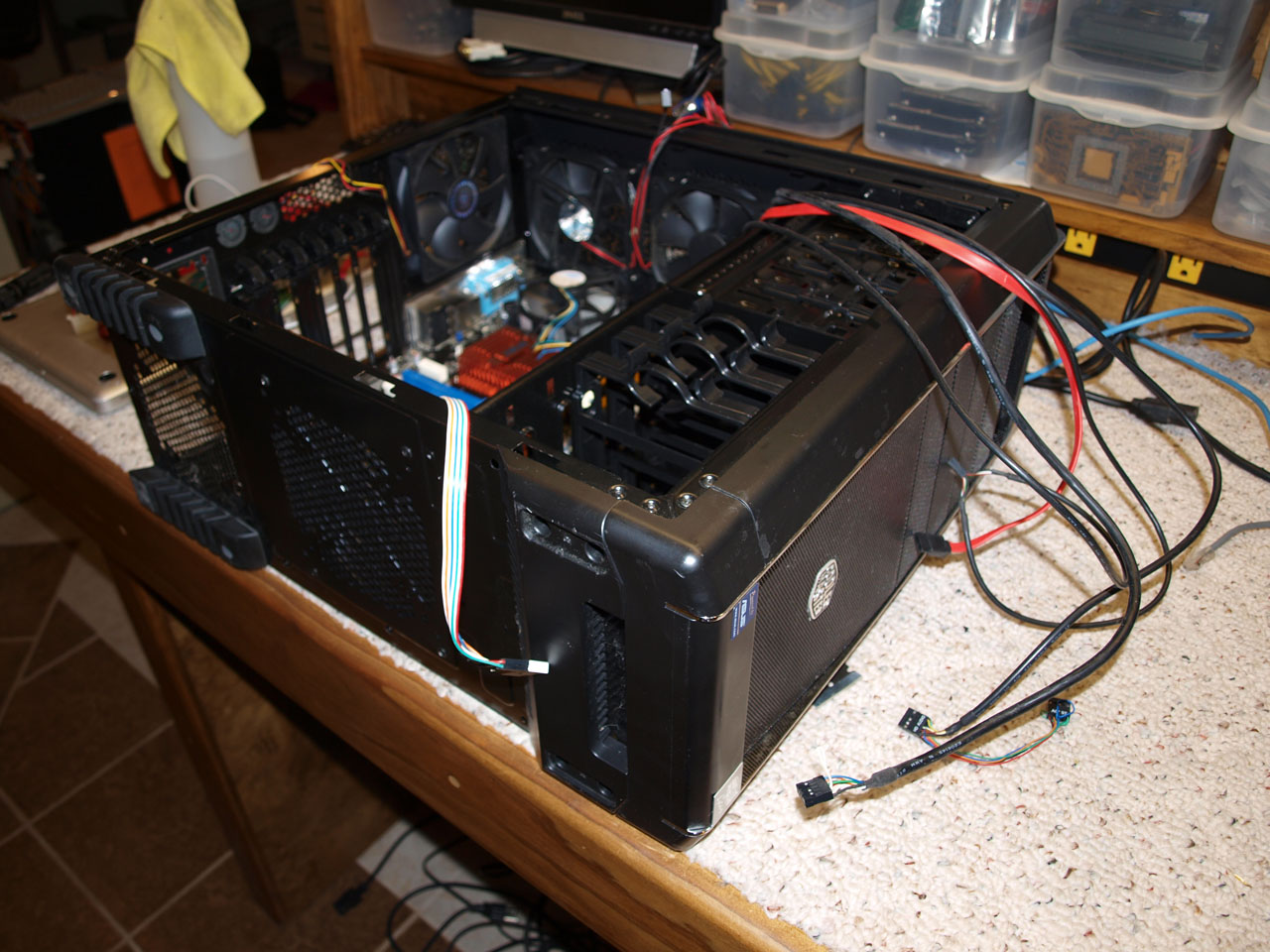

                          Cabling tied up and right side panel installed...
                          Getting closer!
                          GPU's installed.
                          Stick-on holders on the left side panel; keep the wiring out of the fans.
                          ...and installing Win7... I thought about XP64, it would scream on this...but so will 7!
                          That's as far as I got....it was dinnertime by the time I got done installing 7.....I didn't get a chance to install any drivers or abuse anything. This is a power-hungry beast, it will definitely be a good test of mettle for this power supply! I may also tinker around with the other GPU's as well....but those are way too new for this core hardware to be deemed period-specific. I did have to steal a SLI bridge from another build....I knew this build was coming and ordered a few early last week....but welcome to the USPS in December...they're already 4 days overdue....but the completion tomorrow!
                              I saw "Su'scon", which were around in goods before the dreaded "Sacon" caps found in some Soyo motherboards. Is "Su'scon" the same company? WTF?!

                                Su'scon and Sacon are different companies.

                                  Both are junk....so yea....pick one.
                                  The PSU is holding up...but you can tell when its got a load on it....its got a bit of coil whine....

                                      the only thing i've ever liked about thermaltake psus is the fan delay cool feature. some of their psus have it and it works by running the psu fan for 1 minute even after power off. it helps to cool the system down if u power it off immediately after heavy load. without such a feaure, the system temp could increase by a few degrees for a few mins after power off and might cause overheating if u run the system close to its thermal limits.
                                      its a cool feature but i learnt how to leave the system idling for several minutes to cool off after heavy load before shutting it down. so the fan delay cool function on thermaltake psus is not really critical for me now. good caps are more important!
                                      and as for sacon (suck on) caps, yea, momaka really hates those. he has recapped tons of video cards with vented suckons, so much so that the paper roll in the cap is flying out of it. not sure if u still remember the pictures he posted. lol!

                                        I did finish this the other day....I just didn't take any more pics....there wasn't anything to show that hasn't already been. Under loads, the PSU was groaning a bit but it remained stable. The nvidia driver crashed/recovered a couple times inexplicably with both the GTX285's and the GTX560ti's. The seat of my pants tells me it was the PSU, but the frequency wasn't high enough to get overly excited....and only under higher graphics loads (games & benchmarking). I'd swap out the PSU, but I don't have any others here strong enough to take on the loads of this power sucking system...so I'm calling it done for now until I come across a better one.
