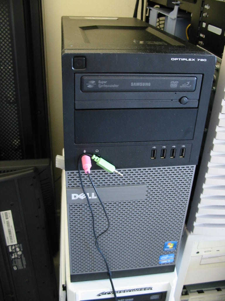

            Dell OptiPlex 790 for a Gaming PC
            So in the Winter of 2017, I acquired a bunch of used/broken desktop PCs from a shop that was cleaning out its storage. Most of them were from the Core 2 Duo and Athlon II era or older. There was one “modern gem” among them, though (at least by my PC standards ): a Dell Optiplex 790 MT (“mini tower”) with a Core i5 CPU.
            For a few years, I kept the system mothballed, thinking I still wouldn’t need a Core i5 for the games that I played currently (Fortinite, CSS, CSGO, Dirt Rally, and some others.) And for the most part, this was true. My EVGA 780i-SLI / OC’ed Core 2 Duo Q6600 build (posted here) was still holding up in the previously mentioned titles. However, Fortnite with its constant updates really started bogging that PC down to the point the game was unplayable (FPS in the 20’s on average, frame time full of spikes lasting up to 1-3 seconds and sound stutter – a sign of severe CPU bottleneck.) Moreover, I started getting into frequent instability issues with the Q6600 build (I suspect a dying nVidia chipset on the motherboard.) On top of that, the heat output from the OC’ed Q6600 with the GeForce 560 GTX GPU was a little too much for hot summer weather.
            Therefore, it was time for something new(er)… but something that still had PS/2 ports, because apparently I’m still stuck in the stone ages with my oldschool mice and keyboards with no intent of changing those any time soon.
            The Dell Optiplex 790 fit the bill. The Optiplex 790 not only has two PS/2 ports, but also even a serial port (now even I don’t need something that legacy! ) Ports aside, I picked up that system completely barebones – only CPU, motherboard, a single 2 GB stick of DDR3 RAM, and the stock Dell 240 Watt PSU. No video card or HDD included. The case was also missing a side panel and damaged… but more on that in a bit. I can’t complain, of course – it was a freebie PC after all!
            When the warm summer weather of 2019 rolled in, I had enough of the hot-running and crashing EVGA 780i-SLI mobo. I took the Optiplex 790, threw in a spare 250 GB HDD (WD Blue), 4x 2GB Samsung DDR3 RAM (to test all RAM slots), and a better PSU. I then proceeded to install Windows 7 Pro (as per the COA on the case) in order to test the system. All tests passed and the stock CPU cooler actually seemed good enough for the job. After this, I swapped the RAM to 2x 8 GB modules and put a Diamond Radeon HD6570 2 GB DDR2 video card. Then, time for games – namely Fortnite first, because this one seemed to be the most CPU heavy. It ran very well, with consistent frame time and 45-60 FPS (capped at 60 FPS) – more than double of what I was getting on the Q6600 build, despite it having a much superior GTX 560 video card. Of course, for the HD6570, I did have to drop the render scaling to 50% on a 3D resolution of 1280x960. This shouldn’t be surprising, though, given the HD6570 is a rather weak card with only 8 ROPs and 24 TMUs. But even running the same graphics settings on the GTX 560 and Q6600 didn’t improve performance – still had terrible frametime and low FPS.
            So, compared to the OC’ed Q6600 build, the Optiplex 790 system really was flying. Not only that, but it gave me ZERO issues during any time of the setup and testing process (unlike the EVGA 780i-SLI mobo, which took a lot of convincing to get it to work with 8 GB of RAM.)
            Eventually, I upgraded the GPU in the Optiplex 790 with the Gigabyte Radeon HD6850 I rescued (posted here), and BOOM - my new gaming PC was born! Less power-hungry and faster at the same time.

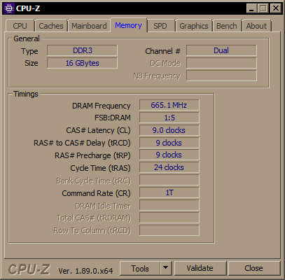

            Current specs of the Optiplex 790 system:
            CPU: Intel Core i5-2500
            RAM: 16 GB DDR 3 PC12800 @ 667 MHz (2x 8 GB Samsung M378b1g73eb0-yk0 sticks)
            Video: Gigabyte Radeon HD6850 Windforce with 1 GB DDR5 [GV-R6850C-1GD rev 1.2]
            HDD: single 250 GB Western Digital Blue (7200 RPM, 3.5”, SATA)
            Optical: Samsung Writemaster DVD-RW of some kind (currently disconnected, but still installed in the PC if needed. Reason: it’s complicated.)
            PSU: 350 Watt continuous / 400 Watt max. FSP Group AX400-PN recapped
            OS: Windows 7 Professional SP2
            For keyboard and mouse, I stole the Gateway G9900H and Logitech M-S69 combo from the Q6600 build. Monitor: a CRT of some kind, as always. (a 19” Dell currently.)
            Some pictures/screenshots of the hardware...
            Front:

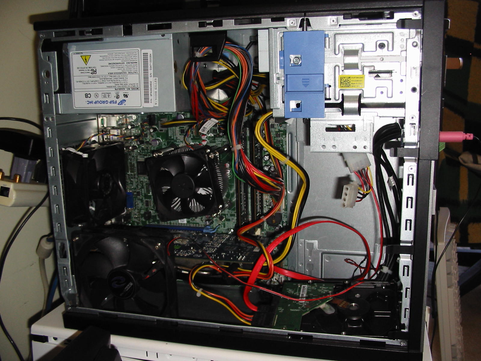

            Side (and lack of sidepanel )
            Specs from CPU-Z and GPU-Z:
            Of course, this wouldn’t be a momaka build without any ghetto repairs, right?
            I’m sure many have already noticed the loosely “installed” side 120 mm fan and un-mounted HDD. But those are not the only thing. The main issue with that PC was with the rear expansion card bracket, which I fixed in the following manner:
            I’m not exactly sure what happened to the case, but when I picked it up from the repair shop, the expansion card rear bracket area was all mangled and chewed up. Even the I/O shield on the motherboard was damaged. The simplest and cheapest solution/fix was to cut and grind all of the damaged metalwork with my angle-grinder and rotary cutter. After this, the case had no bracket for the expansion cards, so I made my own from an aluminum L-channel piece. This was much needed in order to have a discrete GPU card in the system.
            It’s a ghetto fix sure, but it works well enough.
            I’ve had this PC running since the end of last summer… or almost a year now. It’s had zero issues since then, so I’m not sure why that shop was getting rid of it. Probably the damaged case, if I had to guess. Also, in the winter, I temporarily switched the GPU to a Sapphire HD5830 1GB DDR5 to test it out, and because it was a GPU with higher TDP (good for making my room a little warmer/cozier in the winter months ). But with warm summer weather approaching again, it’s back to the HD6850. PC has no problems staying cool in 27°C / 81°F room temperature, which is the norm here for early summer. I suppose we will have to see how it does later in the summer when temperatures approach 30°C / 86°F __inside__. In any case, I really like the Optiplex 790 MT PC. It may look boring and unassuming much like all my other Dell PCs, but I think it’s another reliable workhorse and will likely remain my gaming PC for the summer and maybe up until it gets cold in the winter (at that point, I have a better but more hungry rig... that also needs postin' here. )

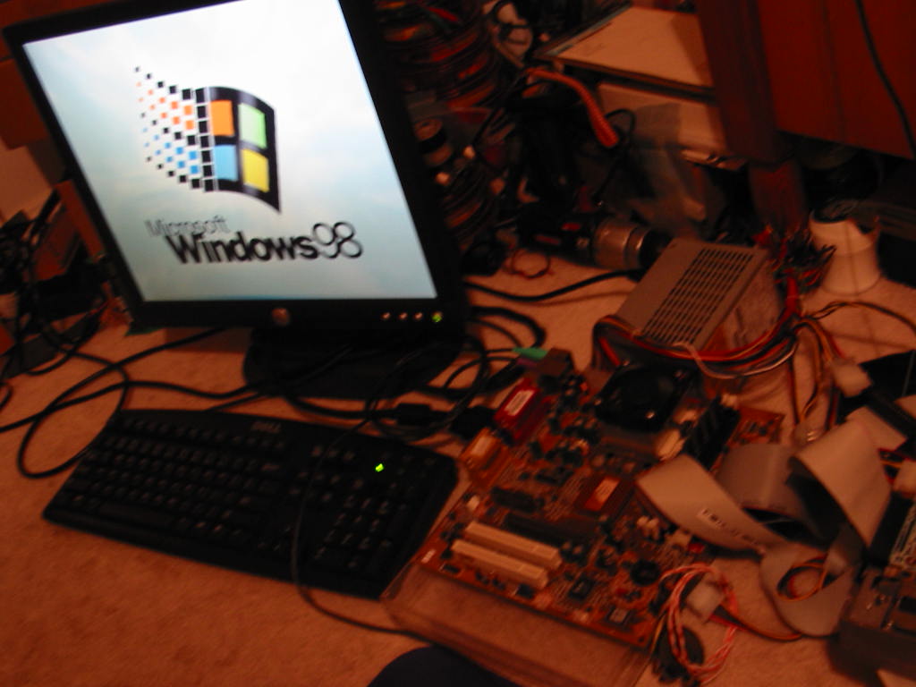

                    Windows 98SE on no-name AMD SiS730 s462 motherboard
                    Originally posted by Dan81
                    Let me go back to the classics for a lil' bit.
                    A few weeks back, I put together a Windows 98SE system as a test, since I’ve never done a Win 9x install before. (Almost too embarrassing to admit but Windows XP and 2k were too good when I started getting around understanding PCs, so I never found a reason to move back… or too much forward for that matter.)
                    So this test “build” (actually, it’s just a bunch of floating hardware on the floor) is based around a no-name socket 462 motherboard with SiS730 chipset/MCP that looks very similar to the motherboard found here:
                    https://www.vogons.org/viewtopic.php?t=45595
                    Hardware-wise, mine is the same (SiS 630/730 integrated video, SiS 7018 Audio, and etc.) But in terms of PCB, mine is yellow and has a few small changes, mainly around the BIOS chip and CMOS battery.
                    Anyways, system specs:
                    Motherboard: No-name (PCChips M810LU clone perhaps??) socket 462 with SiS 730 MCP
                    CPU: AMD Duron Spitfire 750 MHz (D750AUT1B, I think)
                    RAM: 1x 256 MB PC100 SDRAM (no-name with Micron 48LC16M8A2-75E chips)
                    Video: integrated SiS 630/730
                    Audio: integrated SiS 7018 based on Avance Logic ALC100p
                    Network: integrated SiS 900 based on Realtek RTL8201L
                    HDD: 10 GB, 2.5”, IDE (Toshiba MK1016GAP)
                    Optical: LG CRD-8483b CD-ROM
                    Floppy (Drive A): Mitsumi 3.5” (Drive A)
                    Floppy (Drive B): TEAC FD-55GFR 5.25'' (yes, it’s working!!! test results here)
                    PSU: Bestec ATX-1956d 200W (trash rescue with cut wires but works fine)
                    OS: Windows 98SE
                    I built this system for several reasons.
                    1) Like I said, I’ve never done a Win 9x install before this, so this was more or less done for practice.
                    2) The no-name motherboard I used above has always been problematic. It’s littered with G-Luxon caps. Initially, I thought this was the issue, as the system could never complete a Windows 2000 or XP install. It would start, and then 50-70% through copying files to the HDD, it would start saying that the files from the CD are not readable. I tried with several known good HDDs, but still the mobo refused. And what’s more confusing is that it always stopped at different points in the install, never on the same file. I know it wasn’t my Windows 2000 and XP CDs, because I’ve used both on more PCs that I care to count and with that particular optical drive too (so I know the two work with each other.) Well, the issue turned out to be a very interesting one: this no-name motherboard seems to not like NTFS partitions for whatever reason, and that’s what I’ve been trying all along with both the Windows XP and 2k installations. It never crossed my mind to try FAT32 formatting. But since Windows 9x naturally can only use FAT file system, this is the only option I had for it. When I did that, it installed without problems right from the first try. (After this, I also tried a Windows XP install on the same mobo on a different drive with FAT32 formatting with the same hardware and CDs, and it went without a hitch.) Thus, this experiment finally allowed me to figure out how to get this motherboard working with an OS.
                    3) There’s an old tool/program for opening VIV files from old Need For Speed games, called NFS Wizard. This tool only works under Win9x for whatever reason. In XP and 2k, it only works sometimes, and more often than not it crashes randomly within a few minutes of it running. As I wanted to look into a few old modded VIV files for Need For Speed High Stakes from 15 years ago, this was the only way… and it worked beautifully.
                    4) I had a bunch of 5.25” floppies with old games for Windows 3.1 and 95. I figured this would be a good time to try out the TEAC FD-55GFR 5.25'' floppy drive. It worked, but unfortunately I wasn’t able to read anything from the 5.25” floppies. They’ve been sitting unused for over 25 years and were moved around quite a few times. So probably not stored the best way. However, I did try formatting one of them and the Teac FD-55GFR drive was able to do that, albeit with quite a few bad sectors discovered by the drive.
                    So yeah, this is not really a complete system and probably won’t ever be… but who knows. I have to say, though, Windows XP (after finding out the motherboard could take it via FAT32 file system) did run much better. It took me a whole day to find all of the drivers that were needed for the motherboard… and even then, the Windows 9x drivers for the onboard audio are a bit finicky. On that note, I couldn’t for the life of me find an old version of WinAmp that works with Windows 9x. Luckily, back in the day when I only had a 20 GB HDD with my first PC, I was constantly burning CDs to free up HDD space for new games and music. So I remembered that I burned a few CDs with software programs from the early 2000’s. And that’s where I found a copy of WinAmp 3. Also had to look for an old version of WinRAR and Deamon Tools, but was able to find those online. Old WinAmp copies, on the other hand, really seem to have vanished from the web. (I'm thinking about uploading mine here, but not sure if that would be OK due to copyright reasons. Otherwise, why would it disappear everywhere from the web?)
                    Anyways, finding the right drivers for this kind of old hardware was probably the hardest part of the whole build. But it was still fun...

                      Ah yes, the PC133 variant of the M810 (there is a DDR version afaik, completely different from that one you have).
                      I do have one of those as well (branded as Totem TM-S730LMV) and as far as I could find it's basically M810LR PCB ver 8.0. Haven't recapped it yet, don't exactly remember the cap brand, but it's either same G-Luxons or green OSTs (because ECS/PCChips loved them)
                      I guess I might recap it when I have time, I do need a machine for my ATI Rage Pro Turbo All-in-Wonder 8MB, and I wasn't sure what to go with. It was either this or a recapped K7VZA (KT133A+686B) w/ Chaintech BIOS (which actually works much better than ECS's own BIOS ) I do wonder if recapping the SiS 730 board would prevent the issues you had from happening.

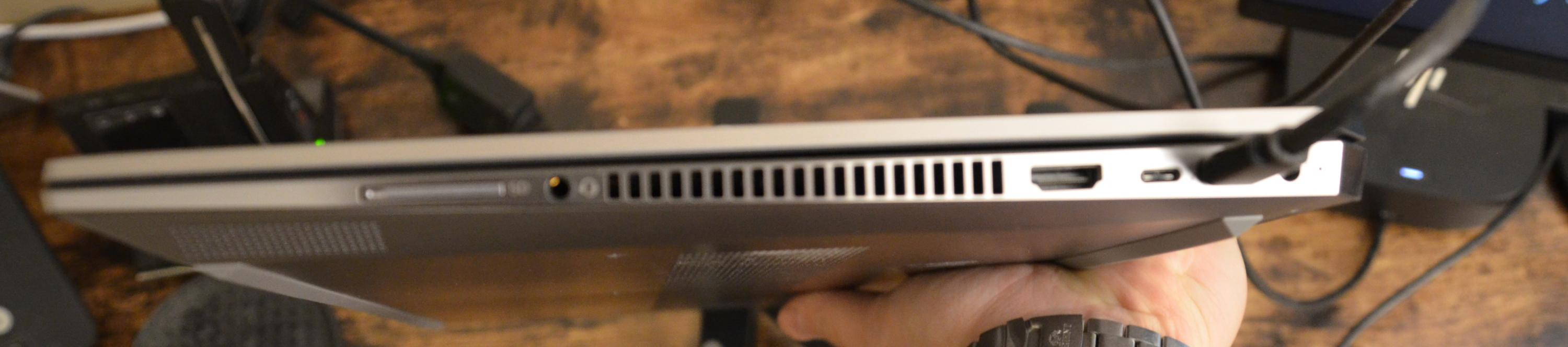

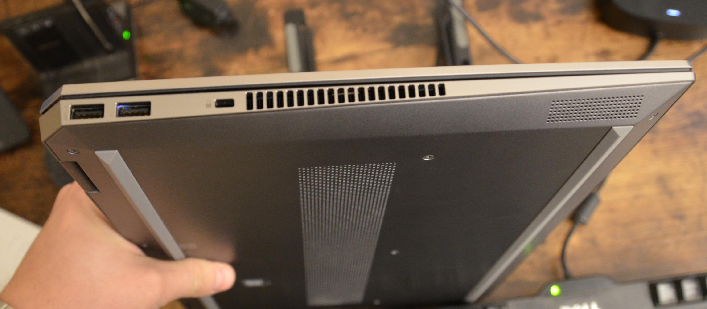

                          Those 3DMark scores are higher than what I get on that old HP laptop with S3 graphics. Now I want another "retro" computer, but I don't want to add to my junk pile.
                          I have a new laptop on the way to replace the Toshita, but it already sucks because it has an Intel CPU. It's still total overkill for me, but laptop prices are pretty screwed up right now. Anything with the RAM and storage I was looking for (while avoiding HP, Dell, and the LED-covered gaming laptops) ended up around the same price. (This is where someone posts a link to a cheap ThinkPad P51 or something.)
