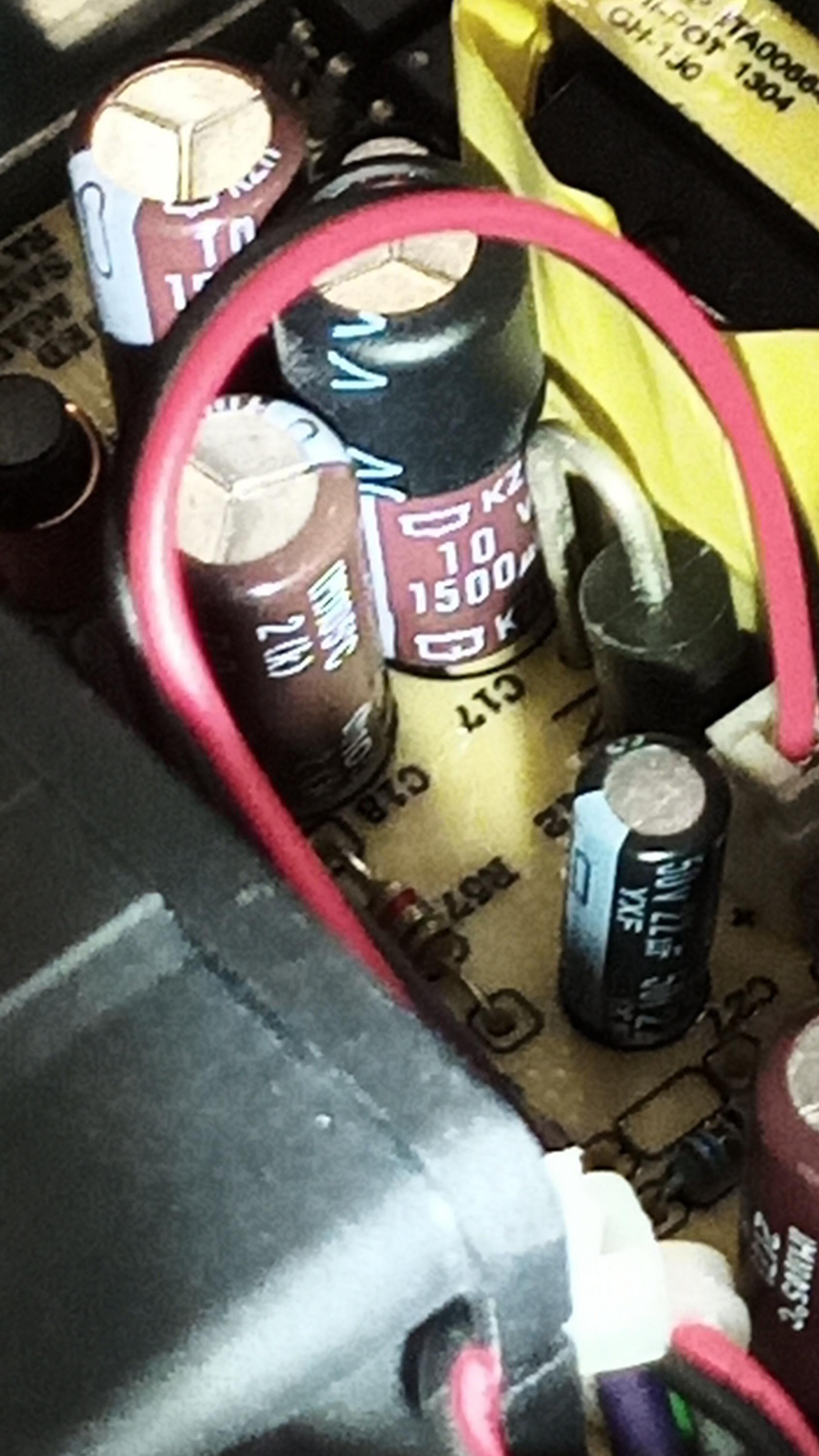

                  Popped open the PSU case, all caps pass a visual inspection.
                  The things I thought were regulators on the motherboard are actually n-channel mosfets. One measures 1.6 ohm gate to source. Is that a red flag or is that normal for some of these on PC boards ?

                    Does the PSU have known crap cap brands? If yes, I wouldn't rely just on a visual inspection.
                    Pictures would be nice too.

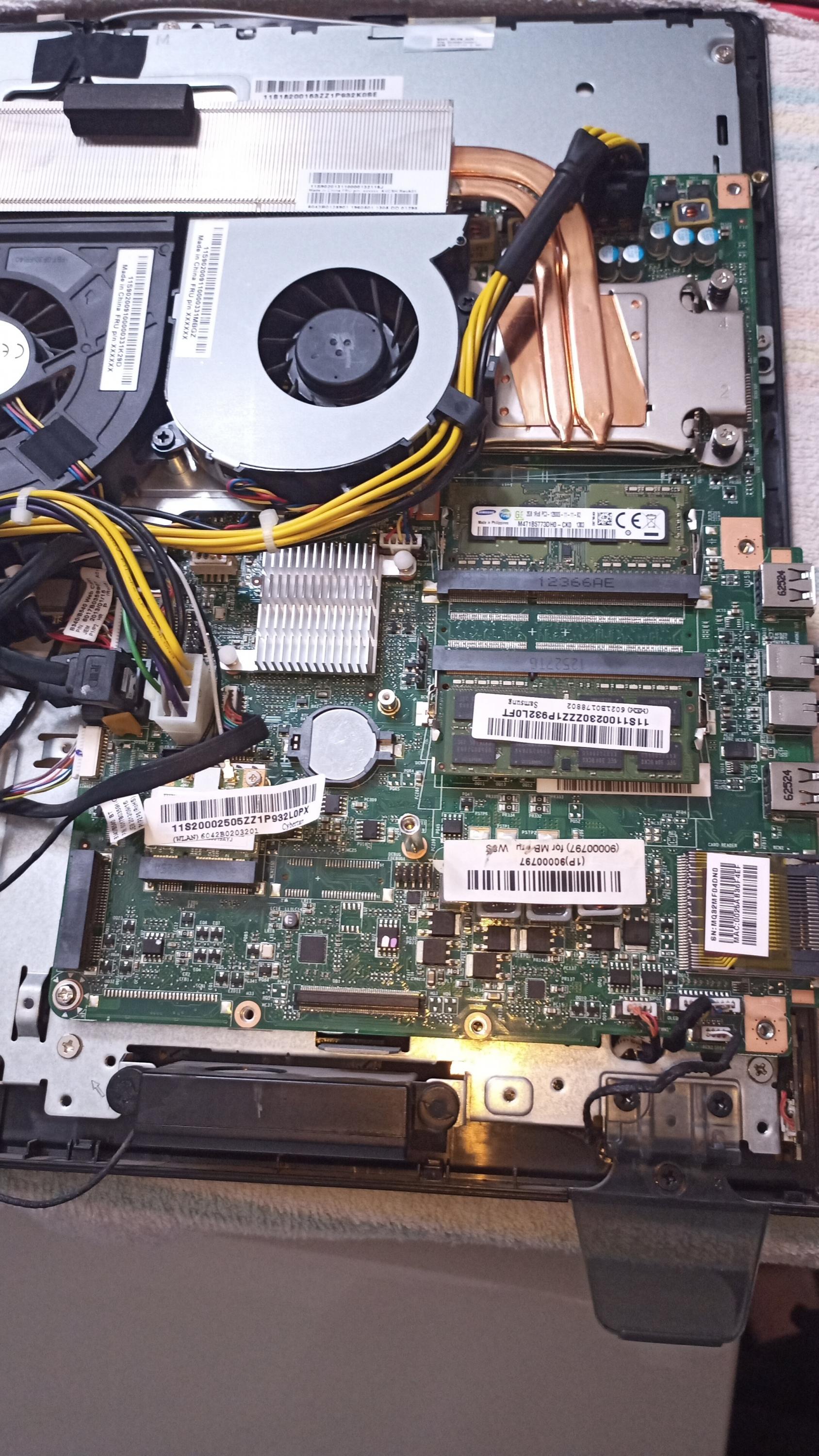

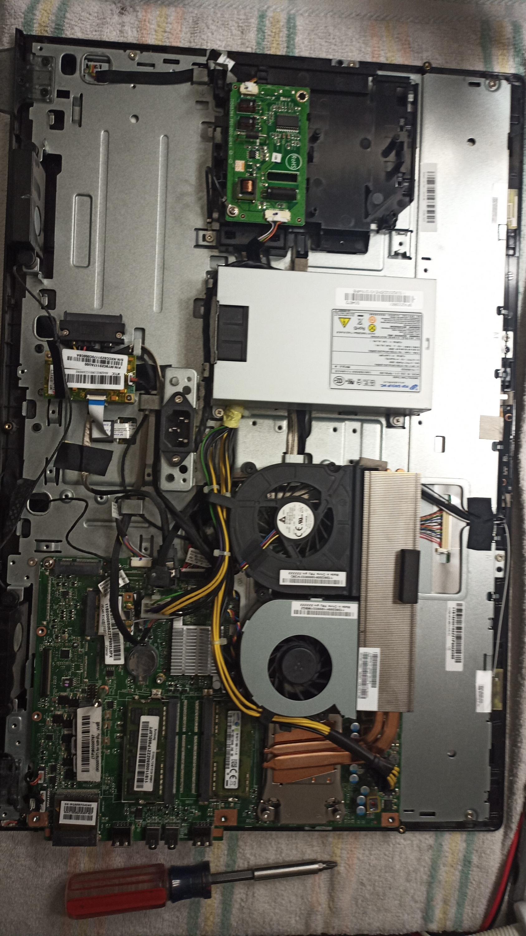

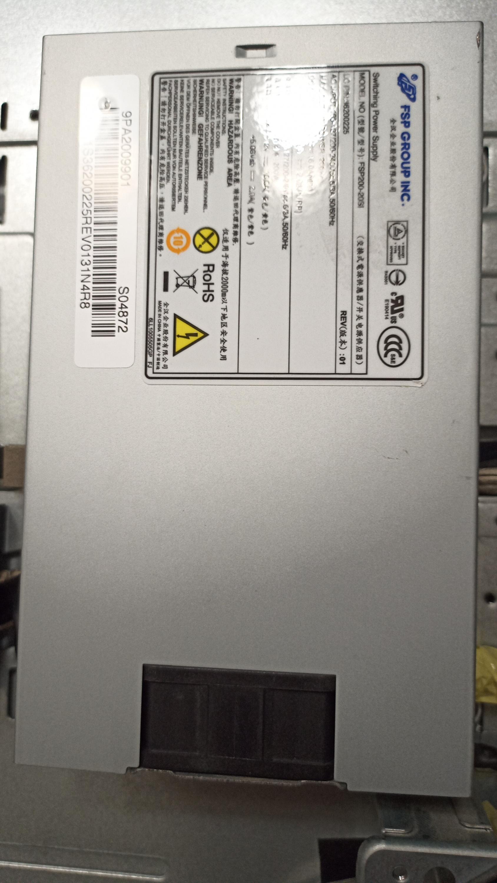

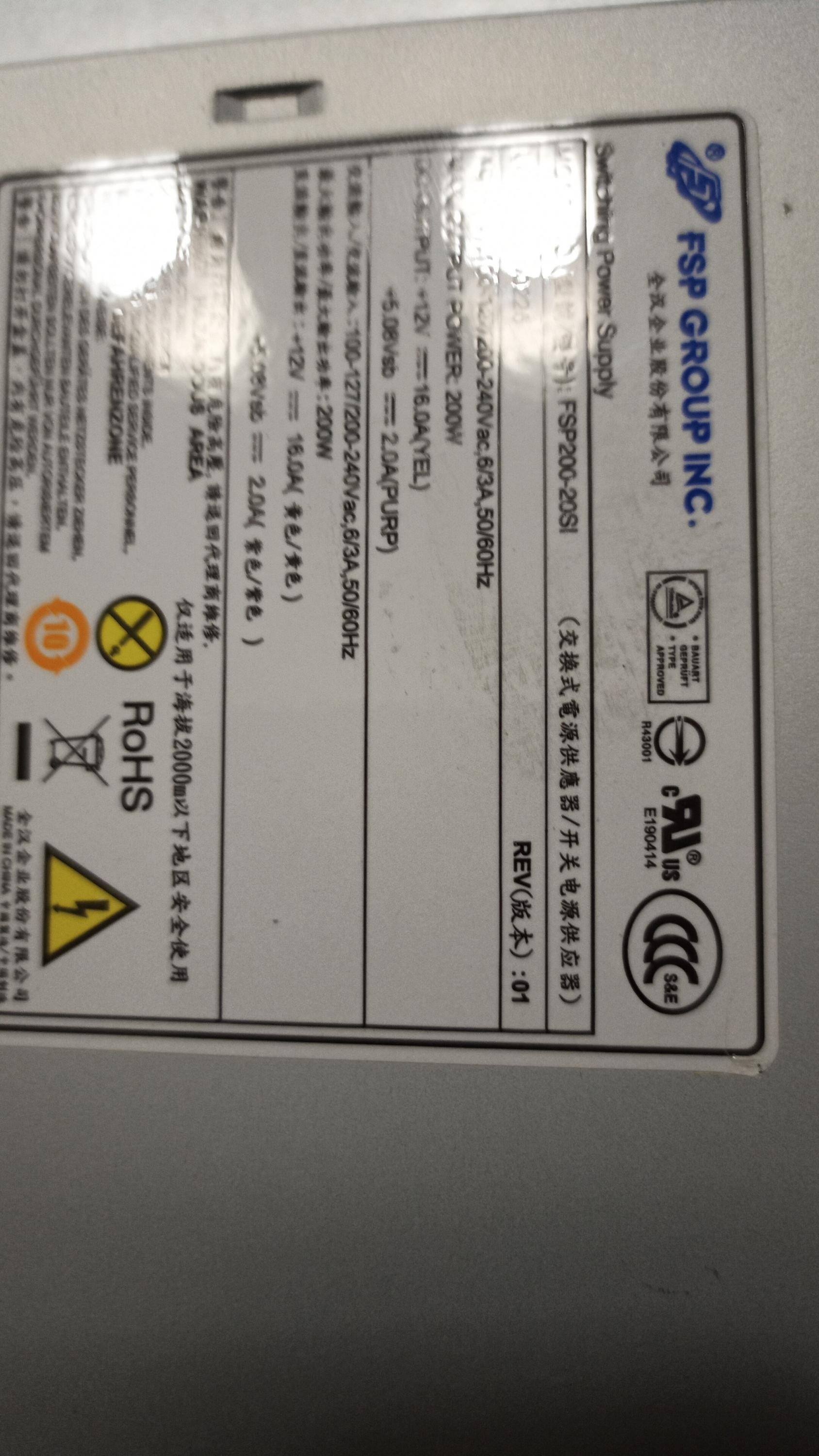

                        Some pics

                              Re: Lenovo Ideacentre B540 All-in-one - Black Screen
                              Chemi-con power supply caps ?

                                  Hmmm. Caps in the PSU are good brand (at least the few shown in the picture), so maybe that's not the issue.
                                  Did you check the thermal compound and heatsink contact on the CPU?
                                  Also, try re-seating the CPU in the socket (provided it is not a soldered one.)
                                  The more I think about the "Can't read location 0x________" errors you're getting, the more this suggests either HDD or RAM-related error (though that doesn't necessarily means the RAM is bad.) If it was the HDD, the PC should at least POST... though I know some OEM PCs take a very long time to do so if there is no HDD installed in the PC. So for that one, maybe try connecting a known good HDD to the PC (doesn't need to have an OS on it) so that BIOS doesn't possibly get hung on it in POST.
                                  Otherwise, if the CPU is an i3... I think that's when Intel moved the memory controller from the NB to the CPU... so NB/chipset can't be the cause of the issues(?)
                                  On the other hand, MCP/SB still is used as a bridge between CPU and SATA HDD ports, so perhaps the MCP/SB is dying? If nothing good seems to come out of this board, perhaps give the MCP/SB a quick reflow/re-heat and see if that does anything.
