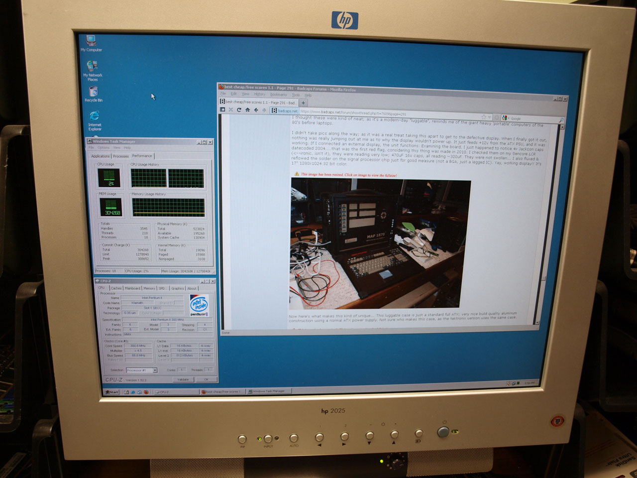

      The XA says it's a D6731T. I cant seem to find an XA manual that lists specs like I did for the XM.

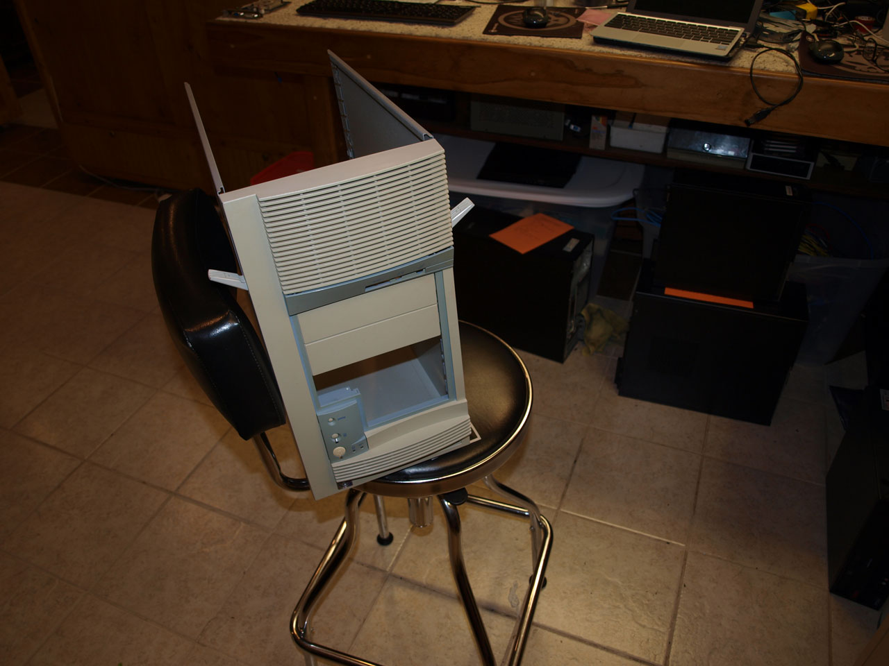

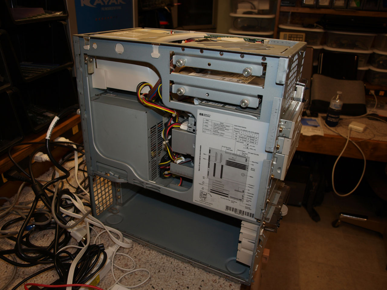

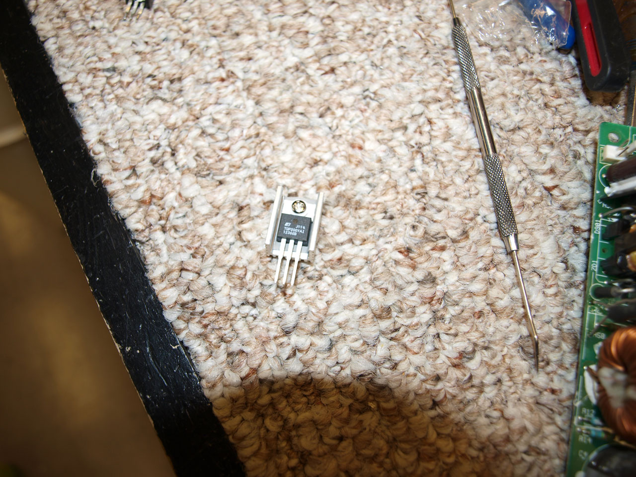

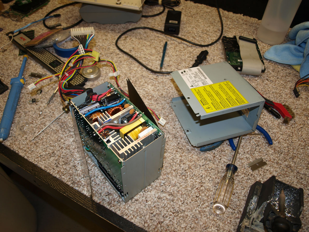

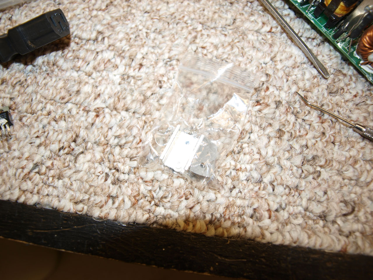

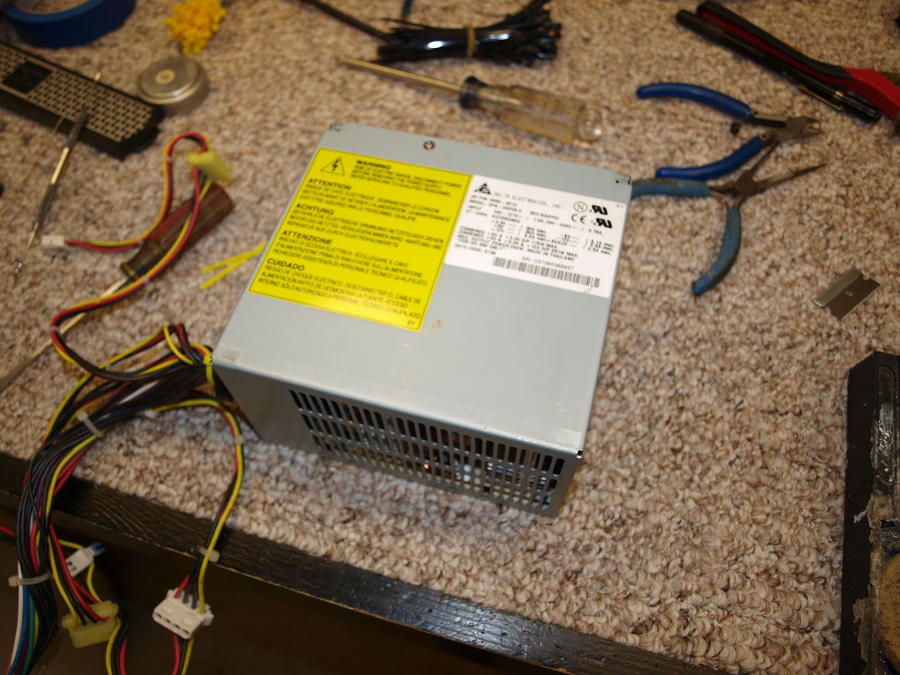

                        Awakening my HP Kayak thread to introduce one of the first Kayak systems made when HP began to phase out the Vectra line and replaced it with the Kayak for high-end workstations. This one is the model XU 6/300; which is a dual Pentium2 supporting only Klamath cores; which in this case were the 300MHz, as per the model number. This one was local to ratdude; oddly enough from Purdue (his Alma mater)....but this one didn't work....
                        PSU was already removed by the seller, but included. PSU would not power up, no standby.
                        PSU is a Delta 260w model DPS-260EB A. 24-pin ATX connector, but it's not pinned out standard ATX. It's proprietary. A standard ATX could be modified to work, voltages are standard, but it would take major surgery to get the pinout right...
                        ...SO lets see if I can fix this one...

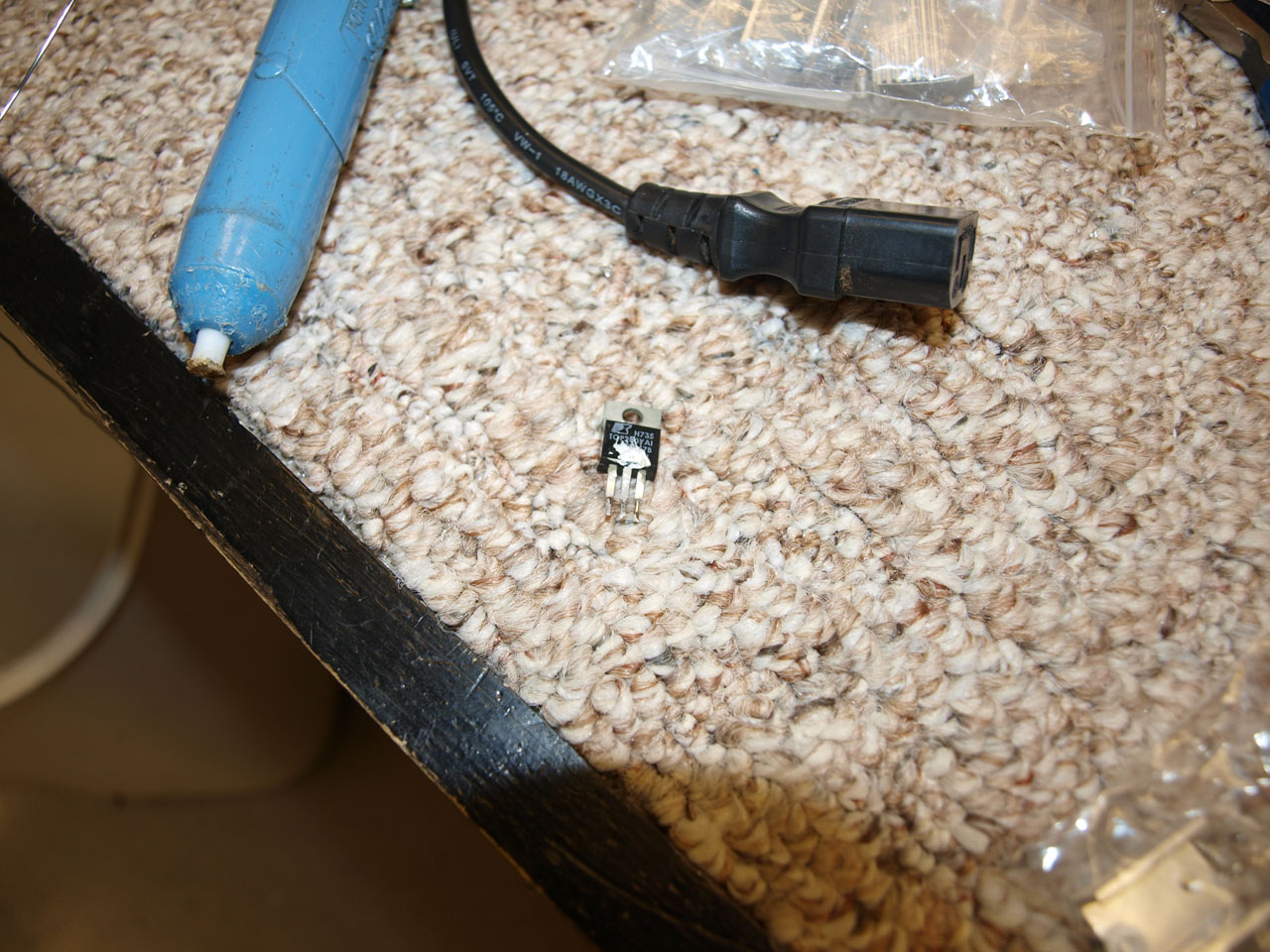

                        It has no standby. No blown fuses. I did find a schematic for it, which helped.... Narrowed down to a bad TOP200YAI TO220 IC and an open 1ohm resistor.
                        This PSU was caked with dust...maybe it overheated.... Just to be on the safe side, I added a heatsink....but from what I gather, these IC's are prone to failure. I had to track down new-old-stock, as they're discontinued.

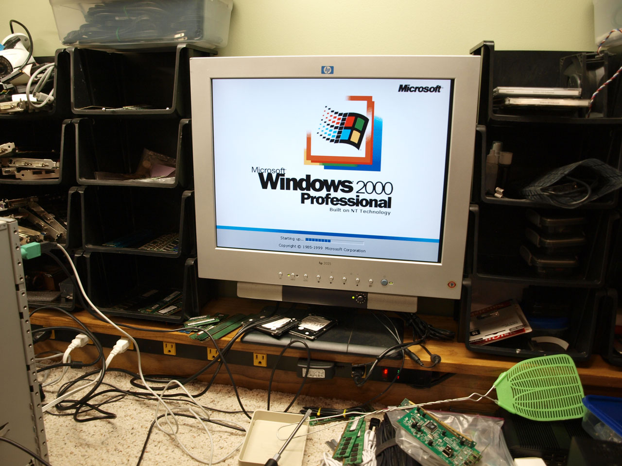

                        ...and TADA!! Success!!

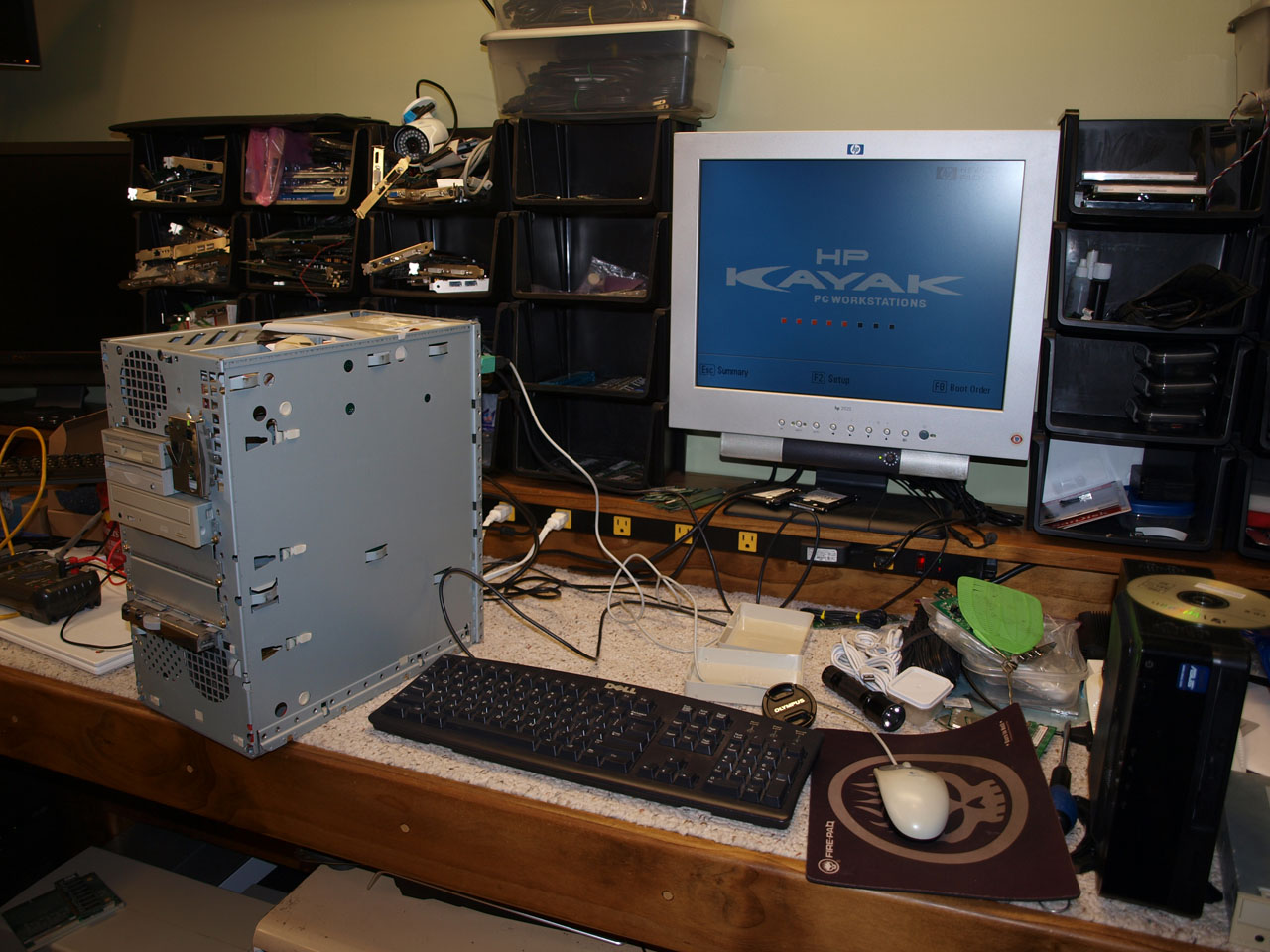

                        Booted Win2k. This was last used in 2003 by an instructor that taught a telecommunications class at Purdue; according to the data I found. I won't go into anymore detail than that.
                        I did wipe it and reload Win2k.... I also added 512mb RAM, the max it can take (LX Chipset).
                        Shazam!
                        I'll build this out a little more later on. Mission one was to get it working to make sure it was even buildable. I don't think I'll upgrade the CPU's, even if it's upgradeable... The HDD is a 4.3gb 68-pin SCSI that doesn't sound very healthy, but does work. GPU is Matrox Millennium2 4mb. This system is complete; with 19" CRT monitor, KB and MS....so I won't deviate it too far from stock save for maybe a healthier HDD and a period specific GPU upgrade....things that can be undone if necessary.....but for now, this rescue is alive again after twenty years!!

                            Have you ever thought of getting female ATX connectors, pins, and a crimp tool and pinning up a custom adapter cable to go from $proprietary to ATX so a standard ATX power supply will just plug in (through the adapter cable) and work?

                              I hadn't thought of that....Had I not been able to fix this one, I'd have probably pulled the entire harness from the bad one and transferred it to a standard ATX....which would have been a real pain.... Finding an OEM replacement for this PSU would be difficult and expensive.

                                Food for thought, and maybe you could build yourself a nice collection of adapter cables.
                                Then comes the moment of someone digging through 300 adapter cables and muttering "I know I have that XA's adapter around here somewhere, but HERE is not it!"

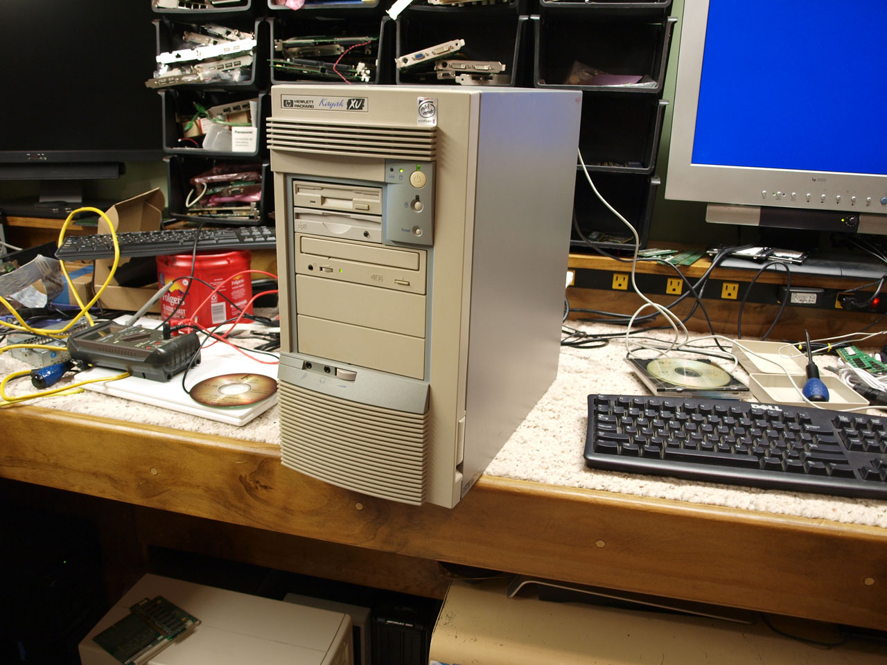

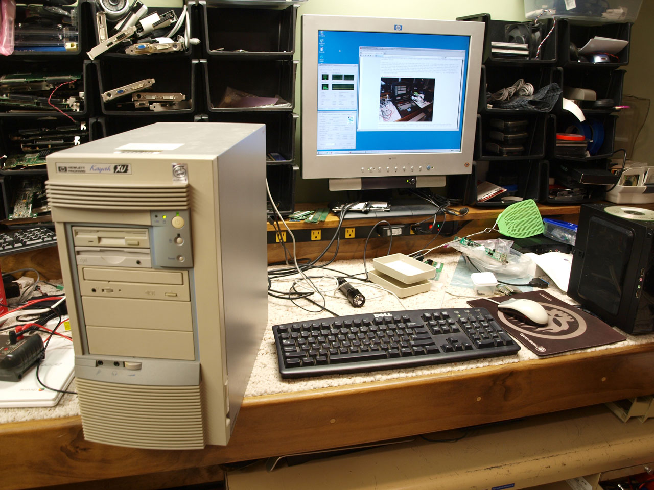

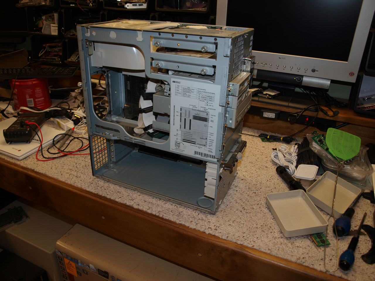

                                  Another Kayak to add to the fleet. This was a dropoff from the same source that the Dual P-Pro Vectra came from. I didn't make a big to-do out of this one, as it's only a single slot board. It came with a bad 9.1gb SCSI HDD. The only uniqueness about it, it has the max CPU that can be utilized in it, rare for a couple reasons; as a factory option from the big box systems, the fastest CPU typically wasn't installed....and rareness # 2 is that this CPU is getting very difficult to find and pricey. It's running a 600/100 Katmai. It won't run Coppermines. I didn't try, but research on this model (Kayak 7/600) revealed that it won't. It has 512mb RAM, max it could take is 768mb; only has 3 slots. BX chipset. I just left the RAM as it was; 2x 128mb and 1x 256mb.
                                  ...and a few pics...
                                  Click image for larger version  Name:	kayak_0733.jpg Views:	0 Size:	226.8 KB ID:	3175673
                                  Click image for larger version  Name:	kayak_0735.jpg Views:	0 Size:	223.0 KB ID:	3175674
                                  Click image for larger version  Name:	kayak_0736.jpg Views:	0 Size:	236.8 KB ID:	3175675
                                  I just cleaned it up and installed another SCSI HDD (18.2gb) and reinstalled Windows 2000. The OS sticker on the front was missing....but I'm guessing it had 9x or NT on it originally.
                                  Click image for larger version  Name:	kayak_0737.jpg Views:	0 Size:	155.9 KB ID:	3175676
                                  Just another one for the Retro Fleet. Nothing really all that special about it other than it's not in a scrap bin.
