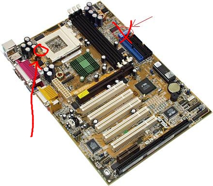

    does anybody know the value/ polarity of the tantualm (i cant spell tonight) cap right next to the cpu socket? its on the side facing the i/o plate.
    it got crushed a long time ago. it still ran but i assume i better fix that if i plan to use it again.

    post a pic.

      its crushed. a pic would be useless if all that is left is metal paddles.

        post a pic anyway.might tell us what it does.most tants and mlcc near the socket are on vcore.probably run ok without it.clear off the remains in case it is shorted.

          its right on the socket... crushed when i used a socket a fan with a 3-hole clip... there is like .5 mm between it and the socket. it did run without it. ill clean it off... it will say hi to a lin-lin soon.

            Post a pic - for location.
            I have an Asus CU-something or other, that was a trade in that I've never even looked at.
            Might be similar.

                  NOTE- i marked out what the original creator of the pic had an arrow to. use the bold arrow on the left instead.

                    Now that I dug it out. [System was still almost fully assembled.]
                    It's a CUSL2 Rev:1.02
                    Doesn't look close enough in the area of your circle to help.
                    This'n has 7 caps to yurs's 5 and the Toroid is laid down flat instead of standing up.

                      yeah, th cusl2 is not even close... i have one too... hate the intel chipset in it...

                        I have a CUV4X-C rev. 1.02 which has more electrolytics around the socket, but nothing like a Tantalum
                        But seeing it doesn't even have empty an position for an ISA slot, it's probably quite a different PCB assembly
                        I think you'd be in a minority hating a CUSL2, perhaps one of Asus's last trustworthy products

                          If it's what i'm looking at, that's not a cap, it's a diode. looks like a flyback diode for the CPU VRM.. I've got a CUV4X-E right in front of me, and the only thing even remotely that close to the CPU socket on that side is D4, which is connected across Q6, a MOSFET in the CPU VRM. The part number on the one here is PJ13 on the top line, and SS12 on the bottom line..

                            it was black and box shaped. right next to the clip.
                            edit, the pic was only to show position, that is not my board model. i screwed op.
                            and yes, gg1978, that is the board you sold me.

                              ok, its d4.
                              i had to switch standoffs so while i had it open, i looked.
