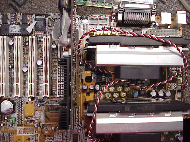

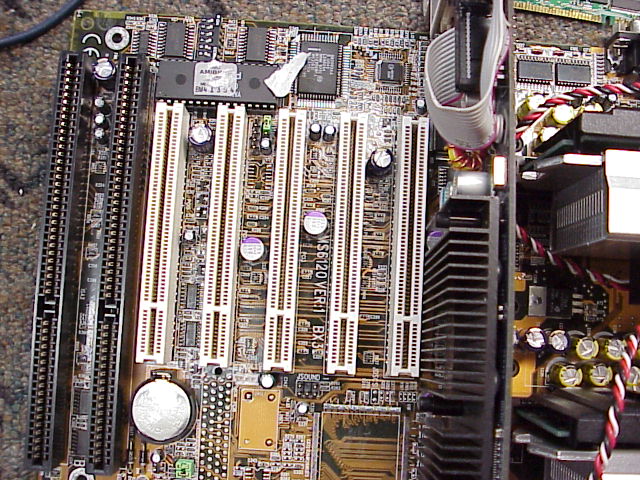

    msi 6120 poly
    intercepted this from the trash.neighbor was going to pitch it.
    he had tried to recap with radioshack caps.looked like shit.
    oddly the vrm on one cpu has 8 output caps and the other only 7.
    yes i double checked to be sure.
    2x 1ghz/100/256 slot 1 chips.i remember when these were scarce as hens teeth and very expensive!

      Nice work! I've been poly'ing more and more boards these days too!

          Re: msi 6120 poly
          did a bh6 for a friend.it was an emergency job for a homebrew cnc computer.
          it was always a bit shakey.polys on vcore and vdimm.also on +3.3.
          so old school stuff responds well.
          eliminated the quirks.
          since tayeh are junk when new i wonder how many were scrapped as being buggy when nearly new.

            I have a KA7 I may give it a whirl on. I think vcore on those is 2.8v, so I'll have to use the 560uF 4v polies on it.

              Re: msi 6120 poly
              iirc even slot a chips cant stand more than about 2.2
              i would use the 820's.install cpu and goldfinger,and play.
              of course the 560@4 will be great on vdimm and anywhere +3.3
