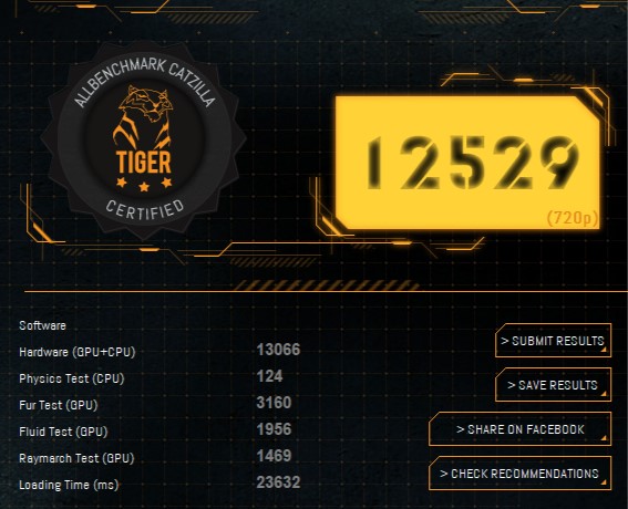

            Was finally able to run catzilla…

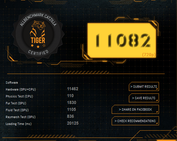

              Single GPU system (the mismatched evga gtx 970 SSC) for comparison (dual low voltage xeon hapertowns):
              SLI is indeed working... almost double in the gpu parameters. Yay?

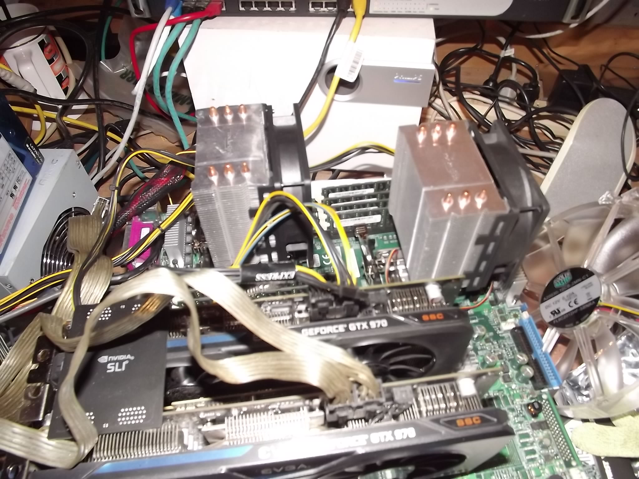

                Re: Yet another RD workstation build... Socket F Fun!
                Coolers came in yesterday. They were a bit beat up (bent fins, easyish fix), but indeed brand new rebadged cooler master TX3s... with all the accessories. Other than saying "rocketfish" instead of "cooler master", they're the exact same thing as the first revision of the TX3.
                Apparently the seller figured it out, and hiked the "sale" price up ($13 -> $19) for the two they still have available. Still a great deal if anybody needs a new TX3 clone and doesn't care about aesthetics:
                https://www.ebay.com/itm/Rocketfish-...72.m2749.l2649
                Installed:
                This was posted from it... boy genius here manged to temporarily kill one of his bench workstations, and the other is an unstable BSOD-happy mess. Until MS shuts me down for unactivated windows 10, I'm rocking it...
