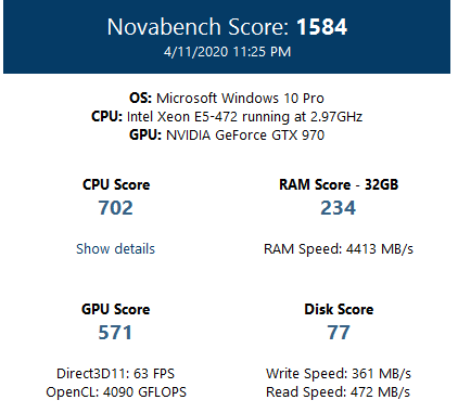

                    Just got done with benchmarks... posting from it again.
                    Novabench result:
                    The HDD is abysmal... you'll see why below. Otherwise, not bad?
                    Catzilla crashed 2/3 of the way though... I'm guessing something overheated. Once I have this is a proper case with proper cooling that should hopefully resolve itself.

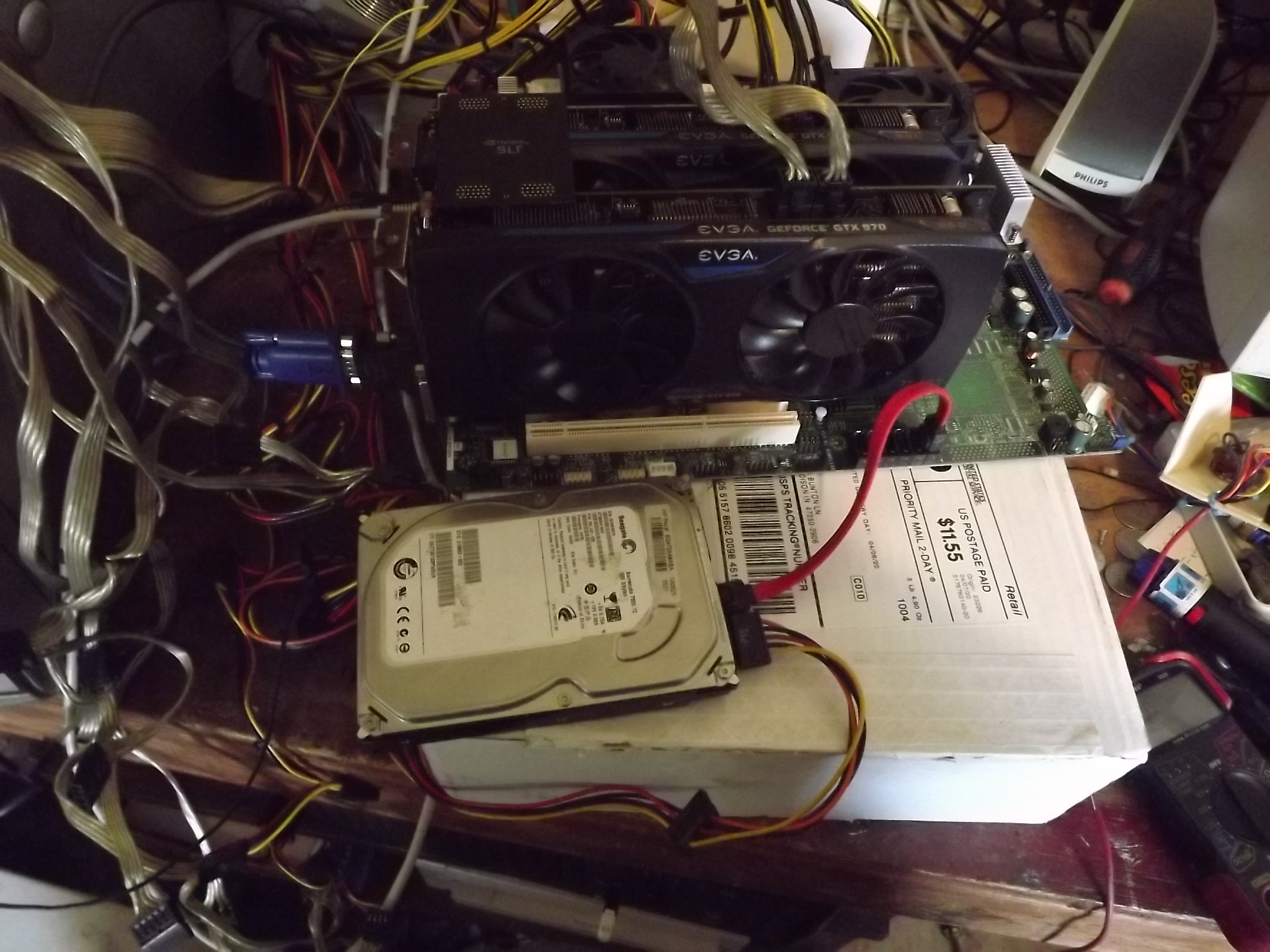

                    The setup: These pics are from yesterday, when I was trying to make it run on 8GB of old RAM I had in the drawer... which was not successful due to the CPU2 issue mentioned previously (didn't discover it until today). But the idea is the same.
                    SLI'd GPUs and a 500GB clay pigeon:

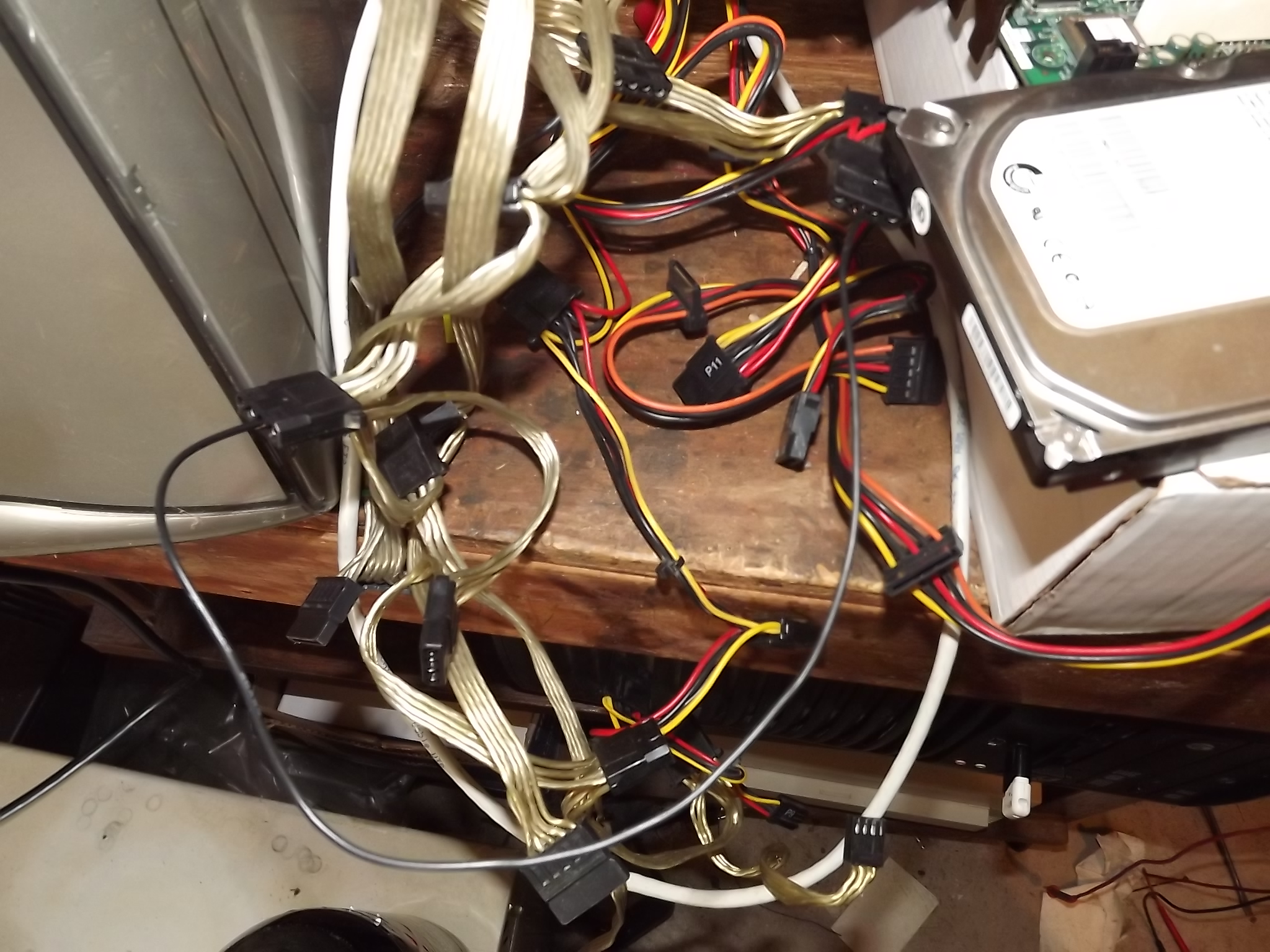

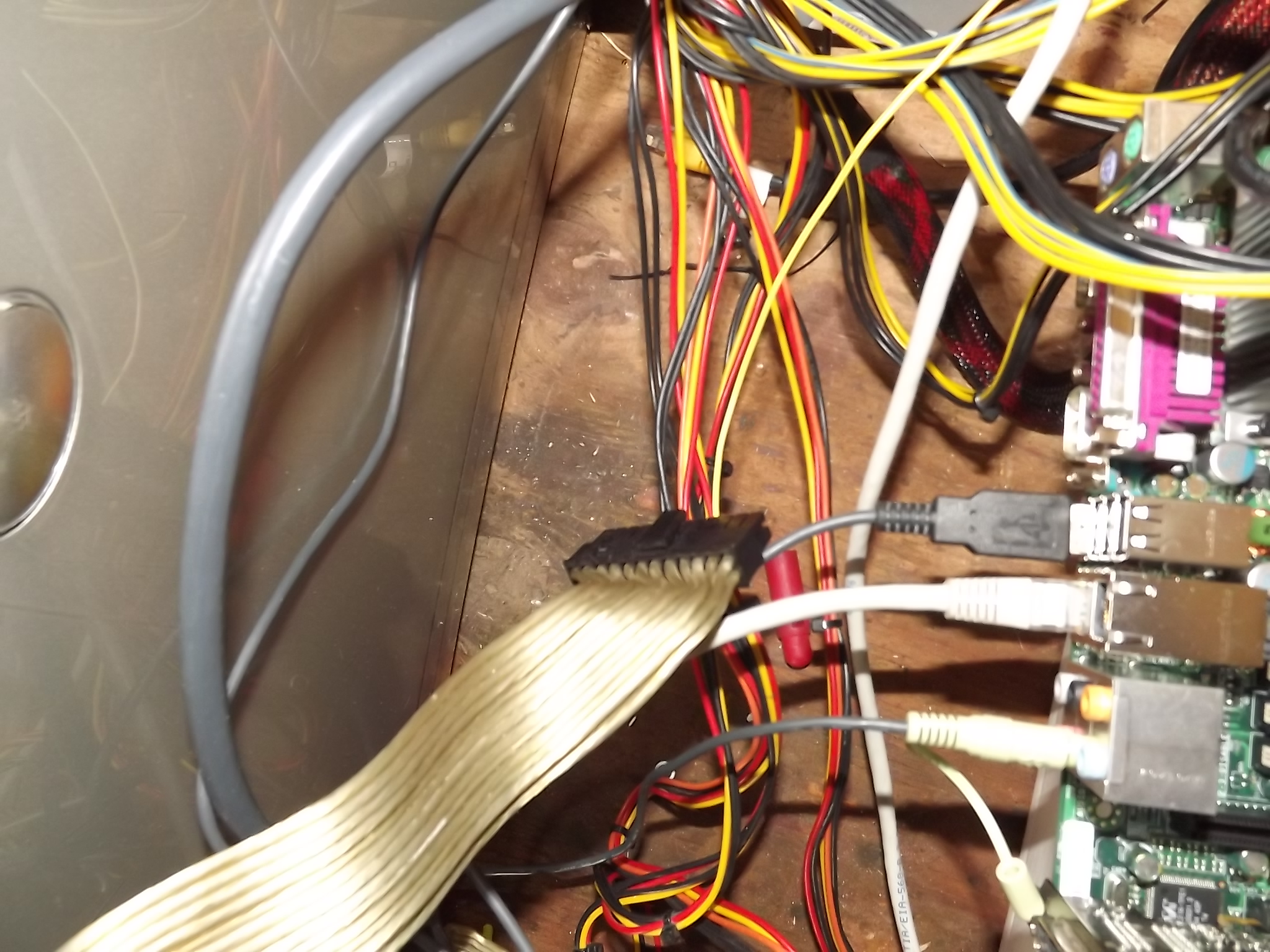

                    As shown, I'm running off two PSUs right now, since neither my Antec 650 nor my ultra 600 have enough PCIe plugs to run both GPUs. Since I didn't happen to have a dual PSU adapter, I ghetto'd it with some jumper wires.
                    To start, I backplugged the soft-on from the "primary" PSU (the Antec Earthwatts 650):
                    … and ran that wire to the soft-on on the secondary PSU (modded ultra Xfinity 600W):
                    Finally, I jumpered the grounds together:
                    Ghetto? Yep. Functional? Yep.

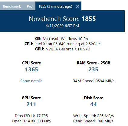

                      Point of comparison: Ran Novabench on my current fastest rig (with the "new" rig's benchmark to the right):
                      (the new rig was on my 24" FD Trinitron, which is why the resolution of the screenshot is bigger)
                      That's with the ASUS Strix GPU installed. Sure, this one crushed it in terms of CPU performance (it's got twin hyperthreaded hex-core westmeres, double the threads) and RAM speed (triple channel DDR3 vs dual channel DDR2)... but that was expected. GPU wise, SLI is indeed working (novabench even prompted me to customize the app-specific SLI config in the Nvidia settings). For gaming (what my wife will be doing with it), this should be a good setup as far as my workstation builds go (not to call it a "gaming" rig... it's not!).

                        Your GPU score seems low, have you enabled SLI ?
                        It seems so but Novabench has a pair of GTX 970 at and average of 832.
                        • ratdude747
                          Black Sheep
                          • Nov 2008
                          • 17136
                          Re: Yet another RD workstation build... Socket F Fun!
                          The Westemere system is single GPU, score of 211
                          The Opteron system is dual GPU SLI'd, score of 523.
                          All GPUs here are 4GB GTX 970's. Probably different clockrates, I'd have to look it up.
                          Over double the score leads me to believe SLI is working... not to mention nvidia (and novabench) both say it is.

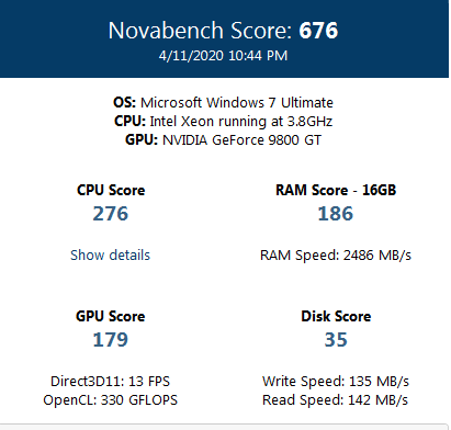

                                How long ago? Seems that they changed thier tests and scoring. For a while it wasn't even downloadable.
                                For reference, I'll run the latest novabench on my other rigs, and see what we get.
                                Booted up my old dual irwindale (netburst!) rig, and now with reseated memory, actually ran for more than 5 minutes without a BSOD.
                                Not bad for an old 9800...

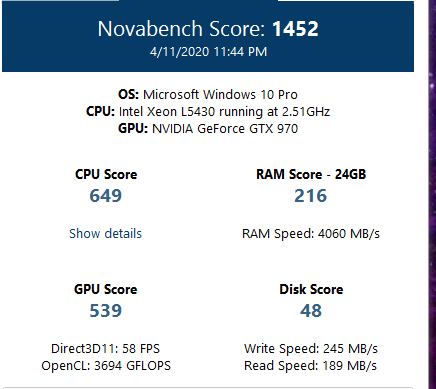

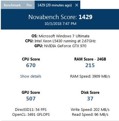

                                  Something else may be going on here...
                                  Just ran it on the second fastest system currently built (what the new build will replace for my wife's main rig)... and got this result:
                                  Sure, it has a factory OC'd Zotac triple fan monster... but it's yet another 4GB GTX 970 (I currently own 5 of the damn things)... No way it scored so high.
                                  My last build with a GTX 970 (where the $85 EVGA card I recently bought ended up) is being gamed on right now... when it frees up I'll run it there for another datapoint.
                                  PS-I tried running it on my other dual opteron (twin Opteron 285's with dual SLI'd GTS250's )... the 3d test program crashed no matter how I set it in the Nvidia 3d settings. It and novabench don't get along.
                                    The final GTX970... in the sleeper build pocket rocket:
                                    Another killer GPU score... Which makes me think SLI isn't doing jack shit on the new build, and for whatever reason my "fastest" system is getting bottlenecked. It's not the GPU; I ran novabench a year ago on the pocket rocked back when said GPU was installed in it:
                                    Alternatively, novabench is an unreliable pile of dog crap, and should be renamed novabust. Other than catzilla, any other suggested free benchmark software I should try?
