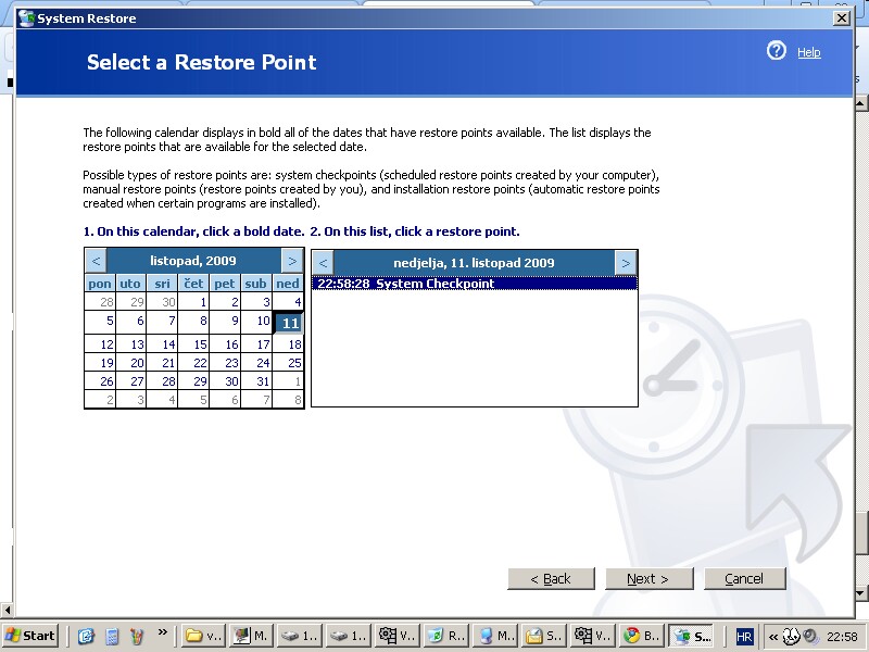

                          keri, you want linux to restore windows?
                          hehe...
                          and if they can't do reinstall, i doubt virtual machine or acronis are solutions either....
                          what YOU could do(obviously not them) is install anew, clone to external hdd(yeap., they would need to buy external hdds) and restore when needed....
                          Store-bought PC's often have a restore partition
                          restore partition is good...untill whole hdd goes to hell....
                          aldo, you do know of system restore option, in xp, right?
                          start->programs->accessories->system tools...
                          just make restore point on day one...

                            Hi i4004
                            Oh yes, I'm very aware of Windows System Restore.
                            Unfortunately, nearly all modern viruses erase all the Restore points and go on to disable System restore!
                            At least on all the stuff I've had to fix for people lately. Only ONE system still had System Restore functional.
                            I suspect that there's been a recent rash of bad stuff out because all these systems had AVG, Norton or McAffee running. Even my manager at work got the "Windows AntiVirus Pro" on his office computer!
                            He asked me what that popup ballon was.... I replied, Better call IT!
                            Glad that isn't me.
                            So, I'd really like to have a NON-Windows OS available to just copy over a whole working copy of the Windows drive.
