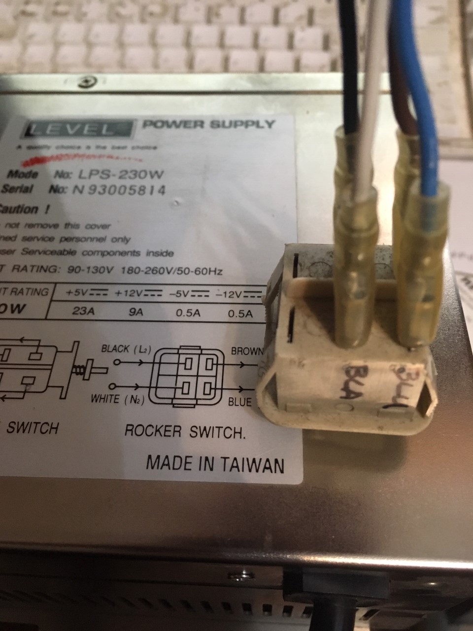

    Ok i'll make this short request long, back in year 2000 or so I was a 8th grader I was attempting to replace a AT power supply in a computer, when I hit the switch sparks shot out the back and the lights dimmed in the house. Ever since I have never touched a AT power supply and recently got a AT case with a bad supply.
    I really want to build this computer but still scared i might fuck it up even though its only 4 wires. So my questions are as follows.
    1. Once said AT power supply is hooked up, can I power it on without it being connected to the motherboard so I don't fry it?
    2. I'll provide some pics of the rocker switch its not a push switch so you guys can hopefully let me know if its hooked it right. the rocker switch already has the color markings labeled from a previous person.
    Pics to follow shortly.

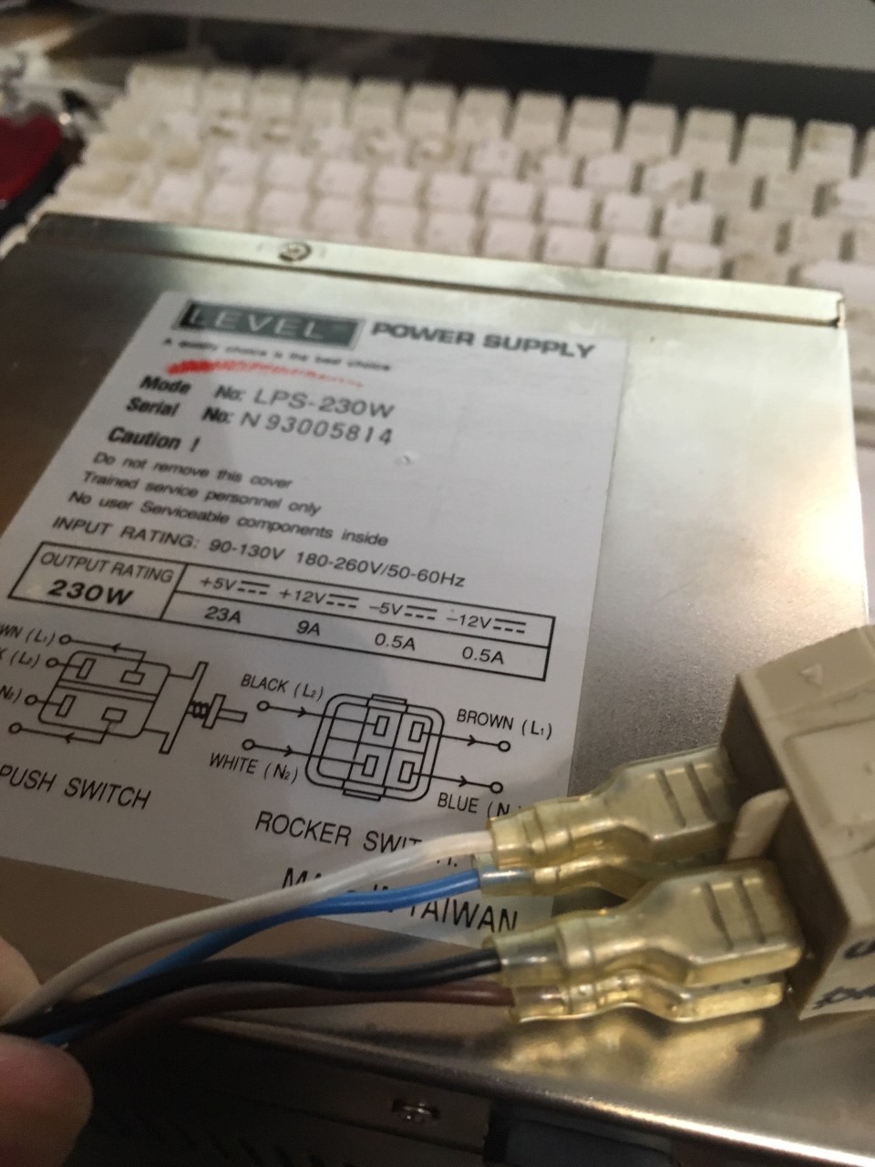

            Re: AT power supply help
            Okay I got the power supply, someone already labeled my rocker switch for me and it looks to be wrong from the label of the power supply as brown and blue shouldn't be on one side, from the label it looks to be brown and black and blue and white on one side.
            I will wait for your guys response before I plug it in, I don't want a repeat of 20 years ago.
              another thing I wanted to point out. when you search google for "AT power supply wiring" the first hit is some toms hardware article from 2001 and the guys is totally wrong https://forums.tomshardware.com/thre...switch.323966/ according to my label his wiring advice is wrong or Iam reading my label wrong, but whomever wrote the colors on my switch seemed to follow that guys advice.
              My Computer: AMD Ryzen 9 3900X, Asrock X370 Killer SLI/AC, 32GB G.SKILL TRIDENT Z RGB DDR4 3200, 500GB WD Black NVME and 2TB Toshiba HD,Geforce RTX 3080 FOUNDERS Edition, In-Win 303 White, EVGA SuperNova 750 G3, Windows 10 Pro
                The switch wiring looks correct, Black (line) White (Neutral) should come from the a/c input, Brown (line) and Blue (Neutral) feed the input to the power supply
                With the switch off (or disconnected) and the power supply plugged in you should have 120vac across the black and white wires
                Or check the resistance between the A/C inlet and the black and white wires. The only way to get it wrong would be to have the black and white wires on the switch so when the switch turns on it shorts out the a/c line
                  Thanks for the help, i'll start putting the supply and in switch into the computer.

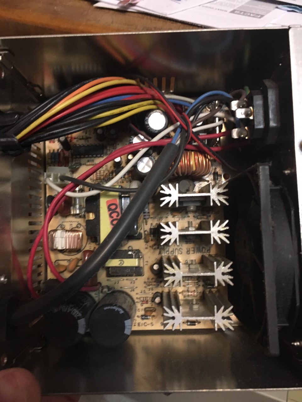

                    • 31084
                    nice board - i have one like that for testing stuff.
                    one bit of advice, replace the fuse with a ceramic one - if that glass one blows it will make one hell of a mess.
                      Good news, I hooked it up like in the pictures i posted and it powered right up in the computer! so I can cross installing a AT power supply off my bucket list. I'll keep the fuse thing in mind also thanks for all the help everyone
                        Or just sleeve it with heatshrink.
                        I also advise you always test AT PSUs with a good load - especially on the 5V rail. Some AT PSUs won't like it or work properly without at least 1 Amp of load on there. So you may need a few incandescent (or halogen, I suppose) 5-12V bulbs.
