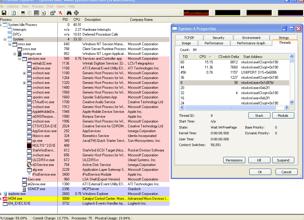

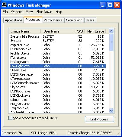

              Plot thickens.
              I connected a wireless USB adapter, connected to the router, got online long enough for Skype and Steam to login and then it died again.
              Oh, one other thing I noticed (it may or may not be related) is that in the task manager there is an unstoppable process called system that was initially started by the system that's running at a load ranging between 35 and 40%.
              This in turn is pushing my system idle up to between 38 and 45% which is normally between 2 and 5%.
              I doubt it means much but I guess it's still worth mentioning.

                  Pentium: System Idle should be at or close to 99% CPU usage when system is idle. Try Process Explorer and see what's taking your resources. I doubt that this is causing the problem too, but it's good to check I guess.
                    I already know what's using the additional resources and I already mentioned it....
                    the process "system" is not the "system idle process" you are thinking of. Look at the attached picture.
                    Still, I doubt that there was malware attached to a driver that came directly from MSI's FTP server and doubt that any inactive malware became active with a driver update.
                    Still, this is one stubborn issue. So far I have reset the Tcp/IP stack as well as Winsock which normally nukes any serious problems and this still persists.
                      I know. But you should try something other than Task Manager to see what exactly is taking up the resources. System is a parent process for a number of other processes too, hence CPU usage from them will appear under System as well.

                          A lot of the LCD stuff is for my Logitech G15 as it has the nice LCD panel on it.
                          I actually tried cycling all my hardware before you mentioned it but no dice there either.
                          Anyways, ran Process explorer and...
