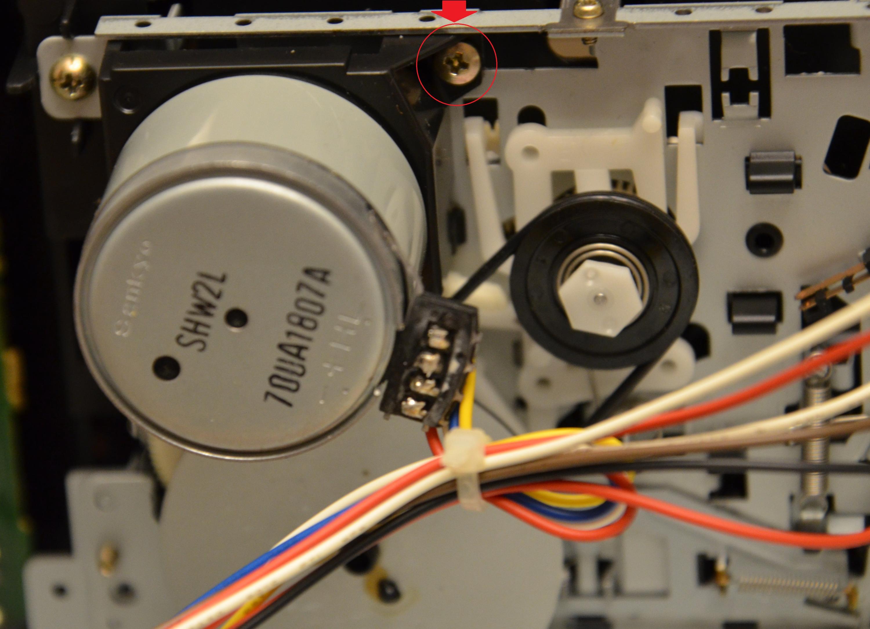

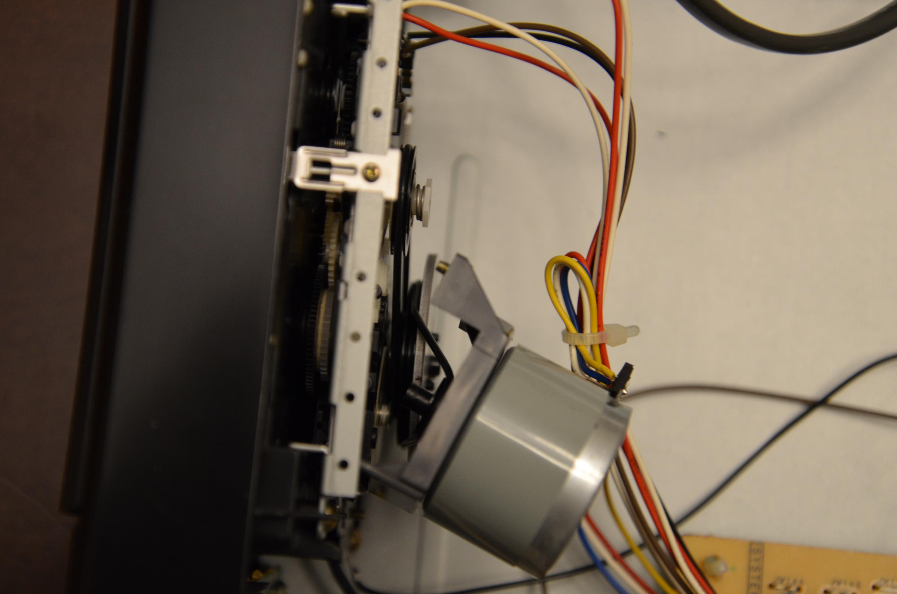

2.Once inside remove the small brass screw holding the motor to the mechanism, the motor will rotate away providing easy access to the belts.
3. Replace the belts.
