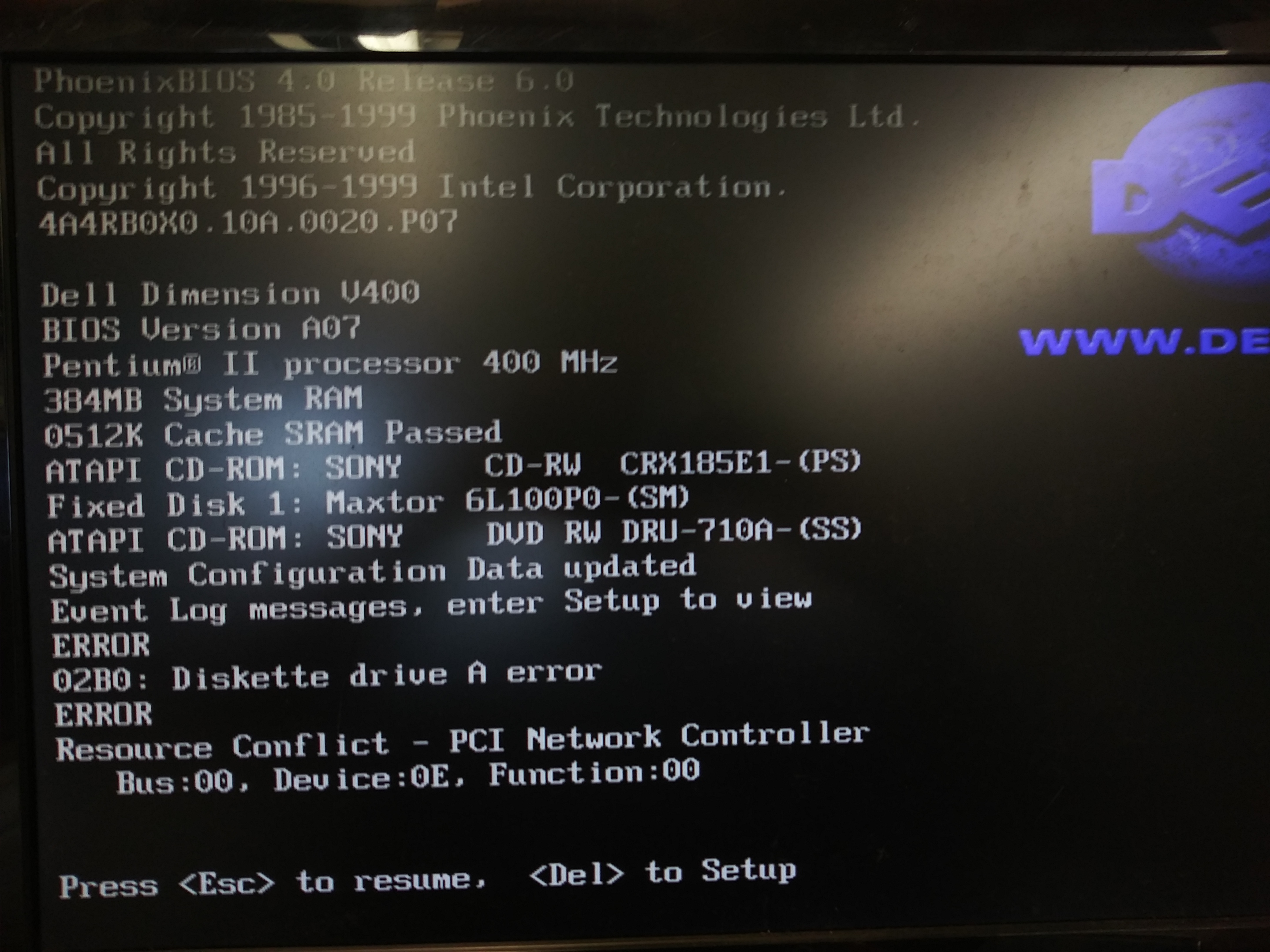

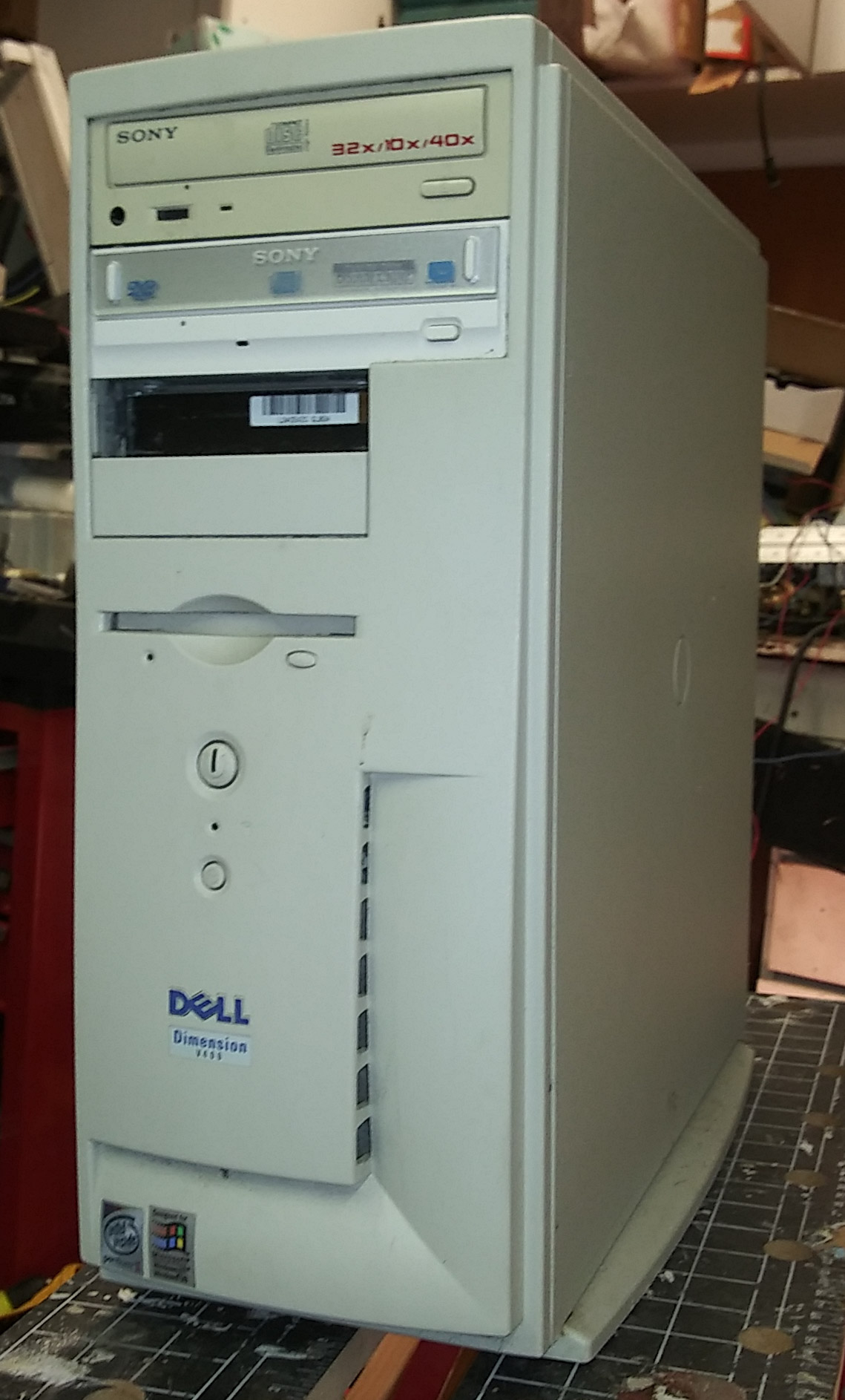

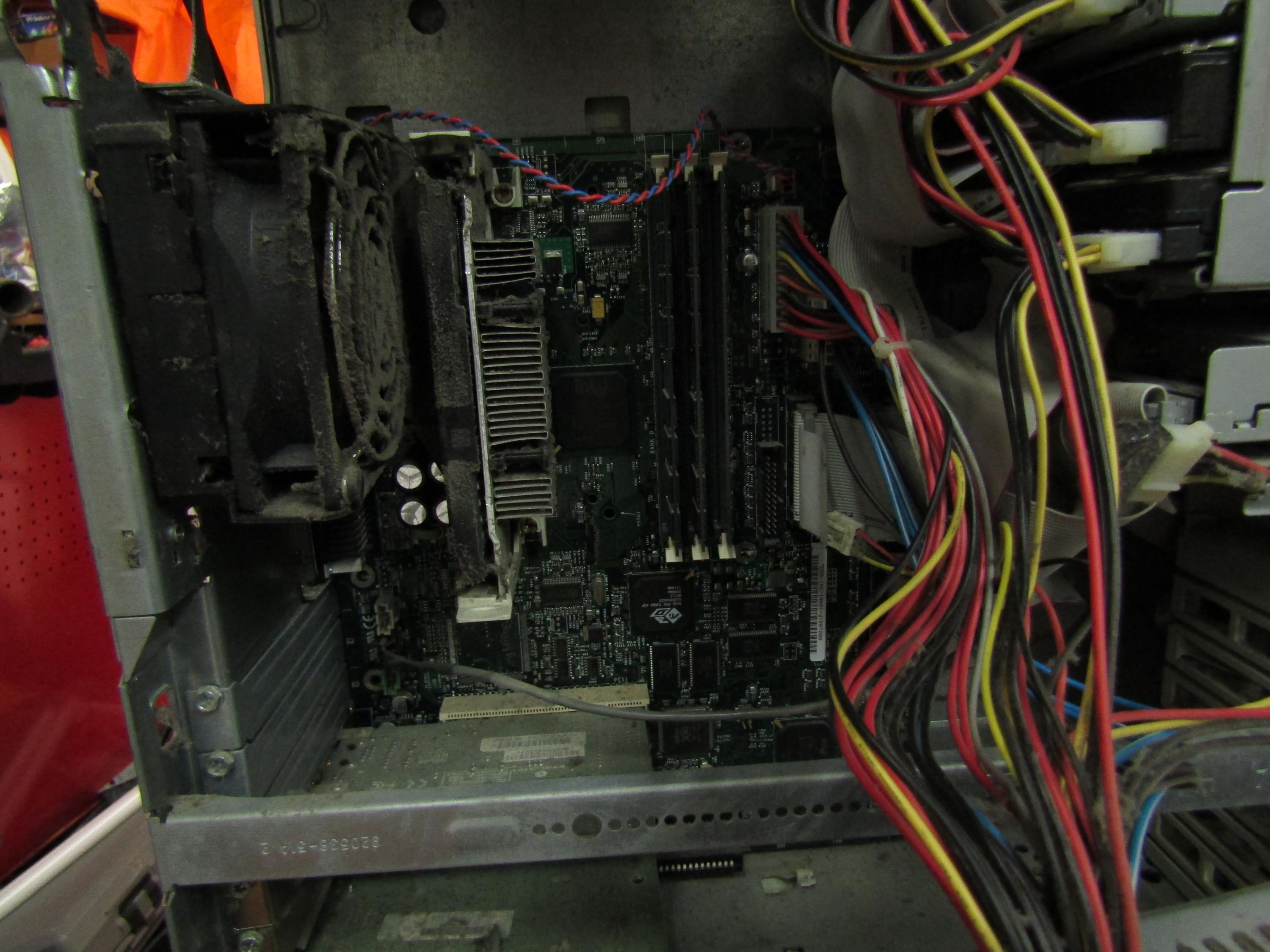

                  Picked up a few computers a few months ago, most of which, were scrapped for parts, except for two.
                  The first one is this dell, something is wrong with it because of it powering up (fans & hard drives spinning up) the moment i plug it in but not booting up at all, and i could not shut it off without unplugging it.
                  I'll post more info when i start taking it apart.

                    Looks like either a bad CPU, missing CPU or RAM, or the 12V CPU power connector is unplugged. Failing that, check PSU and/or motherboard.

                          Not on these old Pentium II/3 Dell PCs!
                          Anything from the Pentium II/3 era will NOT have a 12V CPU connector. Also, these particular Dell PCs, like the one posted above, typically came with proprietary-wired ATX PSUs. I believe there are 3rd party adapters available online still for converting a standard ATX PSU to use with these older machines. But that shouldn't really be needed, as the PSUs that came stock with these old machines were generally quite bullet-proof, typically with Japanese capacitors too.
                          I'd say just clean the mobo, re-seat the RAM several times, re-seat the CPU, and make sure to put a good CR2032 CMOS battery in there. IIRC, some of these Dell PCs won't actually boot properly without a good CMOS battery. A bad HDD or hung IDE device can also make the entire system hang. So do a minimal hardware boot (i.e. mobo, CPU, RAM, and known good video card only.) Other than this, there isn't much else that can go wrong with these machines. They use i440 BX/LX chipset and also tend to be pretty bullet-proof. If it's not flaky RAM, wrong jumper settings, or the items listed above... it must have gotten zapped by something.

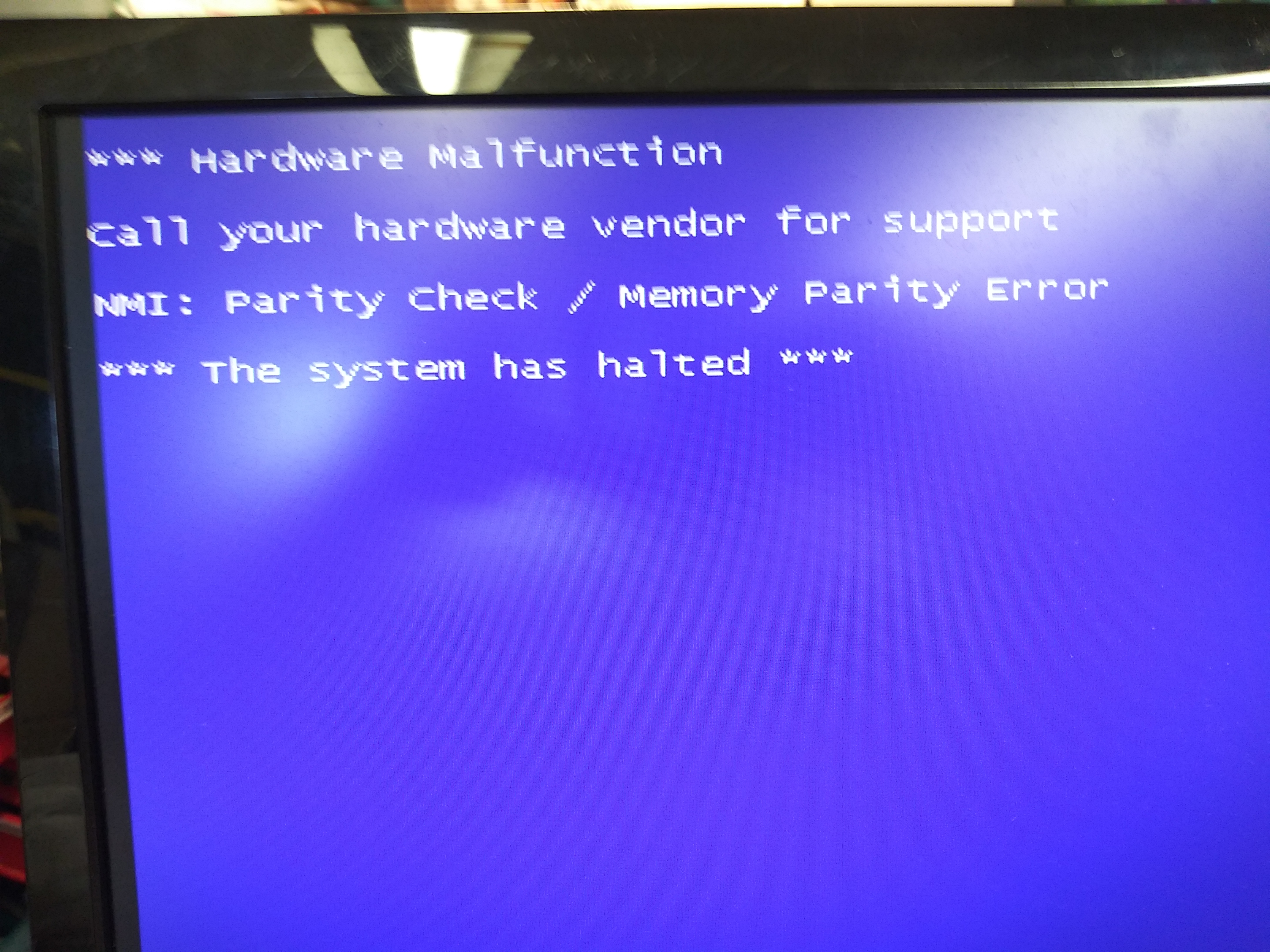

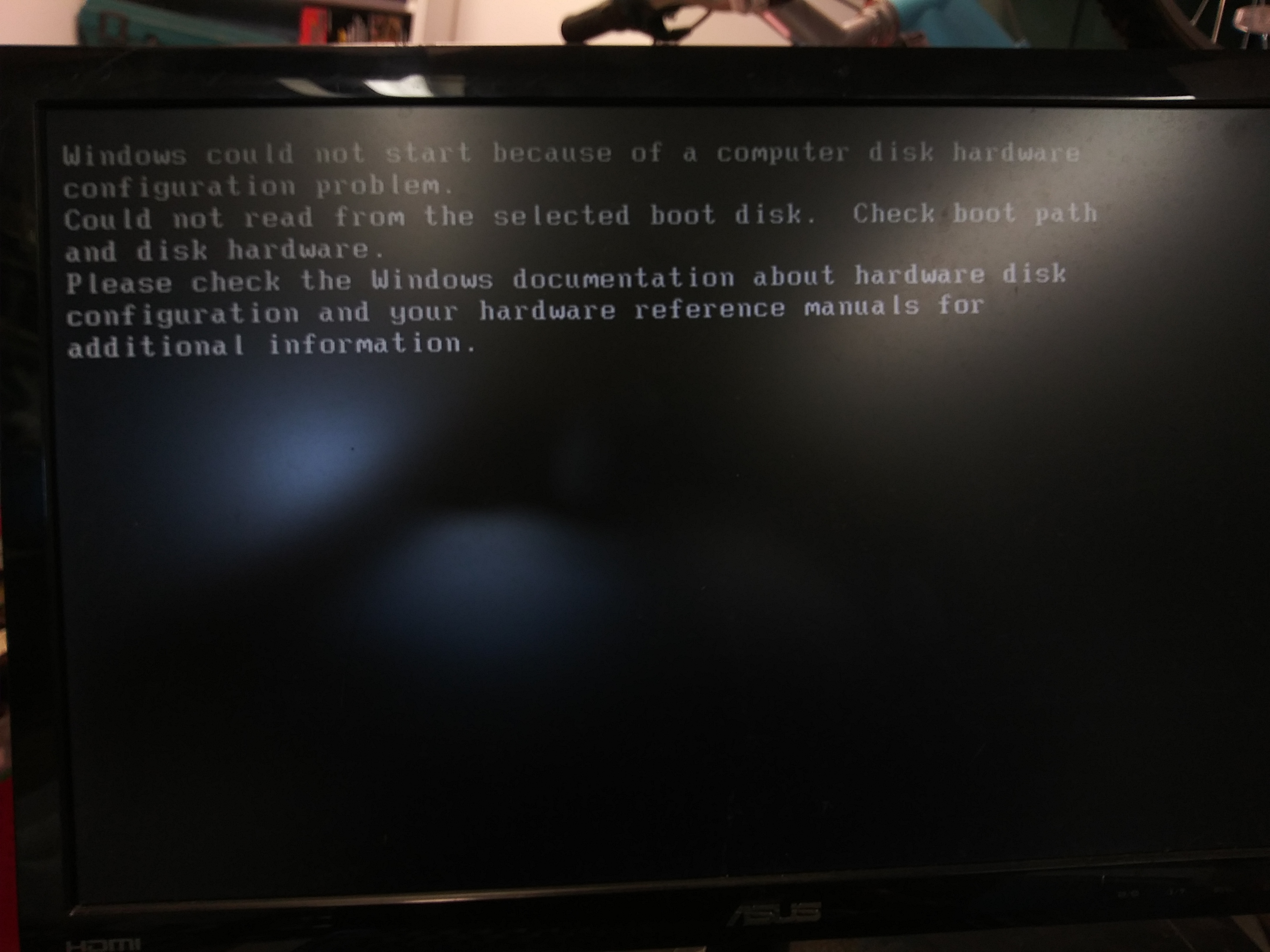

                              I was testing it again today and got an error message after powering it up.
                              So i juggled the RAM a bit and almost got it to boot to OS (Win XP)
                              But then i got another error.
                              I'm going to try reseating the hard drive connectors and see if that does anything.
                              The computer still powers up the moment i plug it in for some reason and the only way to turn it off is by unplugging it.
                              edit: After reseating the hard drive connectors, i was booted into a BIOs screen.
                              Not sure why i'm going through all of this considering the main reason i picked up this PC was for the case :|.

                                lol, there are those of us who love this retro p2 and p3 stuff so thank you for testing the stuff out for some of us so it makes it easier to unload the stuff on one of us. if it was totally dead and broken, we would have told u to just junk it in the landfill so once again, thank you.
                                since its working and has some signs of life, the symptoms seem to indicate multiple bad components. looks like the hard drive could be dying with bad sectors and that memory error u are getting could indicate bad/dirty power going to the cpu and/or ram so the psu could also be suspect unless u can confirm the caps in the psu are jap caps. the mobo could also have bad caps unless the caps are jap caps so post some pics of the mobo.

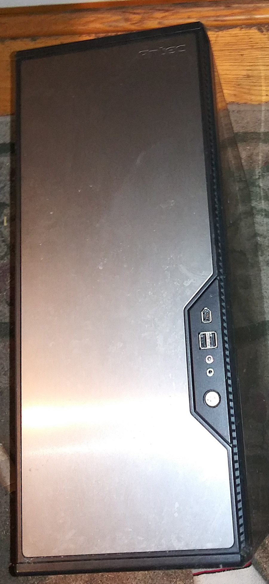

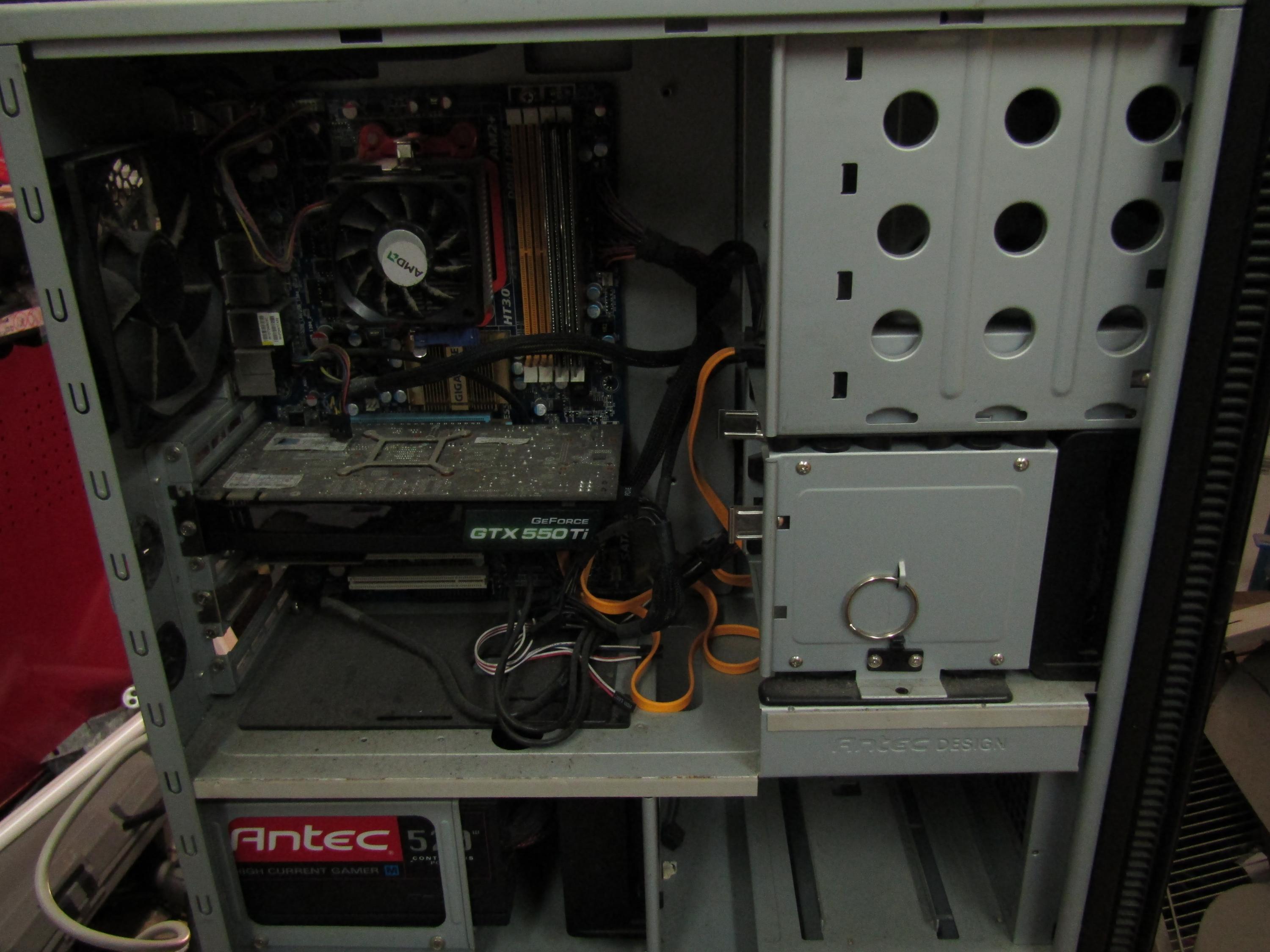

                                  The Mobo caps are all NCC and the power supply caps are all NCC & Rubycon. So i think they should be good, the only issue i know about is the odd auto power on issue (though that could be a flaky power button for all i know).
                                  Inside the PC........

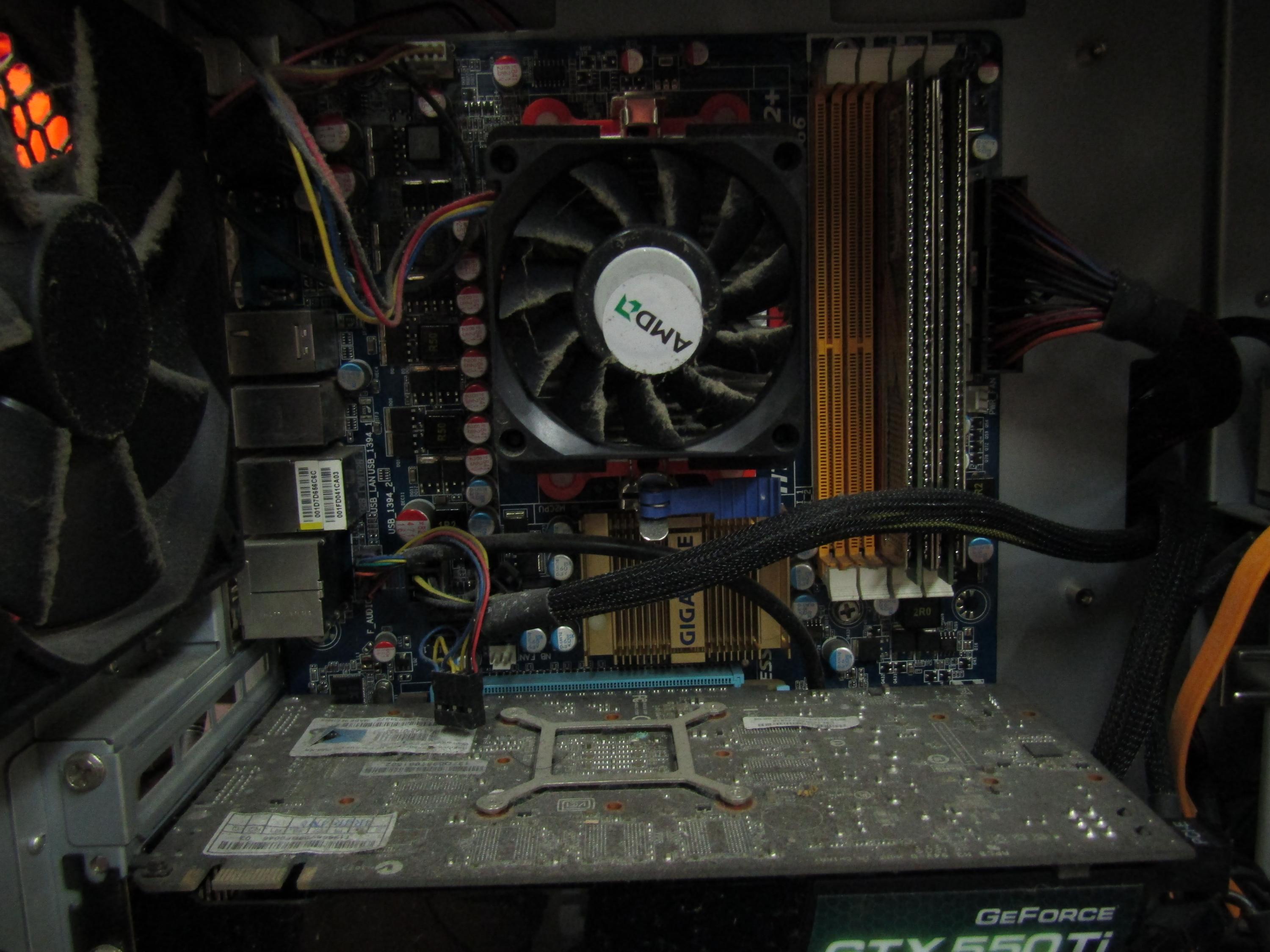

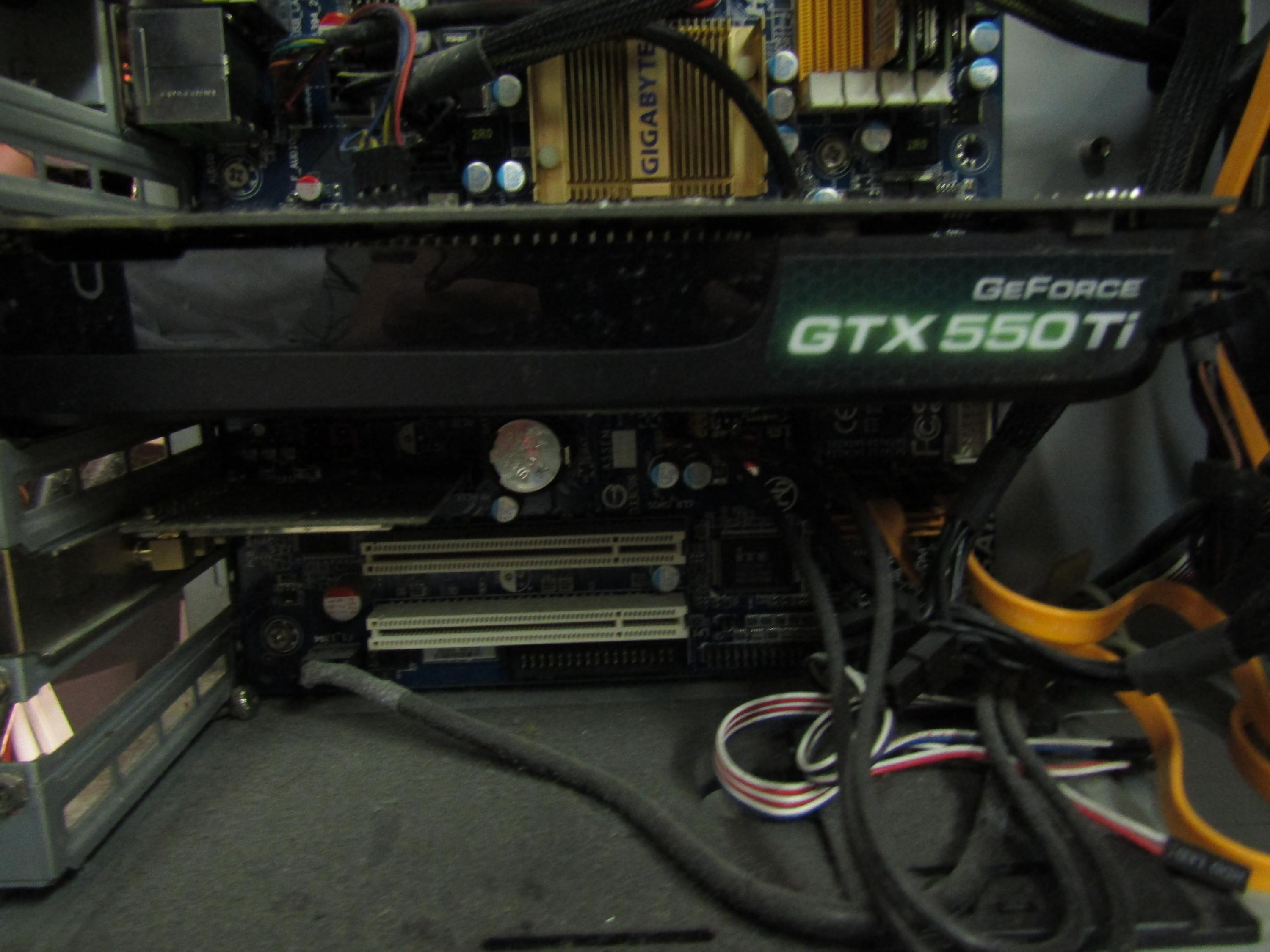

                                  Attached below are some photos of the 2nd PC i found (an Antec 'Gaming Rig') that i still need to test.

                                    I'd hate to see what the rest of their house looks like!
                                      Yeah, i'm guessing it came from a pretty messy household.

                                          ... So i juggled the RAM a bit and almost got it to boot to OS (Win XP)
                                          https://www.badcaps.net/forum/attach...9&d=1570744535
                                          Yup, seems likely to be a RAM issue.
                                          I would do a full removal and re-insertion of the RAM. If you have any known good SDRAM of your own, try that instead. The RAM that came with this computer could just be flaky, for all we know. I don't trust RAM from junk PCs until I've tested it (typically on a known good system of my own.) This helps minimize problem guessing quite a bit.
                                          As for the HDD... oh, I wouldn't trust a junk-picked HDD either. Same as the RAM - I typically connect it to a good PC and test there (pull SMART log and do a full surface read test with HDTune or a low-level format.) In fact, last week I was trying to re-use a 500 GB Seagate HDD that I suspected was flaky. Guess what? Half of the PCs I tried it in would not boot or hang at POST. Only a select few POSTed with it. When I tried to use it in a laptop at first, I thought that laptop was faulty. It wasn't, and it was just the HDD being goony. The weird part is that neither SMART nor a surface scan showed any errors when it worked.
                                          These older Dell PCs have a BIOS option that by default powers up the PC into "LAST STATE". Not sure why, but on a system that has lost its CMOS settings (either due to weak CMOS battery or reset CMOS settings), the default behavior is that the PC always powers up by itself. And if there are issues, like yours there with likely the RAM, then the system will hang, and the only way to turn it off is to unplug it. So when the PC is plugged in again, it will try to go back into that "Last State" (i.e. PC powered up).
                                          So again, check the CMOS reset jumpers, checks CMOS battery voltage, and if you go into BIOS, look for an option in the power section that allows you to turn "Last State" to "Power OFF".
                                          Hey, that looks familiar!
                                          https://www.badcaps.net/forum/showpo...postcount=3174
                                          Oh, it's just a tad bit dusty.
                                          I've seen much worse, though! (and sure you have too.)
                                          A high-school friend of mine had so much dust in their house that you could see whole fluffs hanging from the ceiling fans. And they had a smoke detector with bad battery that kept beeping every 10-20 seconds and they never changed that battery for the 5 years they rented that place. I don't know how they slept with that thing beeping all the time and it didn't bother them. If it was me, I'd have changed the batteries on it instantly - regardless if it was or wasn't my responsibility as a renter. Either that, or shot the thing with a shotgun already.
