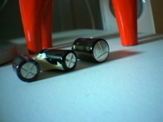

        Hi Mandrakeman
        Welcome to the Forum!
        Your symptoms are consistent with Bad capacitors on the motherboard, in the Power Supply or even on a videocard but of course could be something else.
        Bad or failing capacitors will often fail more when cold but settle down when warmed up a bit. A capacitor problem usually manifests after a couple of years of use and will cause voltage fluctuations and excessive "Ripple" which is kinda like really fast voltage fluctuations. This will cause unstable operation, hard to boot conditions and possibly even "funny humming noises".
        Fortunately, bad capacitors are usually easy to spot. The top of capacitors usually have a "X", "K" or "Y" shape stamped into them. This stamp is a vent that allows pressure from a failed cap to vent without an explosion.
        If any caps are bulged outward at the vent or if any gunk has leaked out at the vent or at the bottom, the cap has failed and must be replaced to prevent further damage.
        Caps to inspect are on the motherboard, the videocard and inside the Power Supply. Primarily, you're interested in any with a vent.
        An "X Power supply" is not a common brand. Is that the name label? This is important because the PSU is likely to be your culprit.
        Good Luck,
        Keri
        PS. The cap on the right has a bulged "T" shaped vent... see picture. This is what you might want to look for.

                      Powmax has a well-deserved very, very poor reputation. I keep a brand new "400w" Powmax under my sofa as a joke.
                      My best advice is to immediately unplug it from the wall and go ANYWHERE and get absolutely ANYTHING else. Even crummy ol' Dynex from Best Buy is far better.
                      But it's probably best to stick with the above mentioned reputable brands.
