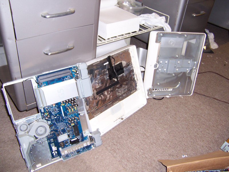

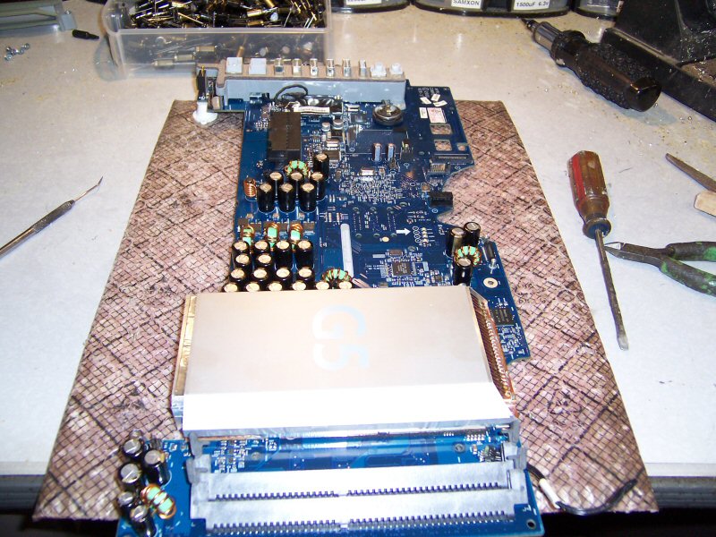

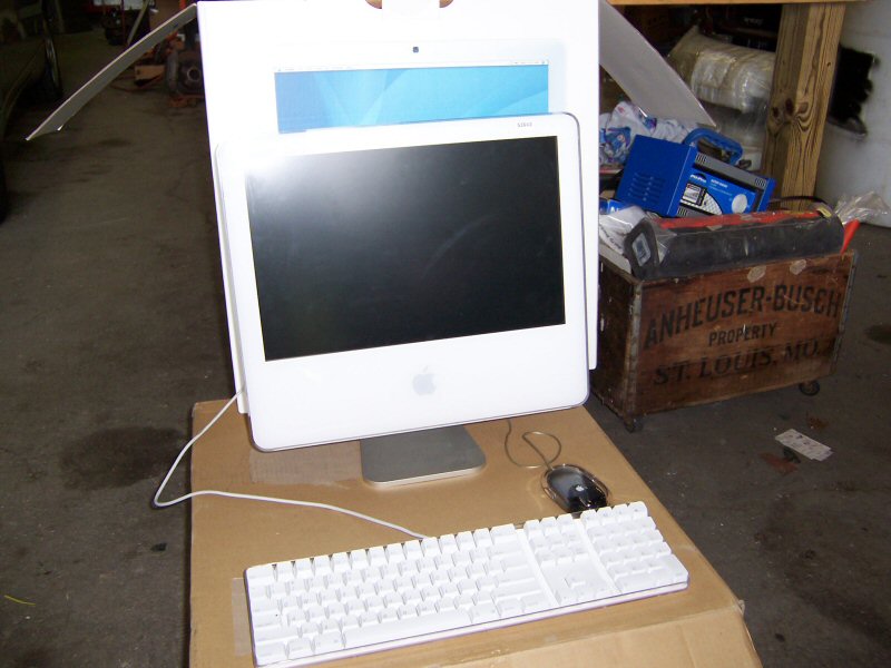

    A G5 Mac this time... I've recapped hundreds of these systems over the last couple years, but I've never seen one intact, I had no idea what a complete one even looked like....so I posted a blurb on Badcaps.net's home page that I was looking for one. Low and behold, I was contacted by someone that had one to part with that was complete. It only took a month before someone was willing to donate one. I'd give them credit, but I don't know if they want their names mentioned. I need to recap it now, but atleast I can say that I've seen one intact...
    it even came in its original box & packing material, with keyboard and mouse.
    Anyway, here she is:

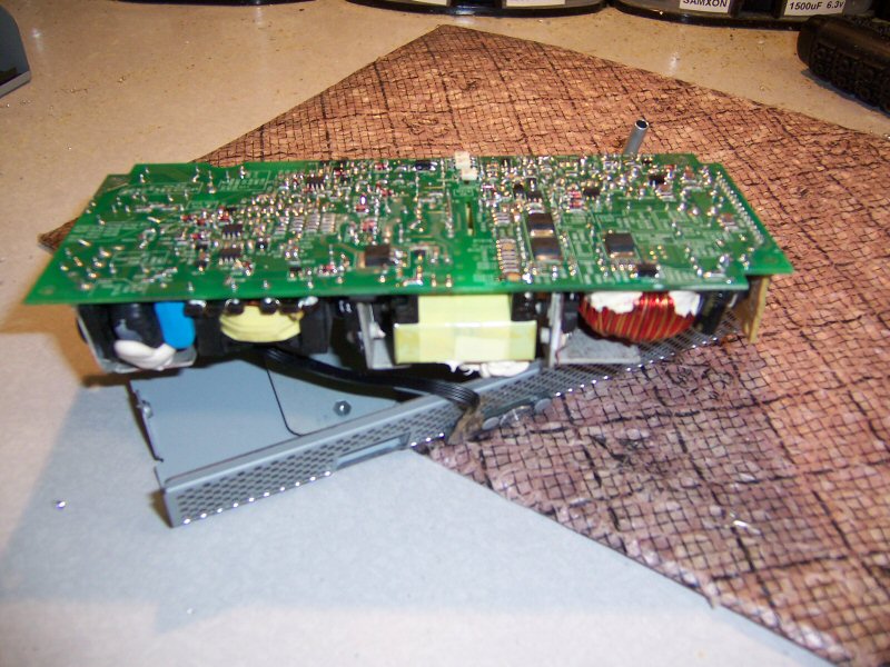

    But the 5vsb ltec caps in the PSU blew. I think you will like the construction once you get it apart even though things are tightly packed.

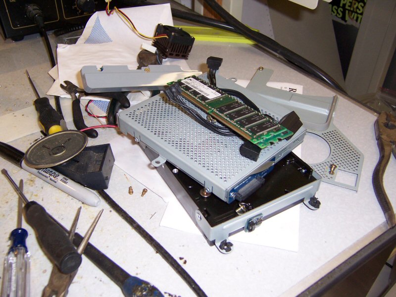

      The last Apple I used was an Apple 2C in grammar school. I know absolutely ZERO about MacOS. I have v10.5 leopard a guy gave me, so that's what I'll be using. This one has a HDD in it, but I'm sure it's been wiped, it was on a business network before I got it.
      It only took me 30 minutes to get the bastard apart... I set it face down on my lap on a microfiber towel. I'm going to recap the PSU, since I'm already in there. The PSU caps appear ok, but I don't want to do this twice.... The mainboard is loaded with splooged rubycon MCZ's, I've seen a lot of them like this. They just overheat...

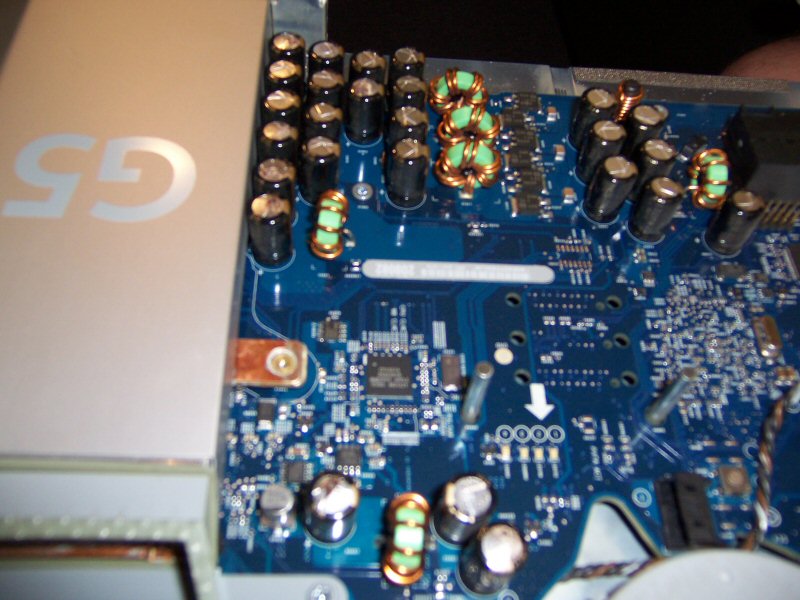

      Here's a few more pics:

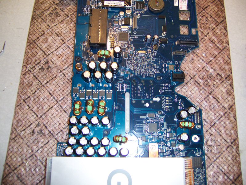

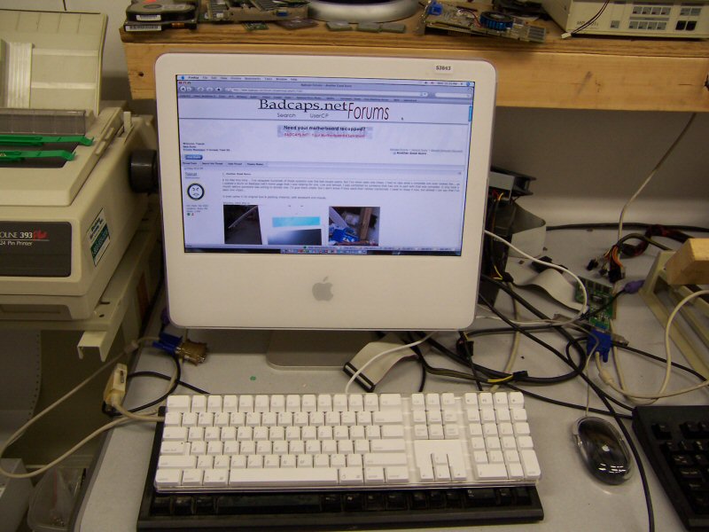

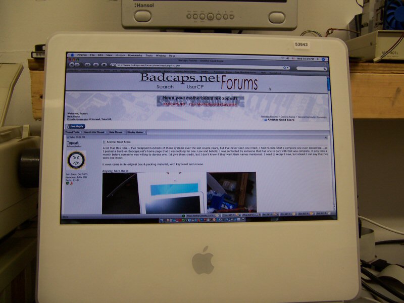

        Recapped and up & running!!
        Fresh Rubies!
        Working!
        It has 2GB system RAM and a 160gb HDD. It wasn't wiped, it actually booted right up...

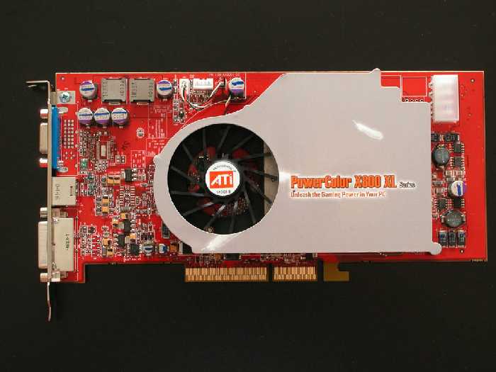

          ratdude scrored some more today! at goodwill again
          ati radeon x800xl agp card 256md ddr3 ram 6$ see below... in box, used, no special cables but had cd and manual
          brother mfc-420cn all in one fax and built in print server. appeared brand new. no ink, i had some from my dead 420cn. works great! $15
          netgear 16 port switch... 10/100, needed 5v 5amp brick, $4 got it to work on a 2amp brick but it is a bit finicky. i will go to the purdue university surplus store... they have bricks like that out the wazoo
          now about the vid card... it doesnt work in my asus a7v8x... i used a 300w delta atx1.x psu... even with only the mobo and card connested to the psu. but...
          it worked in my dad's hp d530 with only the hard drives connected. it has a custom built delta 240w psu. is newer atx version since it powers a p4 nothwood 2.8 ht... or it worked until after bios. box said it recommended at least a 300w psu... i read that the mobo may be the issue... any sugestions?
          i will have pics soon.
          did i get good deals?

            for the card:
            until i upload the pics off my cell phone, this should help with the vid card:

                              Yay!
                              Congratulations and welcome to the wonderful world of Mac.
                              From the looks of that screen I'd say it's Tiger or maybe Panther. I advise you to stick with what it's got as Leopard will make it run hotter and hotness got it where it was yesterday.
                              Just click on that apple thing in the upper left corner then "about this Mac" It'll tell you all about the software and hardware.
                              Only thing: There is a password. The OS installer won't take no for an answer and requires a password to install the OS. The password must be known in order to make any system threatening changes. Here's some advice on resetting it: http://www.macobserver.com/tip/2003/06/16.1.shtml

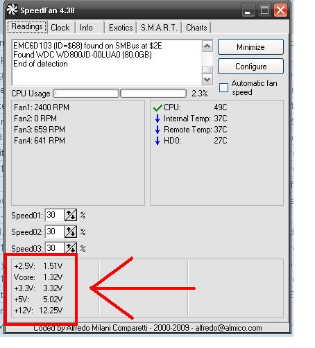

                                  The voltage sensors in the bios are not accurate. You need a dmm to properly get the voltages.
                                  That being said, the AcBel is still a tank and indestructible.

                                      Originally posted by KeriJane
                                      Yay!
                                      It had 10.4 on it. I did a clean reinstall of 10.5 this morning...... :-/ If you have a copy of 10.4 that you could spare, I'll give it a whirl though...
