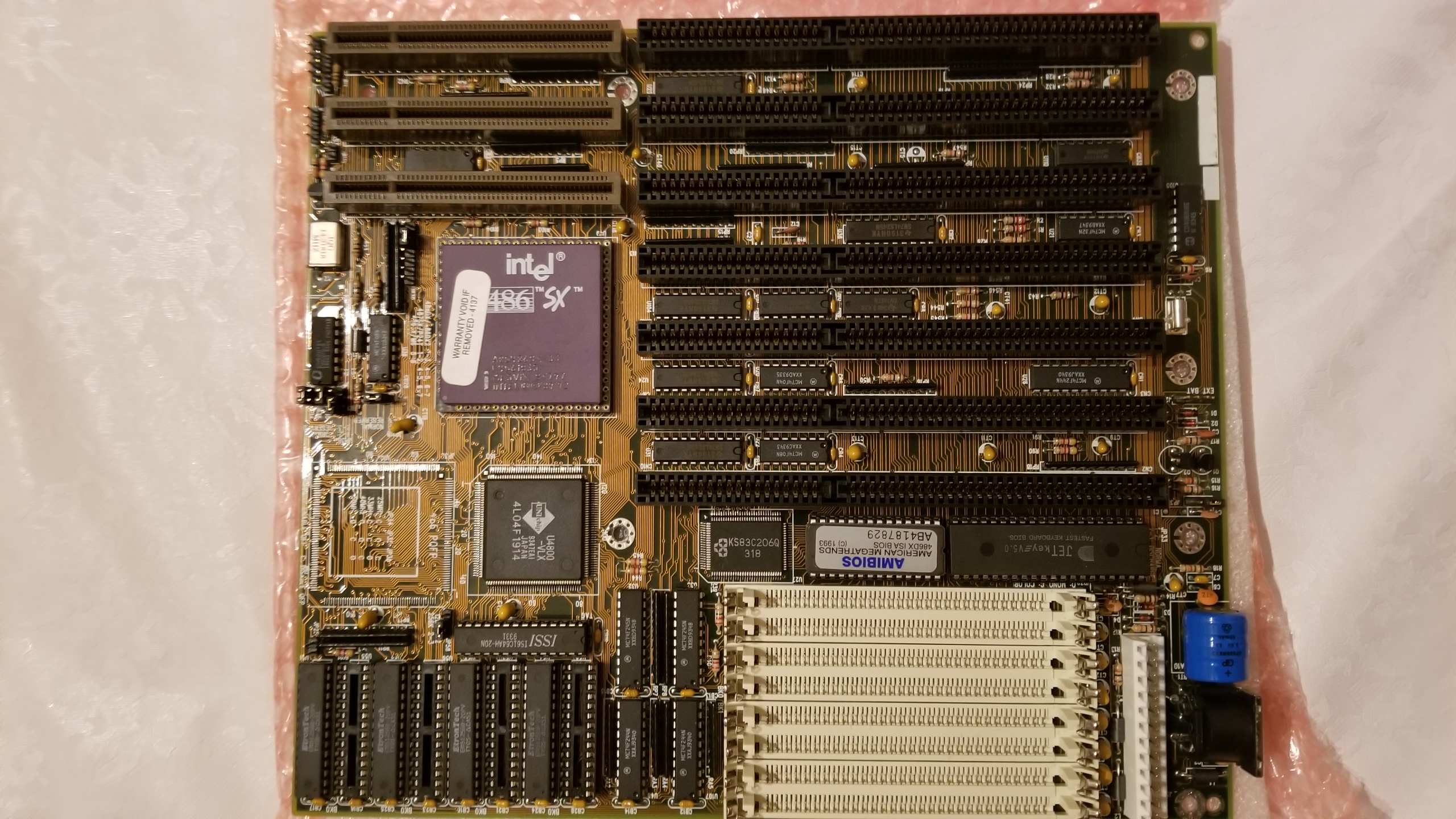

    Considering building a retro system
    The friends of my best friend sent over three boxes of computer stuff they wanted me to look at. One thing I found was a LIKE NEW AT motherboard. With a 486sx. No IDE, just 5 pin din on the back. 16 bit isa videos card found too. I'm tempted to build an old dos box, even get doom on it.
    At psus are available new on newegg but cases are not
    Guess I need a sound card and an ide/floppy isa card too
    It does have three vesa expansion ports

    Re: Considering building a retro system
    visa? sx cpu? that is old.
    got cache chips on it, or empty sockets? that will make a huge performance difference
            It has one chip missing
            there were a few dx and sx chips in a bag too. I should have taken those
            is that missing chip a floating point coprocessor?
              • 31200
              the space is for a soldered in cpu, forget that.
              at the bottom is more interesting, 4 cache chips and 4 sockets that may allow another 4 - download a manual.
              and if it supports it, get a dx4-133
                unfortunately, I have yet to find a model number
                you can see the cpu support by the jumpers by the cpu. it supports a DX2, says nothing about a 4
                  Try using google's photo search (though you may still end up with a gazillion "close but no cigar" hits...
                            luckily I found a small box with a buttload of 30 pin simms. that was included
                            hmm I do have several scsi 50 pin drives. Before such a thing I need to test the board itself
                              • 31200
                              you may get the board i.d. from the boot message.
