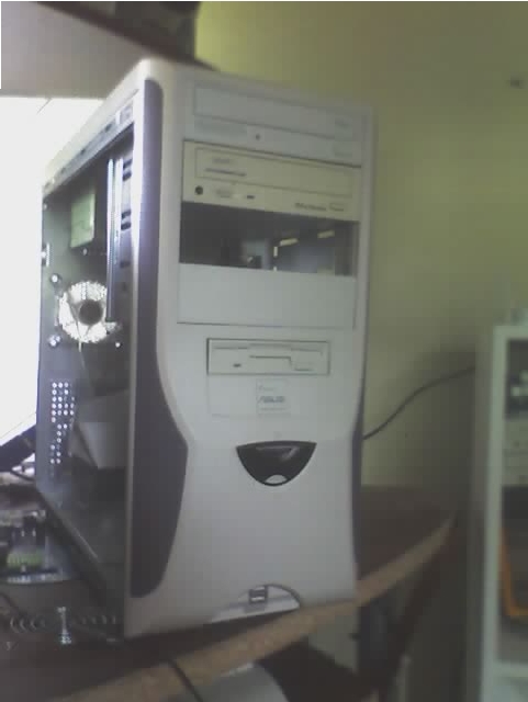

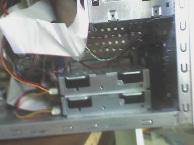

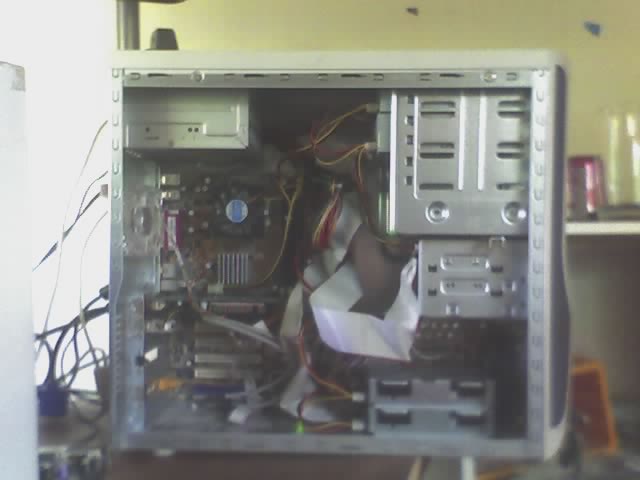

            anyway, time for some pics: (note these are AFTER i started swapping parts)
            front of the case. minus the missing usb door and missing drive bay cover, it looks cool? please comment on the looks since ratdude the king if case dors found one without one.
            the side of the case. case is nice and roomy (not as much as my chieftec hardwired special but still not too bad)

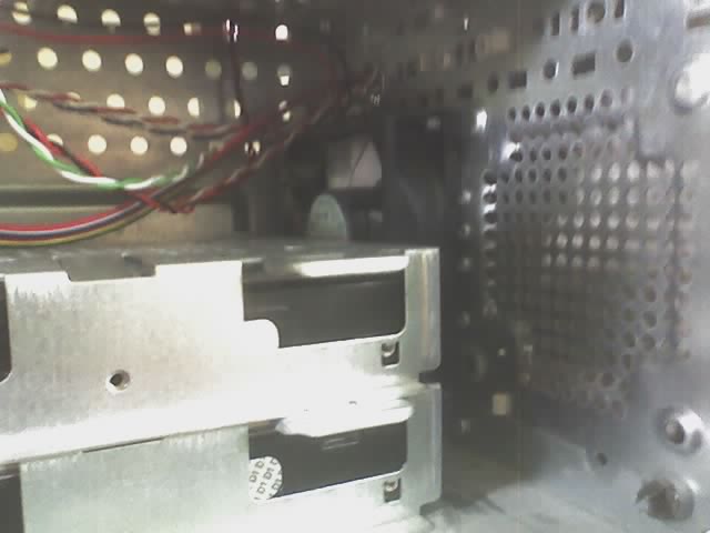

            2 lower hard drive mounts. right in front of fans. speaking of front fans:
            notice second fan mount location

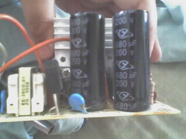

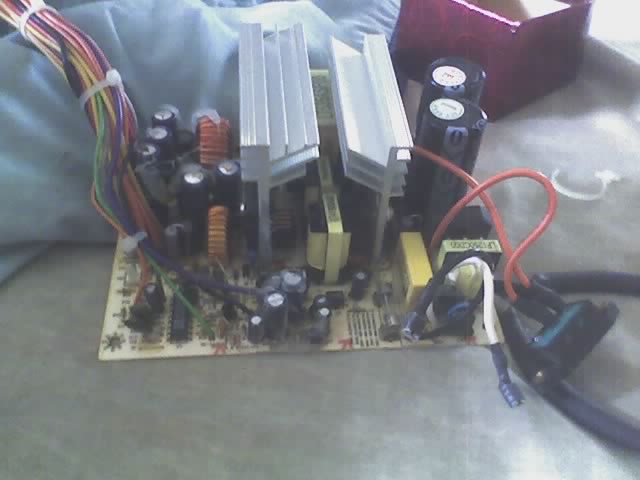

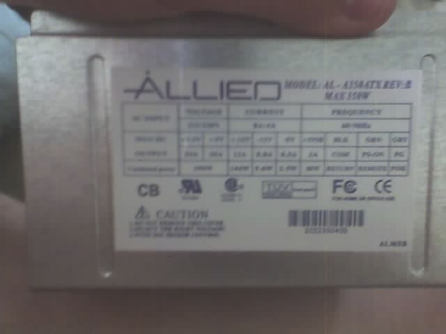

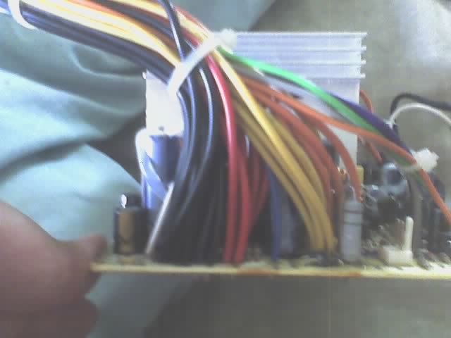

              as for the power supply, some pics of that:
              label of power supply. rated for 350 watts
              the board. plenty of guts. i think i see a 5v pwm chip
              the wire. appears to be same thickness as my delta.

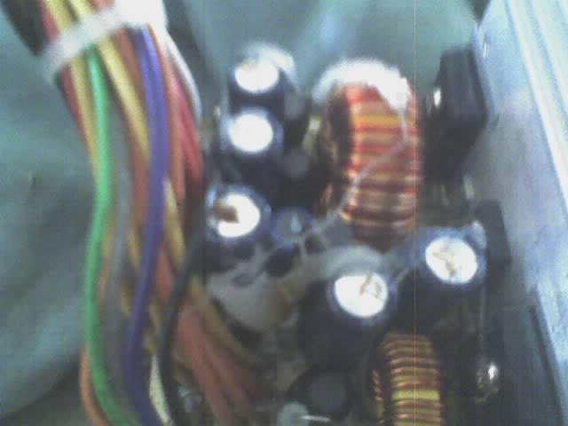

              now for some caps:
              5 blown caps. jun fu or something like that. bulged and leaking
              yc primary with regulator present
              is this worth a recap? it has lots of plugs and seems to be good other than the caps.

                Like the others, I think you could have gotten a little more for $99, but it's definitely not a bad deal.
                Case is okay, nothing special about it that I can see. The slots for the the hard drive fans are a bit inefficient though since there's no intake vents on the front of the case.
                That Allied PSU looks pretty decent. Recap the secondary side, the 5vsb output, as well as any caps that might have these specs: 25v 22uF, 50v 22uF, 25v 47uF, 50v 47uF. You can leave the two primary caps if you want. Everything else looks good as is.

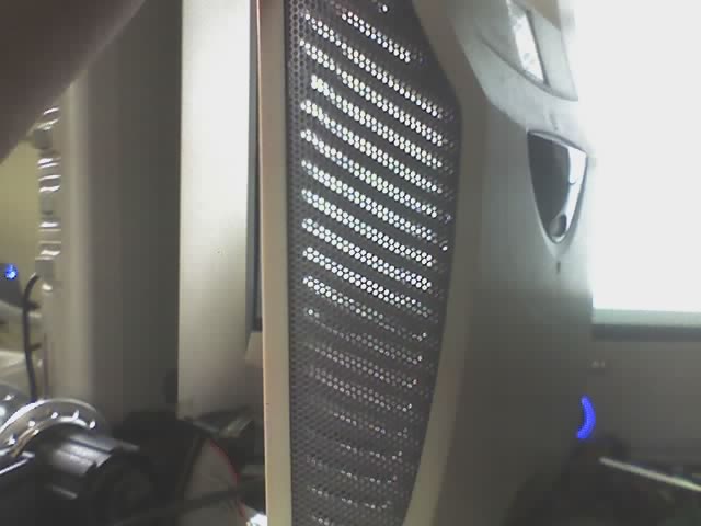

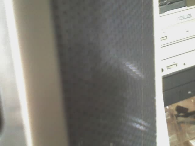

                  yes there are vents. the blue side pieces on the front are mesh. frame metal behind that has stamped vents as well:

                    better pic of vents (in front of monitor (light source)):

                        Thats a better allied for sure, good sized heatsinks, good transient filter, and a bridge rectifier.
                        Jonnyguru did a new 500w allied, it went ka-blewy at 350W, but it was based on a different platform. One of the primary switchers blew out. The secondary silicon was all up to snuff with the label.
                        Interesting with the two small transformers, usually those are used on higher wattage unit with more umph on the 12v. Basically one is for the 5vsb, the other is a small supplementary 12v transformer. Don't know what its used for there.

                          Well from the first few shots it sure looked like there are no vents on the case (I blame your camera though ). But I take back my words now, these vents are nice.
                          One thing you can do to improve the airflow on the hard drive fan(s) is to cut the grille in front of them. Should be easy if you have a dremel.
                          As for caps on the secondary side of the power supply you can use FC and FM (Panasonic), PW and HE (Nichicon), LXZ, KY and KZE (United Chemicon), and YXG (Rubycon).
                          If the power supply doesn't make a line-buzzing noise or the fan on it wasn't stalled when you got it, just keep the YC primary caps. But if you do have better caps to replace them with, then why not.

                            i only powered the supply once, at the store just to show my mom it worked. if no caps were bulging then she wouldnt let me recap. she doesnt understand working but unsafe.
                            sorry, i was using my cell phone for pics. lame vga. my good one, some vista quest 7.0 mp crapper, needs new aaa's and i was too lazy to search the house for my stash. my parents moved them because the remote got hungry.
                            based on the pics, does 350w sound somewhat accurate. once i get around to recapping it i want to put it back in since my compaq-branded delta desnt have the plugs i need. ok, it does-kinda. i dont want to mod it like id did my delta 350-w 20+4 beast... that was fun but im outta zip ties and wire nuts.
                                If the primary switchers are in a TO-220 package, expect 250 watts more or less with some amount of heat. Push it anywhere near the 300 watts mark and it will become unsafe and probably too hot to run reliably.
                                I'd recommend you use it with either only 5v-based systems (such as your Athlon XP) or very light 12v systems.

                                is nichicon rz ok?
                                No. It doesn't seem to have enough ripple. Probably not low ESR either.

                                        soldered the new x/y caps in. the nippon chemicons look pretty in there. no more yc crap. the other caps have yet to be ordered. i also shorted the 115/230v switch since i do not anticipate using it overseas... i assume canada also uses 115v, right? (not that i would be likely moving there).soldered the new x/y caps in. the nippon chemicons look pretty in there. no more yc crap. the other caps have yet to be ordered. i also shorted the 115/230v switch since i do not anticipate using it overseas... i assume canada also uses 115v, right? (not that i would be likely moving there).

                                          You mean secondary caps, X and Y caps are in the transient filter.
                                          I only see one X cap (the yellow rectangle by the AC input) and maybe a Y cap (a little blue disk near the AC input, not by the main caps) but there is a filtering coil too. Sort of complete input filter, should be more x and y caps and maybe another coil.
