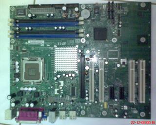

    It did it twice today. This time, it took a few tries to make it boot. I'm gonna take it out of the case and put it back in, maybe it's some sort of funky grounding issue?
    Barring that, f*** this board. I'm not messing with it. I'll eat the $75 and consider it a lesson learned.

        Goddamn, this thing runs so good for what it cost me, I'm gonna give it a go. I've got a dead 1-year-old Biostar I can pull caps off. Which caps do I need to look at? And on which part of the chipset, northbridge or southbrige? Southbridge runs pretty hot and isn't heatsinked.
        Also should I try pulling the board out of the case and remounting it just for shits and giggles, or is that not really likely to solve anything?

          Make sure your power connectors for the motherboard are seated all the way in. As in they are all the way down and the tab clicks.
          I had this problem on my Biostar Tpower N750, it would sometimes just give a black screen and all fans when your started it up. Turns out the 24pin wasn't seated in all the way.

            I'll take it out of the case and pop it back in, double checking connectors.
            Last time it refused to boot, removing the molex plug made it boot. I probably bumped the 24pin connector while I was removing the molex. Are cold joints possible?

              Would a board this vintage (late 2004 it seems) be RoHS? It has no lead/pb free markings. I'm gonna pull it out of the case, clean it really well, clean all the contacts on the 24-pin ATX and P4 connectors (the molex too while I'm at it), and resolder the 24-pin and the P4 connectors. If it does it again, I'll replace any and all caps near the north/southbridge.

                            Redid all power-related connectors (ATX, P4, Molex) on the board today. It took the surgery well and booted just fine afterwards.
                            Only time will tell if that fixed anything.
                            kc8adu, POST card is just not worth it to me. If a simple solder reflow and/or recap doesn't fix this, I'm just gonna buy a new board.

                                          Just thought I'd update this thread.
                                          The "operation" was done on 7/28. It is now 8/15 and the board has yet to give me any crap upon boot again. Prior to resoldering, the longest it had gone without a failed boot was four days.
                                          So, for anyone with an intel board with intermittent POST fails:
                                          1) Resolder every pin on the 24-pin ATX connector.
                                          2) Resolder the 4-pin P4 connector.
                                          4) Resolder the Molex connector while you're in there.
                                          5) Find a skinny paint brush/pipe cleaner?/whatever, dip it in cleaning alcohol, and clean every pin on every connector you just resoldered thoroughly. Alcohol dries quickly, so let it sit for just a few minutes and you should be fine.
                                          6)Unplug/replug the ATX and P4 connectors twenty times each.
                                          That seems to have done it for my board (Intel D915GEV, circa late 2004).
