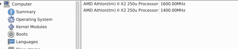

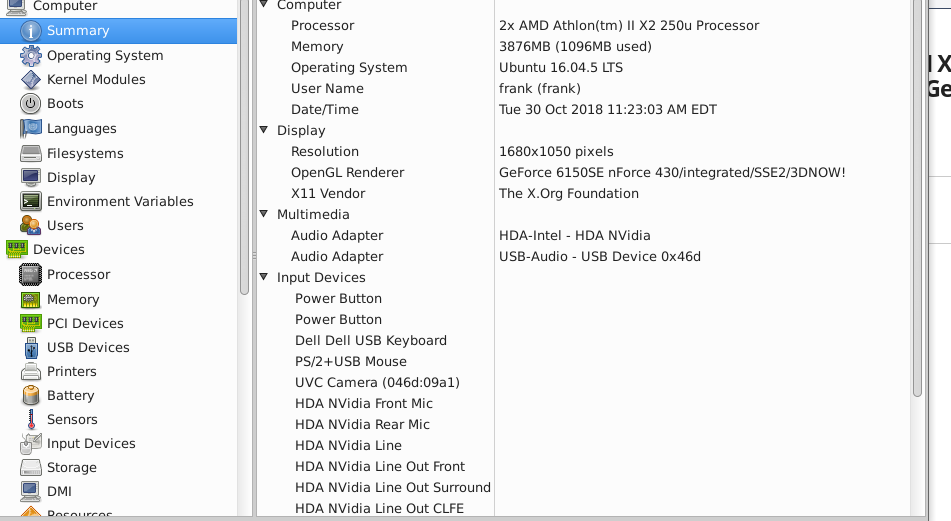

    Hi guys ;i'm trying to figure out the CPU/mother board,also want to get a External video card because of the issue i have with software 18.04 with integrated Nvidea card.

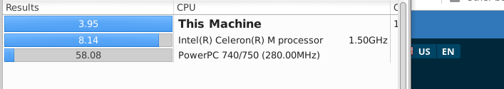

    This E machines when i google specs of this CPU come up with 3 GHZ cpu but when i run benchmark info only have 1.5 GHZ ? also some pics; any help would be appreciated on suggesting an external Video card that won't cost me an arm and a leg.

    u are having some confusion with the cpu model numbers. there are actually three different athlon ii x2 250 cpus: athlon ii x2 250, athlon ii x2 250e and athlon ii x2 250u. the e suffix denotes the energy efficient version and the u suffix denotes the ultra-low voltage version.
    the one shown on the newegg listing is NOT your cpu. u have the ultra-low voltage athlon ii x2 250u which runs at 1.6 ghz. the reason why it shows two different clockspeeds for each cpu core is because of amd cool n quiet which throttles the cpu clockspeed when idle to save power especially since u have a cpu type that is meant to conserve power.
    there is nothing wrong with the benchmark. in that benchmark, lower numbers are better. it compares your machine with another intel celeron 1.5 ghz cpu and with an apple powerpc cpu.
    however, it looks like u have the infamous bumpgated geforce 6100 series chipset. this type of motherboards are prone to failure due to defective materials used to manufacture the chipset. the issues u have may be due to the chipset finally kicking the bucket. i suggest getting another computer which doesnt use a nvidia chipset instead.
