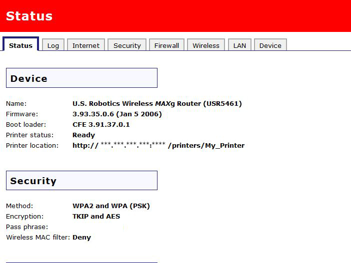

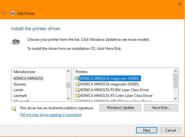

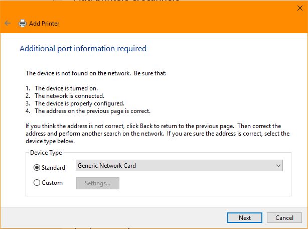

    Hey guys, not sure whether to put this in computer discussion or networking but I think it fits here best.
    I have an old Konica Minolta 2430dl color printer that is super old but still works really well. It has very high capacity toner drums which is really nice. It used to connect to the network but it got hit by lightning and blew the ethernet card out of it. Since then (at least 6 years ago) I've been using it in conjunction with a USR5461 router with a usb print host which works well. Up until Windows 10 updated.
    It now prints pages too far up or too far down on the paper so that some of the image is cropped off and sometimes even twists the image so that it looks like it's sliding off the page. However, sometimes it will print perfect. It doesn't seem to matter what program or print settings I use.
    When I originally set it up with Windows 10 I couldn't get it connecting at all. I'd go through the TCP/IP setup wizards but it would never connect. Finally I just gave up. After not touching it for months I ended up accidentally sending a print job to it and it printed just fine. So basically I have no idea how I ever got it working the first time.
    Now since Windows has butchered my OS with their new update, one of the issues was all my printers were deleted. I went through the TCP/IP wizards and couldn't get it to work. I ended up not choosing the TCP/IP option and just typing the address into the "printer name" networked printer option in the add printer wizard which allowed me to print but with these strange intermittent issues.
    I did some searching and some results said the issue might have something to do with the internet port being used to print on my computer. I think this might be the right path because now when I go to printers-my_printer-printer properties-ports, it shows up as using an "internet port" instead of the previous TPC/IP port. However, I have no idea what any of this means.
    Hopefully someone has some ideas. Thanks

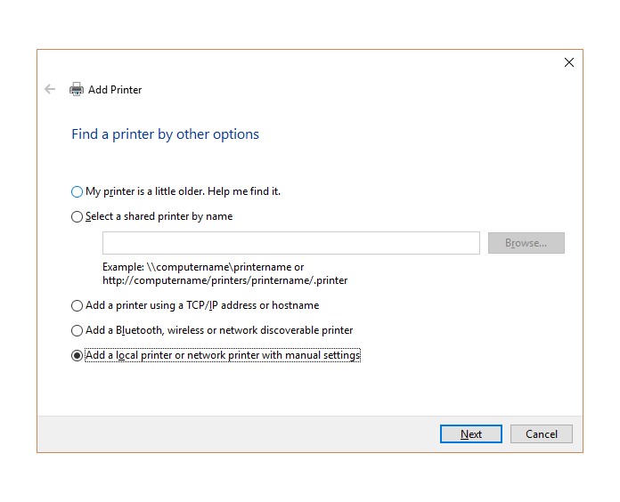

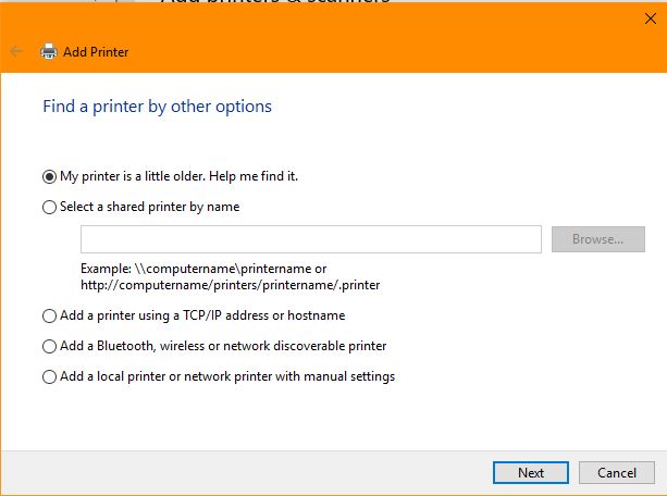

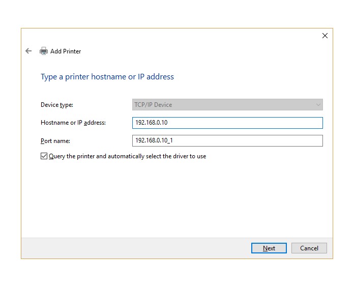

                when you went to Add Printer, did you choose "add a printer using TCP/IP address or host name " or did you choose "add a local printer or network printer with manual settings"
                Use the add a local printer, then create a new port, standard TCP/IP port and enter the printers ip address, see if that helps
                  Thank you for the first reasonable response to my question. I will take a look at that and get back to you.

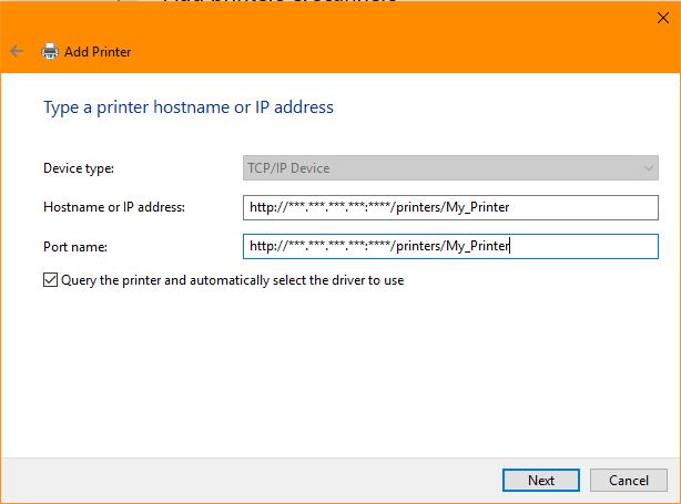

                    To get it to work at all I put the address in the "Select a shared printer by name" box and then selected the driver. I've tried what you suggested and all combinations of it with no avail. Interestingly, choosing manual settings then TCP/IP brings me to the same page as though I just chose TCP/IP originally.

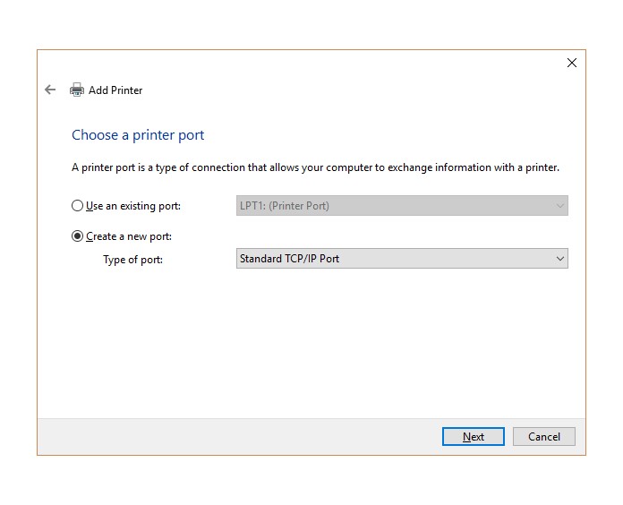

                              The drive I have windows 10 on quit yesterday (seagate 160G) but I have it working today
                              Choose add a local printer, create a new port (standard TCP/IP Port), enter the printers ip address, It should detect the printers ip address, then proceed to picking the driver.
                              I am using an old Laserjet 4 without a problem

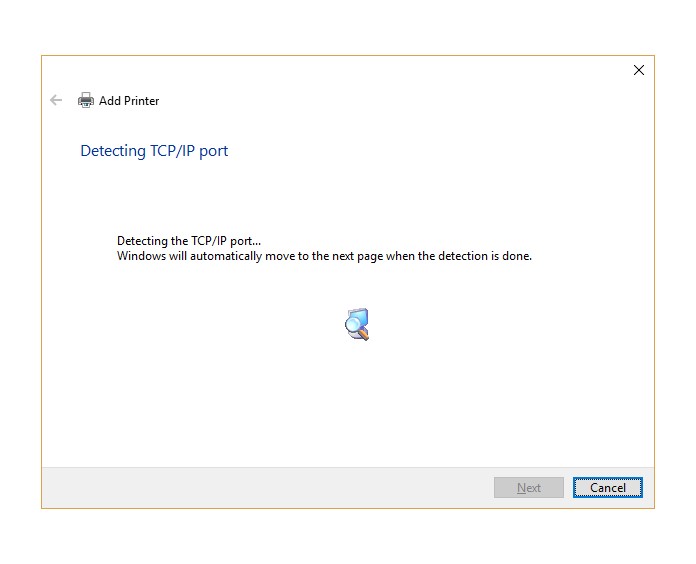

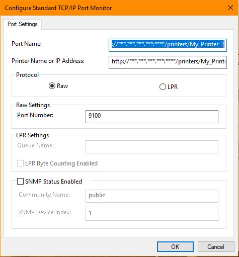

                                Those are the steps I've been following. However, it never seems to communicate to the printer because almost immediately it brings me to the "Additional port information required" page. Selecting custom brings up the "configure standard TCP/IP port monitor" page with the setting shown. Clicking ok and next lets me choose the driver but trying to print a test page results in nothing.
                                I must be going wrong with the port monitor settings I assume

                                    In that first picture, Hostname or IP address, just put in the printers ip address, (like 192.168.0.XXX) Are you using a router or is the printer getting its ip address from your ISP?
                                    • canadaboy25
                                      What is normal?
                                      • May 2013
                                      • 509
                                      Re: Pages sent to printer sliding off page
                                      The printer is connected via USB to the print server of the router. The ip that the router provides is just the router's own ip with the /printers/My_Printer after it.

                                        My printer is just using its jetdirect card in the printer with a ip address, I have'nt used a print server for a while. (Novell days)
                                        The printer should have its own ip address I think you may be just trying to print to the router address
