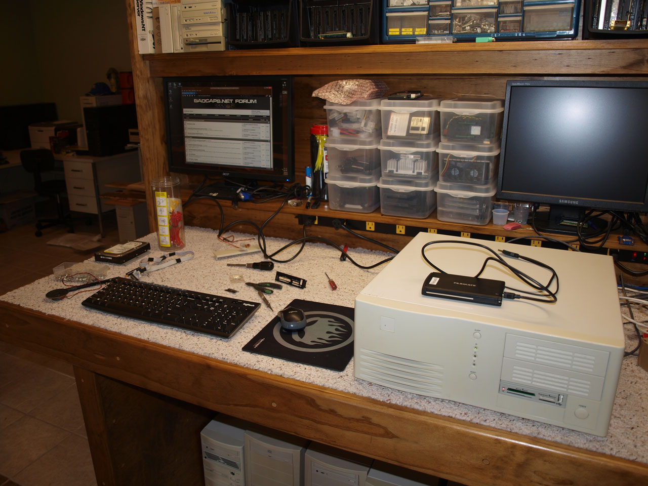

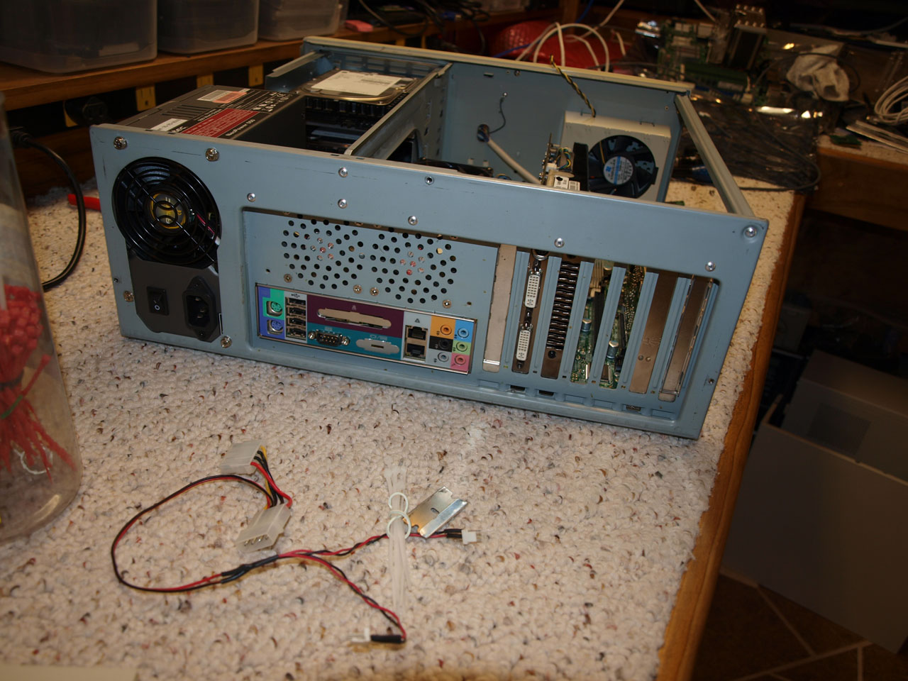

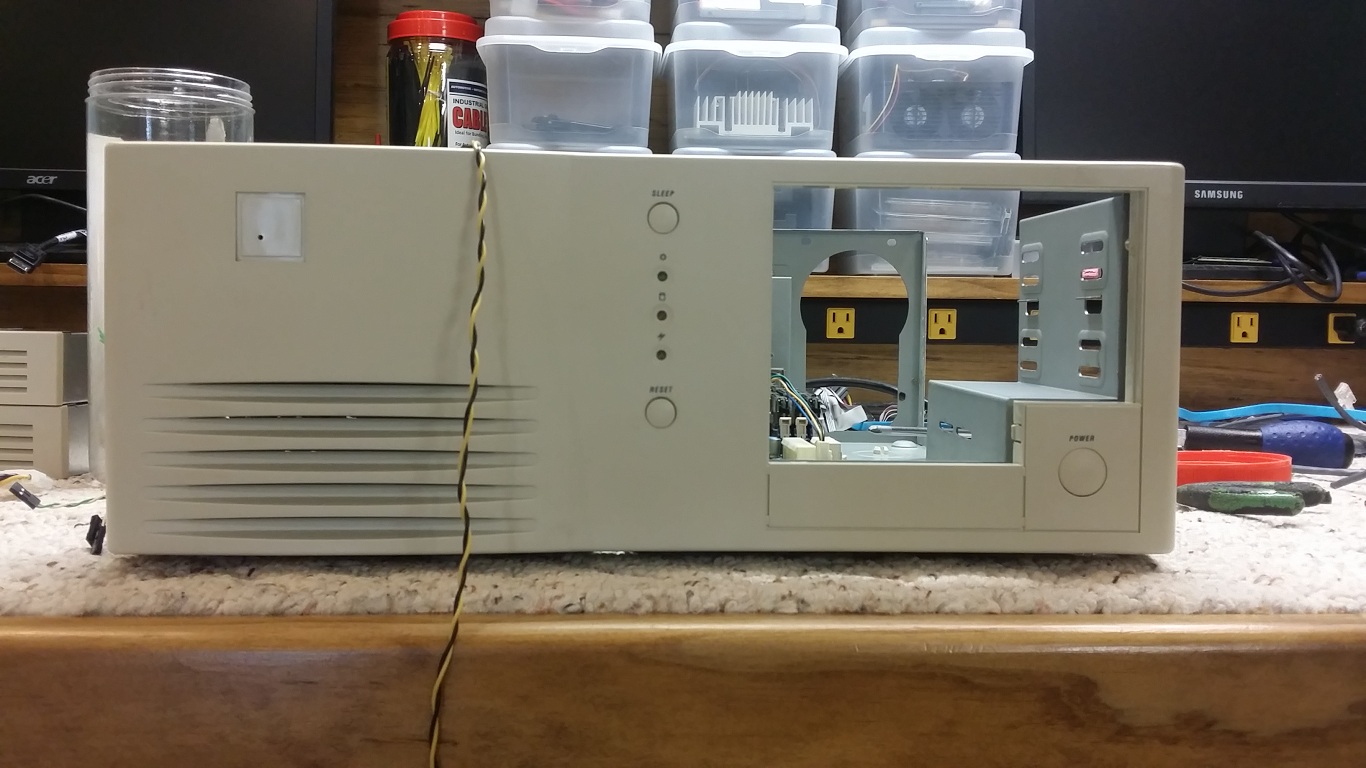

    I bought this case new 20-something years ago back in the 90's. It was bought for a client, had a system in it and sold. It had a P3B-F in it originally (slot-1 motherboard incase you didn't know). A couple years after, I took it back in trade on a newer system, and just kept the case. Horizontal mount desktop style ATX cases weren't easy to find back then, and even harder to find now....and being ancient looking beige, hmmmm.....sleeper build! The board is already fitted....I had to take the dremel to it to make it fit....what fun would a build be if I didn't get to play machine shop with the case!
    More to come!

          Re: Another Goofy Sleeper System

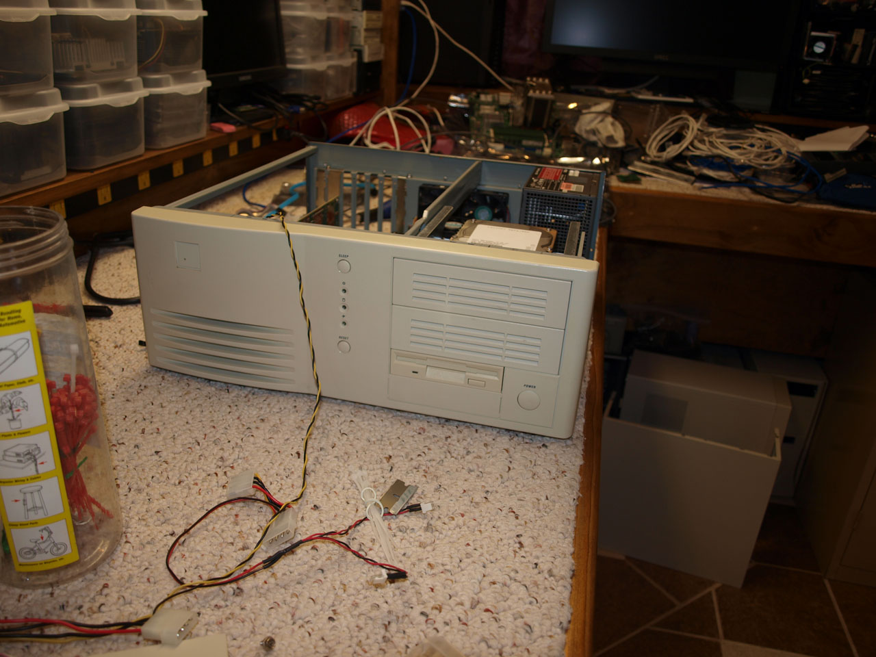

          I popped the baycovers off the 5.25 bays for the pic, just for the teaser shot.... The rear corner and memory are slightly visible.

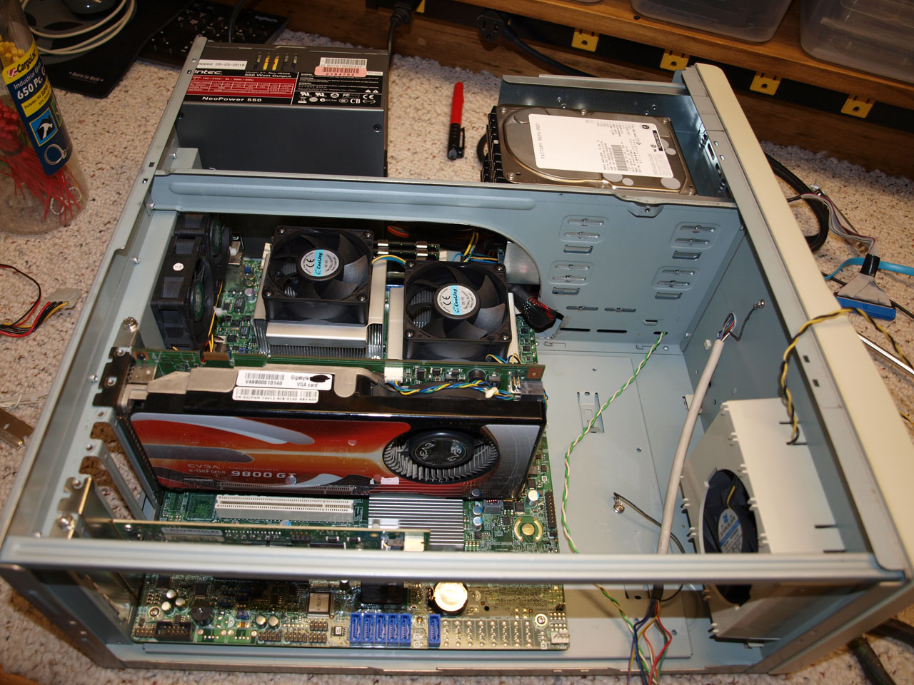

              Close. More of a workstation board (Supermicro X8DAL-i). It came from a recycler source of mine for peanuts (trade caps usually). It came with the heatsinks and a pair of quadcore 2.26GHz e5520's. There's most certainly faster CPU's...I'm just using what's on-hand. I did have to order some memory though....but PC3-10600R isn't expensive.
              I'm kind of short on GPU's right now, so I'll run this initially with a 9800GT.....I'm out of the old trusty quadro FX4800/5800's. Fitment was tight, especially around the 5.25" cage. Less than 1/8" clearance from the back end of anything in the bay....but it cleared! The floppy will be removed....the board has no floppy or IDE controller. I did manage to scare up a beige card reader (wow, those aren't easy to find either), which will fill the 3.5" bay. I'm missing one of the 3.5" bay covers, so something has to go in there. The 5.25 bays will hold HDD's. The trays are Supermicro 5.25 bay fillers that have HDD mounts. The single HDD mount that came with the case will no longer work with this longer board, so the SM trays save the day, and will allow me to run a SAS RAID.
              More to come as I toil with this one....its a low-priority build.

                  This post created from the above with linux live....I wanted to test things before going any further....so far so good!

                    Beige card reader came....the color match was a bit off....but it'll do.
                    I still need to do some cable tidying and get a better GPU for it....but its all but done.

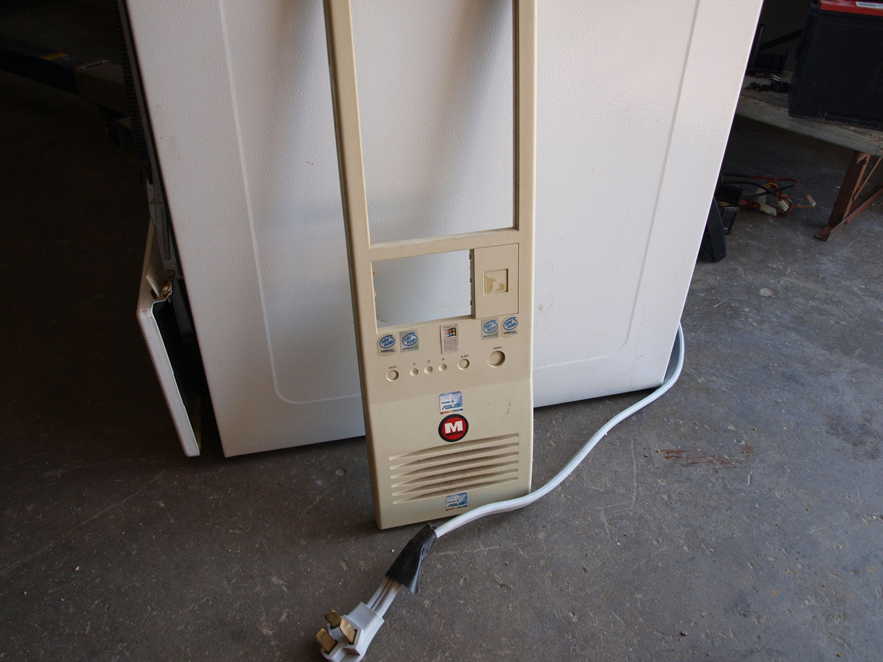

                    Now, here's where it gets fun! While working with this case (Procase), my brain tripped a memory that I had another one of these in full tower form. In a dark dirty corner in the attic, I was right! I built this circa 1996 and decommissioned it in 2001. It's been in the attic since. Unique piece of my personal history from back in my gaming days.
                    I've got something cookin' for this one...
