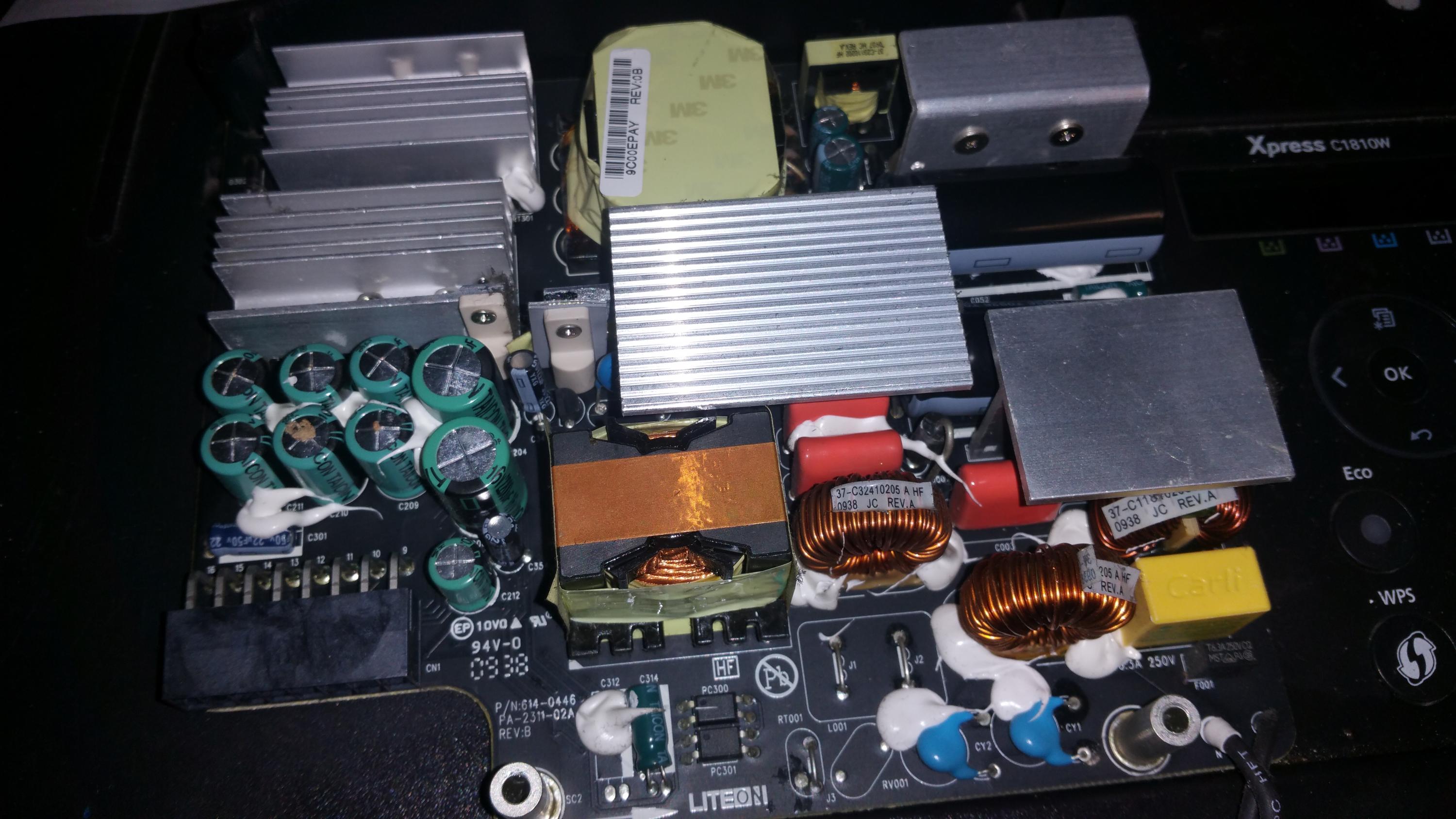

    I had gotten in a nice MAC A1312 a bit ago..
    Did a reflow on the video card to get it up and running..
    ref: https://www.badcaps.net/forum/showthread.php?t=69512
    Had it plugged into the wall at my shop and the power failed. Damn tripped breaker..
    Now the unit won't come on at all.. It appears completely dead..
    Am I looking at a likely blown fuse on the PSU?? Or a blown PSU??

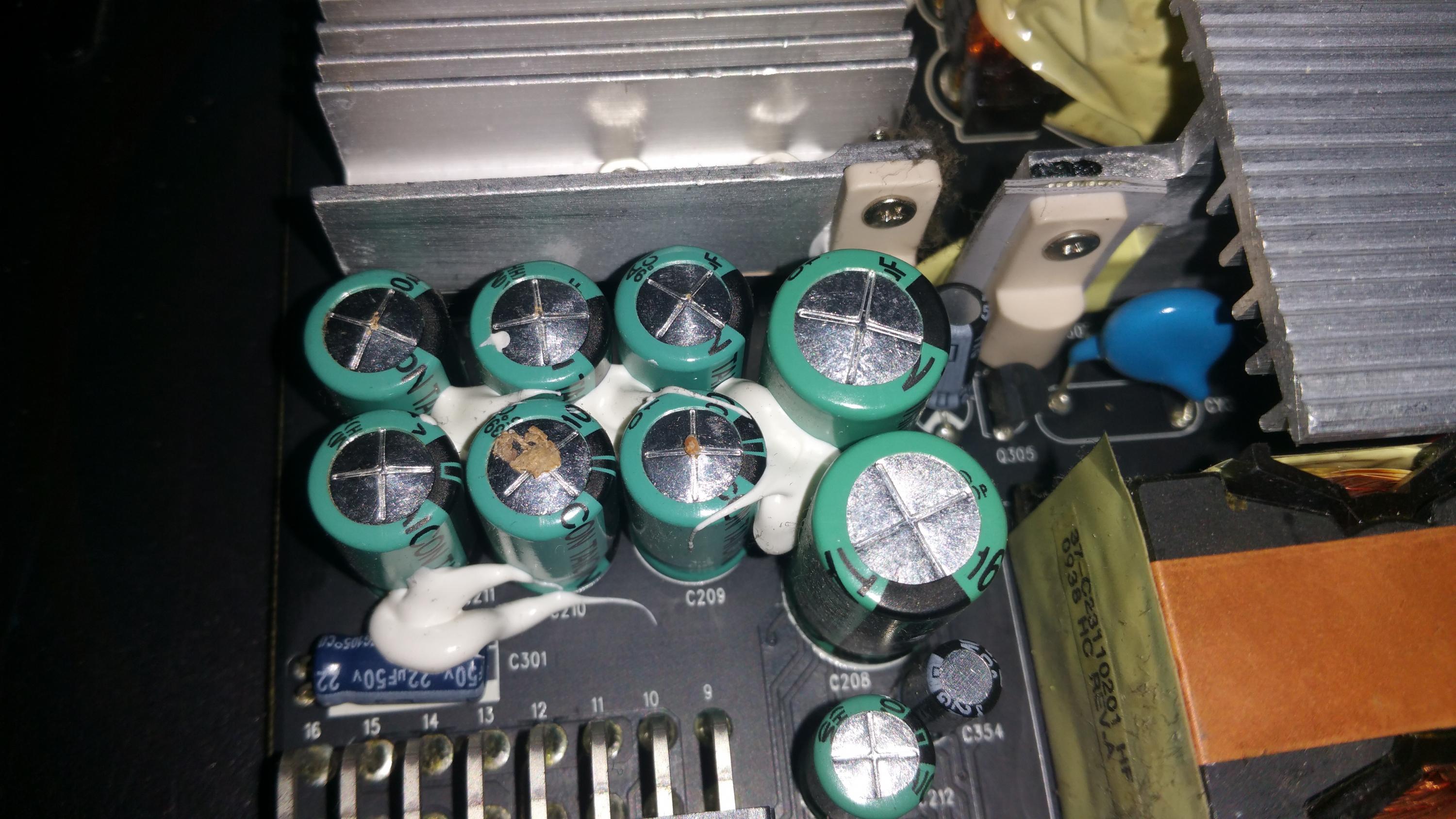

      Re: MAC A1312 Dead After Power Failure
      All the blown caps are TAICON.. They don't appear to be available thru DigiKey, my go-to source...
      I know Apple is really picky about parts and such.. Should I use TAICON or are NICHICON sufficient??
      • Per Hansson
        • Jul 2005
        • 5895
        • Sweden
        Of course you should not use Taicon.
        They are not the best brand (not the worst either).
        Look up their specs and buy reputable brands from the major Japanese manufacturers.
        That said your issue will not only be the caps.
        Probably the switching mosfets are shorted if the fuse went out.
          Awww crap.. I was hoping not have to buy a new PSU... They are about $100...
          • Michale32086
            • Nov 2011
            • 1453
            Replacement PSU found for around $40..
            Problem solved..
