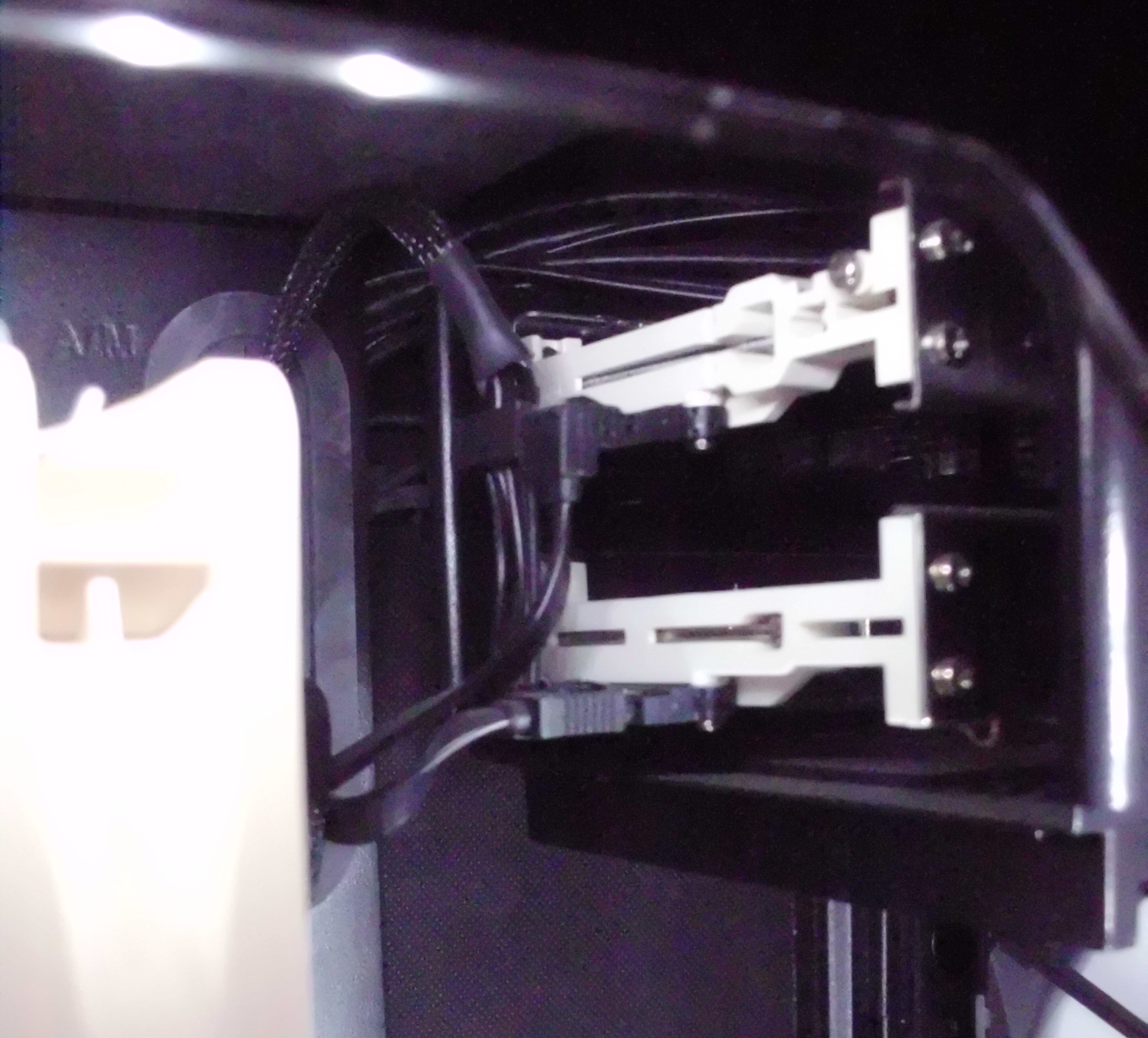

    How many uf do i need to cope with the HDD inrush current
    In my computer i have 2 hot swap bays, i made my power cable and i used some "18 awg copper" wire, i think it is actually 20awg (got it on ebay...)
    anyway i have some legit 18awg copper wire i was going to remake it and stick a couple caps at the end
    my issue is when i am using one bay and i go to use the second the other bay looses power for a moment (if i use that drive to boot it as annoying)
    i have some 470 low esr caps and i have some 10uf general purpose caps i could use as well as some 10uf low esr ones
    my PSU is a Seasonic M12II 520W

    You shouldn't be seeing a "dropout" like this -- unless your drives have some hellacious spinup currents and/or you have high IR drops in your cabling/connectors.
    But, to answer your original question...
    The voltage on a capacitor is a function of current and time (and capacitance). Specifically, CV=It.
    "I" coming INTO the capacitor (remember, there's current flowing in while it is also being drawn out) will be limitted by the peak capabilities of your power supply as seen behind the impedance of your interconnect to the powersupply. "I" exitting the capacitor will be defined by the spinup requirements of your disk drive. So, you have a "net" I flowing out of the capacitor that reflects the difference in these two.
    Similarly, "t" will depend on how long this "transient" lasts (presumably, your power supply can meet the steady-state operating demands of the disk drive).
    "V" should be treated as "dV" -- a change of voltage over a particular change in time (dt -- time interval).
    So, if your drive specs an input range of [Vmin,Vmax] and your power supply puts out Vout... and, the drive actually "sees" Vin (Vout behind the IR losses of your cables) then:
    - Vin must be > Vmin (else you won't be able to run the drive)
    - Vin must be < Vmax (d'uh)
    - Vout must be < Vmax (i.e., when the load is minimized and IR ~= 0)
    - Vin - Vmin is the dV that you have to work with; you can afford for the voltage at the drive to drop from Vin to Vmin and still be assured the drive will function.
    [The capacitor starts out at Vmax before you plug in the drive -- cuz there are no IR losses due to the absence of a load!]
    This is really just a crude approximation of the situation. In reality, your drive will probably work with a lower Vin on the 12V supply (motor) during spinup. OTOH, the 5V supply probably is a lot more fussy about Vmin as "it can lose its train of thought"
    [One "simple" fix is to run a second power pigtail from the power supply so the load from "disk #1" isn't being handled by the cable that is ALSO powering disk #2 (see your photo)]

        Re: How many uf do i need to cope with the HDD inrush current
        Are these hot-swap bays any good, they are supposed to connect GND first on the connector and delayed switch-on power to the drive. So the 5V, 12V pins are recessed, no zaps to the Sata lines.
        Otherwise, it's probably the inrush current of the plugged in HDD.
        Drives are around 2A peak during spin-up. HDD controller boards have pretty much nothing for capacitance, so any glitch causes the drive to reboot.
        Check the wiring/lead/connector resistance, -10% or 10.9V is the spec.
        Try add a large 100-470uF capacitor on 12V power, and maybe another cap for the 5V rail. A few hundred uF is good.
        If your problem is due to a crappy hot-swap connector, it could be zapping the Sata lines etc. during plug in and might damage the HDD?

            they are just cheap bays, they are just well placed sata connectors, there is nothing fancy at all as far as i can see on them
            @Curious.George Not the CPU never had a issue using the bays when running a OS off the internal bays (different power lead)
            I am using a quality PSU and i am not even stressing it, it is either a bad connection and/or inrush current
                                  That could be the problem.
                                  That one is ancient (since 2010), has low capacitance on +12V and is group regulated.
                                  That could cause an issue because the +12V Rail drops and possibly also the +5V because of the increased load of +12V...
                                  Do you have an independently regulated PSU lying around you could try?
                                  • evilkitty
                                    • Nov 2017
                                    • 299
                                    I never had a issue when booting off the internal drives that are on a different wire, then again i do not use windows on those drives so it could be idle and not care
                                    My only spare PSU is a the same unit except it is not modular (purchased when on sale couple months back)
                                    my modular one was purchased on *checks records* 7/26/2012 aka 2012/07/26
                                    I went to use one of my bays the other week and it did not work, gonna rebuild that cable this weekend (hopefully before my pi 3 b+ arrives)
                                    • evilkitty
                                      • Nov 2017
                                      • 299
                                      I remade my cable using better quality wire (without adding caps to the wire)
                                      this alone did not fix the issue
                                      added a drive during a benchmark:
                                      After adding 470uf caps on +5 and +12 (Low ESR Panasonic, rated at 25v)
                                      it did not help,
                                      When i connected the caps it caused my main HDDs to spin down
                                      * The large drop in the read speed is when i connect a second HDD in my second bay
