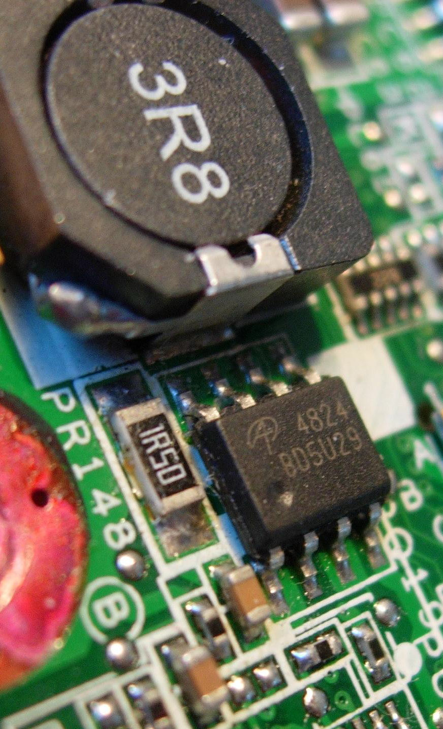

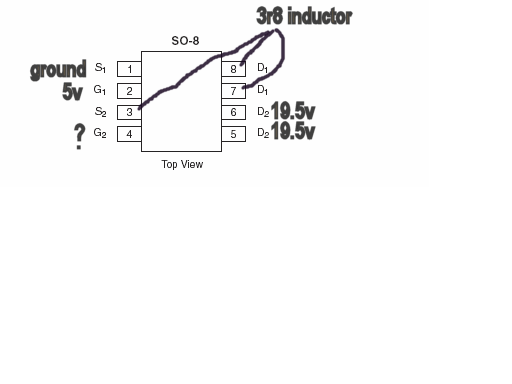

    Can you help identify mosfet?
    This is from a Dell D510 laptop.Will this part work?
    Vishay Si4972dy-t1-e3

    Re: Mosfet Identification
    http://www.aosmd.com/web/products/cross_reference.jsp
      Why substitute?:
      http://parts.digikey.com/1/parts/150...ic-ao4828.html
        Alpha and Omega semiconductor strikes again.
