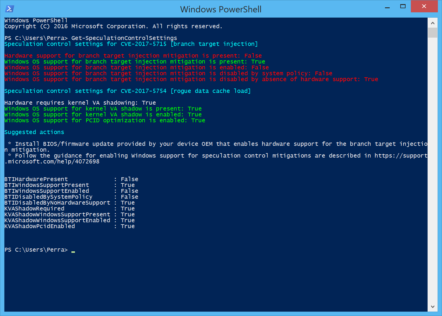

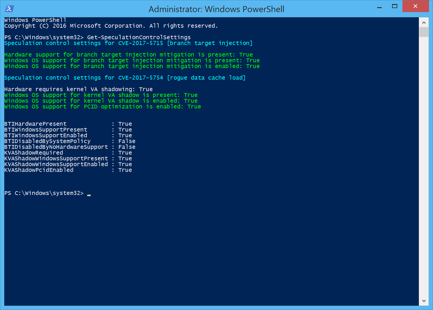

                                      #38
                                      Re: Some serious security bug in INtel CPUs?? Since Westmere possibly
                                      Originally posted by stj
                                      the main thing i'm noticing is the gamer-fanboyz are screaming.
                                      they have realised how fucked they are now.
                                      they all went for the i7 stuff to squeeze every last cycle, while being rop-a-doped into using win10 to be able to install the latest direct-x version.
                                      now they know that the kernel-fix will be auto-updated into them even if they dont want it because the machine has nothing to compromise other than a few games!!!
                                      so they are going to get smashed with what i suspect could be a slowdown of over 50% and possibly a lot more.
                                      The performance reduction in games is below 1%.
                                      https://www.techspot.com/article/155...mance-windows/
                                      Enterprise workloads, especially database workloads are what does see some reduction in performance.
                                      (Up to 35% in worst case for realistic non-synthetic loads).
                                      https://www.phoronix.com/scan.php?pa...5-x86pti&num=2
                                      The patch itself can be disabled also on Windows client systems using the registry keys linked in my previous post for servers.
                                      I have just tried it on my Thinkpad W540p running Windows 8.1 x64 before patching:
                                      After Patch KB4056898:
                                      After Patch KB4056898 & Lenovo BIOS update:
                                      It's important to note that to get the January 2018 update to show up your antivirus program must have confirmed that it's compatible by adding a key to the registry.
                                      Otherwise the update will not show up because an incompatible antivirus program will cause the system to BSOD when these changes are implemented!
                                      Do note that "Windows Defender" included with Windows 7 does currently NOT set this key as it's not a true antivirus program.
                                      So you have to do it manually if you want the update to show up in Windows 7! (Or install MSE).
                                      https://support.microsoft.com/en-us/...dates-released

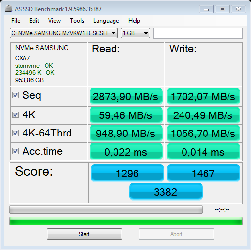

                                          #40
                                          Re: Some serious security bug in INTEL CPUs?? Since Westmere possibly
                                          That is exactly correct.
                                          Just as shown in the test at Techspot I saw a small (but measureable) performance reduction in 4K disk performance:
                                          Asrock X99 Extreme4/3.1 with Haswell-EP 5820K CPU and Samsung SM961 NVMe drive running Windows 7 x64
                                          Before patch KB4056894:
                                          After patch KB4056894:
