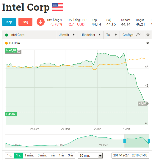

                    • Per Hansson
                      • Jul 2005
                      • 5895
                      • Sweden
                      Re: Some serious security bug in INtel CPUs?? Since Westmere possibly
                      He used to have over 500k shares, since November he has only 250k shares.
                      And guess what the minimum number of shares the CEO at Intel may have is?
                      If you don't find that highly suspicious I guess we have different standards
                      Late edit: here it's put in words better than I can:
                      http://www.nasdaq.com/symbol/intc/insider-trades
                      In the last three months, insiders executed a total of 27 trades. 27 were sells. Insider ownership decreased by a total of 796378 shares, which suggests that INTC’s key executives are feeling less optimistic about the outlook for the stock. The data from the past twelve months tells a similar story: insiders executed 3 buys and 102 sells, and ownership decreased by a net of 1.98 million shares.
                      Source: https://stocknewsgazette.com/2017/11...poration-intc/
                      • retiredcaps
                        • Apr 2010
                        • 9271
                        I don't find that it suspicious because I'm more familiar with how these stock options and things work especially in high profile world wide known companies. If this were a no name company on the penny stock exchange, I would agree with you.
                        All CXOs will get new options every year or annually regardless of how well or bad they do. All options have an expiry. They have to sell otherwise they expire worthless.
                        All CXOs get options for free ($0). Some companies do require that CXOs purchase or hold a minimum amount of stock, but this is a mere drop in the bucket compared to the stock options potential especially in a bull market.
                        Personally, I don't like the stock options as a compensation model for CXOs because it alienates everyday employees. A CXO make might $100 Million with stock options and a basic Intel engineer might make $100K with no options.
