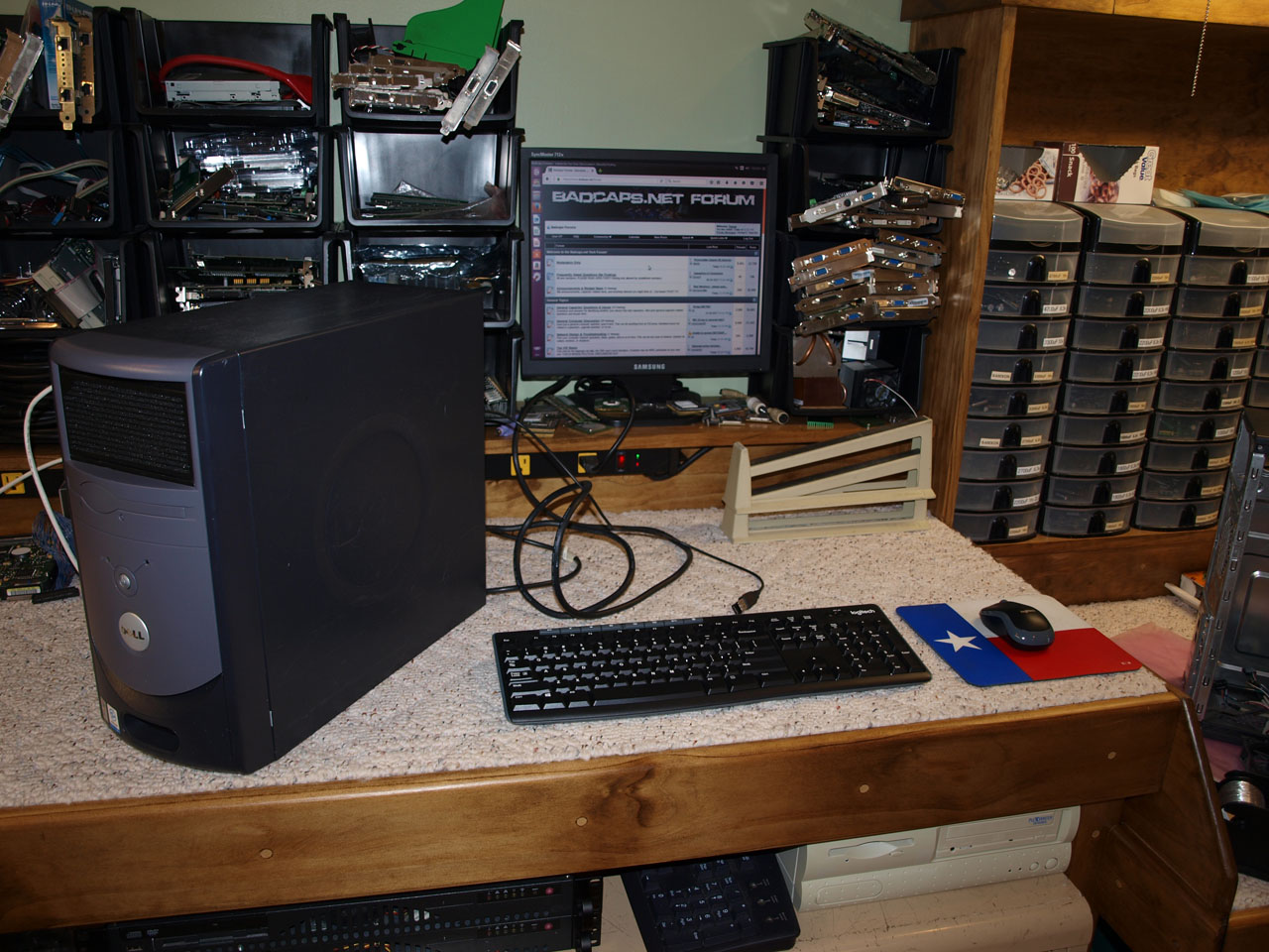

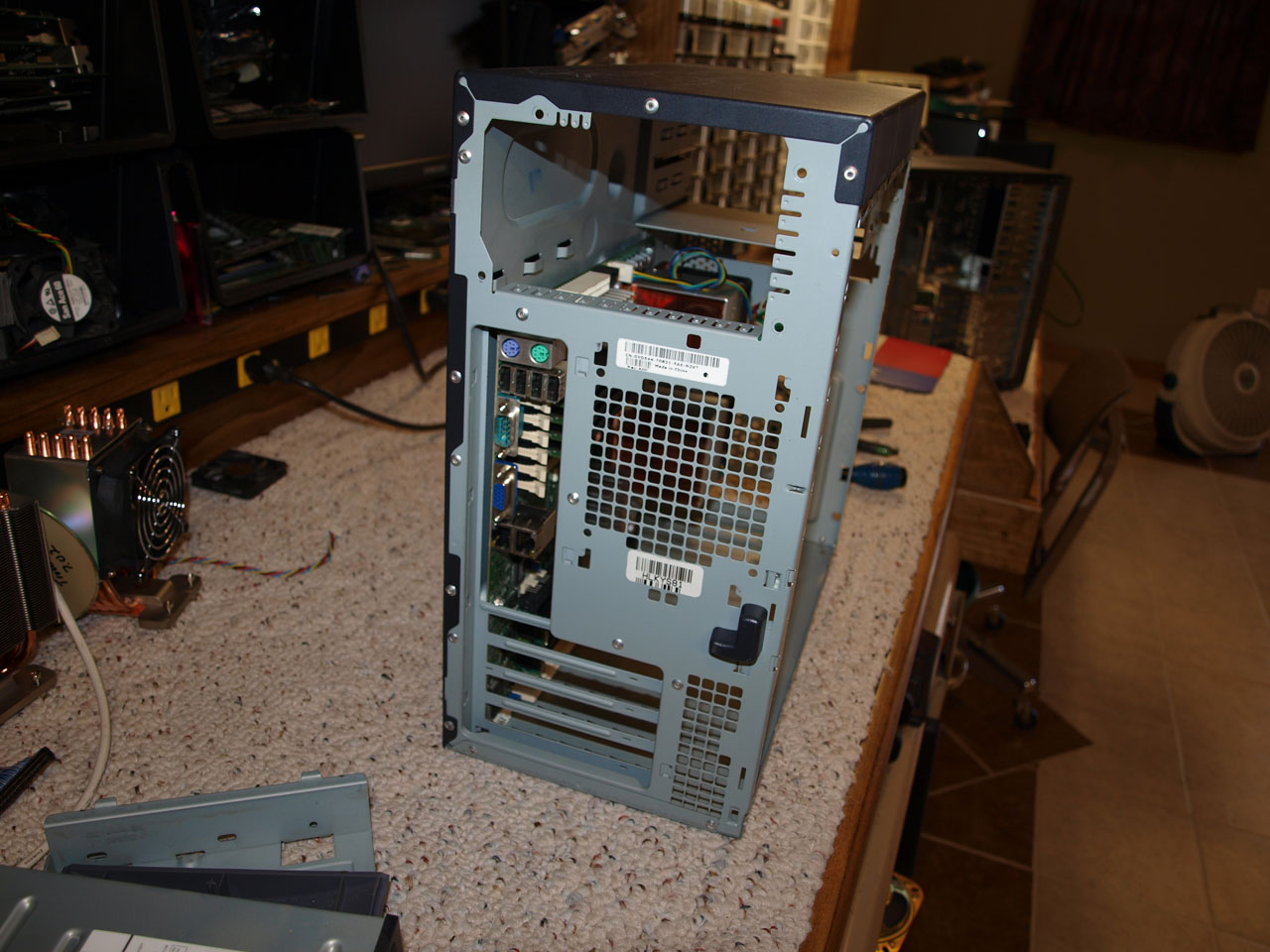

    I picked up a Supermicro X7DCA motherboard on ebay for cheap sometime back, which SM claims to be a mATX form-factor....well, its rather in violation of the mATX form-factor, as its about 1/4" taller than a standard mATX board, which eliminates it fitting in probaly 98% of mATX cases out there.... This extra height eliminates modding the case, as the bottom edge of the board conflicts with the floor of the case, so short of cutting out the bottom of the case, it just isn't going to work.....
    I've kept a constant vigil of all the mATX cases I encountered, hoping I'd run into one that has just a little extra room between the bottom edge of the board and the floor of the case.... I finally got one earlier this week when one of the local shops gave me a pickup load of junk.... It was a Dimension 1100 with a 2.53GHz Celeron in it. The motherboard was bad, the PSU needs recapped, and by modern standards, this thing was truly scrap iron!

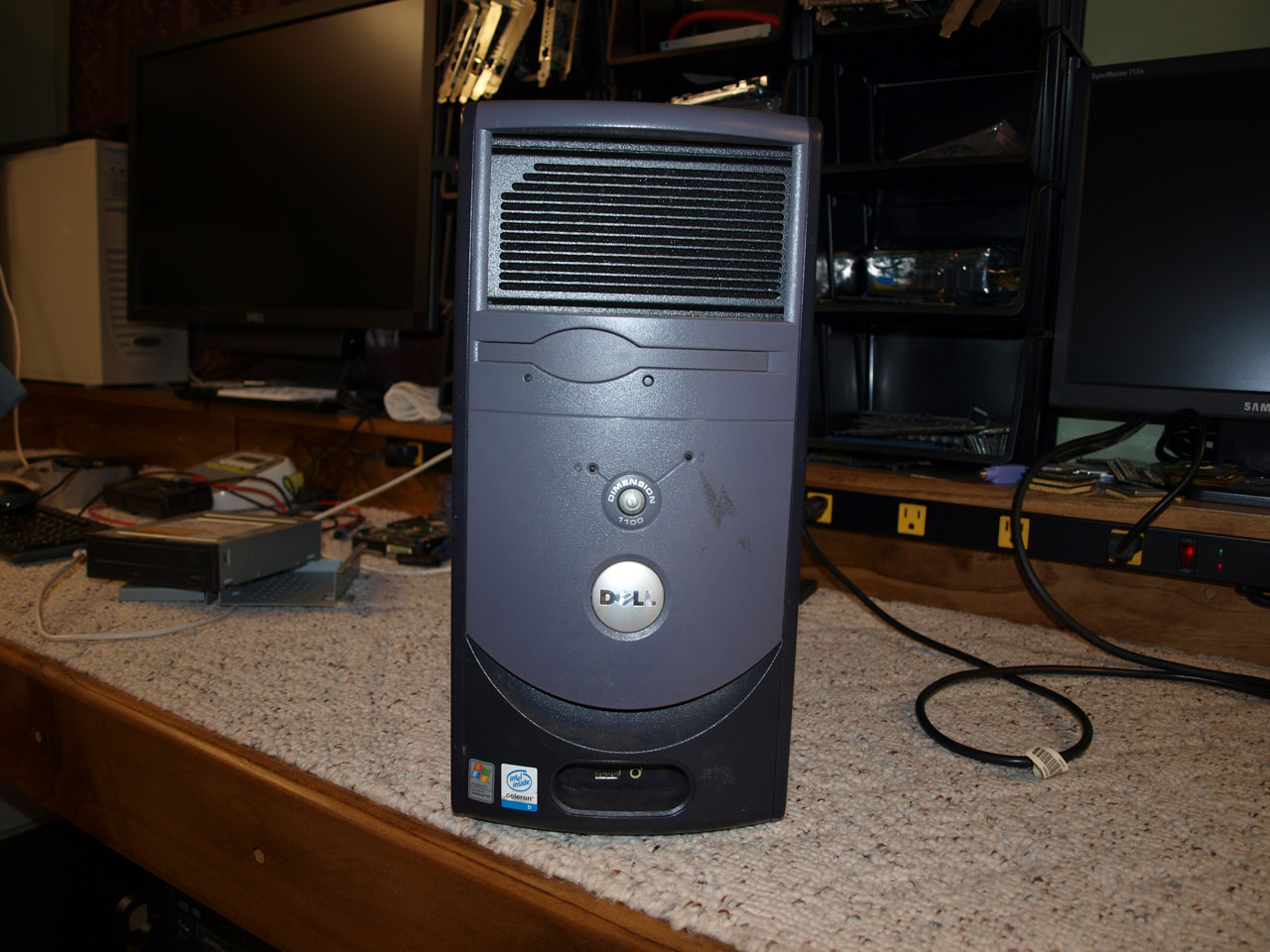

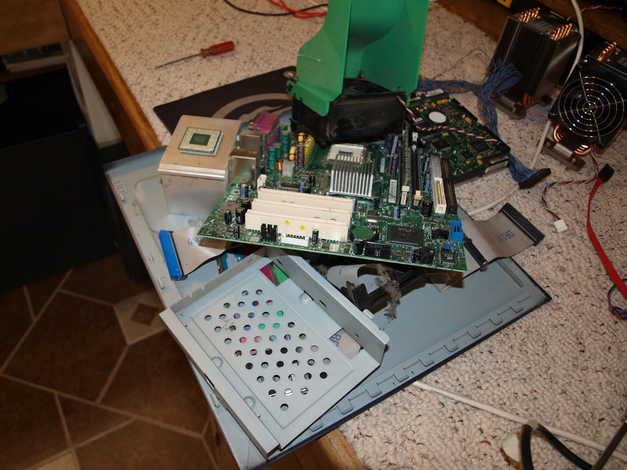

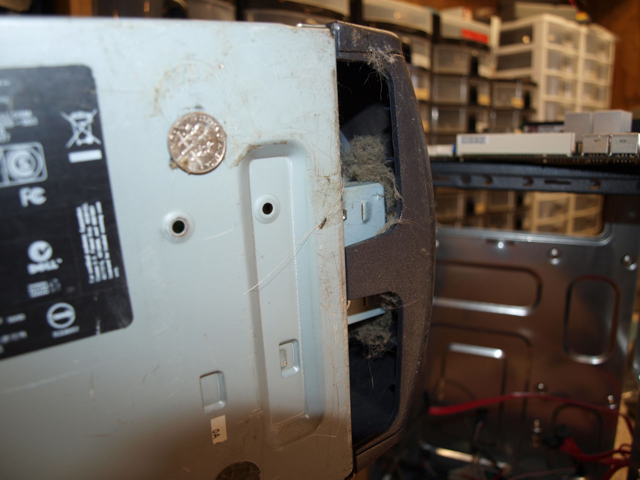

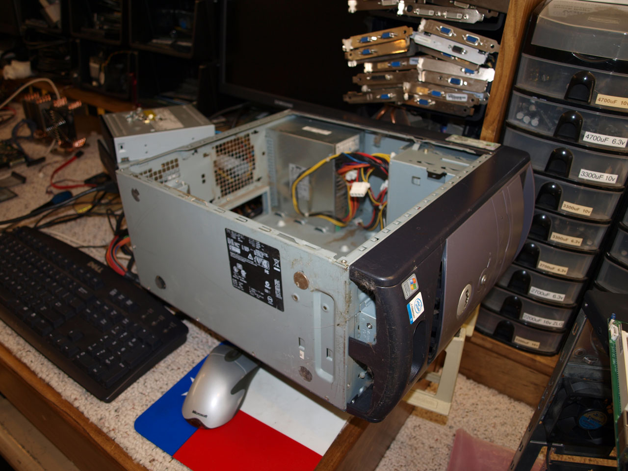

    Anyway....the junk in question:
    Junk internals removed....
    Yes, that's a dime stuck to the bottom of the case...

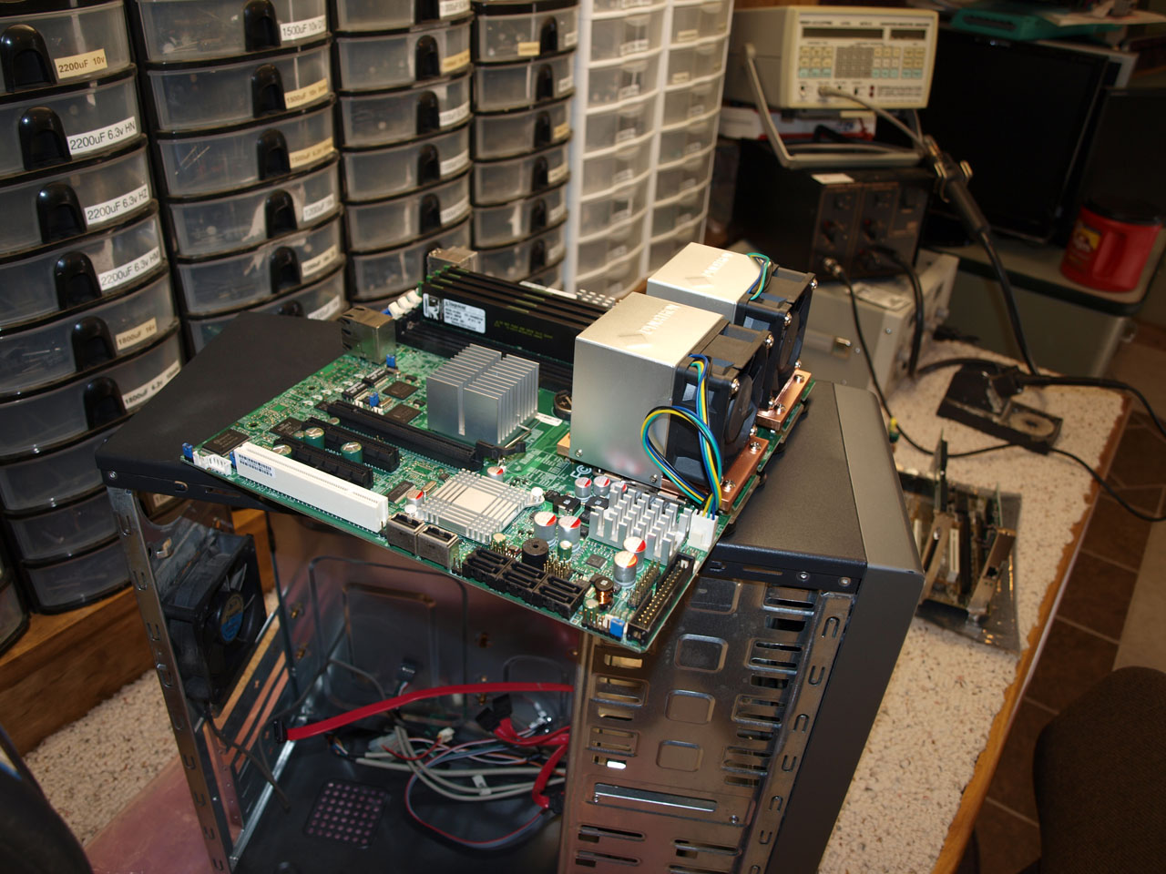

    The magic board...

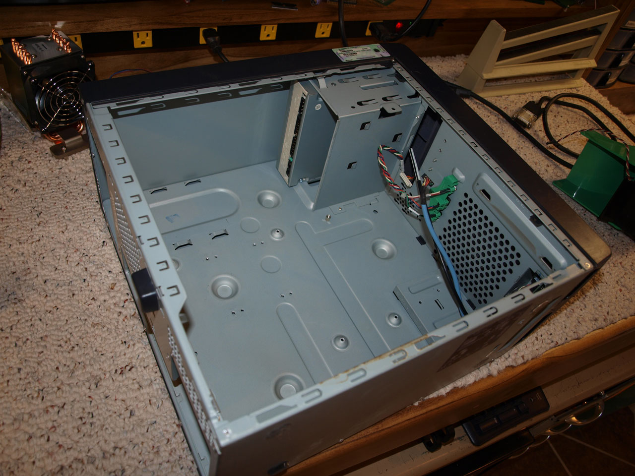

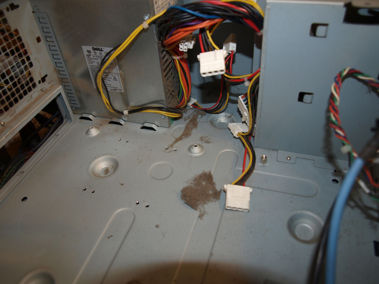

    I took the case outside and blasted it with the air hose to get all the bunnies out of it, and then came the art of making the square peg go into the round hole...

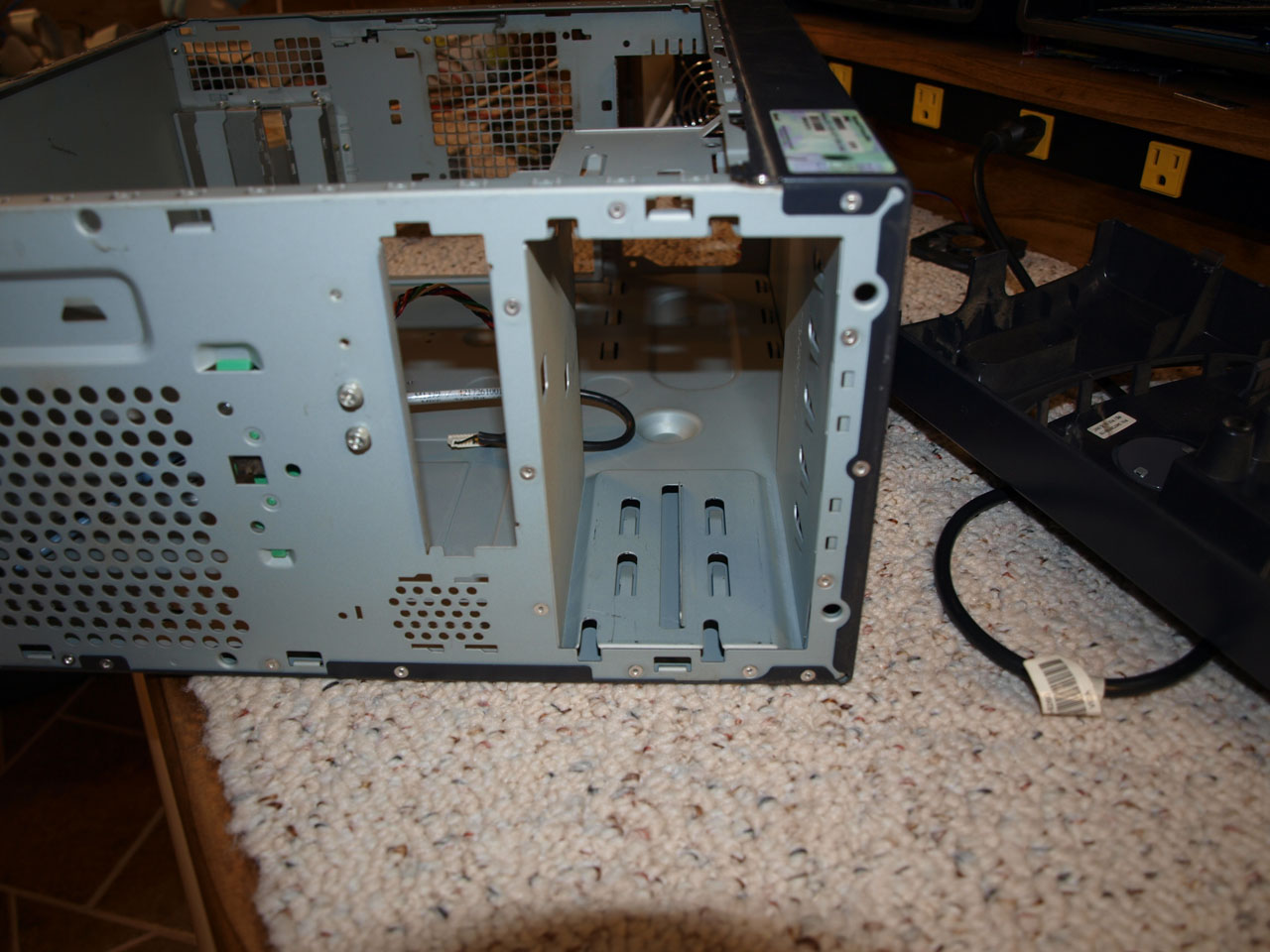

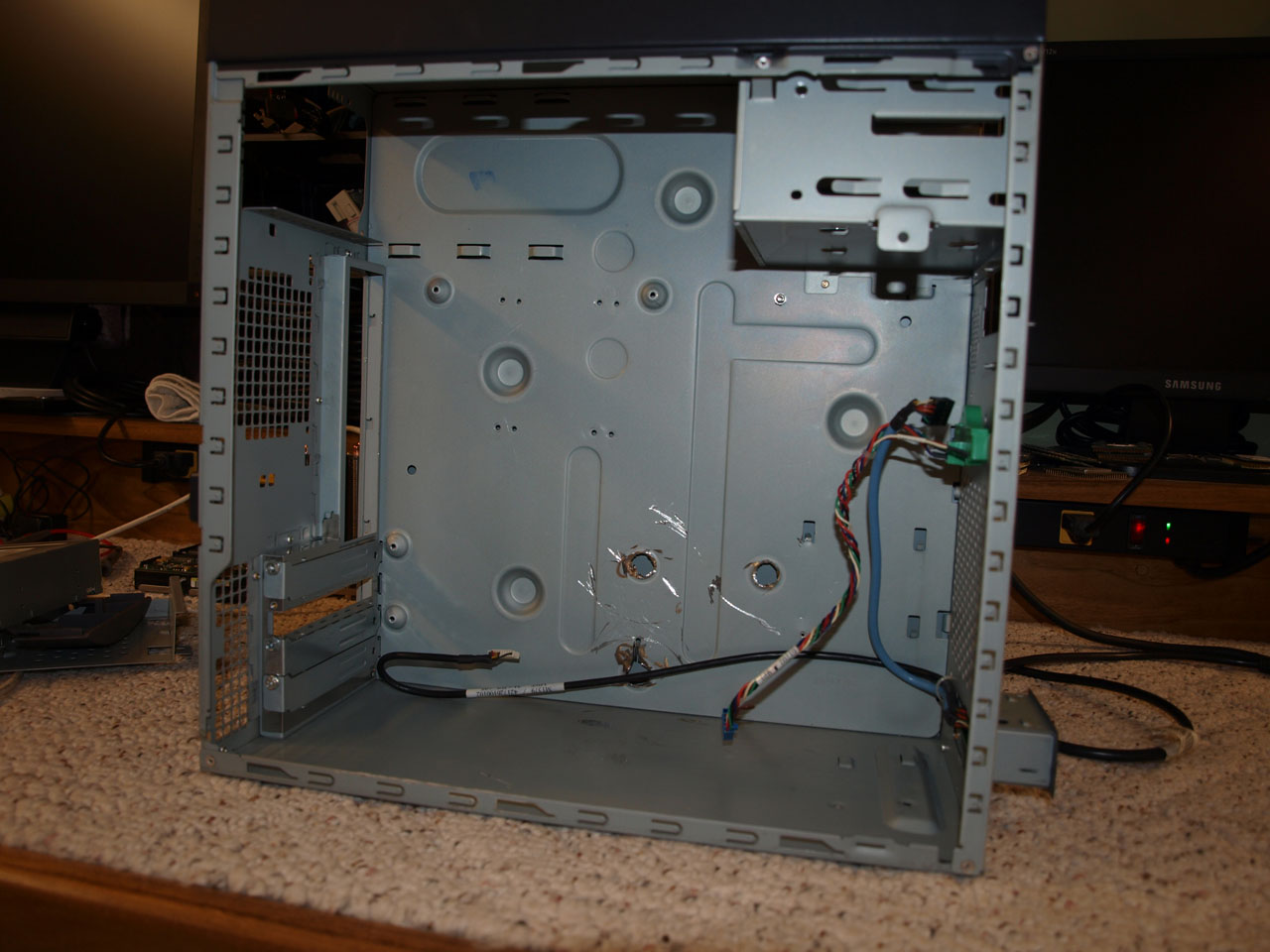

    First off that little platform the HDD bracket/cage mounts to has to go, the back of the board hits it. I'll be mounting the HDD elsewhere anyway, so no loss in losing the original HDD mount point. The large perforated front plate of the case is also a great spot to fit a 120mm fan...I'll come back to that later
    Those 3 standoffs to the left of it don't line up with the mount points on the board....so they need to go as well.

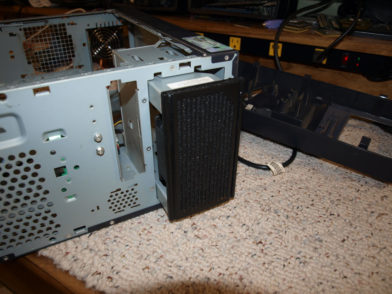

    With 2x 5.25" bays and no need for an optical, another idea dawned on me.... A bay cooler that takes both bays. This solves the HDD mount issue, adds some additional airflow (has an 80mm fan in it), and fills the 2 bays nicely.
    Test fit:
    Aww yeahs!!

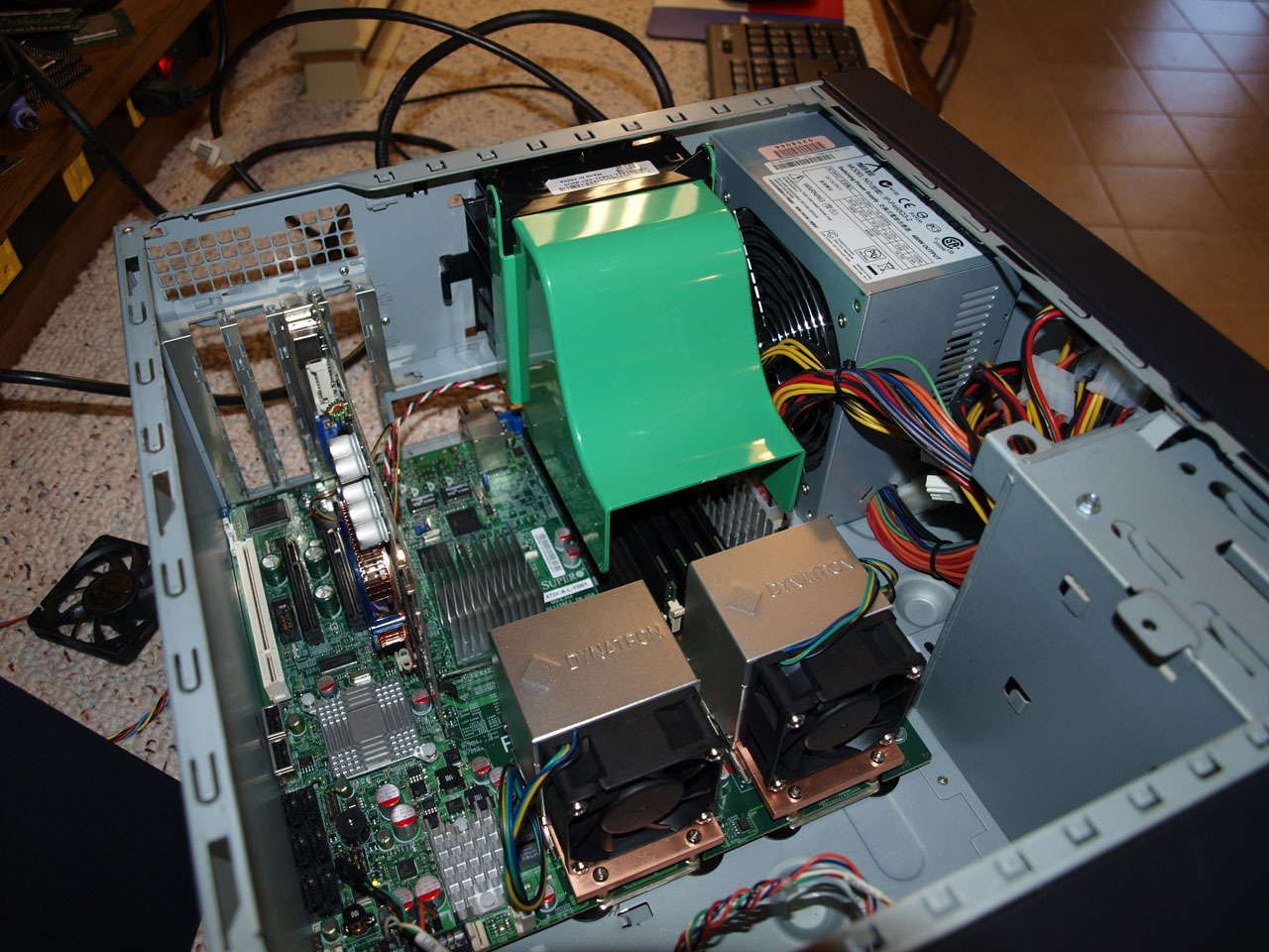

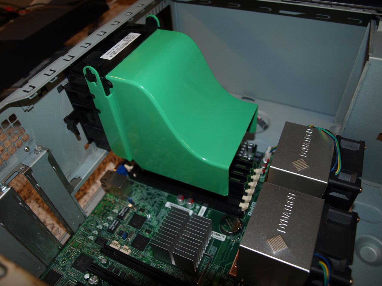

    Now to test fit the motherboard with the OEM air guide....this couldn't have fit more perfect!! Its right over the memory, creating a nice windtunnel to keep that quite hot ECC nice & cool....it's not as bad as fully buffered, but registered/ECC still gets very toasty. I had to trim one small tab off the bottom edge of the plastic tunnel housing, as it was hitting the DIMM modules.
    Trimmed.
    Zipped the standoffs out with an angle grinder....that was kind of tricky in that small space....but I got it...
    Now everything got hotwashed in the sink with simple green, and dried out.
    Board attached to mounts. There's MAYBE .25mm between the floor of the case and the bottom edge of the board, its VERY close! No, I do not have an IO shield for this board, I will find one though, Supermicro is good about not having a gazillion IO shields, and uses maybe half a dozen different styles....and this one is pretty standard. Finding one won't be a problem.
    There's that 120mm fan I mentioned from earlier. I need to drill a couple holes to attach it, I'll do that when I install the IO shield (board has to come back out).

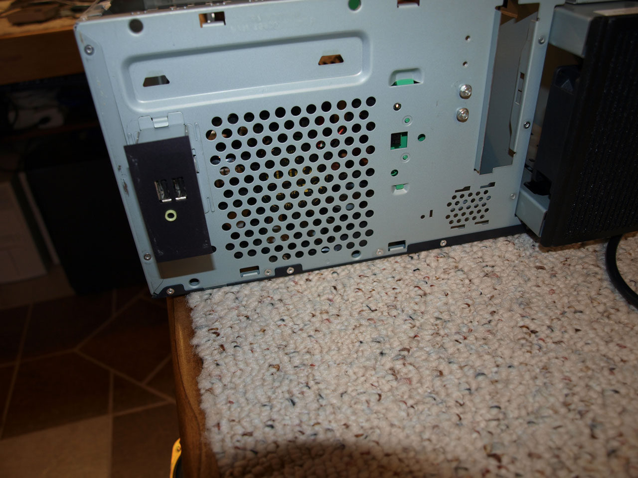

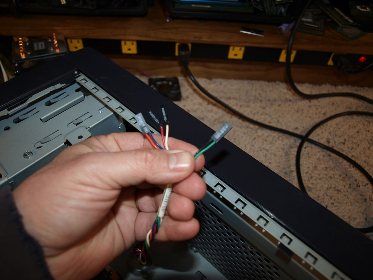

    Now for that goofy single-end front panel connector....
    Cured.
    PSU & GPU added, and ready for a test fire...
    Ignition!
    Ubuntu Live.....
    It runs quite nice and surprisingly cool. Memory was warm to the touch, not scorching hot like it usually is.
    That's all for now. This board is the model without the onboard audio, so I'll have to get a PCIe sound card. The 32-bit PCI slot is rendered unusable due to the mATX constraints, there's no external opening for it...I have no idea why they called this board a mATX, its clear it wasn't really intended to be used in a mATX case at all....but with a little cunning, it can be done. Once I get an audio card & IO shield, I'll finish this one off. I'll also add a HDD of course.

            In this (I added):
            That holds 3x 3.5" HDD's.

                Awesome sleeper! I like how the front of the case still has Celeron D and Windows XP stickers.
                By the way, I like those Dimension cases a lot better than the clamshell ones from the same era. They also have a bit less plastic, save for the front cover/face. That's probably one of the reasons I never really liked many OEM cases, as they often used way too many plastic panels and covers. The P4-era Dimension, like this one, were a rare exception, as were the more recent Core i5 and i7 OptiPlexes - quite the opposite of a modern Studio XPS tower, which has probably one of the most complex plastic front covers/faces I've seen. Whoever made the thing in AutoCAD (or whatever drafting program they used) must have taken them a LOOOONG time to finish.
                Well, that original board appears to have quite a few yellow Fujitsu polymers on it. Also, the green Chemicon KZEs can be reused as well. Oh, and let's not forget the chipset heatsink - way better than the crap you get nowadays on some modern low-end boards.
                ... at least that would be the stuff I pull out of it.
                Maybe the LPC / Super IO chip as well, depending on what it is. You never know when you need one to revive an old retro board that uses the same SIO chip. That eMachines FIC AM37 board you got recently may be on that list.
